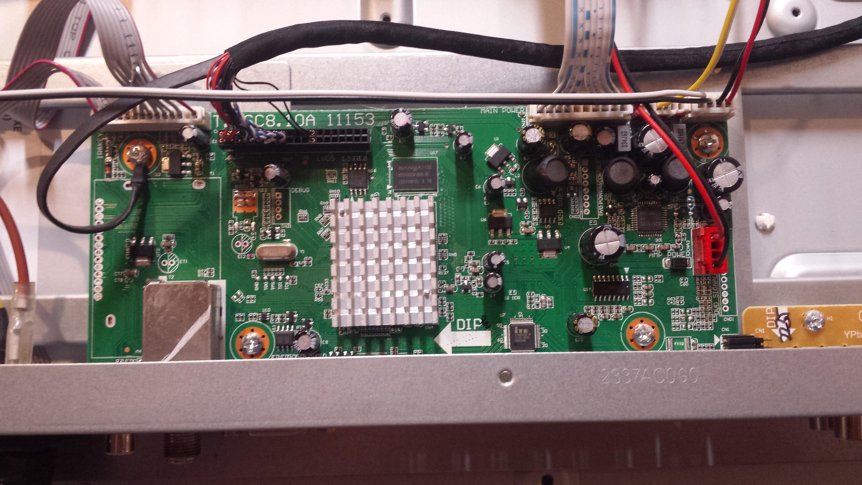

      The existing diode has two of what I assume are rf chokes. Should I reinstall those on the new diode?

        Maybe you need to post picture of this diode. If you tested out of circuit there should be no capacitive effect in reading, nor rf chokes.
        • isherwood
          • Feb 2017
          • 26
          Re: Westinghouse VR-3710 stuck in standby
          You can see them in the original photos I posted. They're anchored with green adhesive. One on each lead next to the diode body.

              I can find nothing about those rings in my research. If anyone has a link to an explanation, please post it.

                          Ok, replacing the diode brought back the 24v pins. The power light goes from red to green when I hit the power button, but no picture. I used a light but couldn't see anything.
                          The C31 cap reads 167 on standby and 383 power on.
                          What's my next move? Thank you.
                            Do you have backlights?
                              Nope.
                                So you need to find out if you get a backlight on voltage. It may be the one on con2f that says sw.

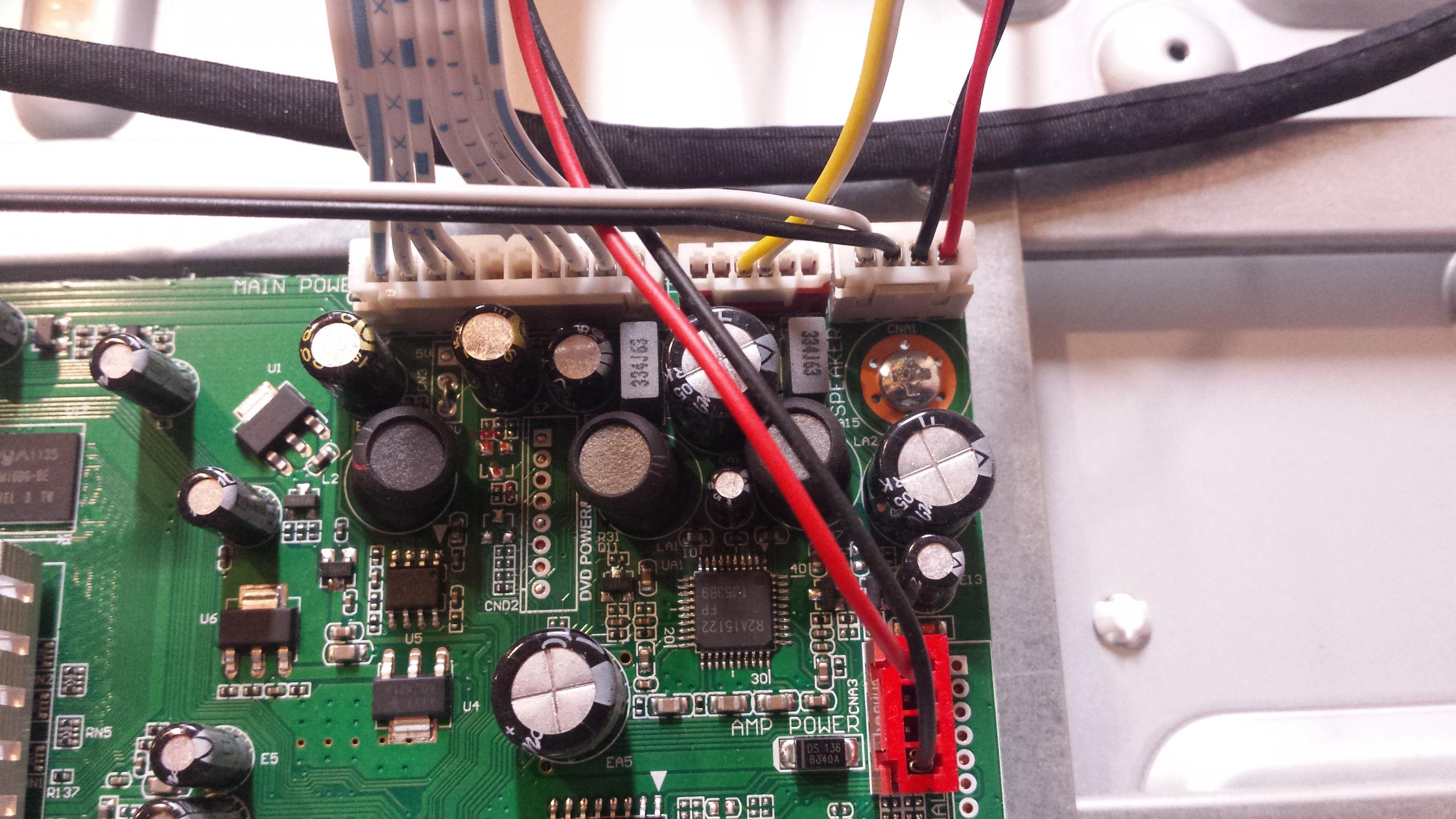

                                  Do you have a photo of the mainboard connection to inverter
                                      No voltage at any of the CON2F pins.
                                        You have two connectors that go into the panel for backlights. You can check voltage on each as you power on the set and see if you get momentary voltage and report max voltage if any.
                                          I think one of those pins, namely SW would be "Inverter On" and the voltage is missing.
