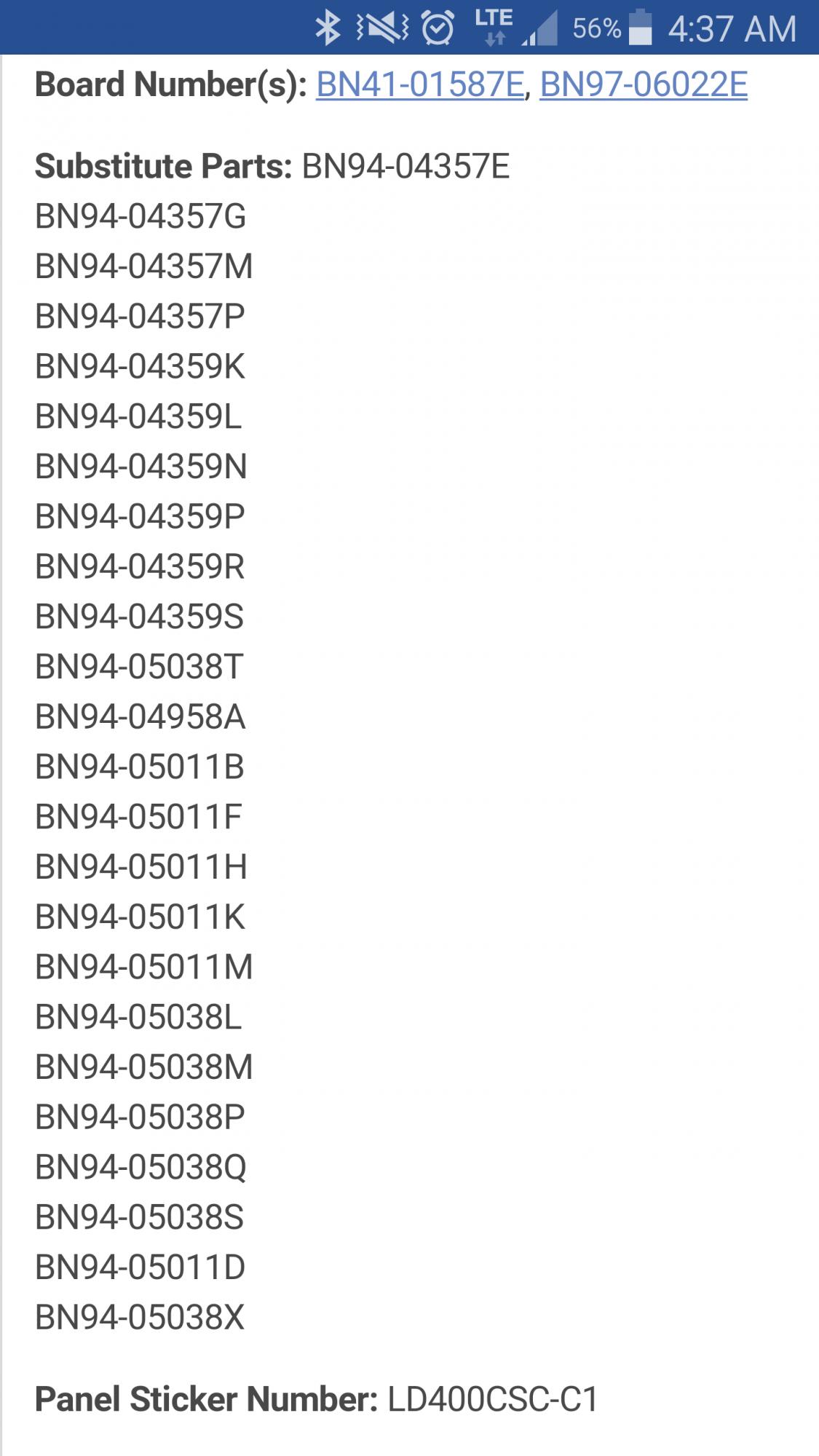

    Im after a main board for the above tv as I have a issue with the tv not displaying anything but seemingly coming out of standby. when you unplug the main board from the psb then the backlights come on. I believe this is a common issue as there is a guy charging about $150 to do a repair on them on ebay but allas I think I maybe able to get a replacement board a bit cheaper. So what im after is the compatible board numbers for the board I have which is bn94-05108f I cannot find anything or one for sale in the UK but I know shopjimmy has a compatible list on there site and was wondering if anyone with access could do a screen grab for me so I can widen my search for a replacement main board.

          That's an obscure main board. The model number is European so won't come up on Shopjimmy and I don't see any 37" sets for that model range so I searched up UN40D6500 and here's a list if you're feeling lucky.

              Re: ue37d6530 bad main board
              cheers mmartell will check some of them out see if the set up on the boards are the same
