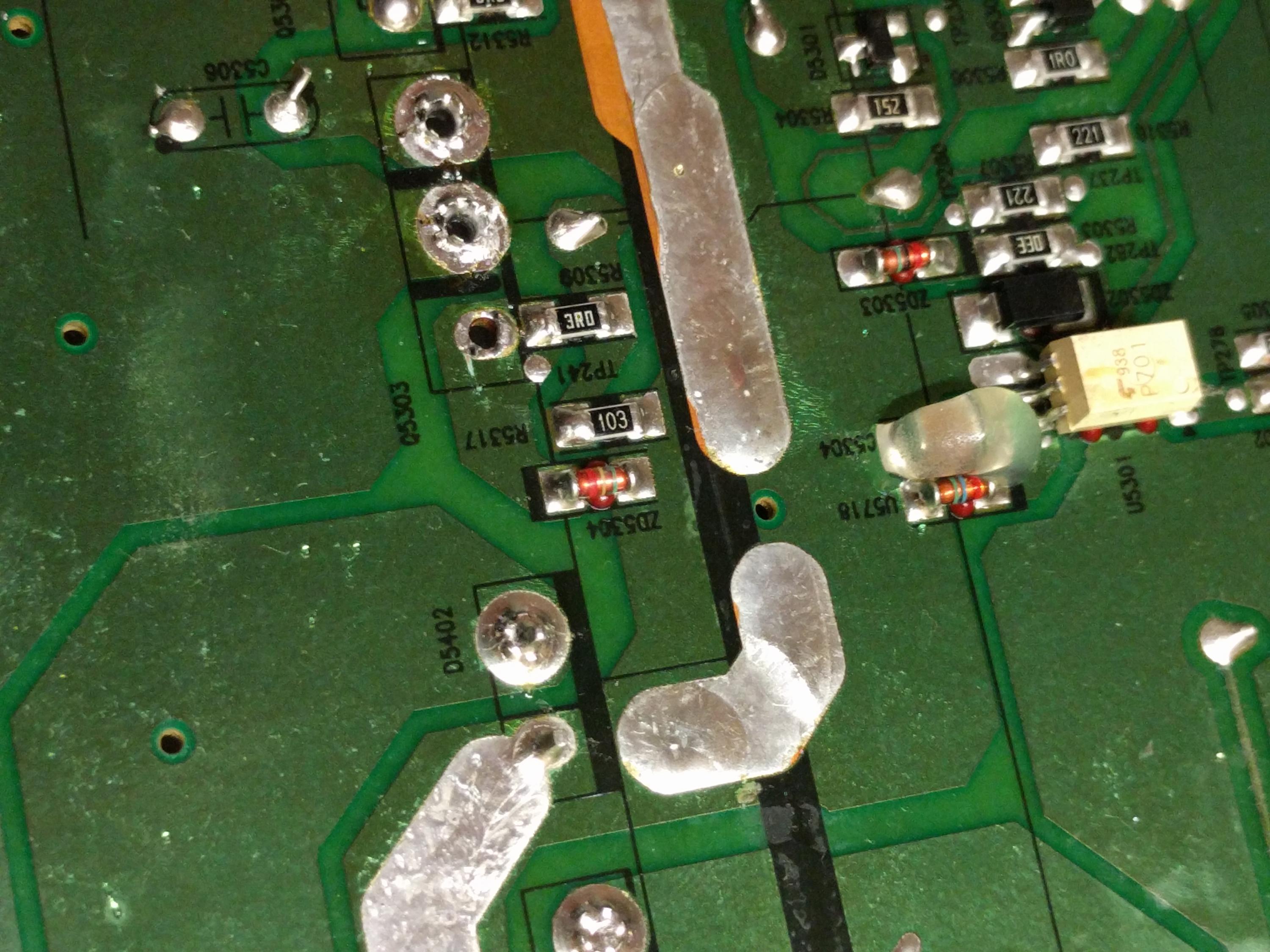

    I'd check zener zd5304, you'll probably need to remove it to get an accurate reading remember what way round it goes. Cathode to black stripe.
    If shorted it may have caused quite a bit of damage.
    If its OK, replace the igbts and test again between vs and Gnd. If its now in the high K ohms....
    Plug in and pray.

        thanks, I'm just going to remove zener diode. what do you think about X board, is there chance it might be damaged too as Y and X in direct connection?
          Re: Samsung plasma PS50B430P2W relay clicking noise - no picture
          zener diode, one way reading 900, other way none, it hasnt got black strip
            Seems OK.
