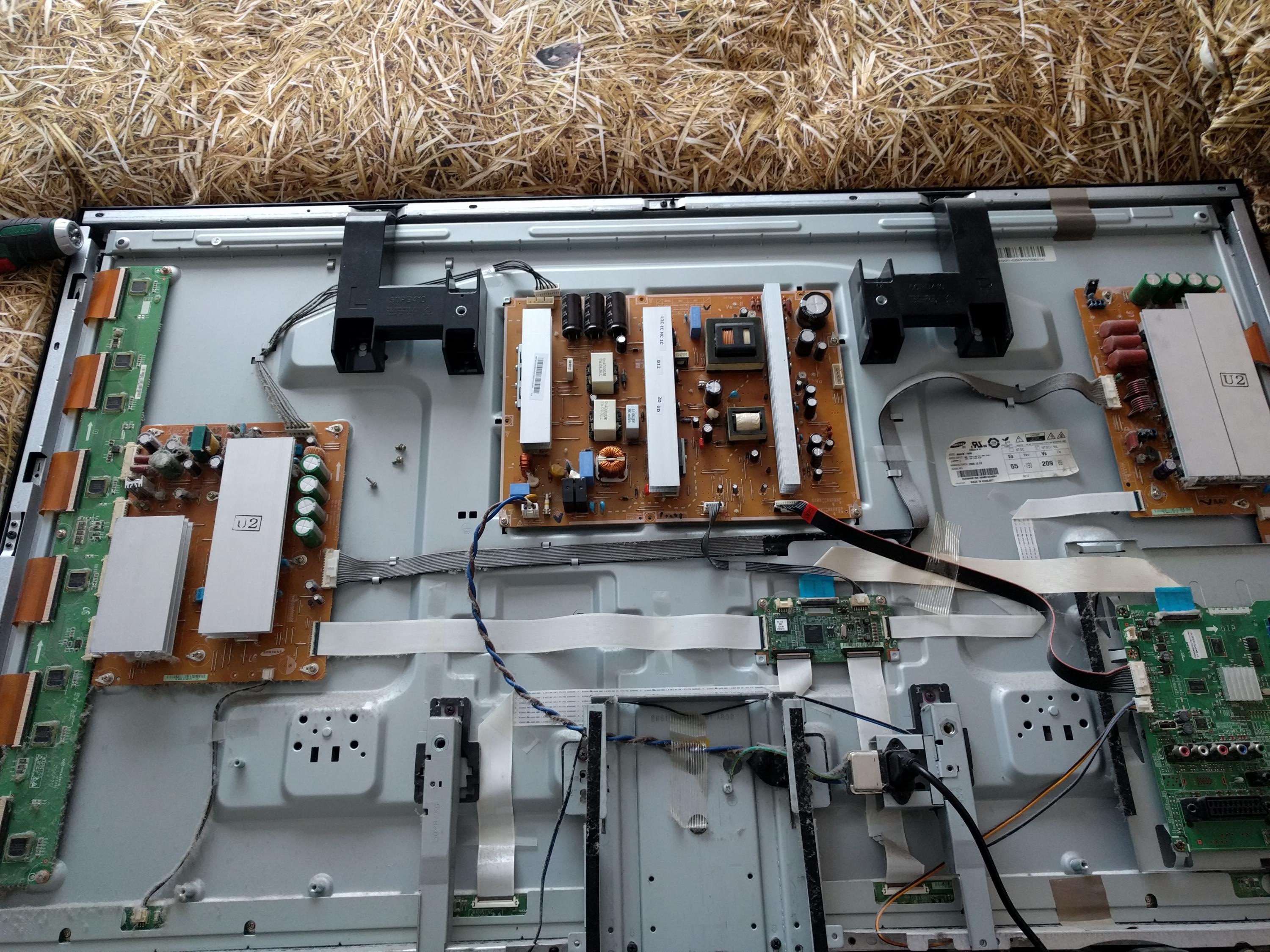

    Hi All.
    I need advise to indetify which component is faulty.
    Samsung plasma PS50B430P2W (serial number on picture below) keeps clicking on and off (relay noise ) and no picture on the screen. I tried to disconnected all components from power board and results are that when I disconnected Y main board TV started , well at least there was samsung intro sound coming from speakers. Y main board is connected directly with power board and X main board is connected to Y main board. I checked voltages and :
    If Y main is disconnected from power board I get :
    Va starting at 130Vac going down to 0V
    Vs Starting at 409Vac going down to 0V
    If Y main is connected to power supply I get :
    Va starting at 23Vac going to 17Vac(relay clicks off) and back to 23Vac(relay clicks on)
    Vs 0V all the time
    Vsc 0V
    Ve 0V

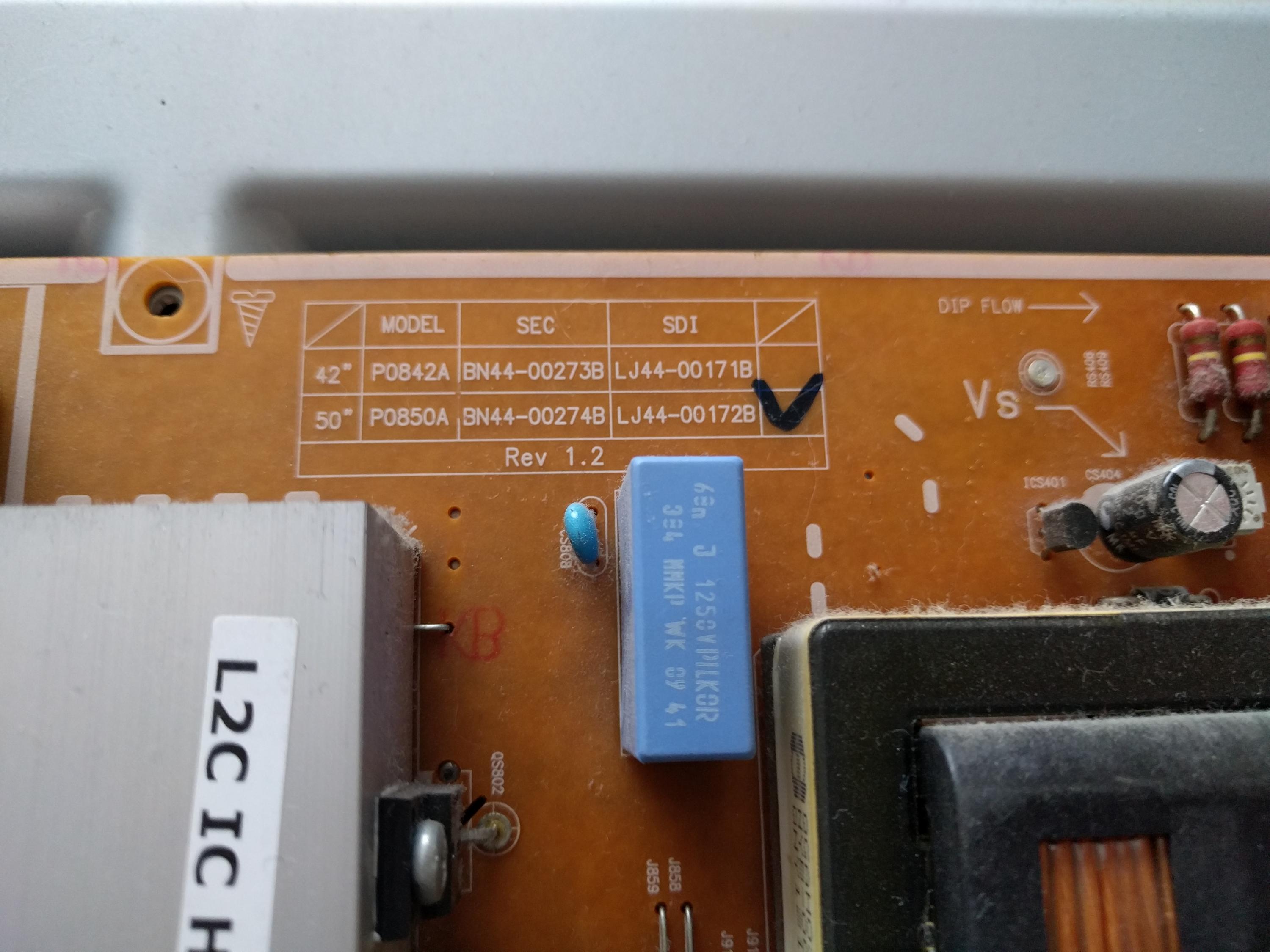

    I attached picture of white sticker with proper voltages.
    What have I done so far ? - I have changed most of electrolytic capacitors on power board.
    Power board number BN44-00274B
    Can you help me at least identify which board needs replacing or maybe help fixing existing fault . Kind regards

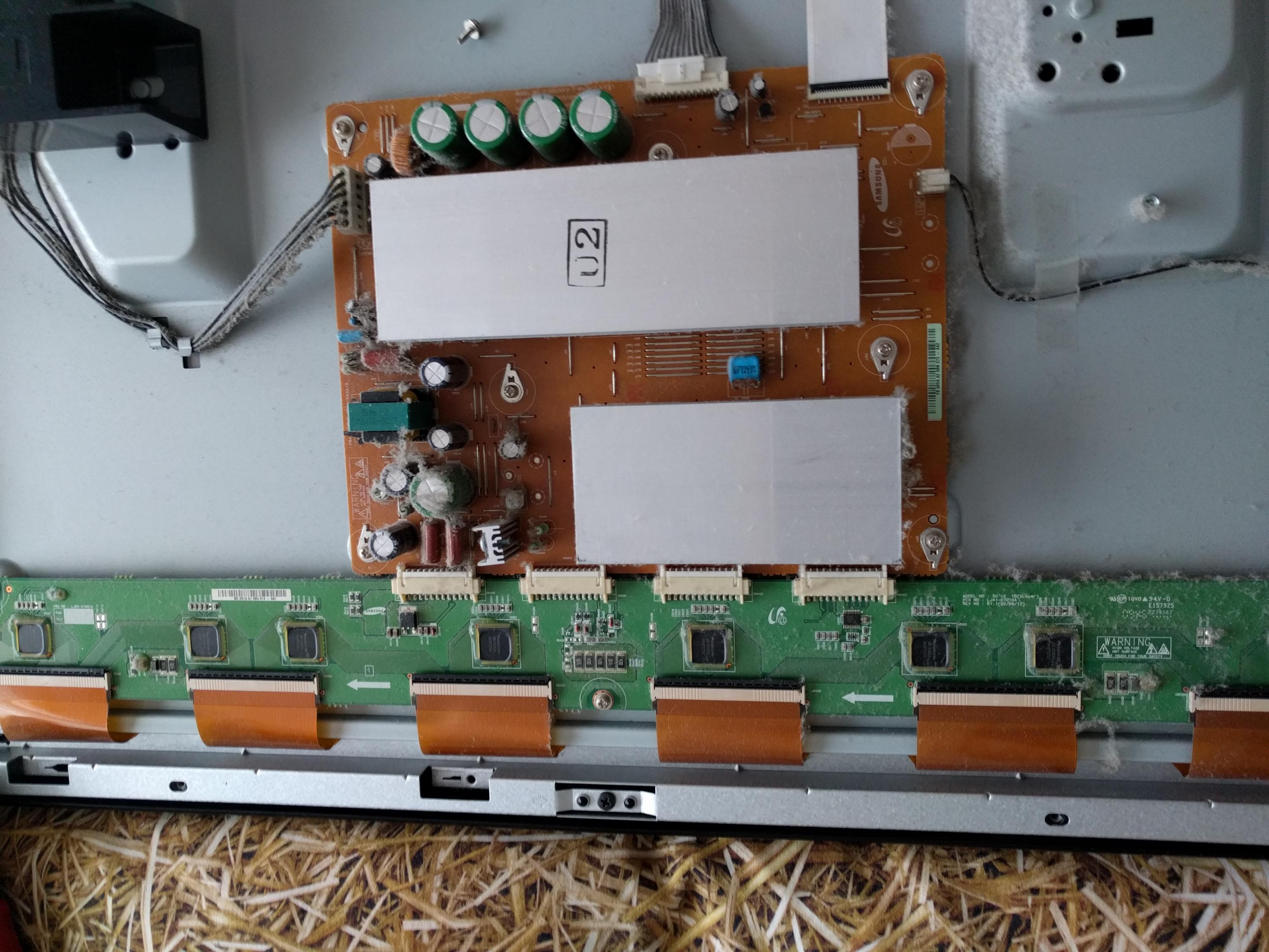

            The vs drops because there is a problem with the ysus or buffers.
            Try unplugging the buffers and try again.

                Long green board that plugs into the y-sustain.
                Remove it and see if your voltages come up.

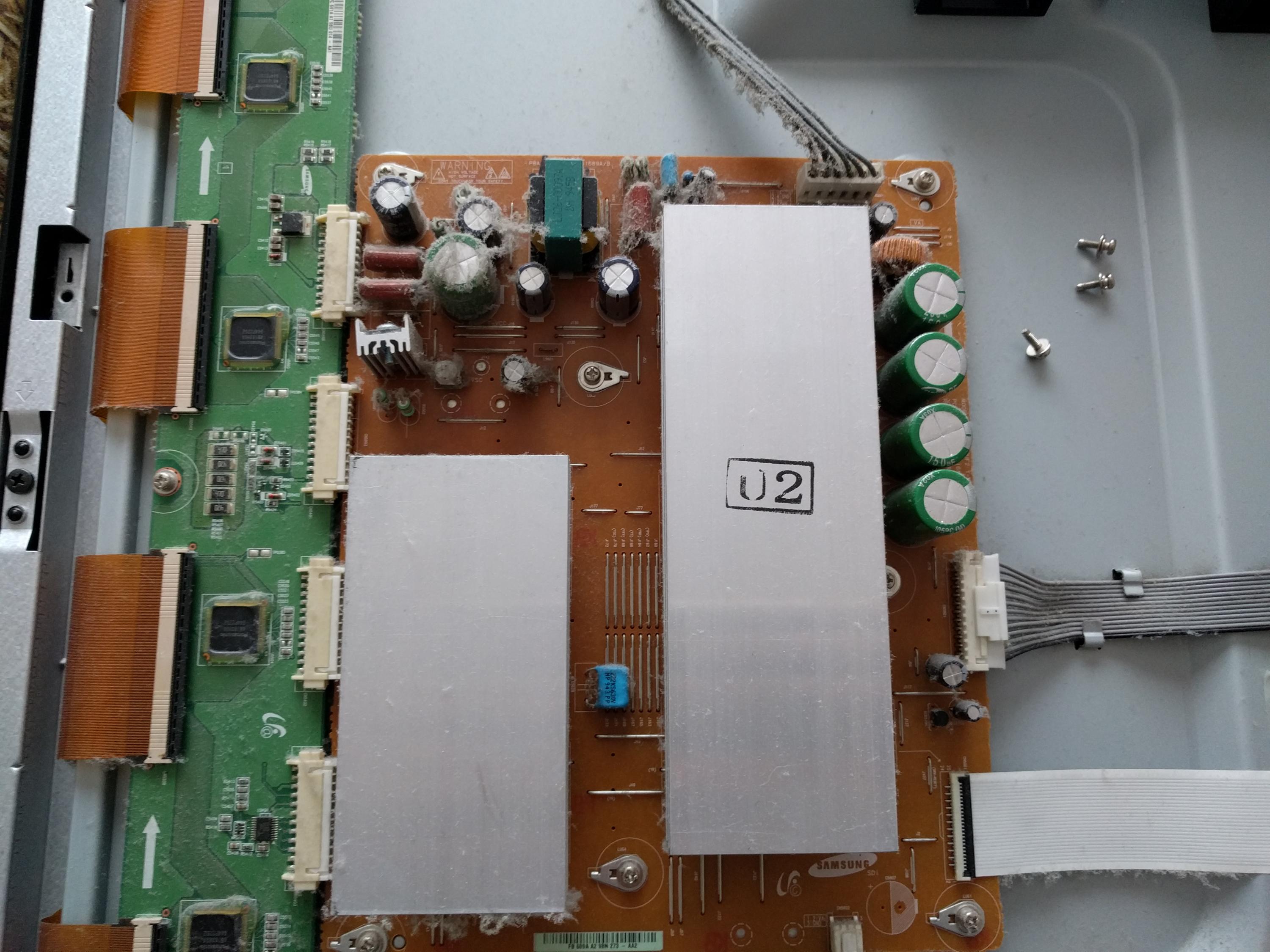

                      any hint what to check on Y board, board number is LJ41-07016A.
                      • Hamie
                        • Apr 2014
                        • 1383
                        Re: Samsung plasma PS50B430P2W relay clicking noise - no picture
                        First put your meter in ohm setting and see if the vs input is shorted to ground. If so check all igbts and diodes attached to the heatsinks for shorts.

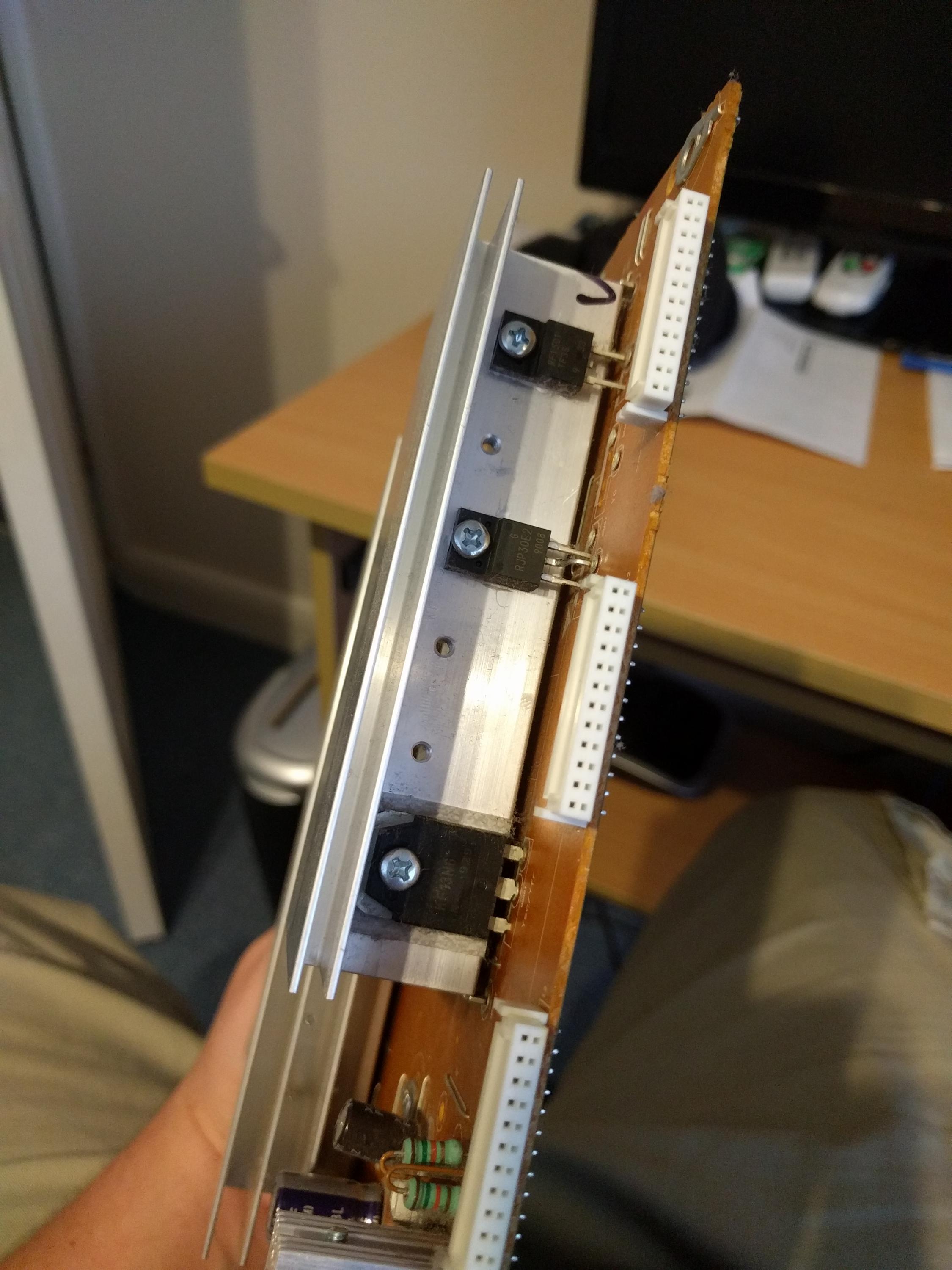

                              thanks for help, I found transistors shorted attached to heatsink, tomorrow after my day work, I will write exactly symbols, and I will need further help. thanks Hamie for you time.

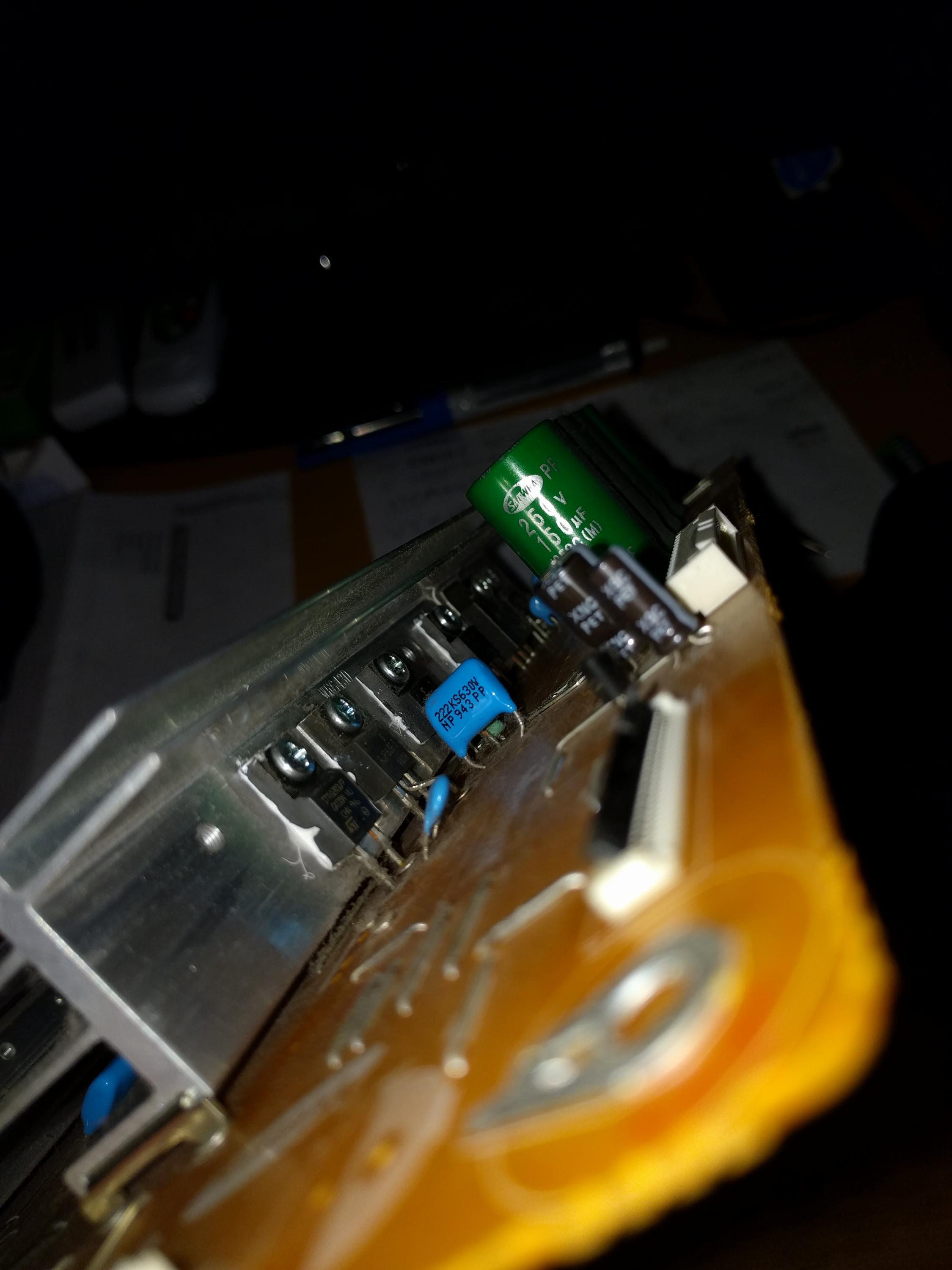

                                Hi again .
                                I attached picture with numbers in red showing which transistor is shorted.
                                1. Q5304
                                2. q5303
                                3. diode d5402 with meter set to 2000 ohms gives reading 448 one way , other way shows 278, as far as i remember the current should only go one way
                                4. Q5403
                                5. Q5101
                                6. diode d5101 resistance one 039 other way 027
                                7. diode d5406 resistance 417 other way meter shows 1 sometimes 327 then back to 1
                                8.Q5402
                                9. Q5501 seems to be ok this transistor.
                                can you give me further advise , thank you
                                • Hamie
                                  • Apr 2014
                                  • 1383
                                  If 1-2-4-5 are all short then you can't test the diodes properly.
                                  I'm surprised 7-8 are short.
                                  I'd suggest is removing 1-2-4-5 and rechecking diodes once they are out of circuit.
                                  For diodes you're better checking them in diode mode.
                                  • Damtom
                                    • Dec 2014
                                    • 57
                                    thanks just to be clear I need to remove heatsink radiator first? I don't know how to describe but legs of radiator are in some kind of socket in board
                                    • Hamie
                                      • Apr 2014
                                      • 1383
                                      No the legs are riveted. It's no big deal.
                                      Unscrew the igbts from the heatsink and bend them forward. If they are screwed the heatsink will take the heat away from your iron.
                                      Get the leg free that's not riveted then simply walk them out the board. Use some flux and wick to clear the pads once removed.
                                      • Damtom
                                        • Dec 2014
                                        • 57
                                        Hi again
                                        you were right. 1, 2 4 5 and 8 transistors shorted. diode 3 and 6 are ok once transistors are out. diode 7 with meter set to diode shows me one way 435 other way 1035, I'm not sure if this diode is OK.
                                        also to remove some transistors I had to take out 4 big green capacitors, I checked them and they are OK.
                                        can you help with further advise, thank you Hamie
