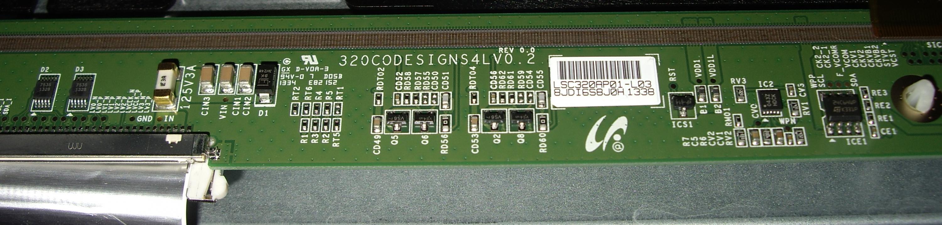

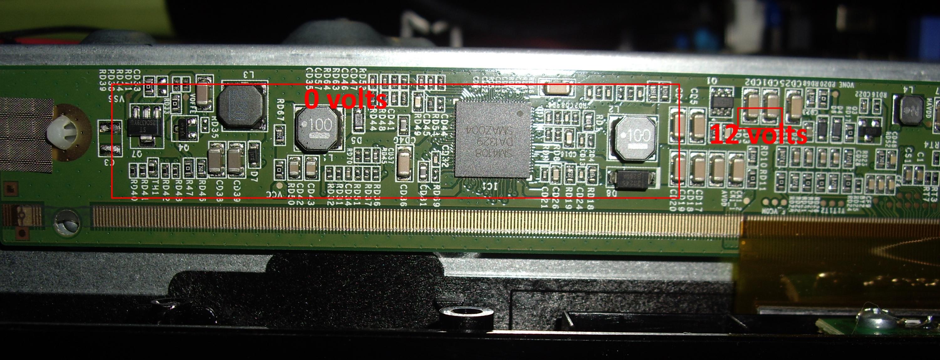

    my TV shows no picture.
    It starts, the background lighting goes on, but there is no picture.
    I have already made a vestel core update. No change!
    Then I rewrote the two flash memories 25Q32 and 25Q64 - unsuccessful.
    Need help!
    Chassi: VES315WNDS-01
    PS: Vestel 17IPS11
    MB: Vestel 17MB82S
    Thank u

    Re: Vestel TV - backlight but no picture
    Guessing WNDS panel then if not what does it use ? The samsung Panels in these are prone to this failure sometimes, check the ceramic caps on the panel board for short circuits if they are fine theres an Ic on the panel that needs swapping.

      Panel board means the board between panel and mainboard? There ist no ceramic cap.
        On the panel tab pcb which is hidden under some plastic.

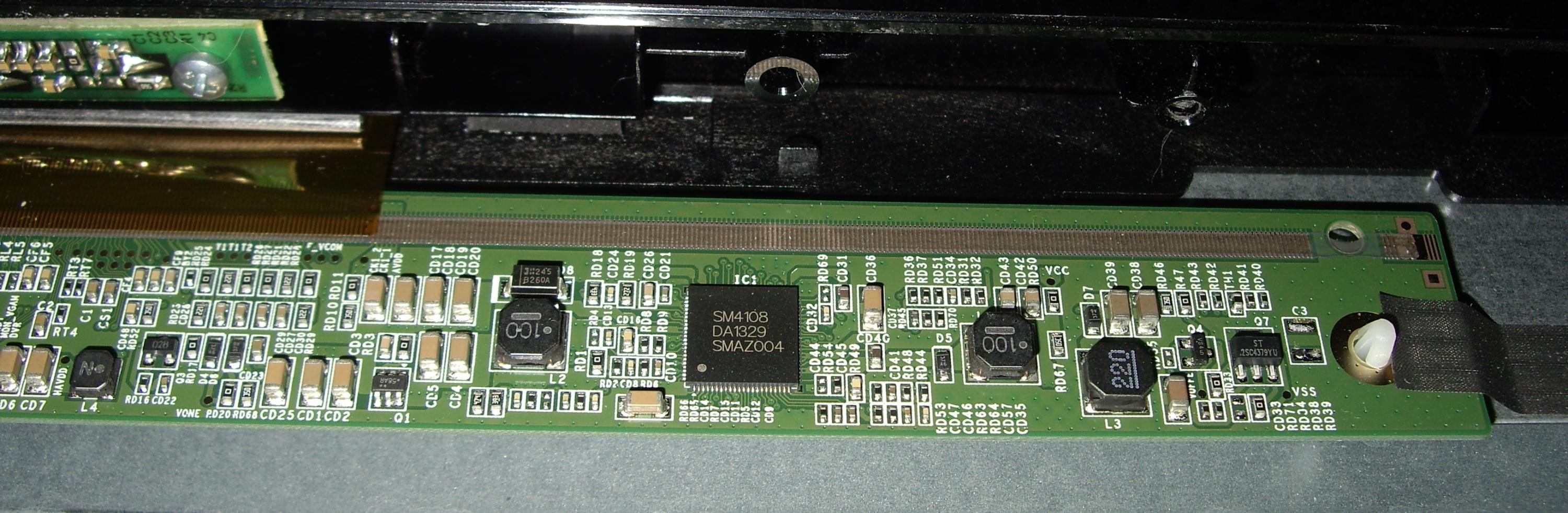

          Can i check something? The fuse does the job.
            do you get voltage on each side of that white fuse?
              Yes 12 volts on each side

                thats ok then hopefully reece will have a idea what maybe causing this issue now he knows it uses a VES315WNDS-01 panel
                        Dmm also just see if they get warm for a start.
                          I have checked the temperature.
                          Unfortunately, nothing is warmer than 18° C.
                          The TV responds to the remote control only on / off and the presets button. Presets make the backlight brighter and darker.

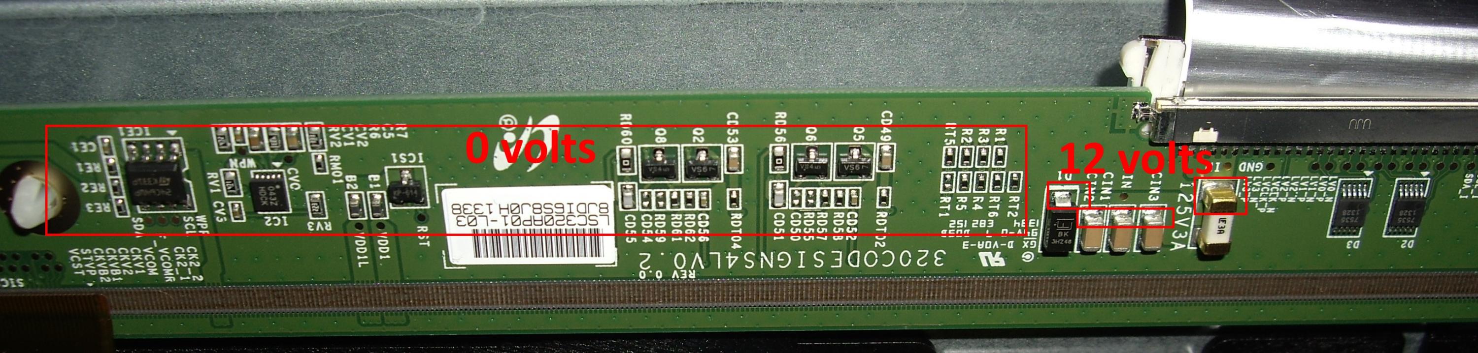

                            I've got behind the few parts on the right side and the two (t2 parts) only 0 volts...

                              Test for short circuits.

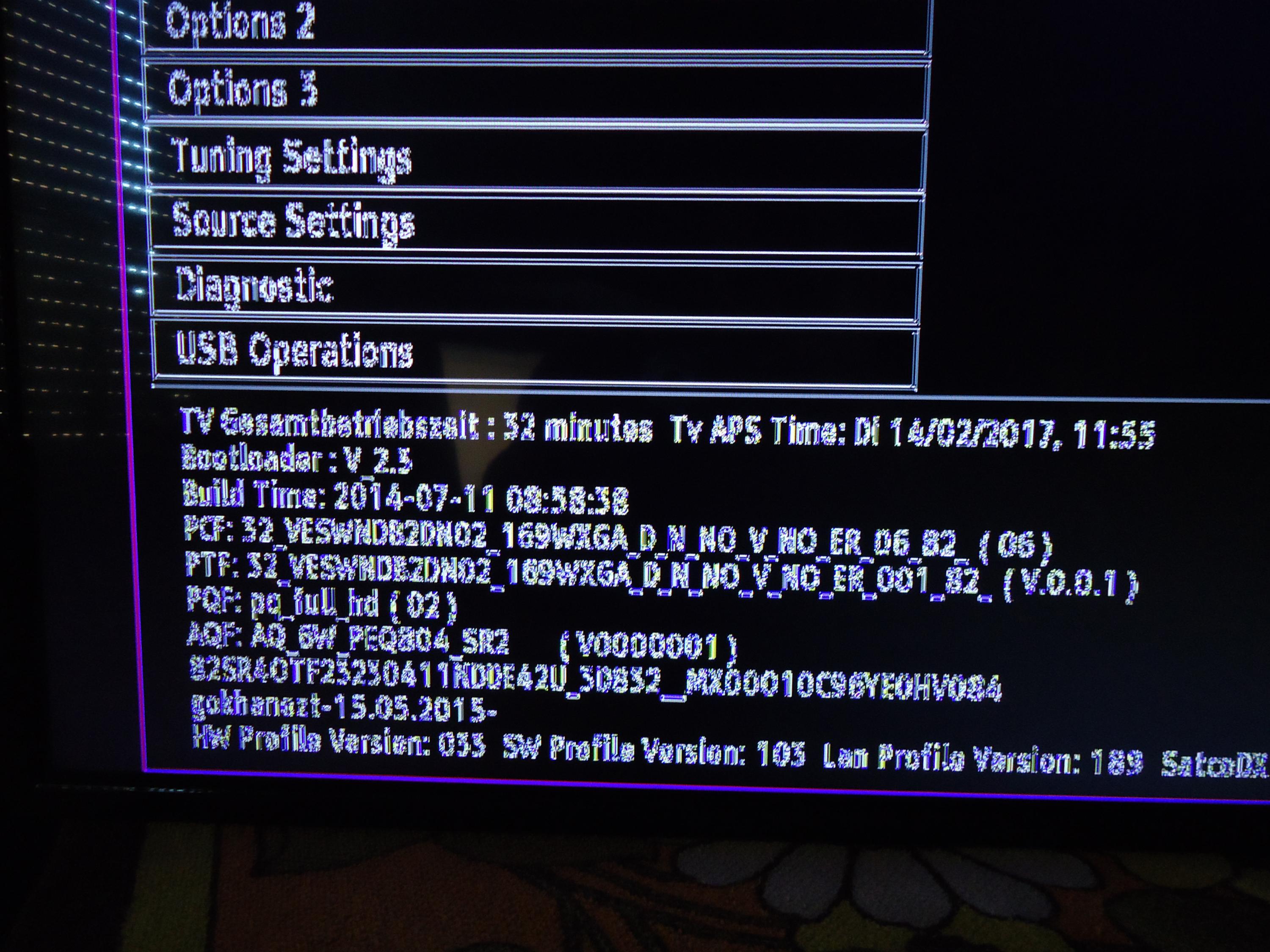

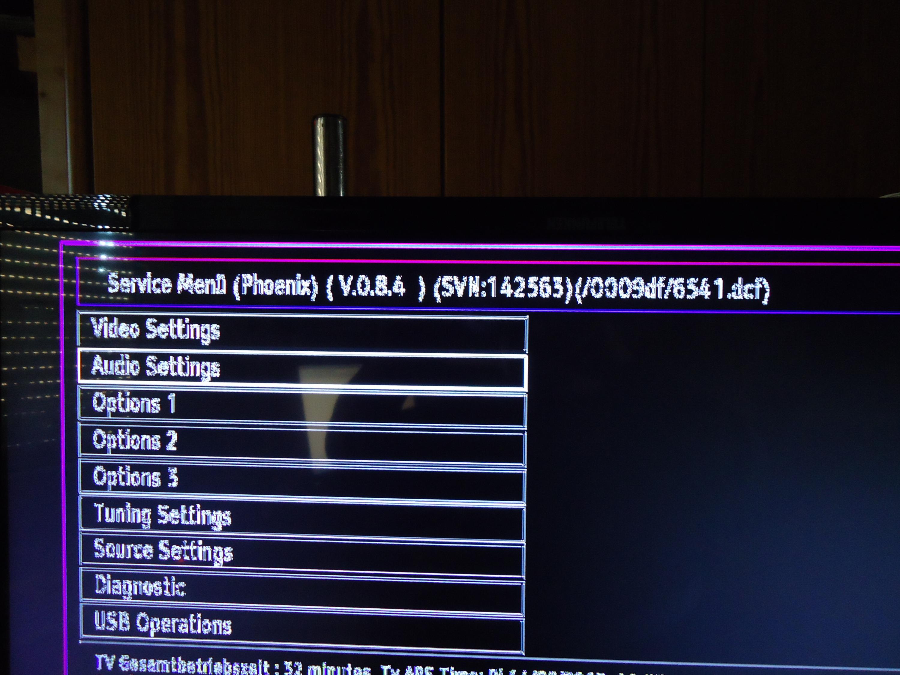

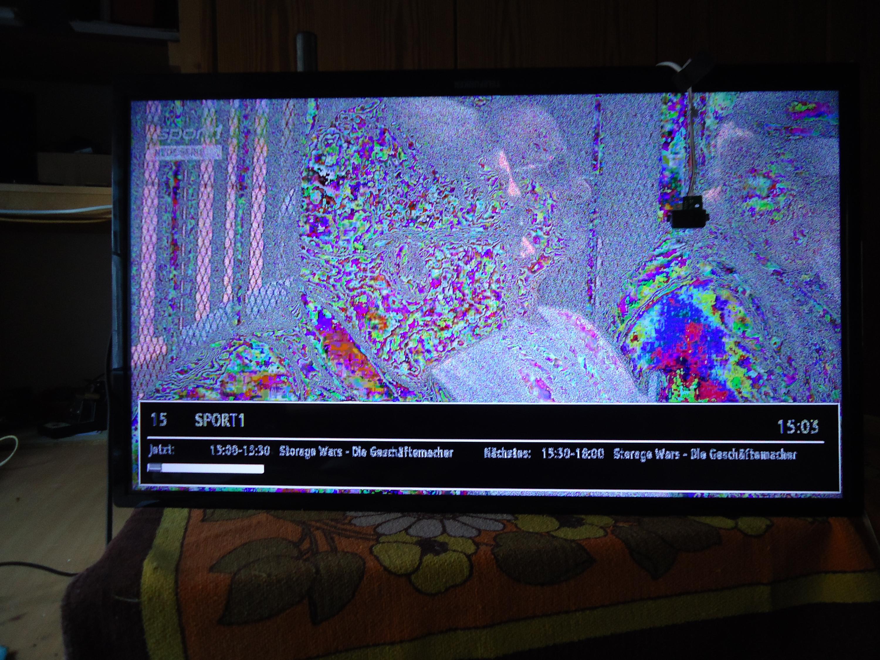

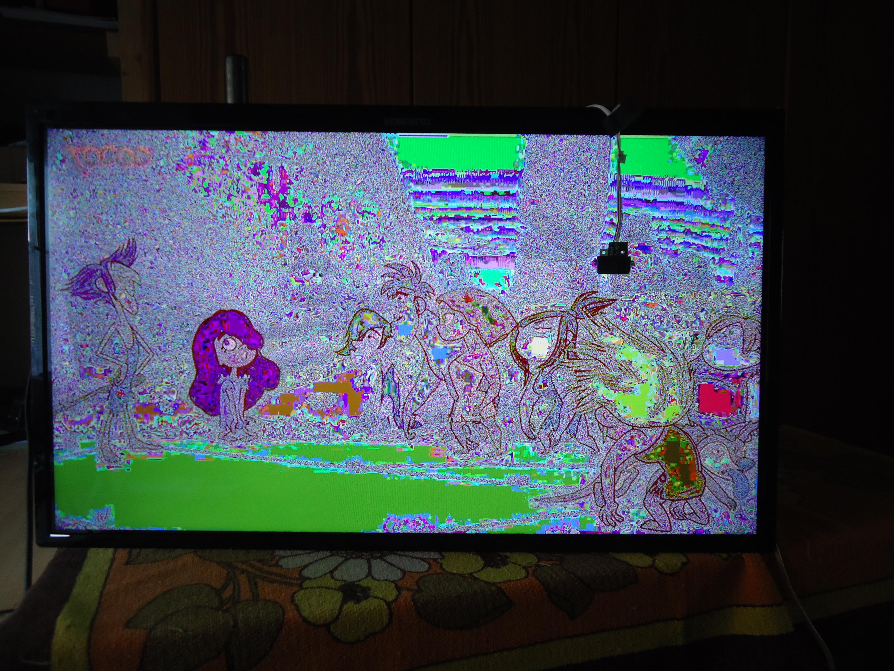

                                Vestel 17MB82S / Telefunken LED TV D32H278R3
                                i am new in this Forum.I am from Germany.My Problem:
                                I have an Telefunken LED TV Model: D32H278R3
                                The Motherboard Vester 17MB82 is broken.
                                I buy on Ebay an other Board from an Telefunken D32H278A3.
                                Now the Picture ist standing on the Head and the Picture ist very Bad.
                                Motherboard: 17MB82S
                                Power Supply:17IPS71
                                Panel:VES315WNDL-2D-N02
                                Here some Picture from the TV.
                                What can i do?
                                Who can help me,please ?
                                Greetings from Germany
                                Martin
                                  Main Bd Software is not a correct match for your T-CON Bd
                                      Who can give me the correct software?
                                      Which version?
                                        No one order the correct board.
