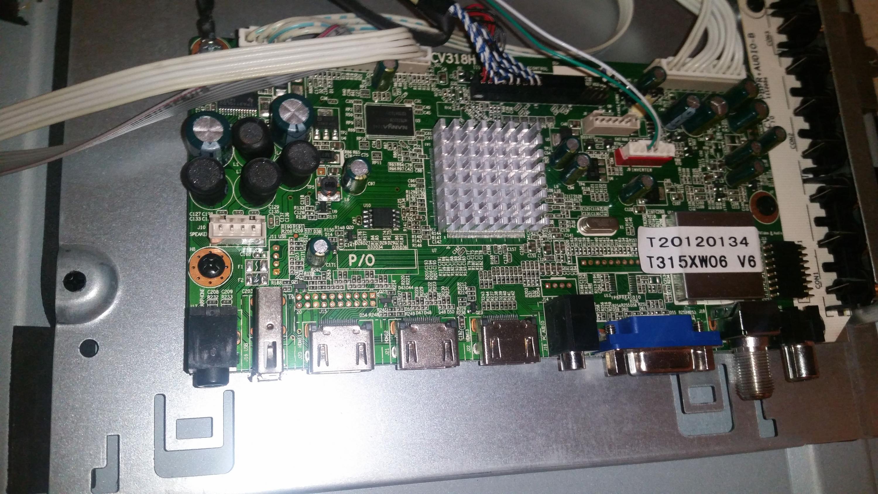

                        Hi lotas:
                        Here is SPI flash dump from 32" RCA RLED3216A. Mainboard is CV318H-X with MSD3391DS processor. The EEPROM at position U10 is Winbond W25Q16V.
                        The TV turns on, displays the RCA logo, then screen flashes entirely green for a split second, then clearly shows the channel number 2-0 in upper corner with static on screen (it is not connected to antenna), then resets itself continuously.
                        Please have a look at it and let me know if you can assist.

                          #1172
                          Re: Eeprom dump thread!
                          Originally posted by Unspun01
                          Hi lotas:
                          The core is whole, cut off the tail, try it.
                          • Unspun01
                            • Jun 2011
                            • 349
                            #1173
                            Hi lotas:
                            My 32" RCA model RLED3216A is now working after re-programming my existing EEPROM IC with your "fixed" .BIN file.
                            Thank you for your assistance!
                            When you "cut off the tail", what does deleting this information do? In the "fixed" file, it looks like you deleted everything including and after offset 0018F504h? How did you determine where to delete the remainder of data?
                            This offset is certainly specific to this file and may not apply to other files, but I think it would be great to know how you picked this location?
                            Thanks again!
                            • lotas
                              • Jan 2016
                              • 4643
                              • Russia
                              #1174
                              The core itself is in the dump, this is its software, panel, remote ... and eeprom (the tail that I cut off) it stores the settings, after deleting this eeprom section, when you turn on the TV for the first time, the processor itself prescribes the initial settings, like from a store.
