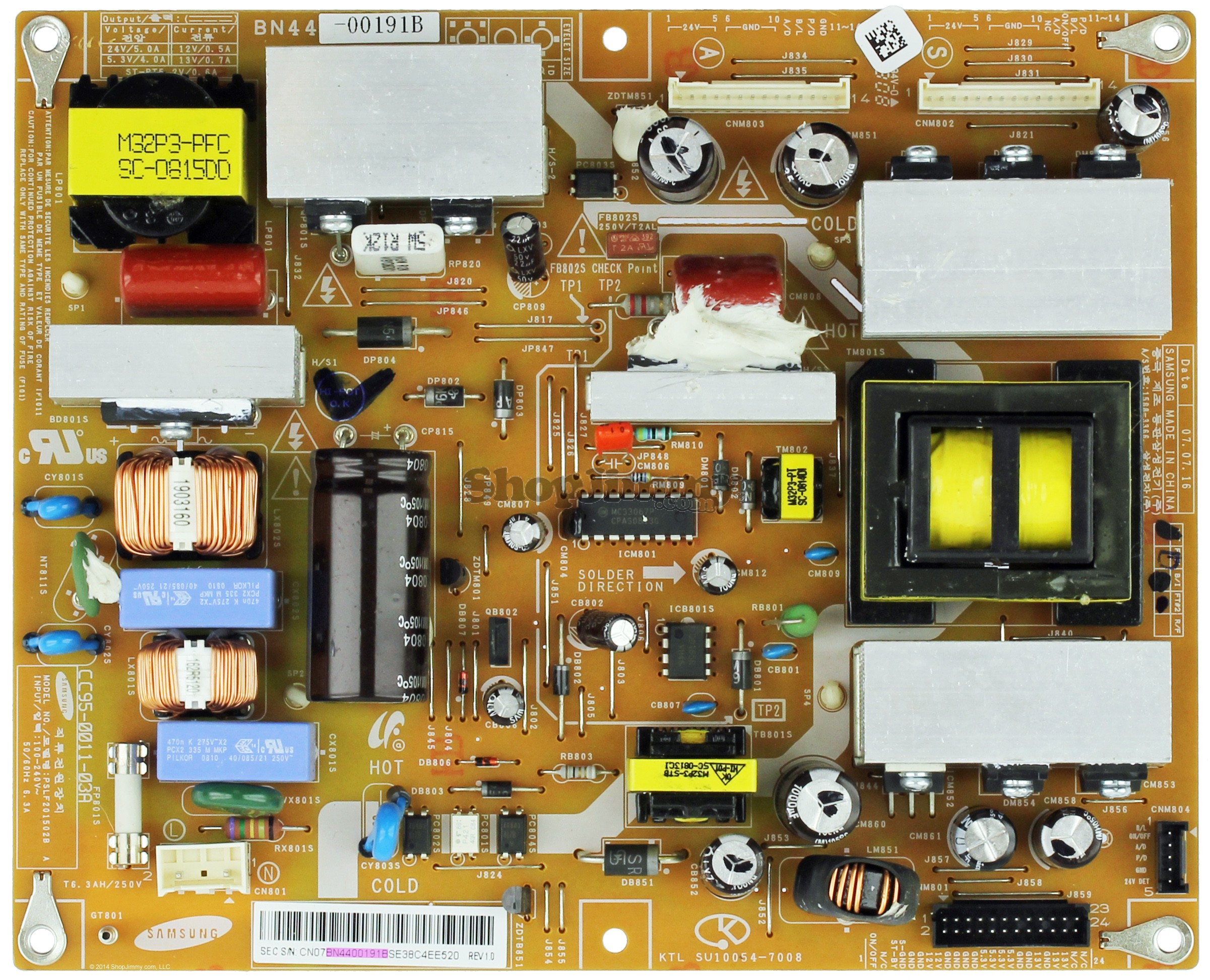

    I got this and all I was told was that one day it did not turn on, no other details were provided. See attached for initial images of PSU when I received it. As you can see from the photos I had to fix the obvious things to even try to do more troubleshooting. I am curious why these failed so catastrophically.
    I have highlighted the parts that I have already replaced in yellow and the ones that I believe need to be replaced in blue in the attached schematic.
    First I replaced
    FP801s fuse
    CB806 capacitor

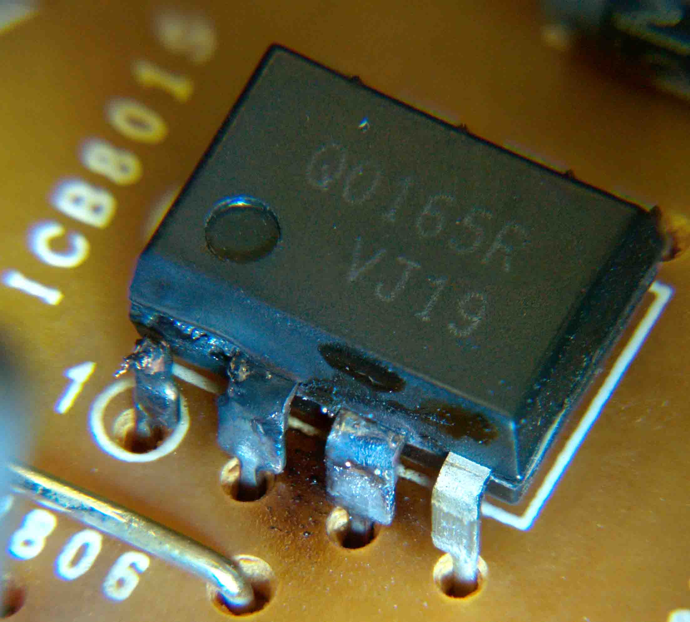

    ICB801S Q0165R (I replaced it with the SOP instead of DIP and made some legs to go through the board, not pretty but I hope effective, not pictured)
    DZB806 Z02W9.1VY zener diode
    DB806 1N4148 diode
    Dim bulb tester showed a short and I found and replaced
    QP801S 11N60C3
    Plugged it back in with 100W bulb and the bulb flashed bright about 4-5 times. After that and on subsequent power ons nothing. Tried it without the dim bulb tester and fuse did not blow so I guess no dead shorts. But in both instances I noticed a smell of something getting too hot. The IC getting too hot is ICM801 MC33067.
    At that point there was only a standby voltage of 5.2V on pin 3 of CNM801, main cap CP815 shows solid 158V, voltage on ICB801S is 8V if I can recall, no other voltages on that connector and ICM801 does not get hot instantly. However, this only occurs when CNM801 is disconnected from the mainboard.
    When CNM801 is connected to the mainboard all of these voltages continually fluctuate and ICM801 gets hot instantly(5-10 seconds), I shut it off at around 180°F.
    Further research led me to find that QB802 KD1691 is shorted and ZD805 Z02W15VY is open. I have not replaced those yet.
    Currently, checking pin to pin on ICM801 pin 4-13-14 have continuity. I desoldered those pins to isolate it from the rest of the circuit and they still have continuity. According to the block diagram of the MC33067 it would seem that pin 13-14 continuity means that it is bad and needs replaced. Is that correct?
    Currently, checking pin to pin of ICP801s FAN7530, 4-6 have continuity but that seems to be due to the resistor RP820 having low resistance and my meter beeping below 40 Ω, as there is not continuity between those pins when the resistor is removed.
    Correct me if I am wrong but I have read that the order of things to check out for the PSU is first I need standby voltage then the PFC section turns on and boosts the voltages then the secondary voltages are created, in this case I assume it is from the ICM801 MC33067, correct? If this is correct I would like to be able to know if ICP801s FAN7530 is good, if possible, before replacing them. Not knowing about SMPSs I do not know how these two interact.
    I have read about shorting the Standby and ON/Off on the connector to the mainboard to see if the PFC ICP801S is working, but with the other problems I do not know if they should be fixed first or if it can be done with out damaging other components. Knowing the components I mentioned above probably need replaced is there are way to test the PFC IC without them functioning or do they need to be replaced first?
    Does the fluctating voltages when the CNM801 is connected to the mainboard, but solid when not point to a mainboard failure or do these things on the PSU need to be fixed before determining if the mainboard is also at fault? It makes me wonder about things I hear about power surges coming through the HDMI and causing failures of components on the PSU and perhaps damaging the mainboard in the process.
    Any assistance is appreciated. Thank You
