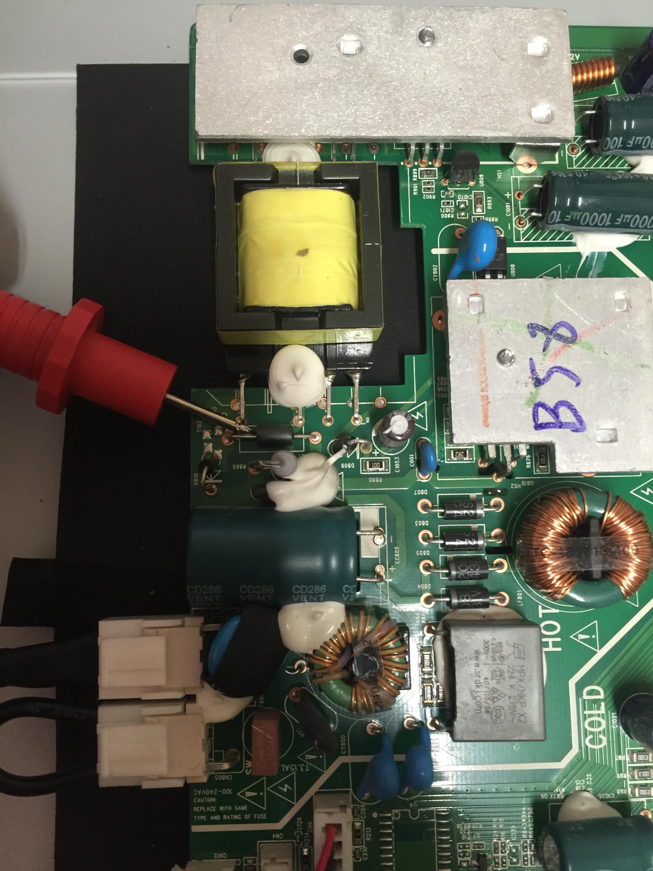

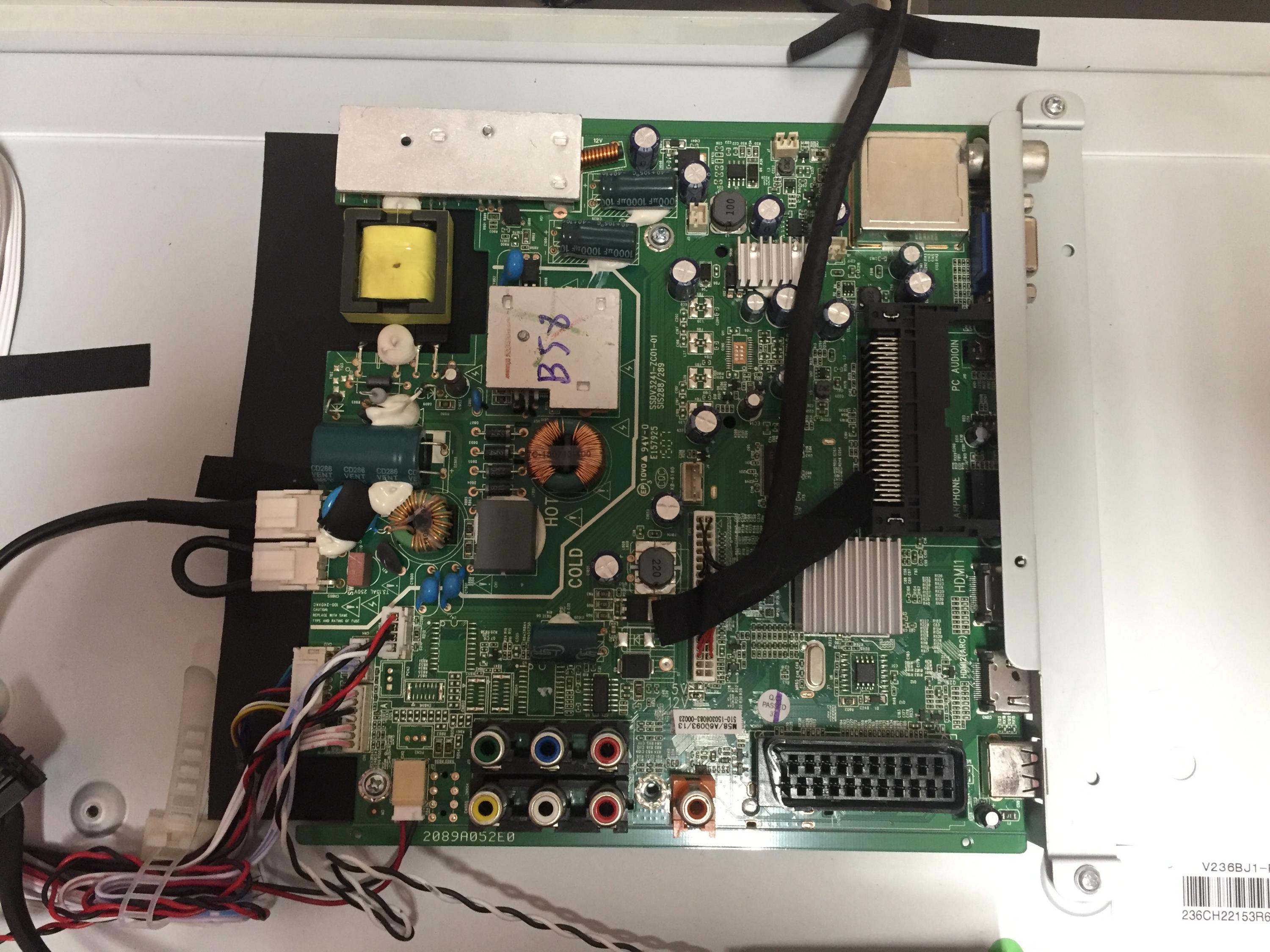

                                    I have been given a Polaroid SSDV2311-I1-D0 TV with this fault of turning on for between 20-30 seconds and turning off while the light flashes and no response to controls.
                                    The panel in this TV is V236BJ1-P01 (Chimei-Innolux).
                                    The mainboard is a SSDV3241-ZC01-01. Additional markings on board SIS288/289. White sticker also contains M58/A60093/13.
                                    Could someone give me a firmware to try please?
                                    Also I don't have a universal remote handy at the moment, so would be nice if I don't lose that functionality.
                                    Also what is the part I'm pointing at with the probe, there is a white box printed underneath on the PCB. I want to identify it so I can figure out how to test it.
                                    Thanks.

                                        The part you are pointing at looks like a ferrite bead
