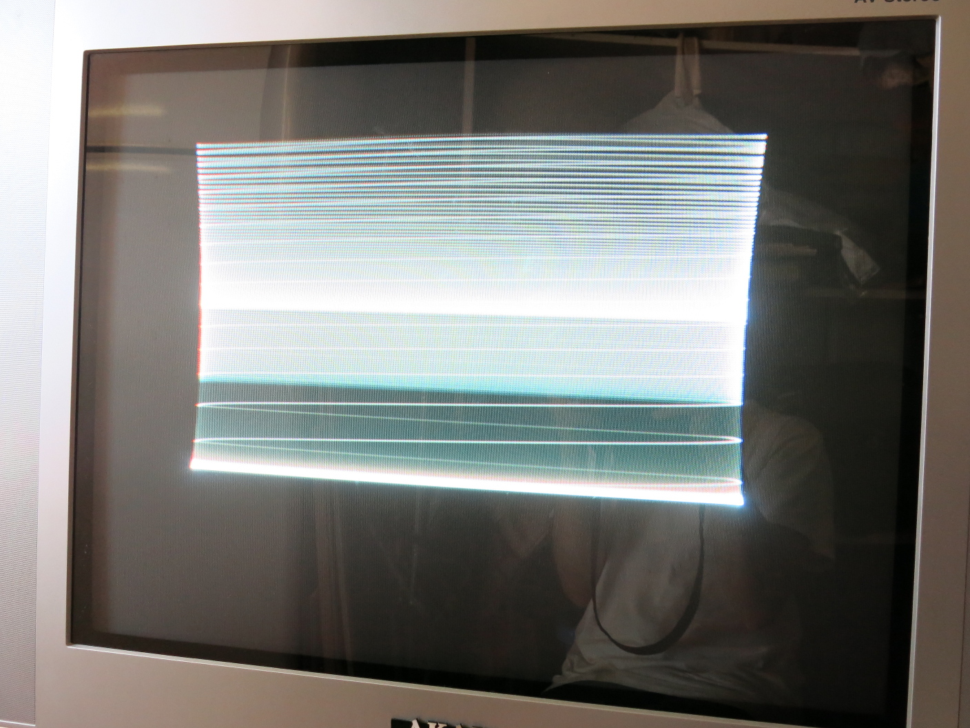

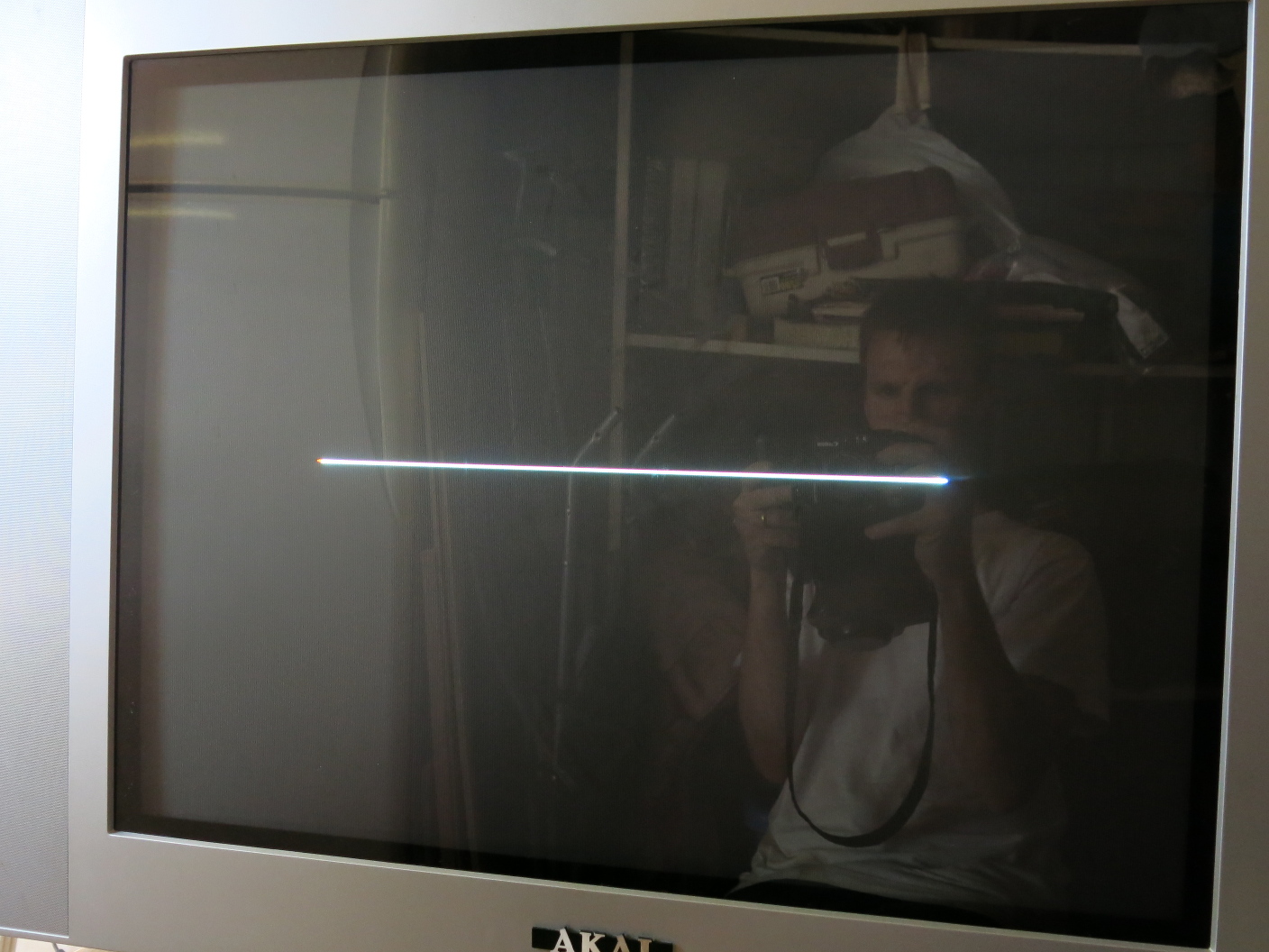

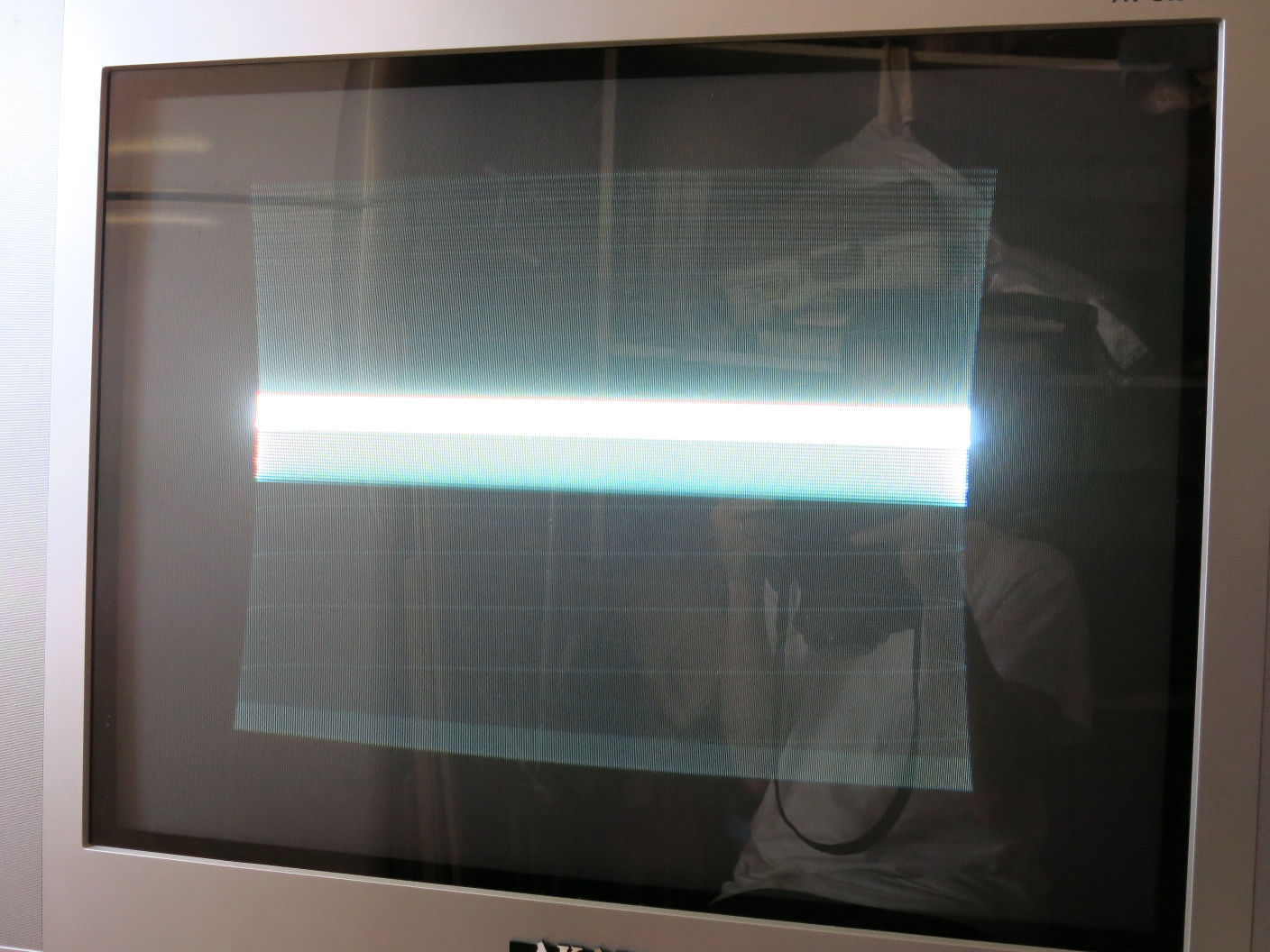

    Hi Guys, trying to look into a problem with my Akai CTV29TA TV when pressing the remote standby button.
    If the TV has been on for a few minutes and it is well warmed, then if I put it into standby, I get this 'box' effect, then the display goes down to a single raster line that very slowly shrinks inwards.
    Takes around 30 seconds to fully go into standby mode.
    The operation for the rest of the TV, including viewing is perfect.
    I am guessing the trouble is perhaps around the flyback unit, or surrounding caps.
    I have reflow soldered every large to medium solder point (including everything around the flyback).

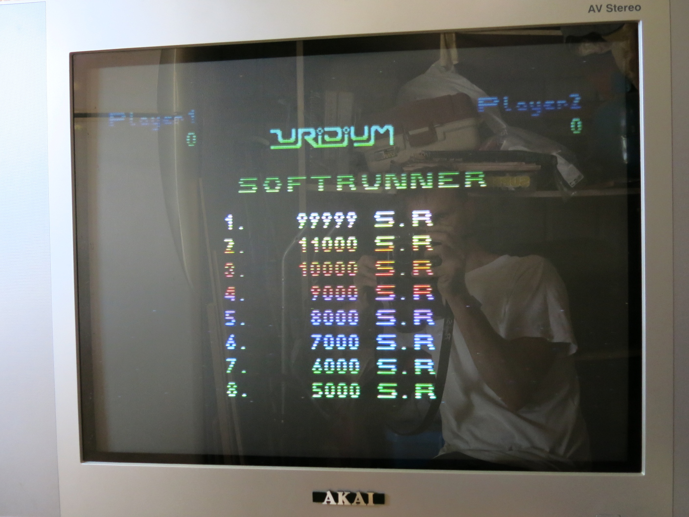

    Included are some photos of good operation, the effect when going to standby, plus some shots to show the power area:
    Running Uridium on the C64. All fine.

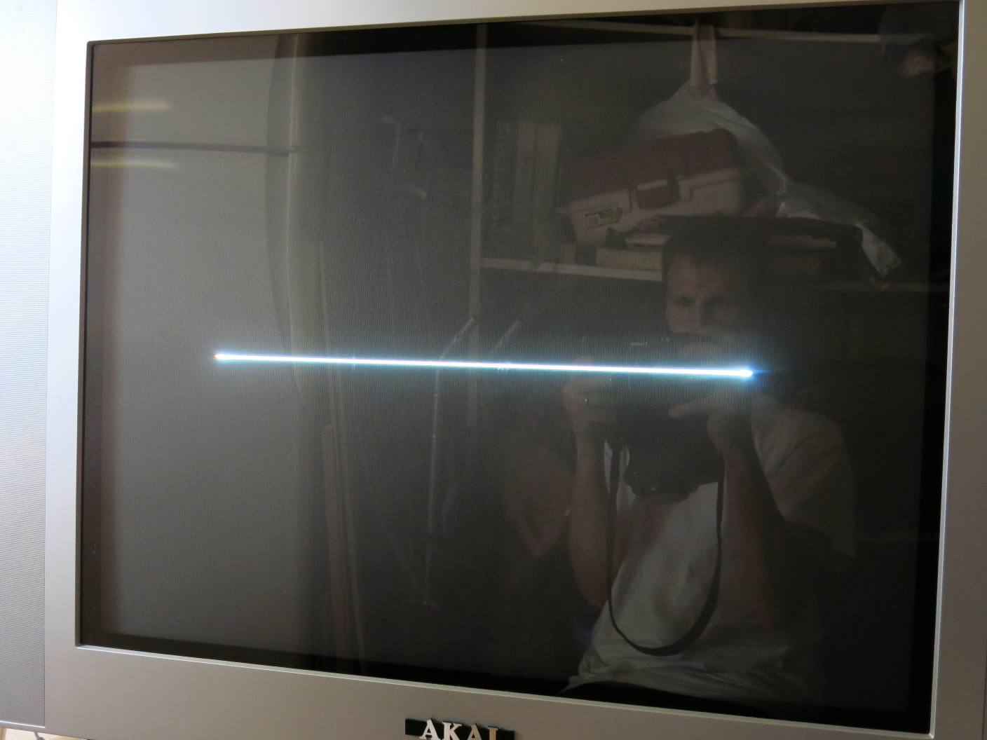

    When first going into standby mode:
    20 seconds later...
    10 more seconds later...

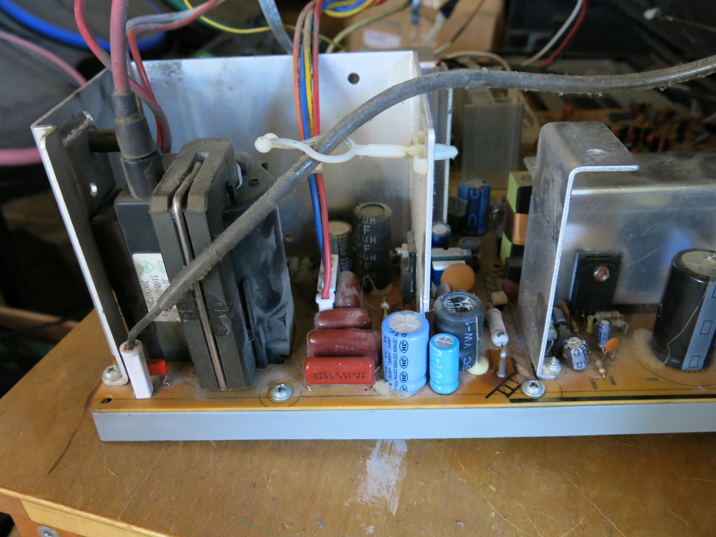

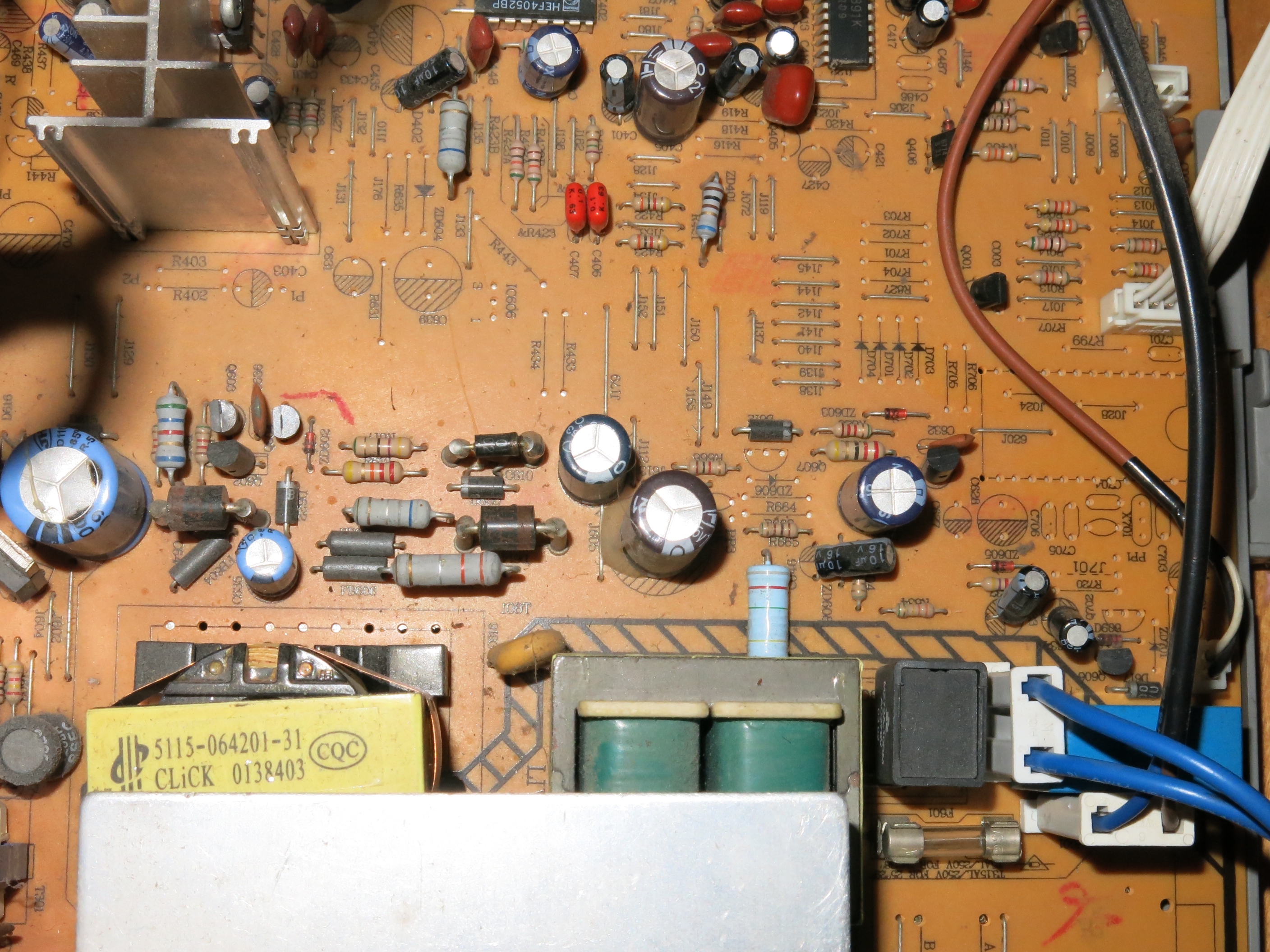

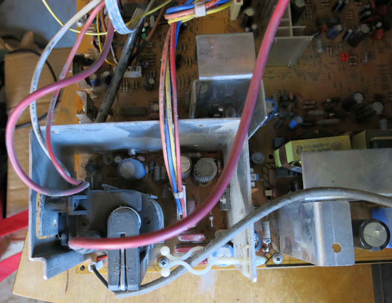

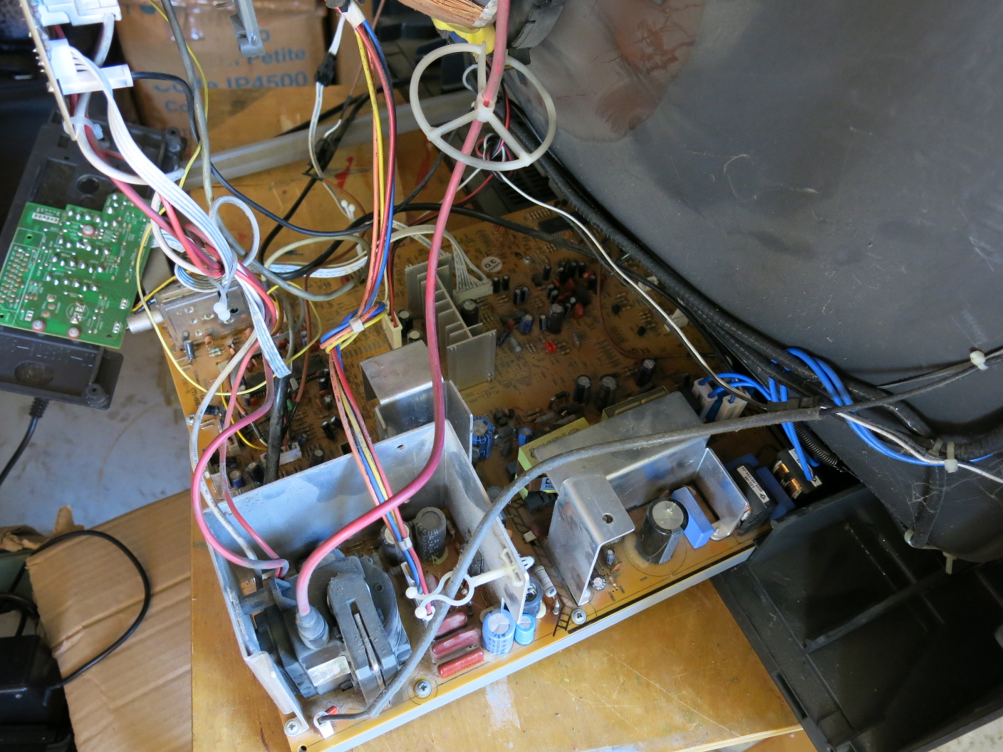

    Shots near the power and flyback:
    I'd be grateful if anyone could recommend an approach to fix, or let me know the terminology for the effects that I'm seeing so I can research solutions.

      It looks like the drive circuit is not being turned off, Its still supplying drive signals to the horz. vert. output circuits while the b+ to the outputs has been turned off and slowly bleads down.
      Its posible the relay (if used) contacts are stuck closed, I've seen similar effects when that happens.
      Try giving the relay a couple taps and see if that changes what happens
      Got the service manual or schematic?

        Hi llonen, when pressing the switch at the front of the TV, it is an instant off. So it doesn't have the same odd effect.
        Hi R_J, thanks for that. I'll try giving it a tap or two. I'll look around for a schematic.

                Are you saying there are two switches on this tv, one main and one standby?
                when you operate the standby switch (the one where the problem occures) Can you here a relay click? If you can I would check it's contacts, the could be stuck closed
                When you push the standby button to turn off the tv the main micro turns off video and signal processing, there is usually an output from the micro to turn off the main power supply, this is usually done with a relay, if the relay does'nt open the main power supply keeps running but since there is no video signal or drive signals the raster stays on untill the b+ drains off.

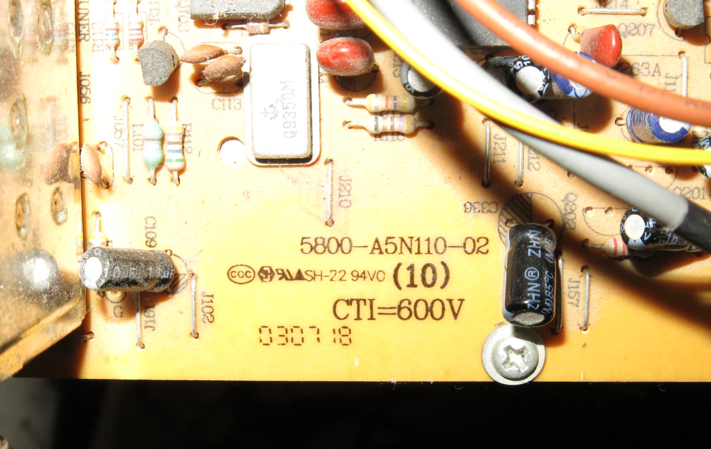

                Check the Chassis for a number, I suspect this was made by another company

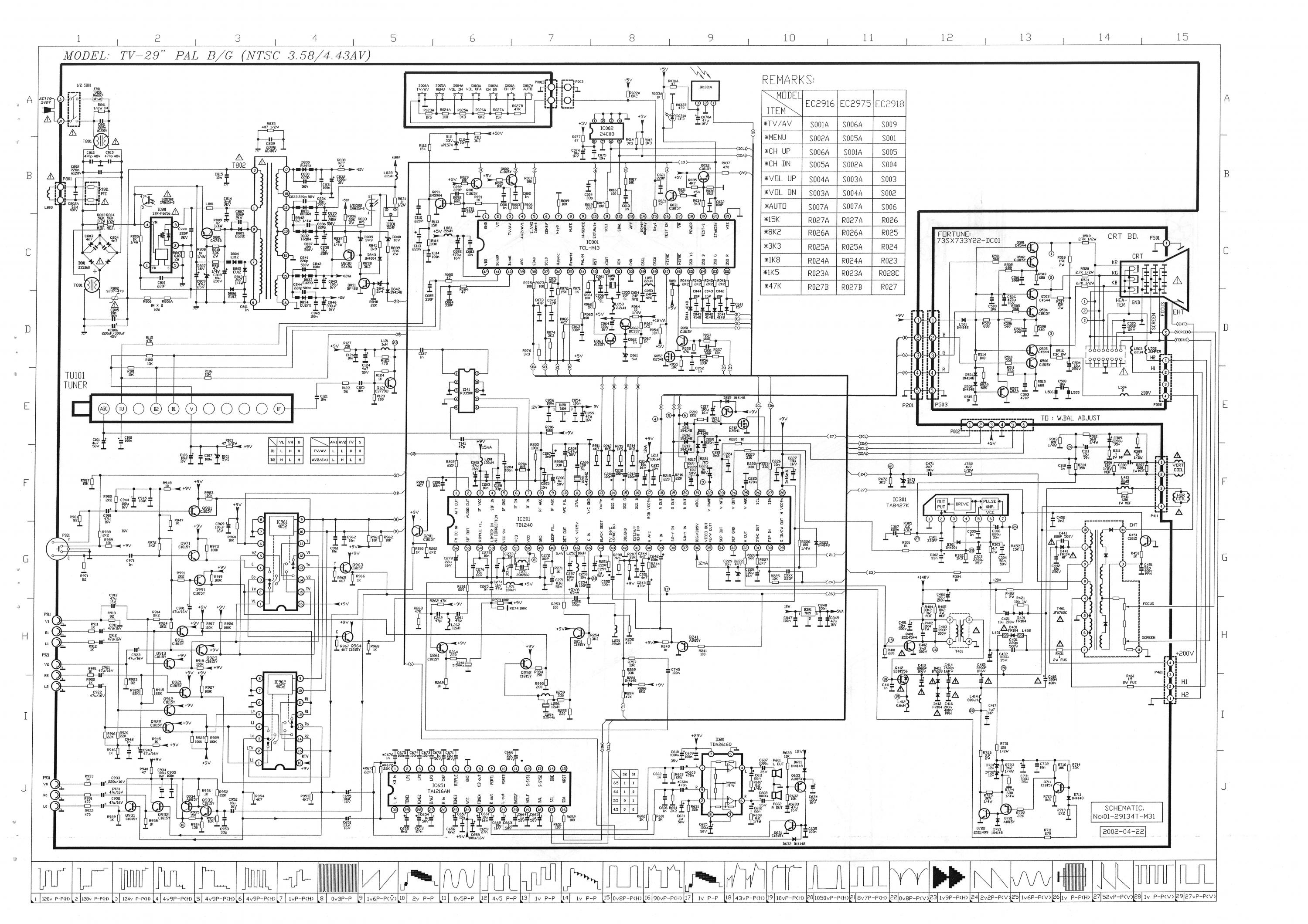

                I found this schematic, It does'nt use the relay to turn off the power supply but it uses an opto coupler. But I think its different then yours

                  Hi R_J, sorry I meant there is only one switch at the front.
                  Pressing that is instant on or off. The only way to come in and out of standby mode is with the remote. If the TV is off, the remote cannot control the TV.
                  I am impressed you found that schematic! Do you mind if I ask if you found that publicly or is it via a repair subscription? (oh it might be different ok)
                  This might confirm what you said: When going to standby, I don't hear any relay. The closest thing to a relay sound is only when powering on or coming out of standby, there are the two usual CRT "clunks".
                  Couldn't find any other chassis number or anything on the main board. The tube was made by LG Philips. But it probably matters little if you have the schematic.
                  This might also help, during this phase:
                  ... there is a whining noise, but the TV becomes silent by this stage:

                    I found that schematic at eserviceinfo, its for a CT-C29nnes
                    That whining I suspect is just the horzontal circuit. as the voltage is dropping the frequency is also dropping and thats what you here.
                    So that switch on the front is a mains on/off switch (I suspect) so the remote just puts the tv into standby by turning off the main power supply, leaving the standby power supply running.
                    so for some reason the main power supply is not turning off like it should. If it does'nt use a relay to do it then it must be similar to this schematic where it uses a transistor to turn an opto coupler on and off which turns the primary (in this schematic) ic on and off
                    Without the correct schematic I'm only guessing

                        I also found this schematic
                        Check and post some of the ic numbers from the power supply circuit and maybe the micro and video proc. ic's
                        Also look on the pc board for any chassis numbers, labels sometimes they are on the side of a heat sync or the tuner

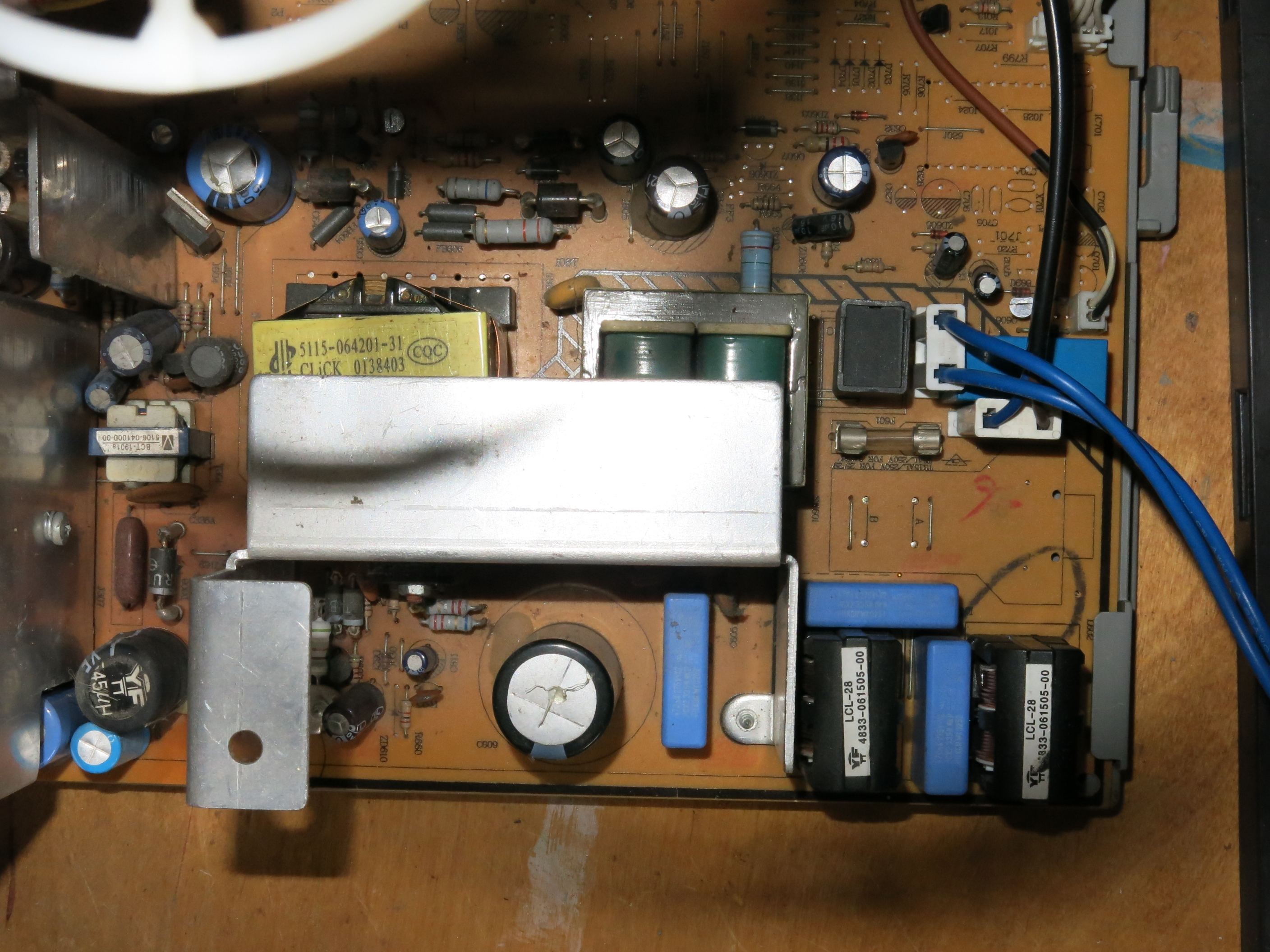

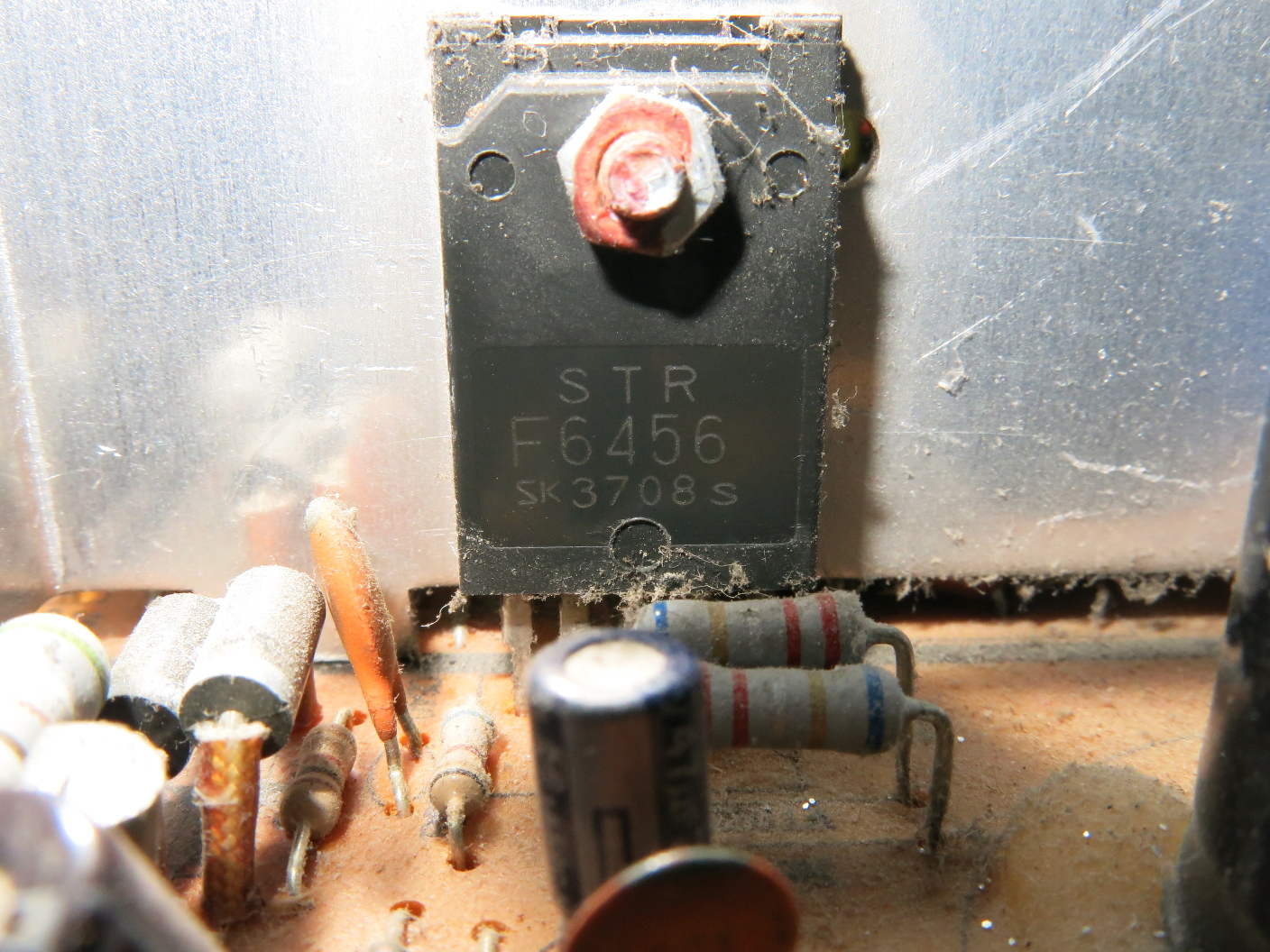

                              The power supply ic is mounted to the heatsink by the large capacitor

                                Also a couple of shots of the power area for reference:
                                And the mainboard numbers:
                                Though I realise the CTI-600V is more about the board wafers. Not sure if any other number is the board model.

                                  The problem is the vertical deflection ic

                                    Thanks, R_J and ducky29. Looks you guys nailed it.
                                    It was the power supply / vertical deflection ic.
                                    It led me to this link:
                                    http://www.riddledtv.com/journal/Vertical/
                                    Now, I had already reflowed the solder on these pins before, so this time I removed most of the solder with a braid and added new solder.
                                    Fired up the TV and let it run for a while before going into standby.
                                    Couldn't believe my eyes that it went to standby cleanly.
                                    The only thing... we're running around 10 degrees cooler today. So I'll keep an eye on it as the summer heat returns, but I think it's pretty well over.

                                        Glad you got it fixed, It looks like the chassis # is 5800-A5N110-02, one of these might be a closer schematic, for next time.
