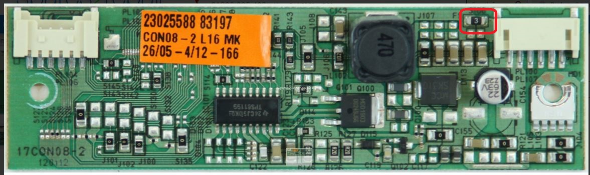

      Which Board has the LED Driver and inverter on then?. Where are the connections to the LED's? the main board only has a ribbon type cable from it.
      Thanks David.
        Re: Toshiba 19BL502B replaced diode worked, now not working
        https://www.badcaps.net/forum/attach...1&d=1484649140
        Small green board on the top right is the LED driver board, this not CCFL backlights system so there is no Inverter board.
            There's a fuse marked in red box which would be worth checking. Also check all the 0 ohms resistors.

              for some reason i thought this was a ccfl set too but as the others say check the fuse and the zero ohm resistors then we can advise further
                Since that LED driver has boost converter, so check the DC in at the fuse and DC out to the LED when BL-ON is present.

                    #29
                    Many Thanks for your help.
                    I have 27.2 volts both sides of the fuse. Have checked all zero resistors with multi meter and have continuity across them.
