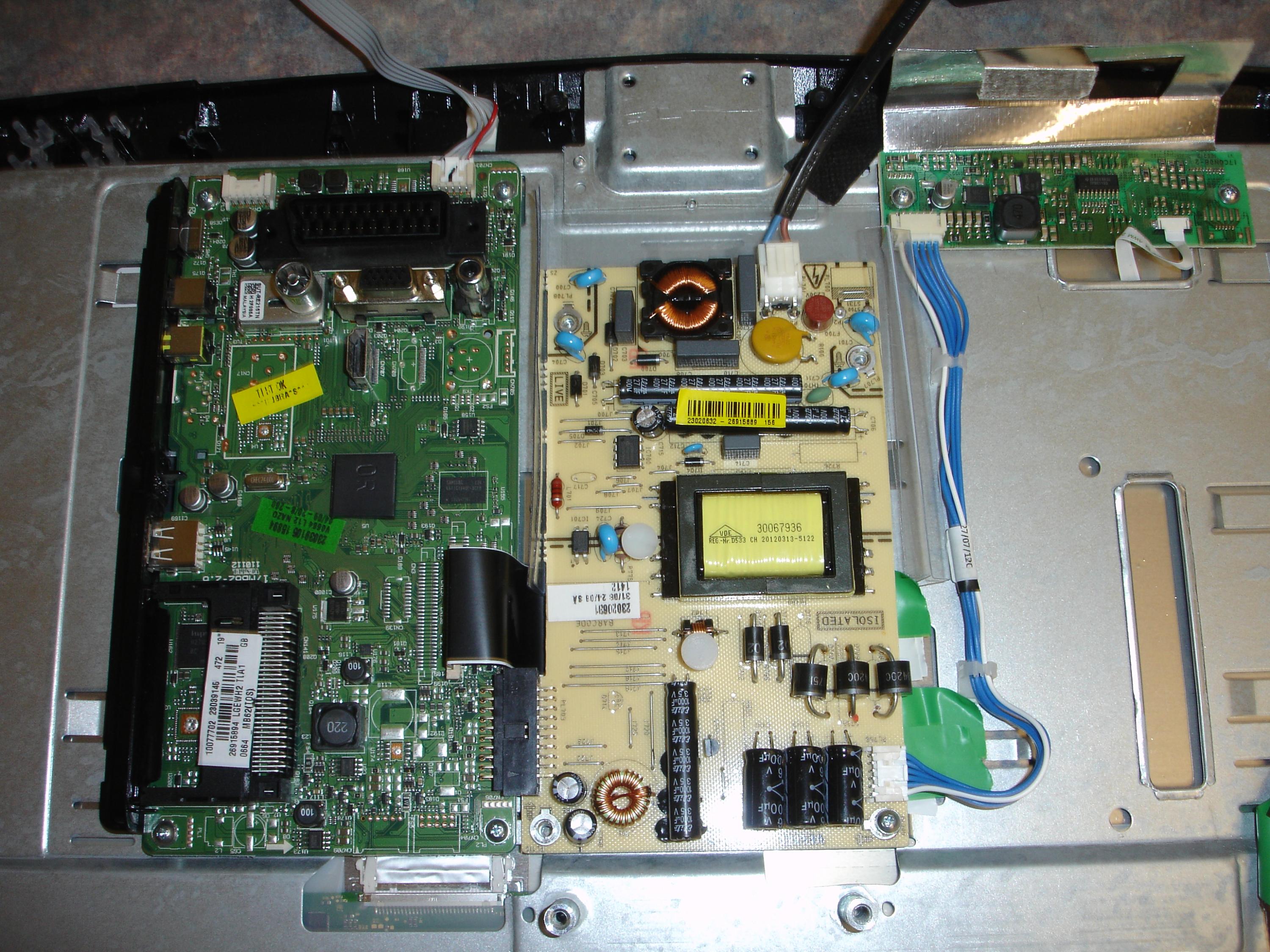

Toshiba 19BL502B replaced diode worked, now not working
  • David-OLW
    • Jan 2017
    • 26
    • United Kingdom

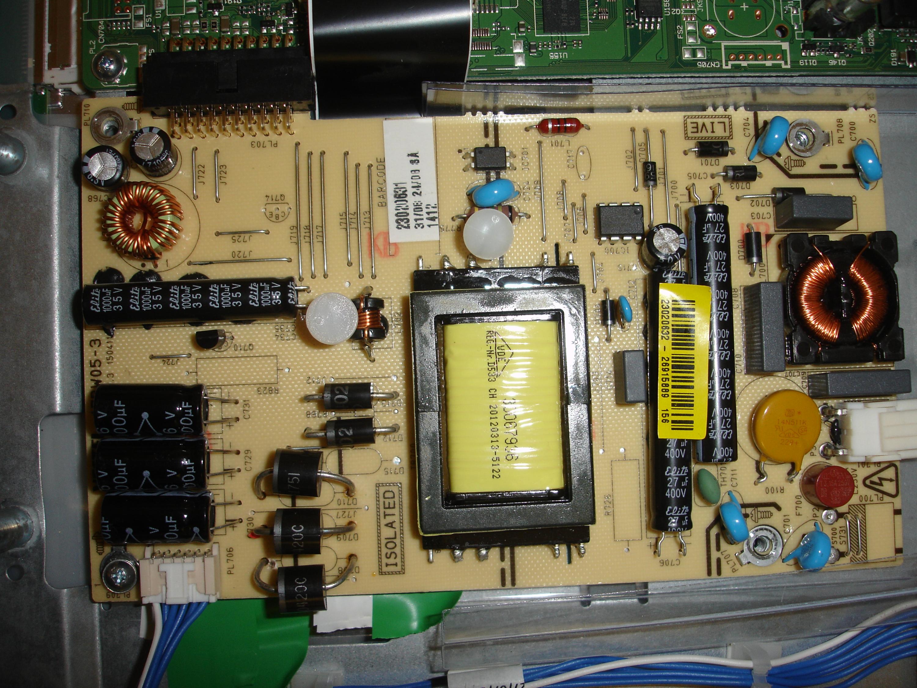

    Toshiba 19BL502B Main Board 23039106 PSU Vestel 17pw05-3 150411/23020632
    Was Dead, found D709 centre diode shorted, removed put on briefly on and worked ok. Replaced all 3 diodes, RS did not have UF5408 in stock so used G1751. Worked ok for couple of days, then not working green light on but no picture. There was a smell of burning. Found the 3 diodes very hot and 2 Capacitors were warm C729, C730. Replaced the 3 16 volt 1000ยต capacitors C729, C730, C731, but still not working, goes from standby to ON green steady light but no picture.
    With Main Board disconnected Volts on PSU 11.5 DC Volts/24 DC volts, with Main Board connected in standby volts on PSU 8.69 DC Volts/20.8 DC Volts, turning it on 11.8/33 DC volts, and the 3 diode get very hot. To me this would suggest the Main Board is drawing a lot of current, although the 12v DC is low, and why does the 24 volts go up to 33 volts.
    Any advice would be greatly appreciated.
    Thanks David.

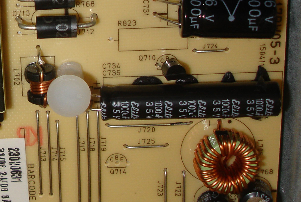

    Re: Toshiba 19BL502B replaced diode worked, now not working
    The diodes do not looks like suitable replacements. The UF are ultra fast switching diodes and the G is a general purpose diode, You need to replace with suitable ultrafast diodes.
    Also check and or replace C734, C735

              +1, wrong type of replacement.
                OK have replaced diodes with UF5408 and have replaced one capacitor C734/C735, there is only one position for a capacitor here, although marked C734 C735 see picture.
                I still have only 11.29 DC volts and 23.89 dc volts but the diodes are not getting hot now, green on light comes on ok but still no picture.
                How do I now trace the fault.

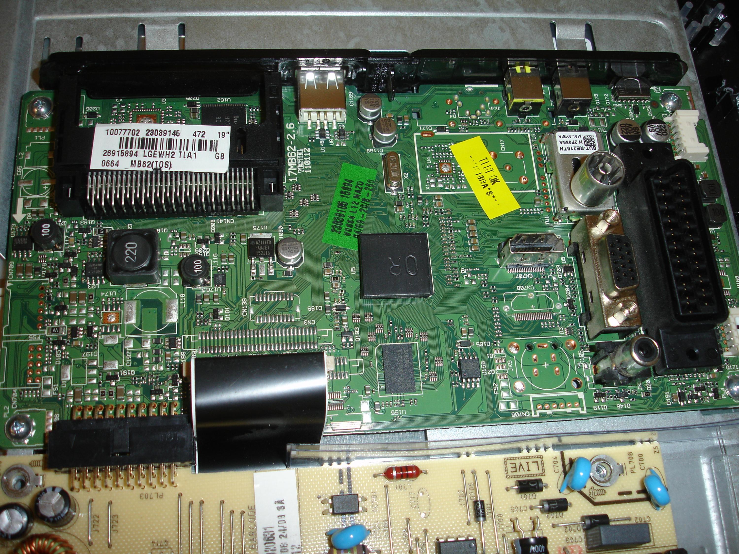

                            on plug pl706 on pin 4 what voltage do you get on there with the set turned on as its for the bk lights
                            On Pin 4 I have 0.23 volts, I am only measuring this with a multi meter, if it is PWM should I look at it the scope, should this be higher.
                            On the Diagram the only other place PWM_DIM is shown is on the Pin !3 on Main Board connector, does this signal come from the main Board.
                            Pin 1 and 2 27 volts
                            Pin 3 3.04 volts
                            Pin 4 0.23 volts
                            Pin 5 and 6 Ground
                            Thanks for your help
                            David
                              that seems low to me for a back light command voltage i wonder if you have a mainboard issue?
                              Edit just found this thread
                              this toshiba thread may help his back light voltage was 2.3 volts so maybe you do have a bad mainboard
                              https://www.badcaps.net/forum/showth...estel+17pw05-3
