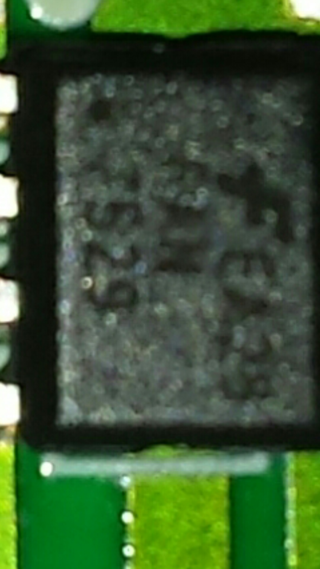

        When the backlights go "off" do you still have audio and IR control (Volume up and down).
        If you do can you measure what voltage you have on the power supply connector for Backlight on.
        What is the IC number on IC8512
          #44
          Re: Vizio M320SR turns off after logo
          Yes I still have audio and full menu access just with a flashlight.
          Backlight on connector , isn't this the connection I have previous tested ?
          IC8512 is fan7529
            #45
            Thanks,
            All good so far.
            Audio and picture but no backlight.
            So need to concentrate on the dropping out backlight only
            So is the ON/OFF dropping to 0V. This is supplied from the mainboard.
            I'm trying to find what IC is the Led driver and it's not the FAN7529 or the A6069H
            What other IC's are on the board to try and locate this driver.

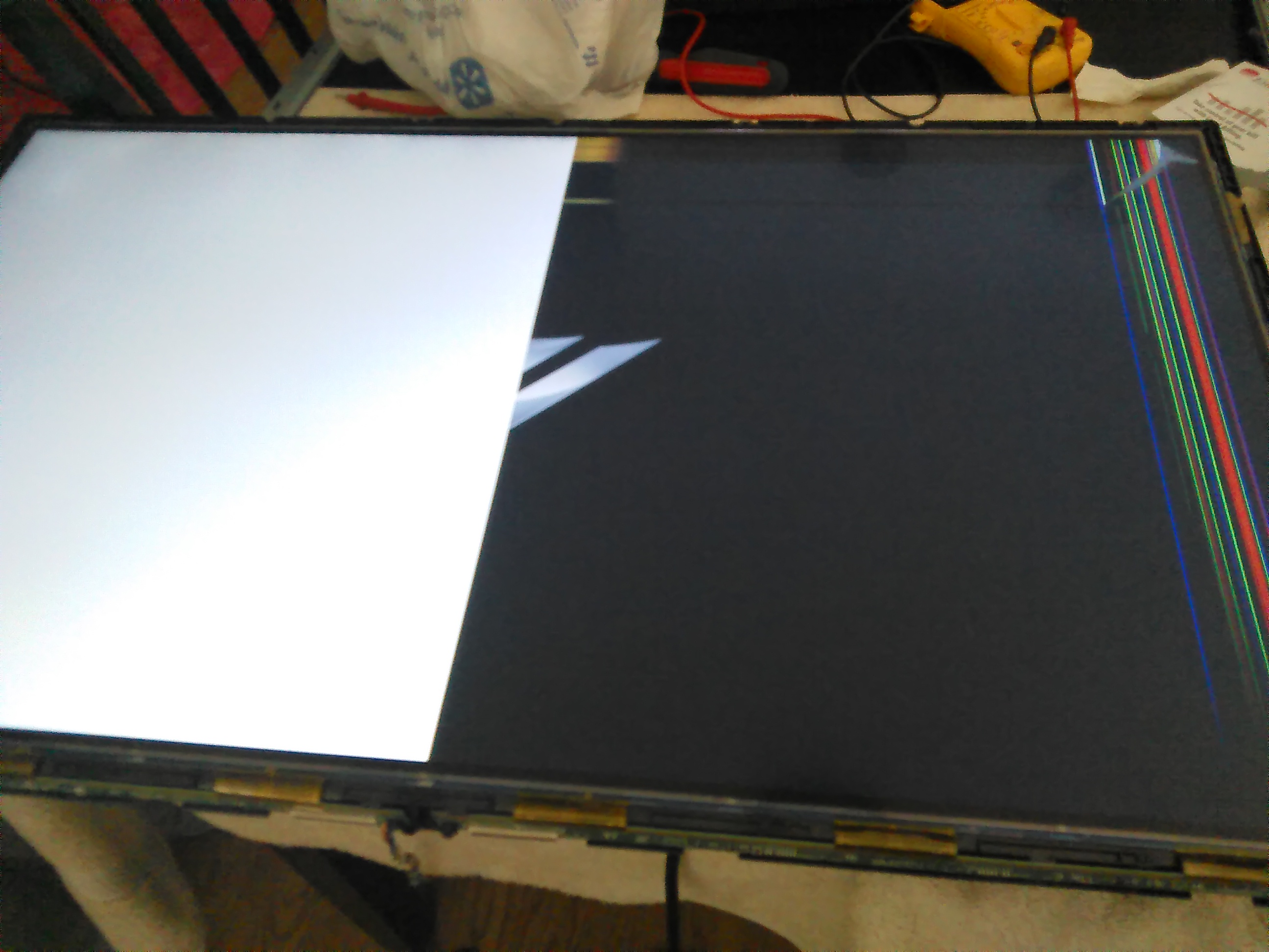

              Well have a new problem now. Put the tv back together and I know have a vertical rainbow on the right side of the panel. I was super careful and the process was easy so I have no idea what caused this. Might just be time to purchase a replacement. What could have caused this ?
                #47
                Disconnect the ribbon cable from the tcon going to the panel and re-insert it carefully.
                You flip the tab cover lever upwards to release the ribbon from the tcon connector and push it back down when the ribbon is correctly inserted.

                    #49
                    Well it's toast. There's a hairline crack in the corner of the panel. Like I said I was super careful so the only thing I can think happened is maybe one of the panel bracket screws was tightened too much.
                    Thanks for all your help I learned a lot. If I ever need to service a TV again I definitely feel educated.
