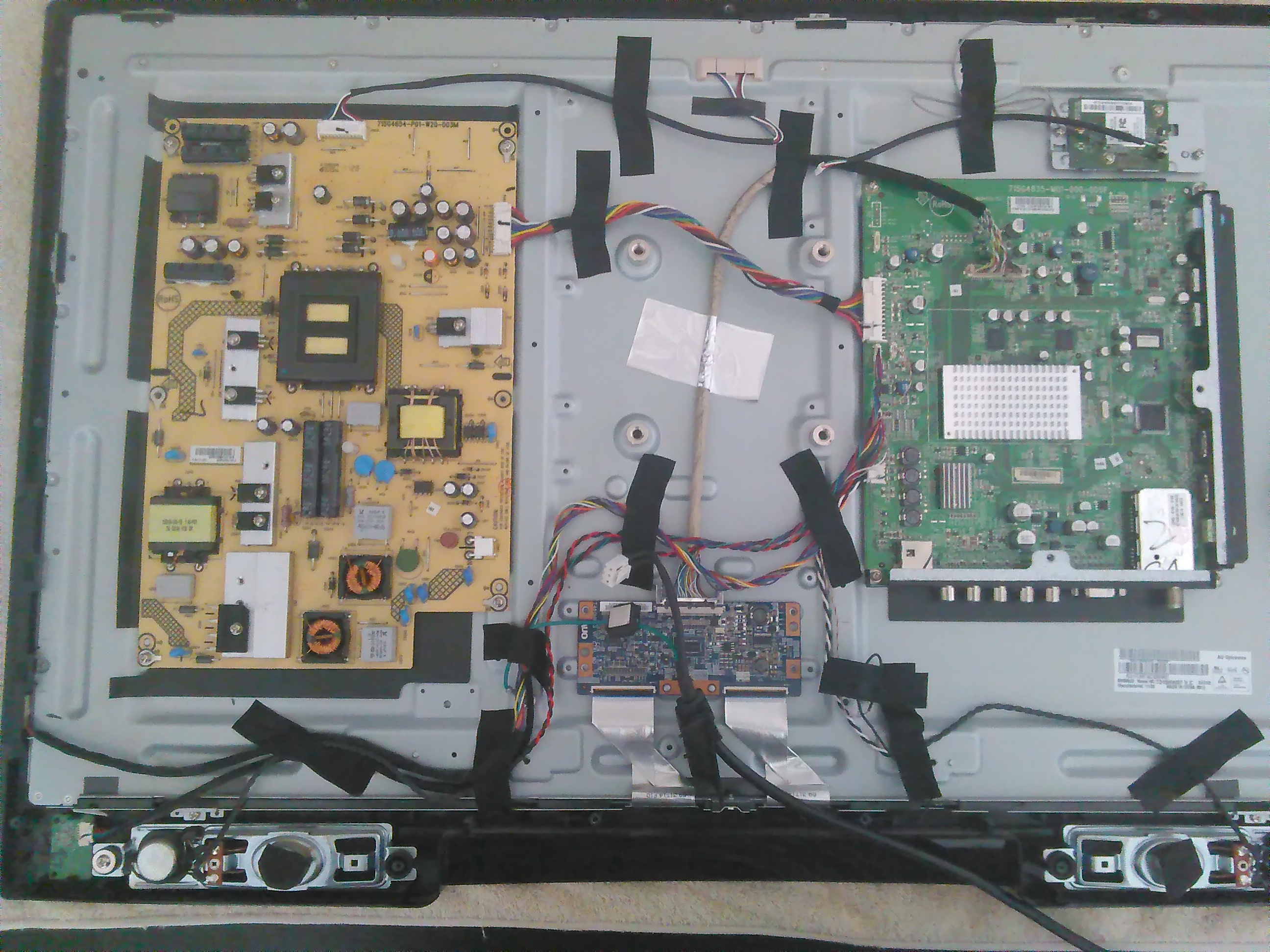

    Hello all , thank you in advance for any input provided.
    I have owned this TV for about 2.5 years and never had any problems until last night. My wife was online and the picture just faded out to a black screen. I unplugged the television and did a reset with the power button. Upon reboot the logo flashed as normal and the picture returned. It went out again about 15 seconds after that. The television's behavior kind of fluctuates with sometimes needing to be unplugged to power down to booting with logo and 15 seconds of screen to logo then black. The Vizio light at the bottom of the set stays illuminated when the screen is black. The back light is not on and there is no picture via flashlight test. I have contacted Vizio support and unfortunately I am out of luck. I did ask if there were any firmware updates or eeprom kits available to no avail.
    I removed the rear panel and inspected the power and main board. All caps and pcb's appear to be ok visually but when I plugged the set back in I noticed a very high pitch whine coming from the power board. I used a straw and believe I identified the source of the pitch. So, is this a transformer and is it common to have an audible indication of failure? Could this be the source of the problem with the set? I have a basic skill set to solder and replace it as well as perform dmm tests.
    Again thanks in advance for any advice or input.

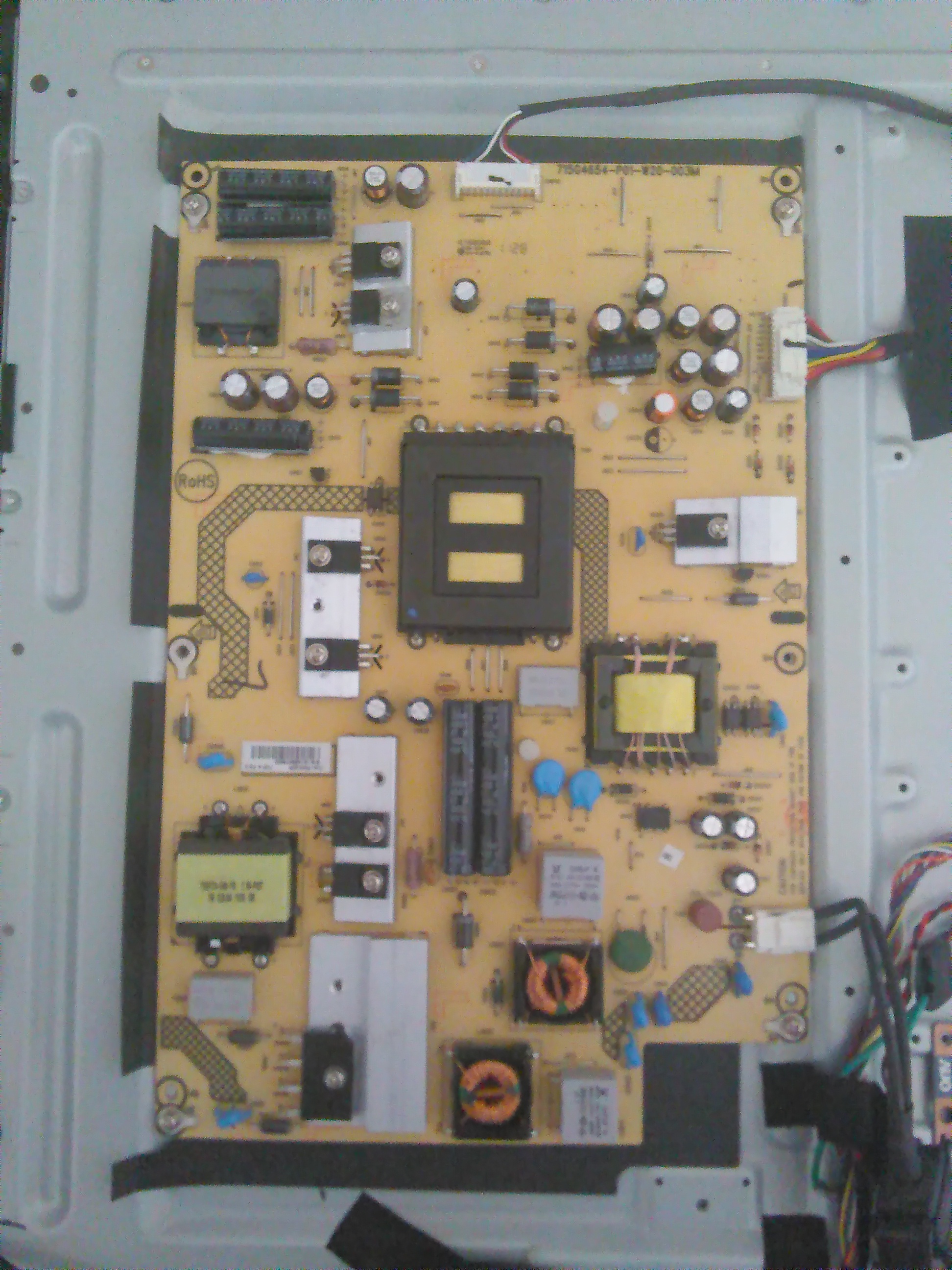

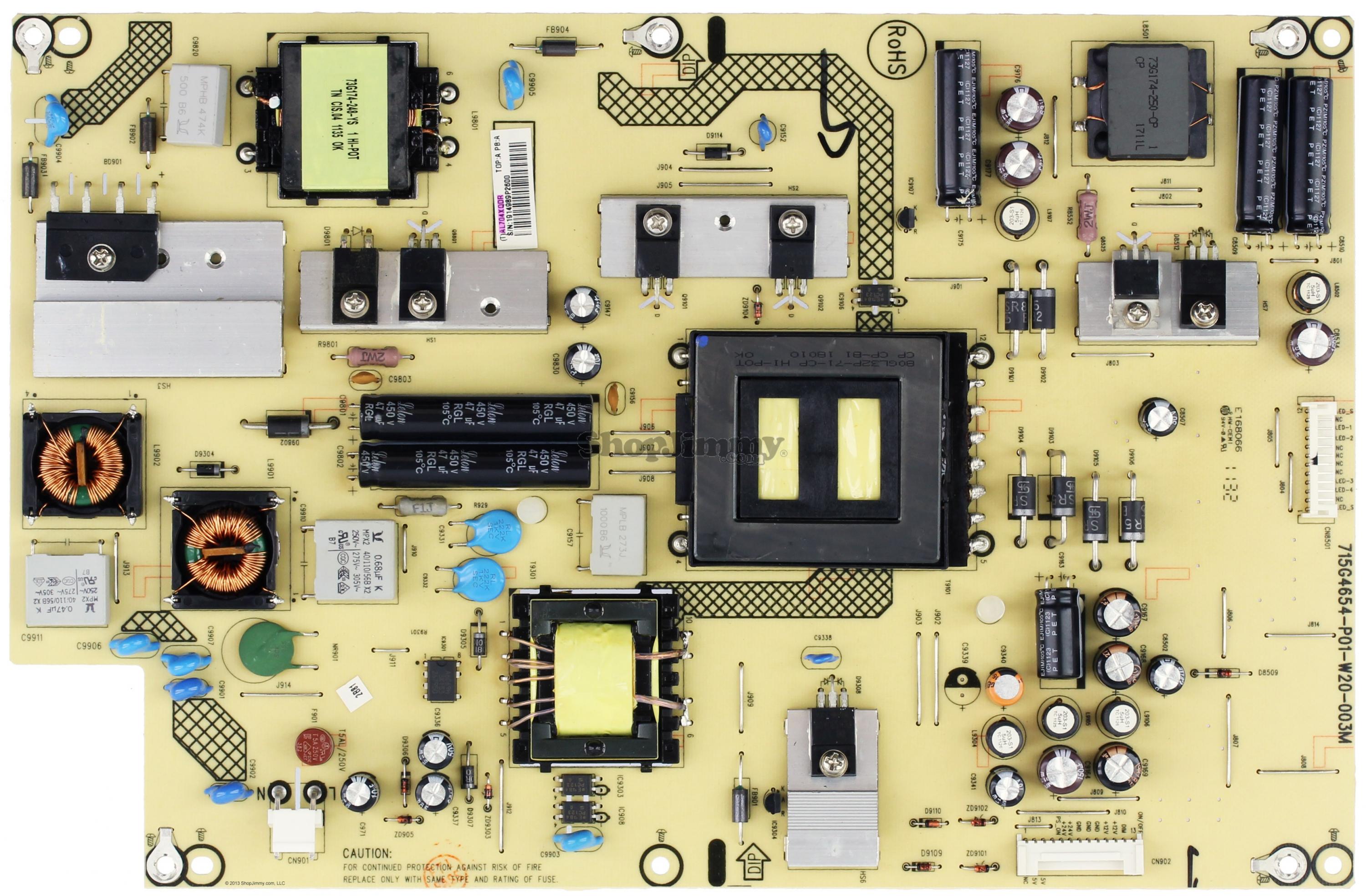

      Re: Vizio M320SR turns off after logo
      Could you post a sharp picture of the whole of the power supply which may prove helpful.
        Well this isn't very sharp so if need be I will have to get a better image for you this evening. Also included the back of the tv.

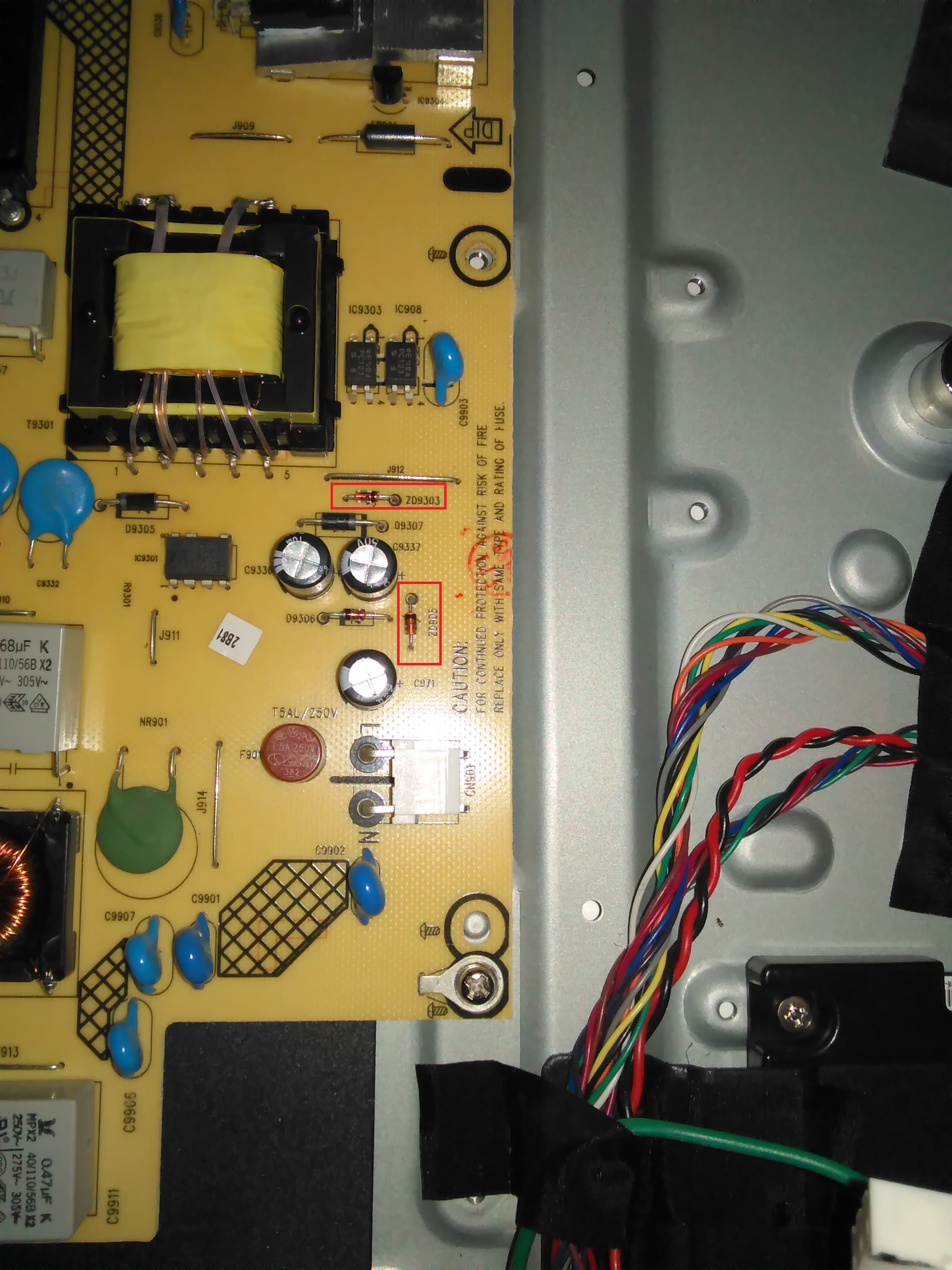

                        What is the voltage written on C9801/2. It looks like your PFC circuit has stopped working.
                        How confident are you with taking measurements and using a soldering iron?

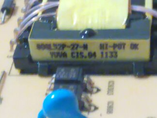

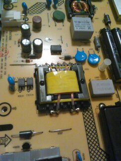

                            Can you give the numbers written on the IC's but not the 4 pin IC's.
                            I can see one 8 pin IC on the top of the psu and there will be more on the solder side.

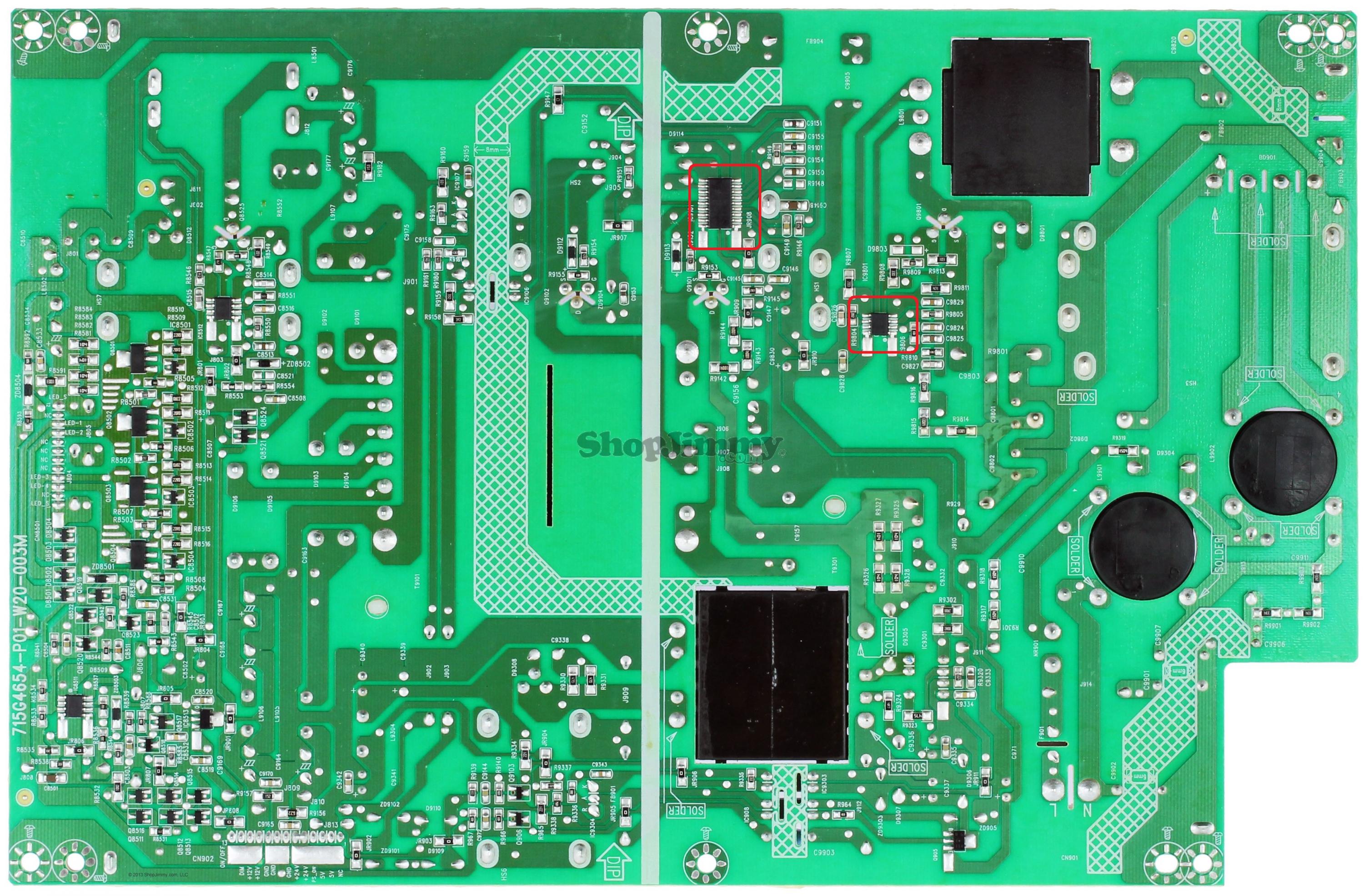

                                  The IC of interest is IC9301 which I believe is an STR-A6069H
                                  Can you very carefully measure what dc voltage you have (when you power up) between pins 5 and 3. It should be a minimum of 13.8V
                                  Check all the diodes around the IC
                                  Photo's courtesy Shopjimmy
                                  • Roush2fast
                                    • Jan 2017
                                    • 49
                                    Good call , A6069H SK153 26795D
                                    IC voltage reads 13.7 ~ 13.8 when powered on.
                                    These tests were done when the TV is in a functioning state. It's been unplugged since last failure and it is operating again. I received readings ( meter does not have diode function ) from all diodes excluding ZD9303 and ZD905 which are indicated in the attached picture. Not sure if that means anything as my level of understanding is still elementary. I am learning more and I find this very interesting.
                                    The transformer is still squealing like a stuck pig in stand by.
                                        Does the large capacitor still have 389V DC when the set is squealing and are all the DC output supplies still operating and is there still 13.7V on the IC A6069H between pin 3 & 5.
                                        If you disconnect the Inverter cable does the squealing stop.
