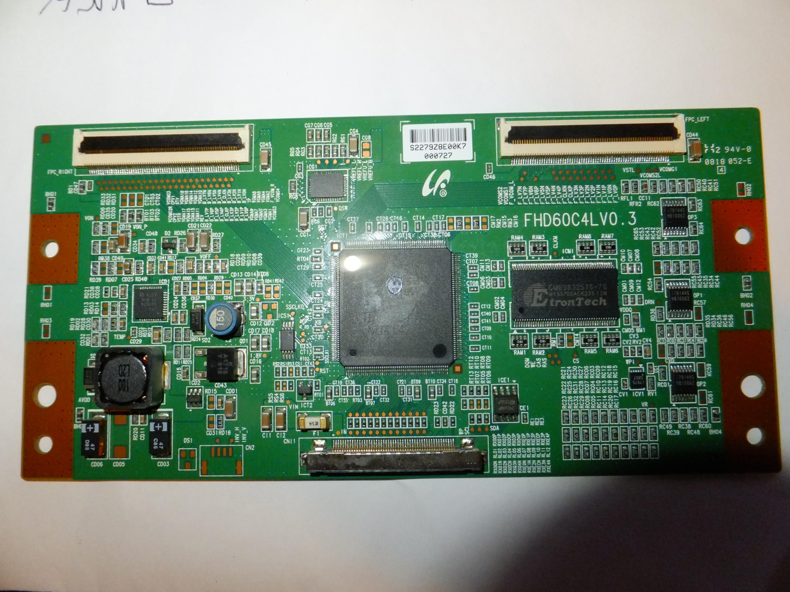

    Samsung LN52A550P3F T-Con Board Color Problem
    I got this Samsung LN52A550P3F with a bad T-Con board. My colors are all messed up. So I assume it is an IC. There are 3 ICs but I am sure ICM1 is a memory chip. There is ICD1 (TPS65217a) and that seems to be a power IC so maybe not that. Then there is ICT1 (THF9301) which I can not find any information on what type of IC it is. So I assume it is this one. I am about to remove one from another working board to see if it fixes the problem, if it does I will order some new ones.

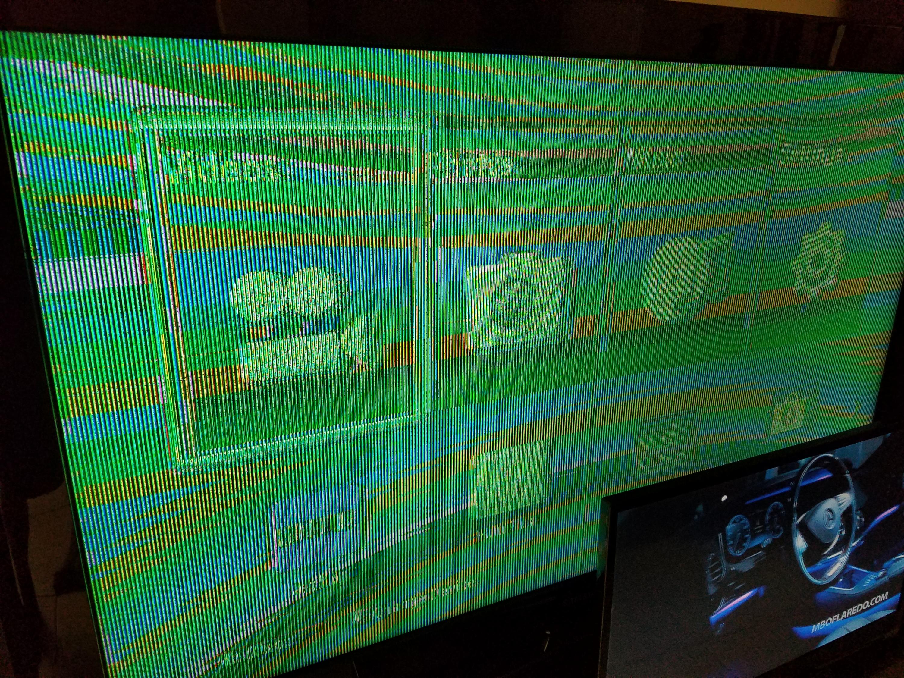

    Does the picture clear up if you only have one of the panel - Tcon ribbons connected? Have you cleaned up the LVDS cables since I seem to remember a fault just like this that was a cable problem.

      No. I know it is not the screen because I actually have 4 T-Con boards. 2 are good and 2 are bad. So I need to repair the 2 bad ones.

        I don't think it's the screen either. The picture looks as though it has not only lost colour but also missing every 2nd pixel which was a problem with the LVDS cable to the mainboard in another thread. Can't guarantee that this is the case here but may be worth checking the cable.
        Missed this in your first post.
        You say you have some good Tcon boards so the fault must be with the Tcon

          Cable is good. TV works fine with the good T-Cons. I am trying to fix a friends T-Con so I am using my TV to test it. TV works perfect with my T-Con board. I went through my parts and found another T-Con board I had written on "Needs to be tested" and it tested bad so now I have 2 I have to fix. Of Course my original T-Con board is good and I found another good one. But I don't believe in swapping out, I repair it.
          I am also going to install a cooling fan so it does not happen again.

            Have you checked all the voltages from the onboard regulators ICD1, ICD2 are OK? Compare between a bad and working board.
            Don't rule out ICM1 - it's a RAM chip, probably used as video memory, and you do have a corrupt image. It could be bad.
            ICE1 seems to be a 24C64(?) EEPROM, probably the program for ICT1. If this was bad it may be loading wrong info into ICT1. Have you tried dumping this from both a good and bad board? Compare code? Try a brand new EEPROM and program with code dumped from a working board.
            What is ICS1? Another EEPROM?
            What are ICG1 and ICV1? Have you compared voltages at their pins between working and non-working boards?
            -David VanHorn

                  Oh, I have seen this many times. If your colors are bleeding it is usually an IC on the T-Con Board. I have also seen blocks on the screen and it was the T-Con Board. Blocks about 1 inch all over the screen. Like is was a puzzle and all the pieces were mixed up, replaced the T-Con board and it was fixed.

                      Well I swapped the EEPROMs and the Good T-Con board is still good and the bad T-Con Board is still bad so problem is not with the EEPROM. My next step is the main IC.

                        I still wonder if it's that RAM chip.
                        Bad VRAM on PC Graphics cards can cause similar image corruption patterns.

                          Right now I am getting double images. I can't seem to remove the main IC so I am going to have cut it off and put a new one on. It may be glued down.

                              The odd or even pixel data seems to be missing and the color is out of sync. I'd check the first and second clock channels on the back of CNI1 to make sure the positive and negative drive for each is getting on the board. Reflow that connector and look for bad connections there.
                              The processor is from AUO, not sure if you can get it elsewhere.
