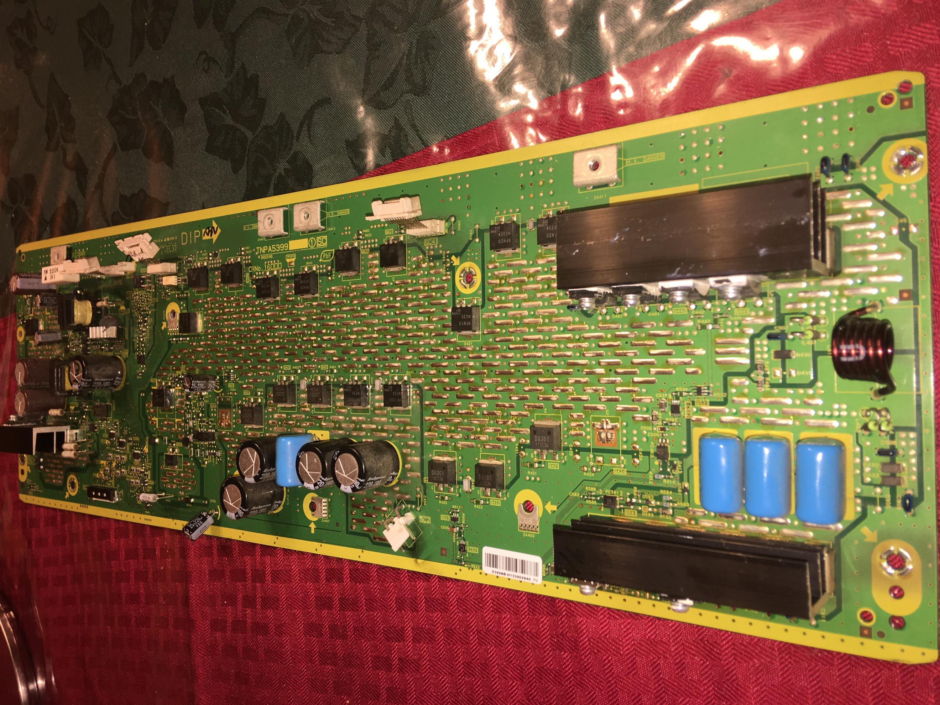

    panasonic viera tcp60st30 SC board Transistors type or Kind ????
    Hi guys
    I need a little help from experts

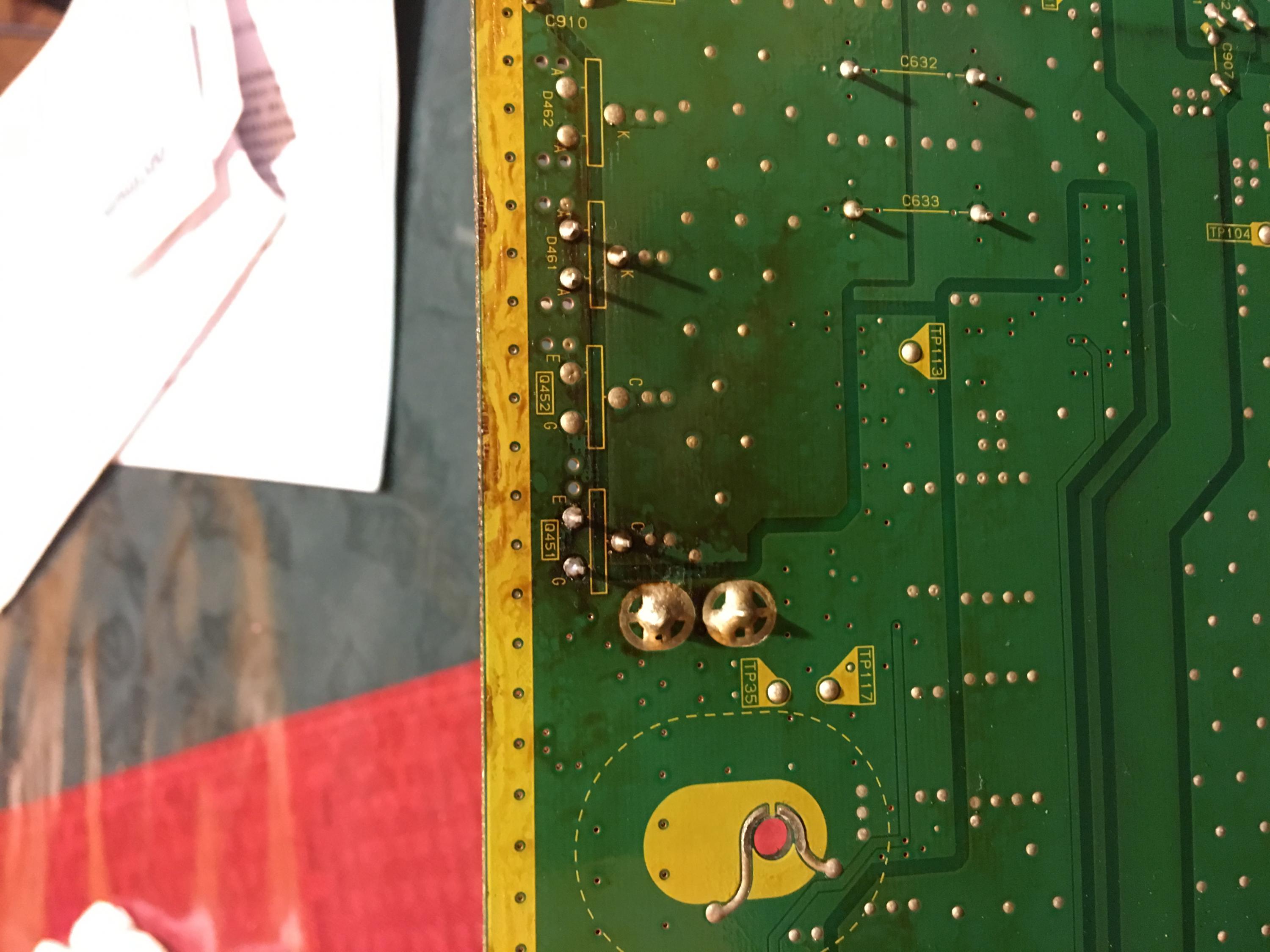

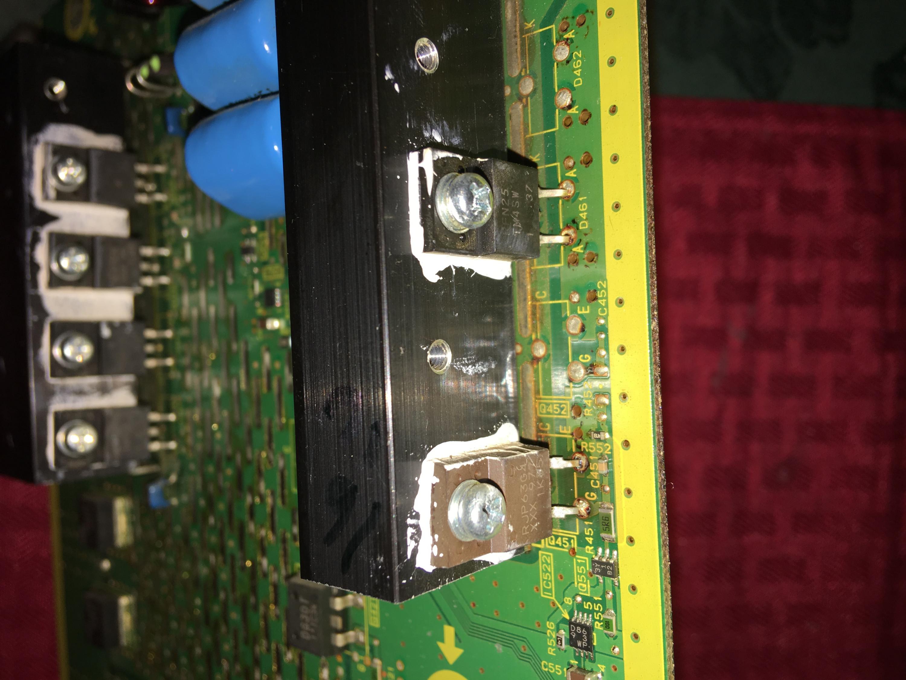

    My 60 inch 3D tv recently started acting up
    Till it died
    So I found the problem it was very easy to identified
    And it was SC board ( TNPA5399) transistor that went bad
    Now my Big question is
    How do I identify or how do I buy this transistors (see attached pics)
    I Know nothing about transistor world
    Hope you guys can help me out

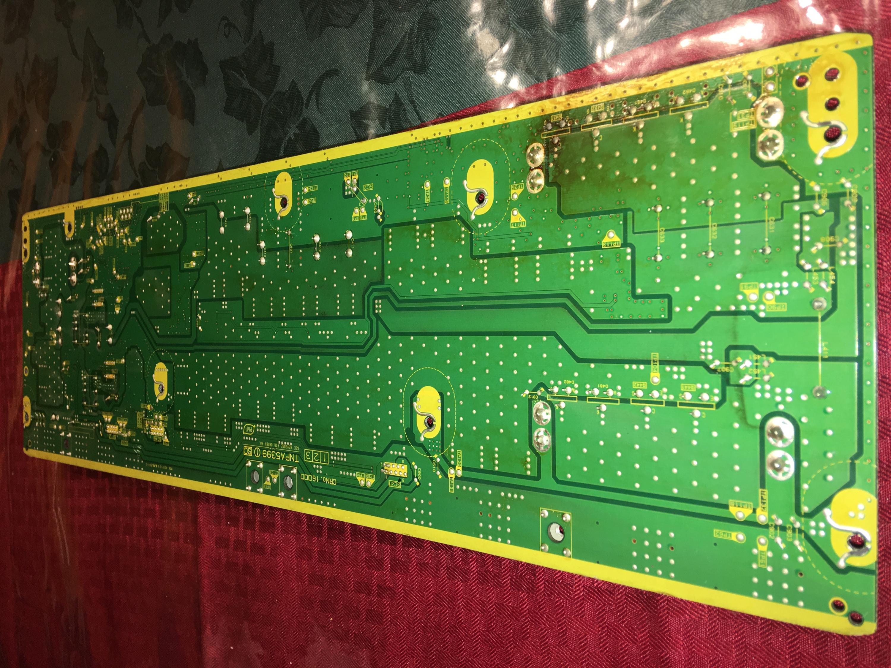

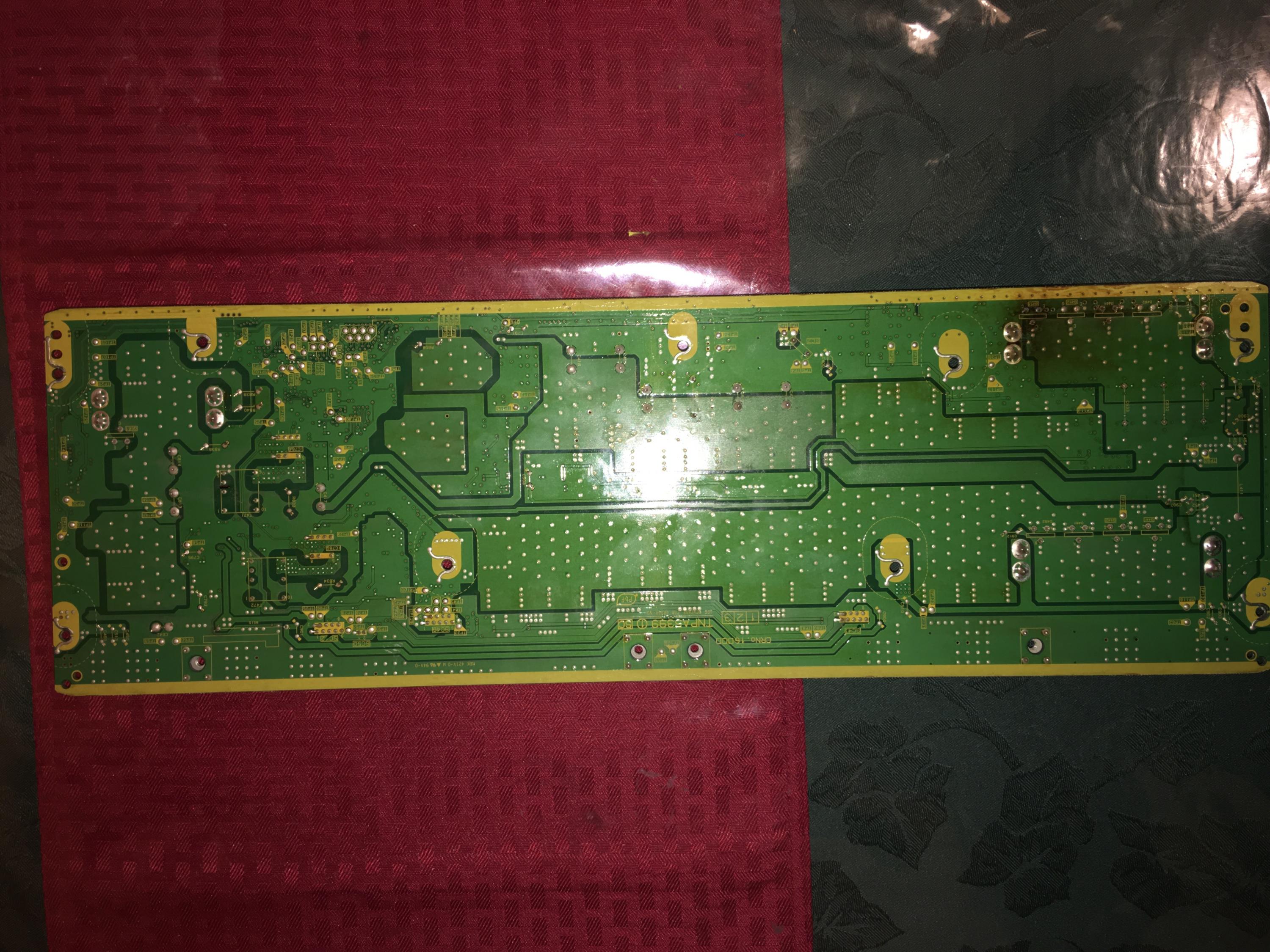

    Re: panasonic viera tcp60st30 SC board Transistors type or Kind ????
    Are you sure that's the only transistor that is bad? I cant imagine only one is bad.
    Did you measure all of them?
    http://www.ebay.com/itm/1pcs-RJP63G4...gAAOxygPtSwA4-
    Can you post pictures of the whole board?

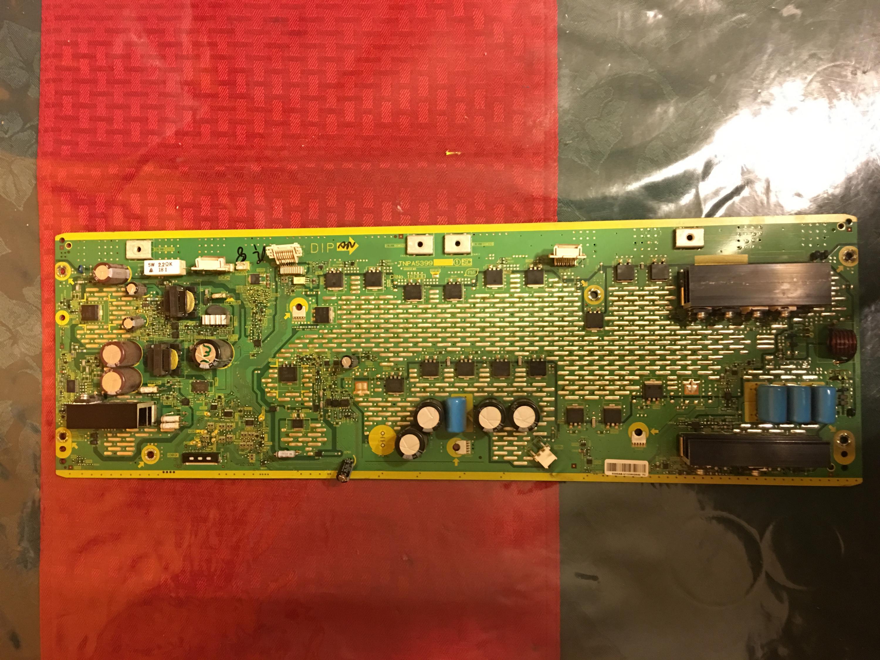

        Well , these 2011 models all have the same problem.
        What you see on the boards ( unless you soldered ) is flux/fluid from the factory when the board was made. Nothing special although the solder looks like its gone.
        Meter in diode mode and measure the outer pins on every IGBT ( Q )
        For the DIODES ( D ). black prope on middle pin and red on 1 of the outer pins , again beep is usually bad.
        First picture , measure the 6 fets around the white prong connector. Cant see it clearly but will be something like Q422.
        Ps , set blinks 7 times?
        • Moreno83
          • Jun 2014
          • 2008
          • The Netherlands
          Also , what happened with the tv and how are you sure its the SC board?
          Measure Q401/402/403 on outer pins in diode mode. Same for Q421/422/423.

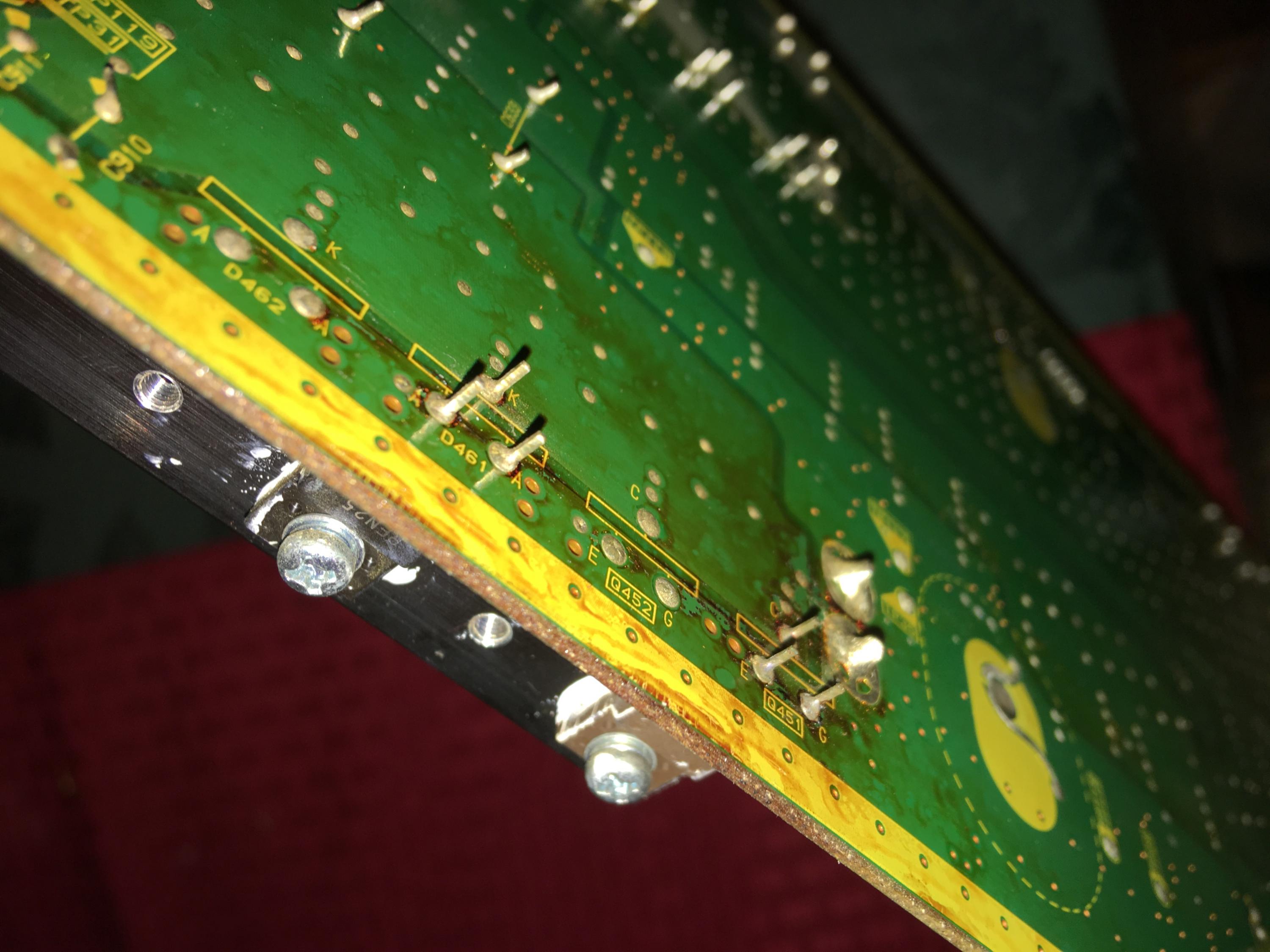

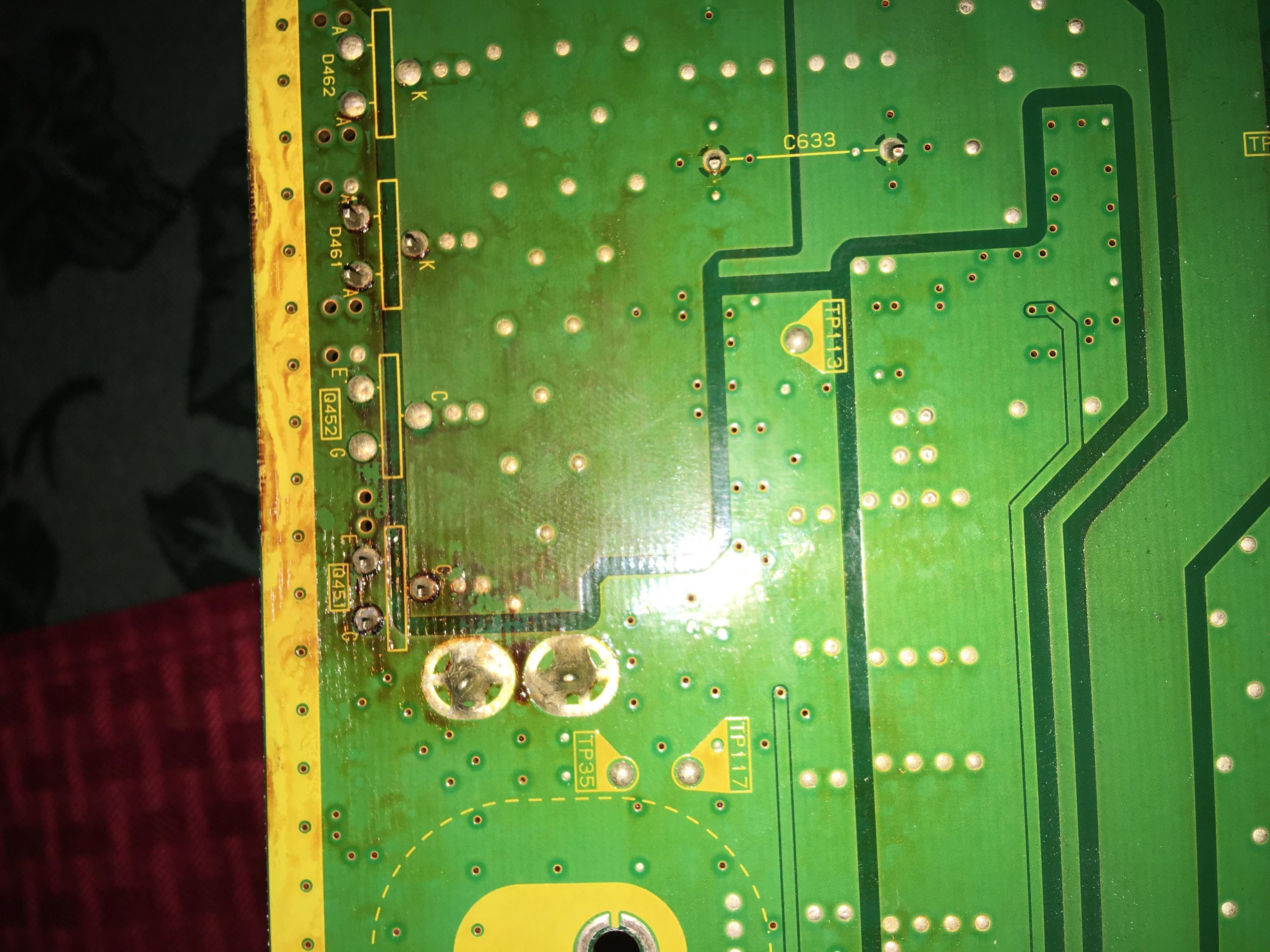

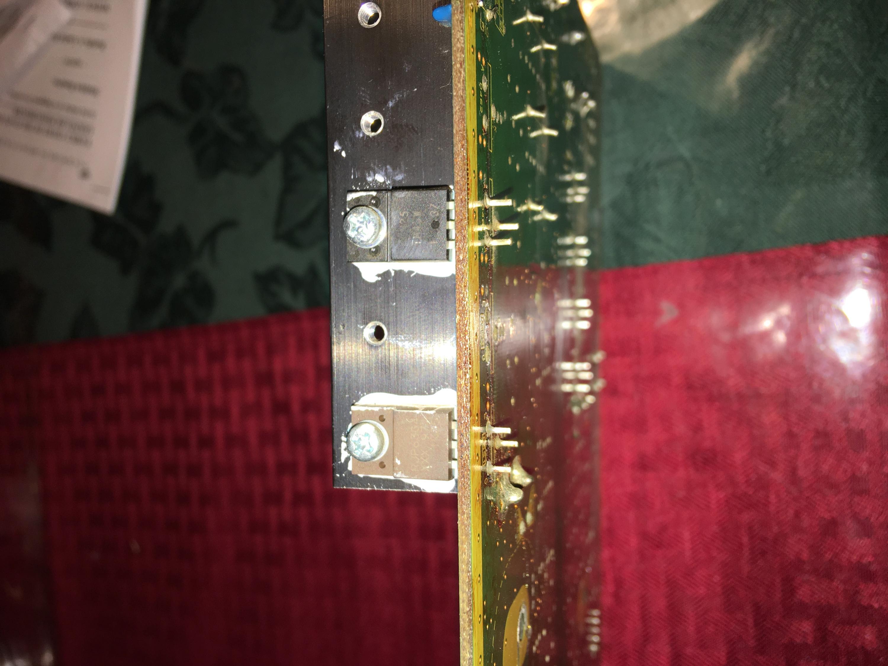

            Thank You for reply
            So the way I figure it out
            Light was blinking 6 times
            I saw shopjimmy code explanation video
            (https://youtu.be/GFE14ElXz7g)
            After I followed their steps
            It turned out to be that the SC board was the problem by the light code
            So now
            I measure all the Q And D
            And all seems to be good
            Except
            Those 2 burned transistor Q451 and D461
            You think one of this transitory will fix it ? (See pic attached)
            If not how can I get them ?
            Thnks again
                As Tvtimmy says.
                You could order the part from mouser or on ebay. If you are 100% sure the SC board is bad then you could also buy a new one on Ebay. They are being sold for $40/50
