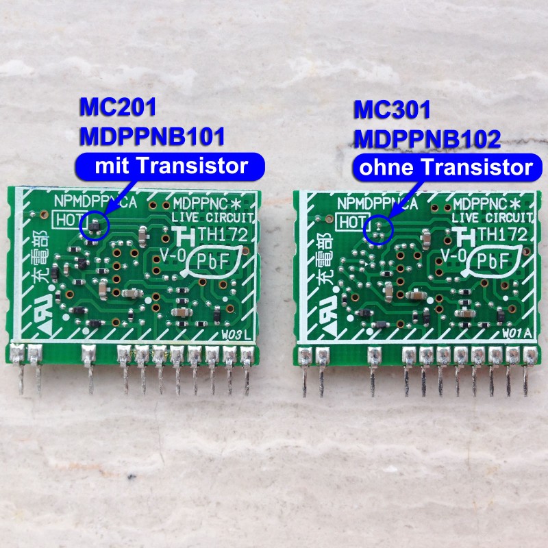

    I was hoping that the cause of this 10 blink SOS would be the TEA1611T chip on either the MC201 or MC301 located on the P(MAIN)-Board. This diagnosis seems to be wide spread across the internet and the chap selling the TV had even highlighted this as a likely cause. However, having purchased a couple of new IC's and fitted them along with new 1uF 0603 caps the fault remains unchanged.

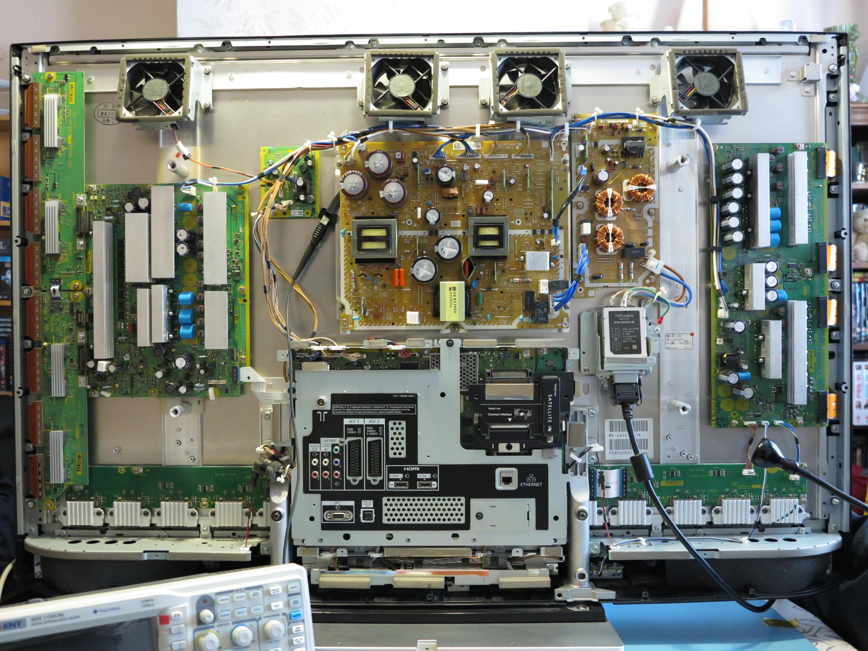

    With these resources in hand I set about trying to determine what was and wasn't working on the TV.
    According to both service manuals the 10 blink SOS indicates one of the following errors: Sub 5V SOS; Main 3.3V SOS; DTV 9V SOS; or Tuner Power SOS.
    What I've found so far:
    • When the front power button is pressed the 15V F_STBY (15V standby supply originating from the P(MAIN)-Board) was being correctly generated (so MC301 was working!). The 15V generated does seem a little high, measured at 15.9V
    • This in turn was feeding the PA-Board which generates both SUB 5V and DTV9V (SUB9V) measured from test points TPS5 and TPS9 on the PA-Board
    • Also as long as the front power switch is left in the ON position (latched in) there is 5V present on the STBY5V line of P7(Pin 5)
    • This would appear to leave Main 3.3V and 'Tuner Power' (I'm still not exactly sure what this one is)
    • On the A-Board Sub 3.3V is present during the brief period after pressing the main TV power button before the unit shuts down
    • 3.3V (STB3.3V) is present at connector A1
    • The schematics I have show that Main 3.3V is simply a switched output from Sub 3.3V (Q5693 PMOS switch driven by a BJT which is controlled by IC1100)
    • Main 3.3V is not present. The reason, IC1100 is not asserting the TV_MAIN_ON line
    • I really need some experianced help!
    Now I'm in a sort of 'chicken and egg' situation. I don't know whether there is a fault with IC1100 (seems unlikely, fingers crossed!) or if there is some other condition that is not being met preventing IC1100 aserting the TV_MAIN_ON line which in turn is preventing Main 3.3V being present causing the test to be failed.
    One of the posts mentioned above talks about Vsus initially being present as well as the standby 15V. Vsus is controlled by MC201 on the P(MAIN)-Board and is definately not being generated. From measurements (although I've been struggling with this) it appears the optoisolator device acting as the ON/OFF switch for MC201 is intentionally driving MC201 into its OFF state at start-up (which suggests Vsus is not initially ment to be present, unless of cause this is a fault!).
    The training document above (google docs) manages not to cover the PZ81 (even though I'm sure its from the same year as the PZ80 and PZ85) which is a shame because it does give a sequential work through of the power up sequence (page 13 seems the best sort of fit but doesn't mention Main 3.3V).
    As you can probably tell I'm pretty well stuck (especially without the correct service manual).
    Can anyone shed light on the correct sequence of rail power-ups for this unit and on 'what depends on what' for the TV to initially correctly enter the standby state?

    Hi , welcome to the forum!
    I repaired many of these PZ85 with that famous PS , but never this model.
    Have you tried freezing the 2 small boards to see if the tv turns on? You sure all the solder connections are ok? Especially the small capacitors , those pads are really tiny.
    You already posted the correct SM for this tv? These boards are also used in other models so im pretty sure this SM will do the trick.
    SM says its the A board but it can be the A board mis diagnosing the error. ( blink pattern isn't always correct ).

        Hi Moreno and tom,
        Thank you both for your replies.
        @Moreno, I haven't tried freezing the TEA1611 chips on the MC201 and MC301 boards as I skipped ahead and just replaced them both with new IC's. I de-soldered the two boards and took them into work on the weekend to do the soldering under a microscope (as you say they're pretty small parts!). I'll try and get hold of some freeze spray to see if the replacement part on the MC201 board is acting up. I'll also look at the board again to double check.

            Re: Panasonic Plasma TH-46PZ81B, 10 Blink SOS (Doesn't appear to be TEA1611T chips)
            Is it just me or do the large brown capacitors near the 'scope probe look bulgy?
            -David VanHorn
              They often do, but they are usually OK

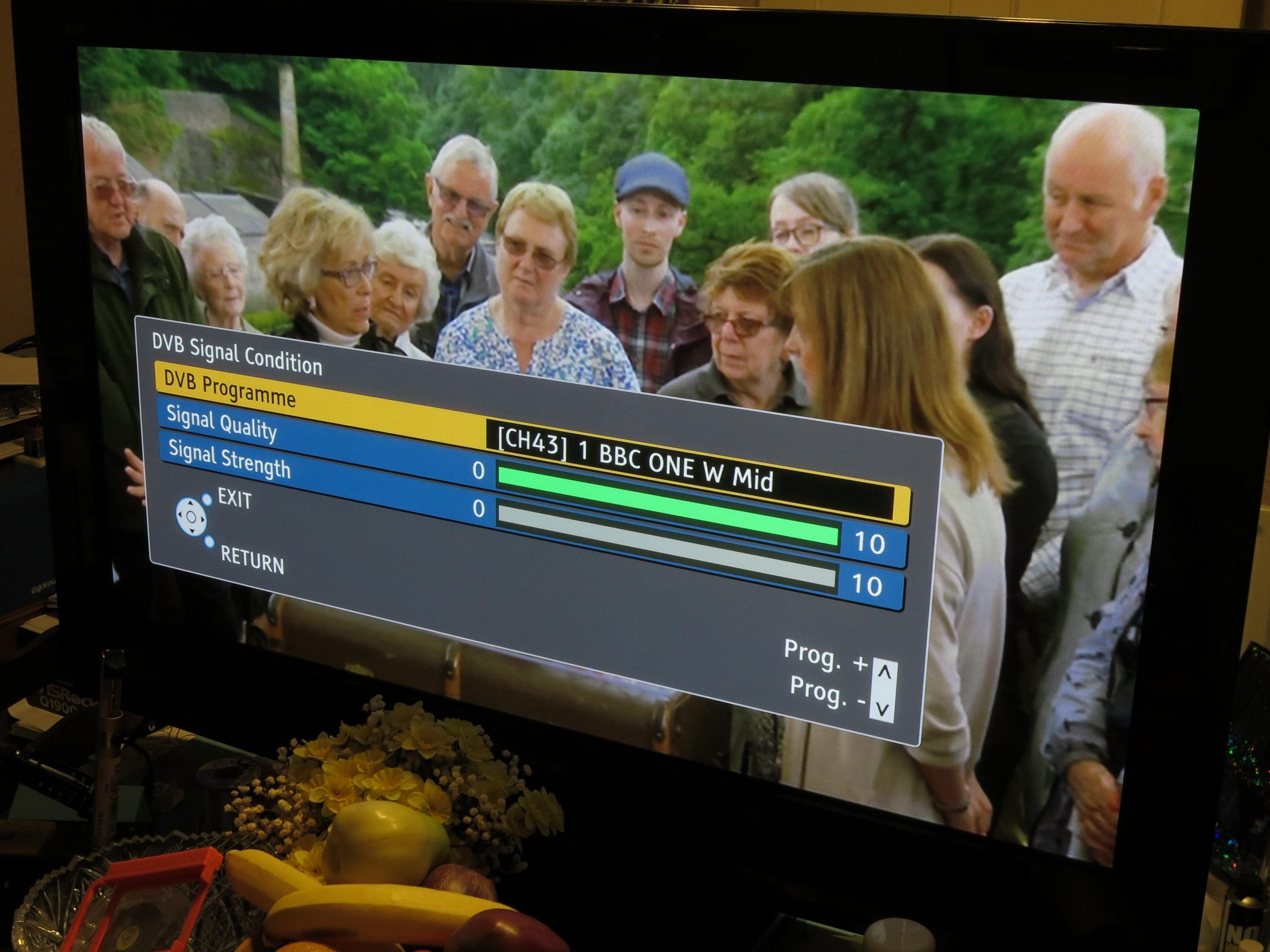

                                        Good news everybody, another Panasonic Plasma lives again!
                                        Just wanted to share the good news with the forum and take the time to thank everyone who offered me advice over the last 5 months!
                                        I'm still not really sure what the issue was with this TV but after spending some time looking at the F_STBY_15V (which seemed to take quite a while to reach 15V) I decided to take another look at the non-working P(MAIN) board I'd bought off eBay some months ago. I was working under the assumption that perhaps this or another voltage derived from this source was taking longer than the A-Board (or D-Board) liked and hence they were instructing the P(MAIN) board to shutdown.
                                        When I first put this other P(MAIN) board into the TV, back when I first got it, it behaved no differently to the original board so I'd put it to one side. I had a quick poke around looking for any obvious issues (shorted transistors etc...) but didn't see anything really wrong. As I'd still got some new spare TEA1611T chips I decided to change the one on MC301 which looked like it may have gotten hot at some point. I swapped it over into the TV and tried powering on...exactly as before two clicks of the relays followed by both tripping out. Oh well I thought no real loss. Then I wanted to see if any of the supplies from this board came up slowly as well. So I sat with a meter working along looking at various rail voltages turning the TV on and off in quick succession. Then to my absolute amazement I didn't hear a third relay click and the other boards had come to life as well!
                                        Not everything was well at this point as the TV now gave a single Red light blink error code. After a short session of head scratching I noticed that I'd not plugged a cable back into the A-Board (A3) . With that plugged back in I tried turning on again and the TV when back to two relay clicks followed by a third. WTF! So I started turning the TV OFF and ON again in quick succession and the flippin TV only powered up and gave me a picture!
                                        I tried turning it OFF and ON, waiting in between, and I still seemed to be getting instances where the TV would trip out as before.
                                        Anyway, to end the story, I left the TV on whilst I adjusted the VSUS voltage and checked other voltages as per the service manuals instruction. For the last few hours I've been turning the TV on for a reasonable period of time (5 to 30 minutes) and then off again for a similar length and the TV has started behaving itself! Its behaviour when you push the front power button has also now changed, rather than turning straight on it waits to be started with the remote? I've performed a factory reset, so perhaps this has had an effect.
                                        I've put all the screws back in and fitted the back cover and its now been running for the last 2 hours without issue. A little bit more soak testing and I need to find out if it will switch on again tomorrow.
                                        I can then finally pass this on to my poor old sister, bye bye CRT!
