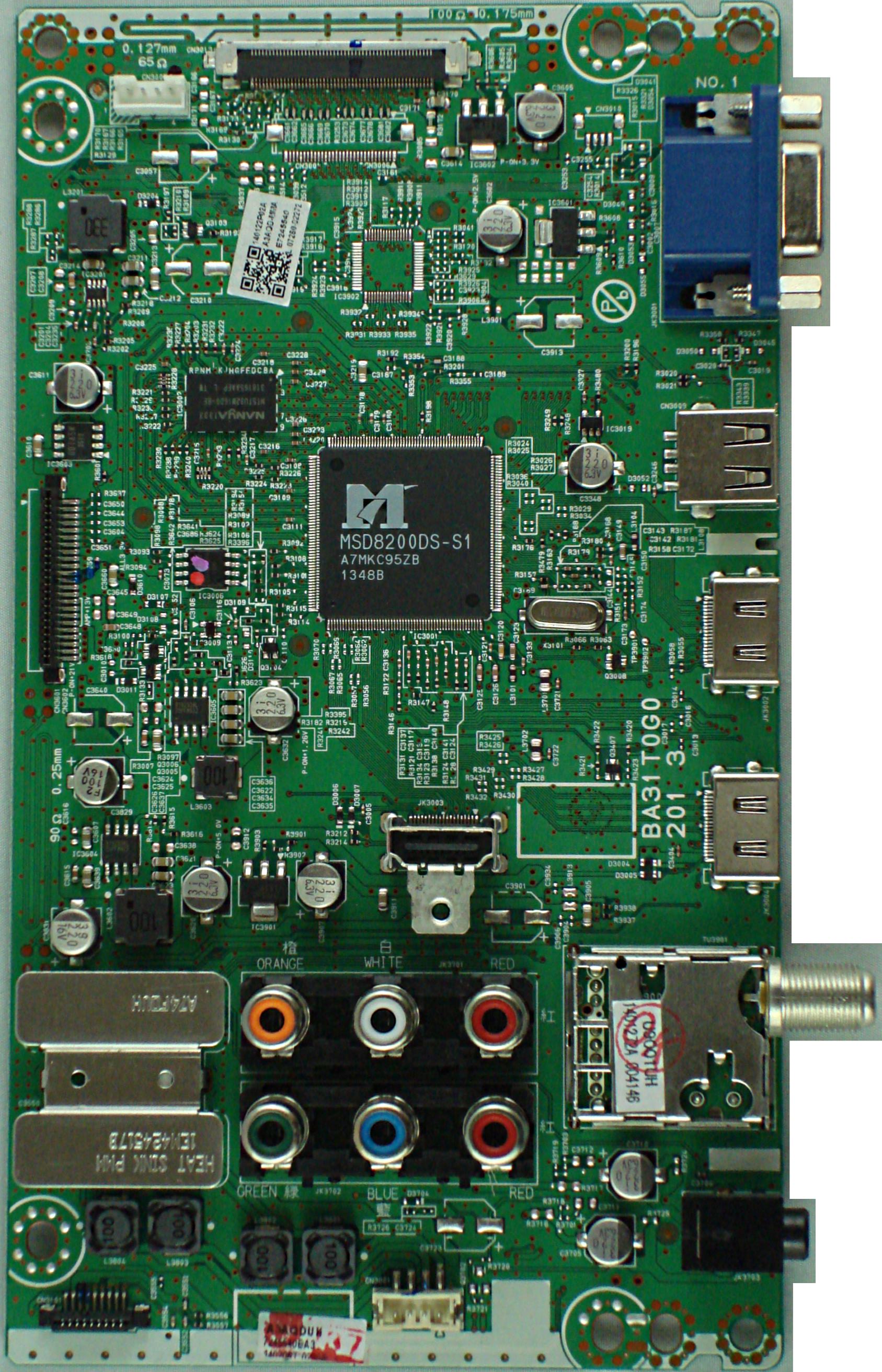

    Something around IC1101 is pulling the Protect3 low.

        Can who ever knows he protect 3 circuit explain it a bit more simply? 3.2 vdc needs to be powered to PROTECT3 1341 IC3001(2/5)MSD8200DS-S1 but instead to R3193 because Q3103 is either messed up or whats left of protect 3 circuit is grounded ? that 3.2vdc is being bought to main board at P-ON+3.3V from power board? Thats what i got so far am i correct?
          #104
          Re: Funai (Emerson) LF501EM4F not turning on
          OK, I just study type 'B' main board dagram, you need to see if you do have LCD+12V at the LVDS connector CN3013 pin 1~4 or not, leave the meter on one of those pins so you can catch the Voltage when you first turn on the TV so you can see what happen before the TV goes into shutdown mode.

            It reads .0065vdc and stays at that from the moment it is plugged in i checked as top right was pin 1. checked left side had 0.00vdc
            tv hooked up normally ,
            checked +21v and had 21vdc also 3.3vdc at ps-on and 12vdc at amp-13v+
              #106
              OK, we are getting some where, so it never goes up to +12V to feed the T-CON.
              I found many sensing circuits that many Voltages on the main board that will trip the PROTECT 1 and PROTECT 3. At first I thought PROTECT3 is just for monitoring the Backlights circuit, but it turns out to be that it also monitoring the LCD +12V.
              If you look at Digital main 1 TYPE b, you will see that IC3201(MP1472GJC4527) is the down converter that converts the PON+21V down to 12V for running the T-CON, IC3201 is turned on by the CELL-PWR-CTAL signal generated by IC3001 (Micro Controller) pin 76.
              So you need to check IC3201 Pin 7 (+21V input), and EN pin2 for >2V or more for ON signal.

                0.28vdc for pin 2 and pin 7 21.17vdc no change both start and stay at voltage

                  Heres how i labled

                    OK, so the Controller is not sending the signal to turn on that Buck converter.
                    So at this point you do have problem with the main board + LED1 drive circuit.
                    i am not sure how much you will want to pursue these two problems and hoping there is no other problem too.
                    You can force on this IC by removing R3213 first and then use 100K resistor between EN pin and the IN pin to see if it will put out the 12V or not.

                        No luck there ill triple check the resistor is on fine i removed r3213 no +12 at lvcs 103 Ohms 10% should be okay ?
                          #112
                          If the EN pin is high when using the PULL-UP resistor 100K (I would say 47K~100K should be fine. and you do have 21V going into it then you should have LCD+12V.
                          If not, then tell use what you have:
                          1) on EN pin when you use the resistor between EN and Vin pin.
                          2) What is the resistance reading between the LCD+12V and GND? We want to know if it show low resistance reading or not.
                          You can possibly have bad IC too.
