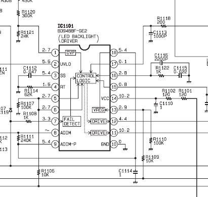

    You have three LED driver ICs with fault output (FAILB) OR together so if one of the LED driver circuit detect fault it will take PROTECT3 line low, see schematic on how PROTECT3 signal is generated and the spec sheet of the IC BD9488F.

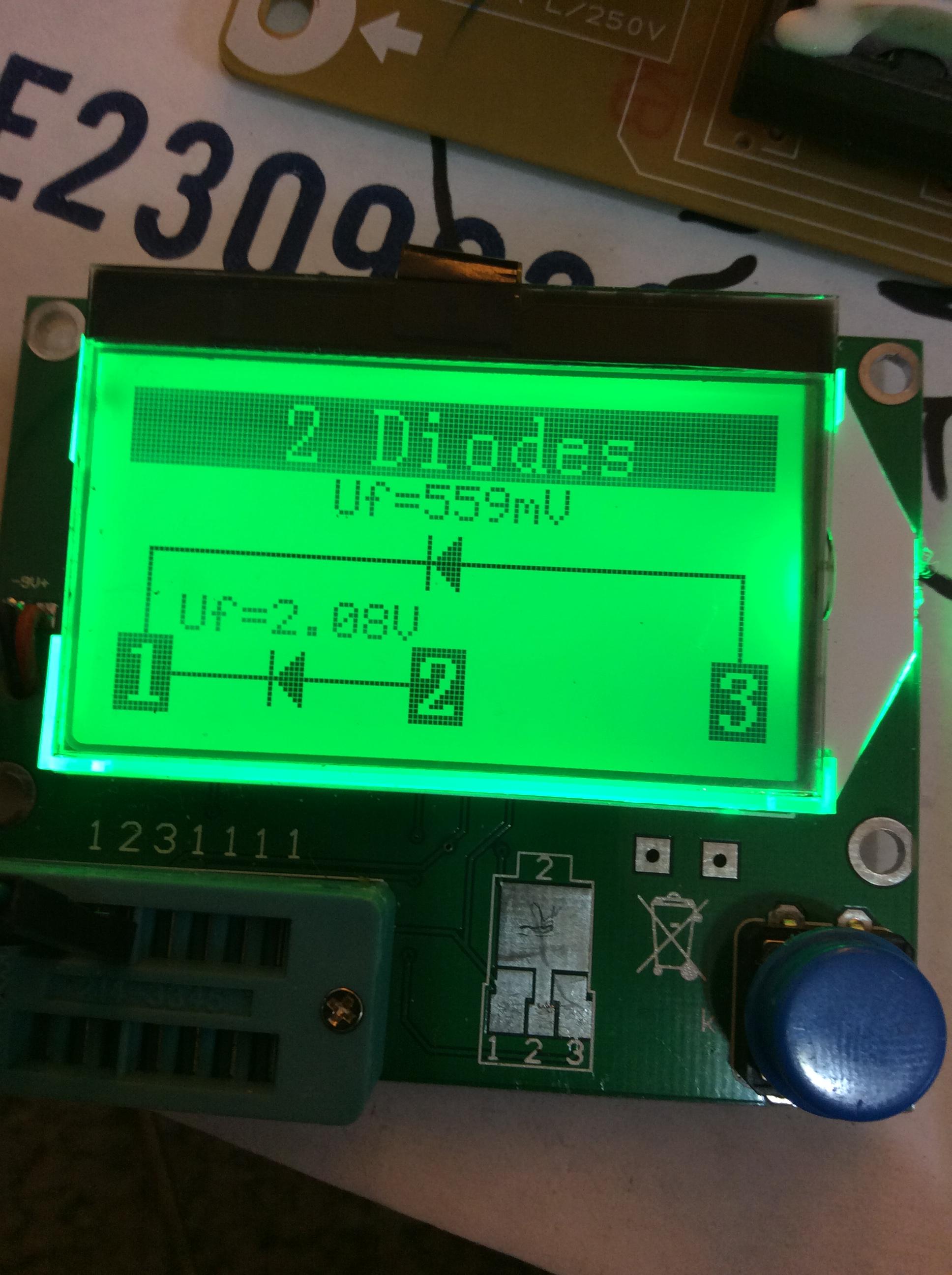

          Maybe we getting somewhere now D1603 & D1605 diodes tested good if okay to test on board Mosfets however Quick and Dirty test first with dvm did no match anything from video(even after i got out the iron and lifted gate leg) I then tried quick and dirty again then mega tester from ebay.
          http://imgur.com/a/VgblK

            Re: Funai (Emerson) LF501EM4F not turning on
            Is that picture of testing Q1601 / Q1602?
              Q601 was no Q1601 just a Q1602 sorry i misread there is showed same on board removing leg now for Q1602

                okay took them off http://imgur.com/a/BHjkt Q1601 C=1.28nf Vt=3.2v Q1602 C=1.29nf Vt=3.3
                  Can you attach your pictures to this thread for other to see at a later time should they too have this problem.
                  The mosfets pass the test.
                  What was the picture shown in post#25 about?
                    Wrong test i did it on Q601 the diodes just tested 0.455 on diode test function . anything else to remove..? person i got tv from before the steady power light flash every 10 seconds was able to unplug , plug in and hrs or days it came on or was able to turn on

                                  Out of curiosity when everything is connected what DC voltage do you have at pin 7 & pin 14 of IC1101, IC1201 and IC1301. Trying to figure out which IC is going into protection mode.
                                    Hooked to normally main board? or all jumped??
                                    Forced on power board+lights on Pin 14 read same 9.5v .
                                    Pin #7 ran
                                    IC1301 2.6v
                                    IC1201 1.8v
                                    IC1101 2.3 v
                                      It's strange since I would expect all the IC's above to have the same reading which should be 3.3V at pin 7 according to the data sheet added in an earlier post. Also the supply voltage to this chip is low but still greater than the minimum of 9V.
                                      Puzzled.
