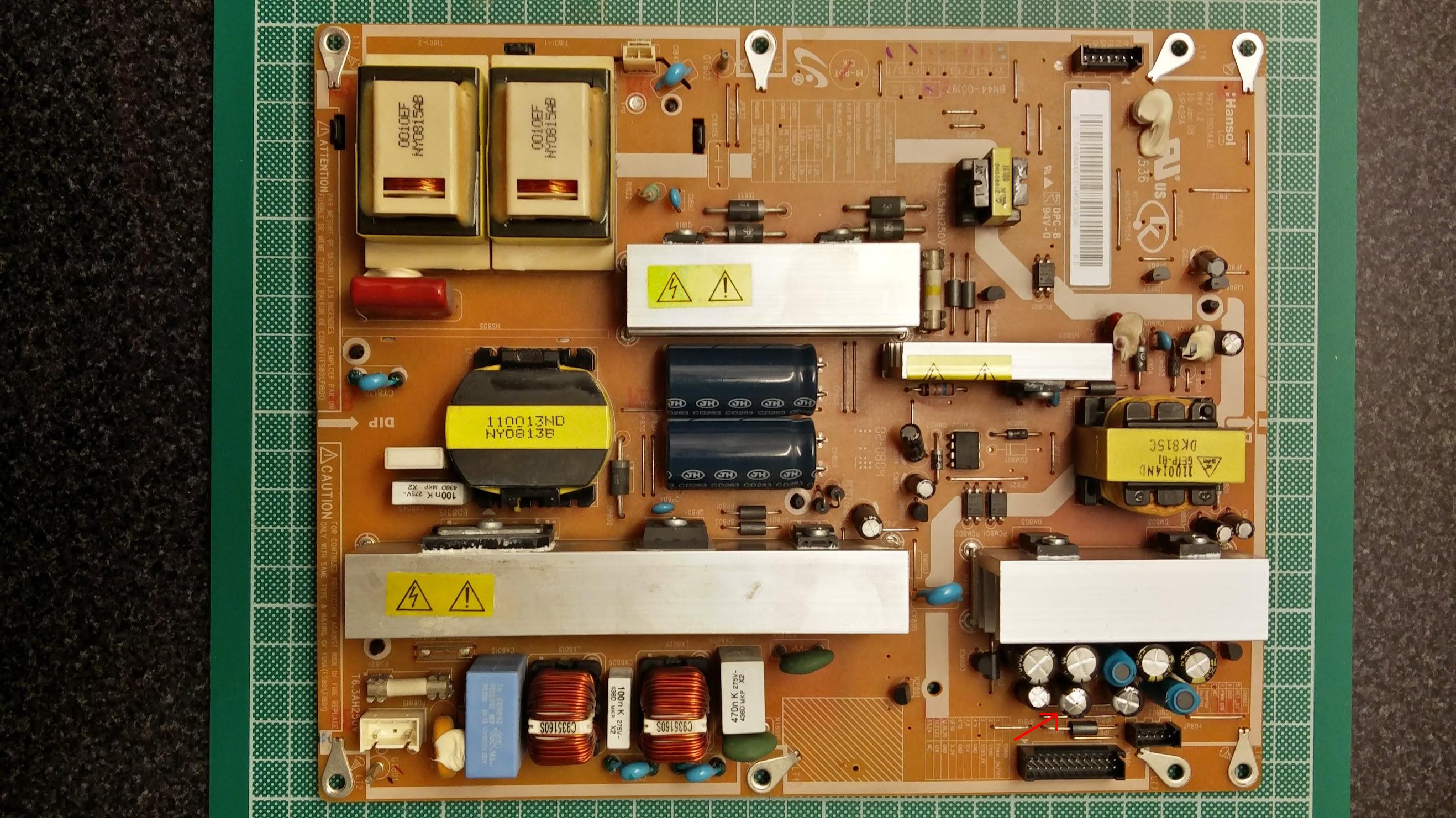

                  I've made a cleanup of PSU, MB & T-CON board as well as reseat all cables including LVDS & ribbons that go out of the T-CON + factory reset, but the problem persists
                  After some time of the startup the TV goes "normal" as stated above and stays like that for hours to come until the next time turn off & on. (this time took almost a minute, but when "cold" it usually take a bit longer)
                  Below some pictures of the power supply & main board. I see at least one cap that needs replacement on the PSU and a weird liquid form stuff in the back of the MB (PCB Varnish ??).

                        the MB look had allot of dioxide, you need to use ethanol to clean it.
                        you need to narrow now which board make this noise at first start ( Cold state ) , use hair dryer to really warm up boards one by one then start the TV, to see which one will let it start normal. begin with MB.

                            Have you changed the bulging cap on the power supply ?

                                change this cap as marked on the photo attached..

                                    I did change that cap already (it's a 470uF) but the problem is still there... I did another round heating the the T-CON and it started immediately so I'm almost sure the problem is focused there.
                                    I've noticed that some of the ribbon contacts are starting to peel off, I've position them carefully and it's now ok again but will eventually need to replace them as well.
                                    Below some closeups on the T-CON in case it help..
                                    Thank you
