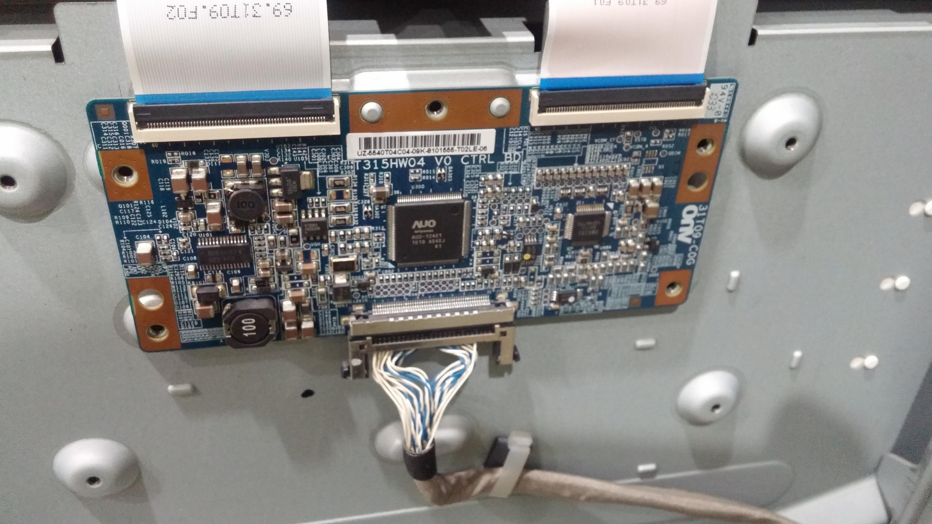

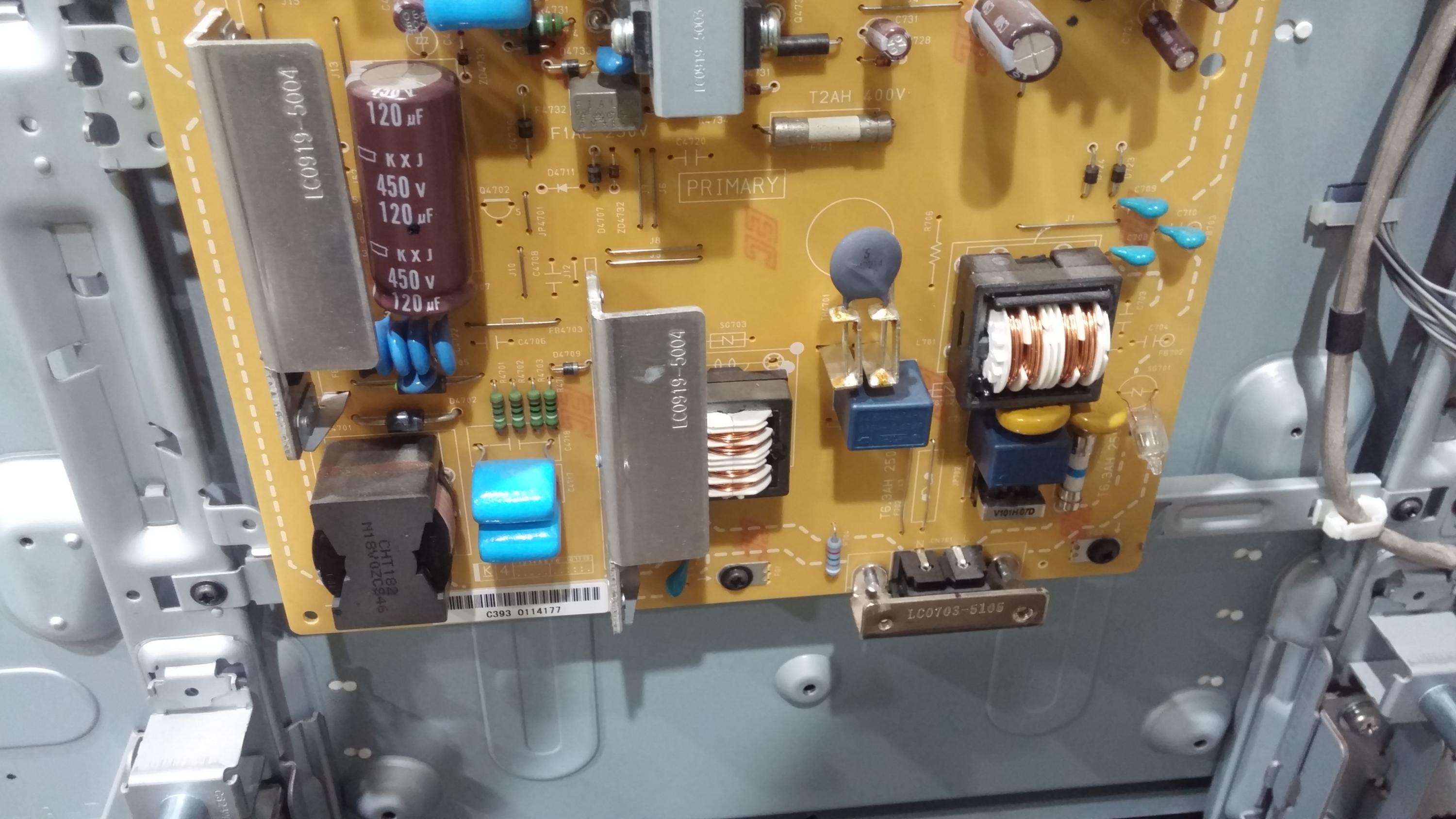

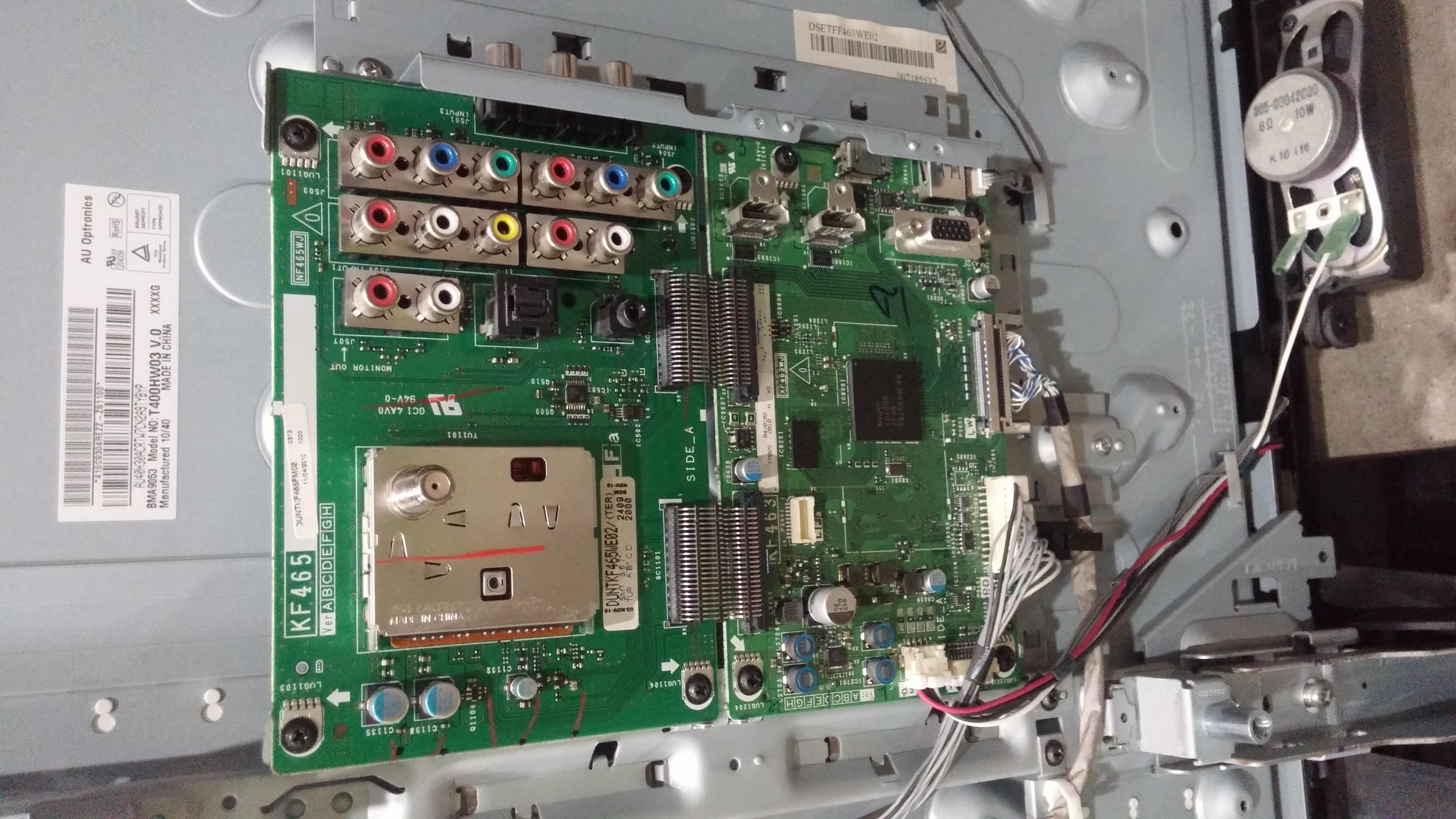

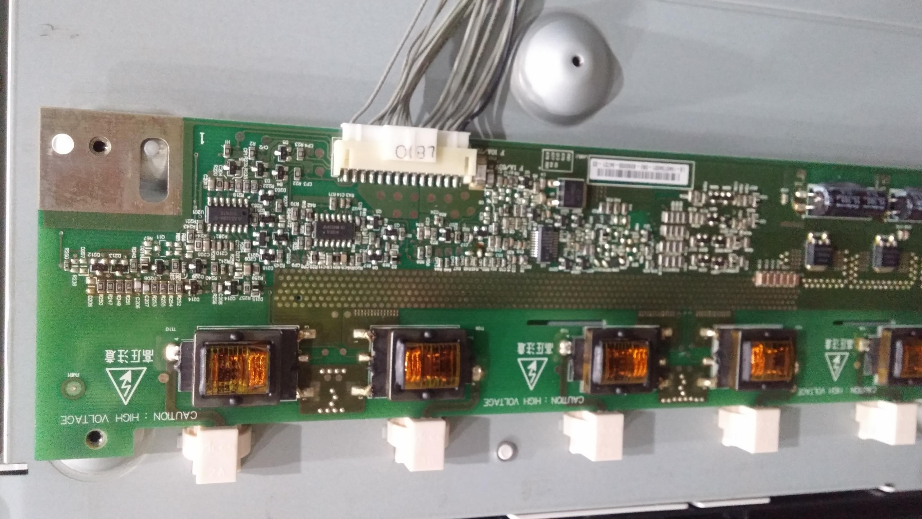

    Re: Sharp Aquos LC-40D68UT Blinking Red Power Light

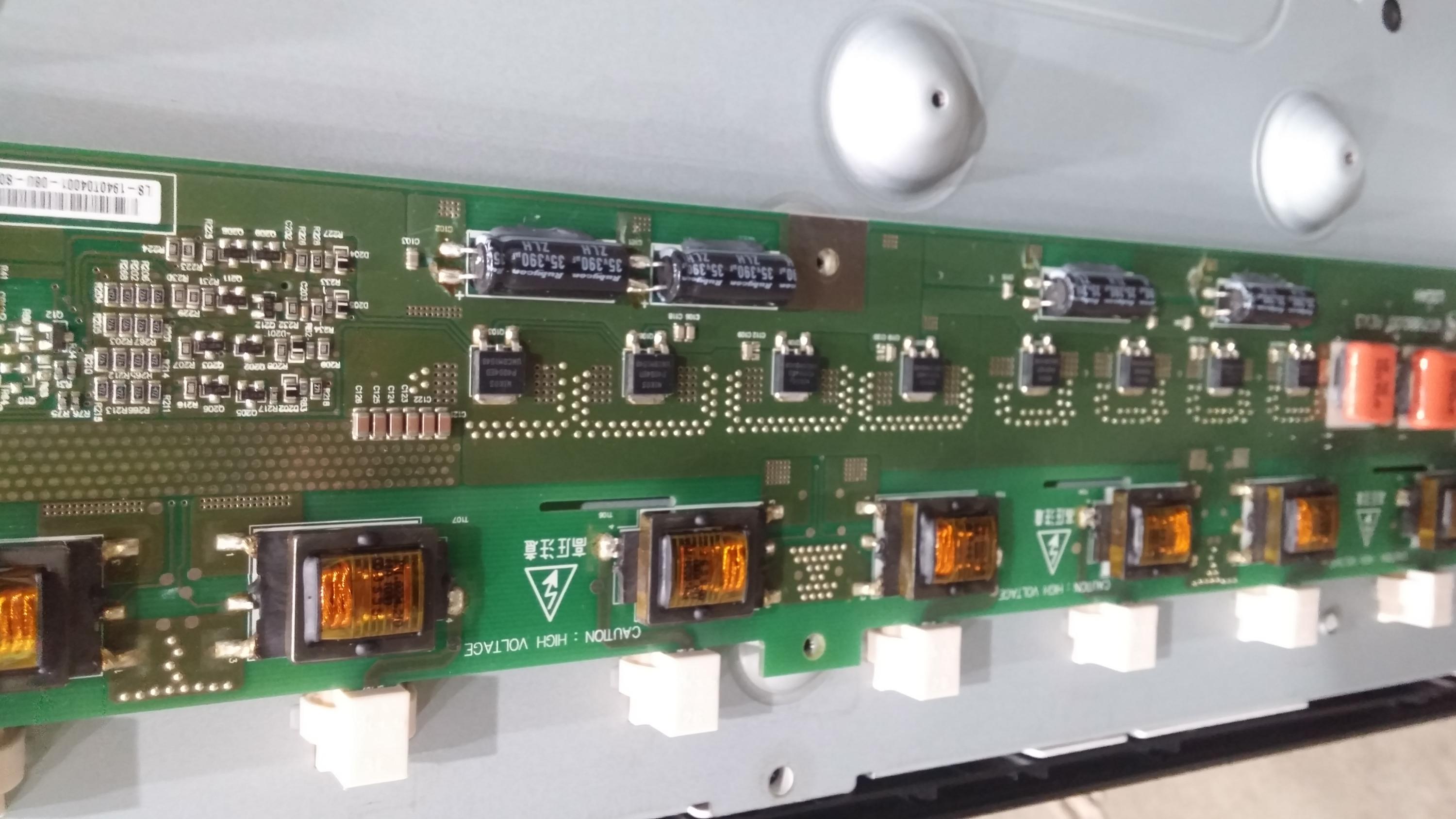

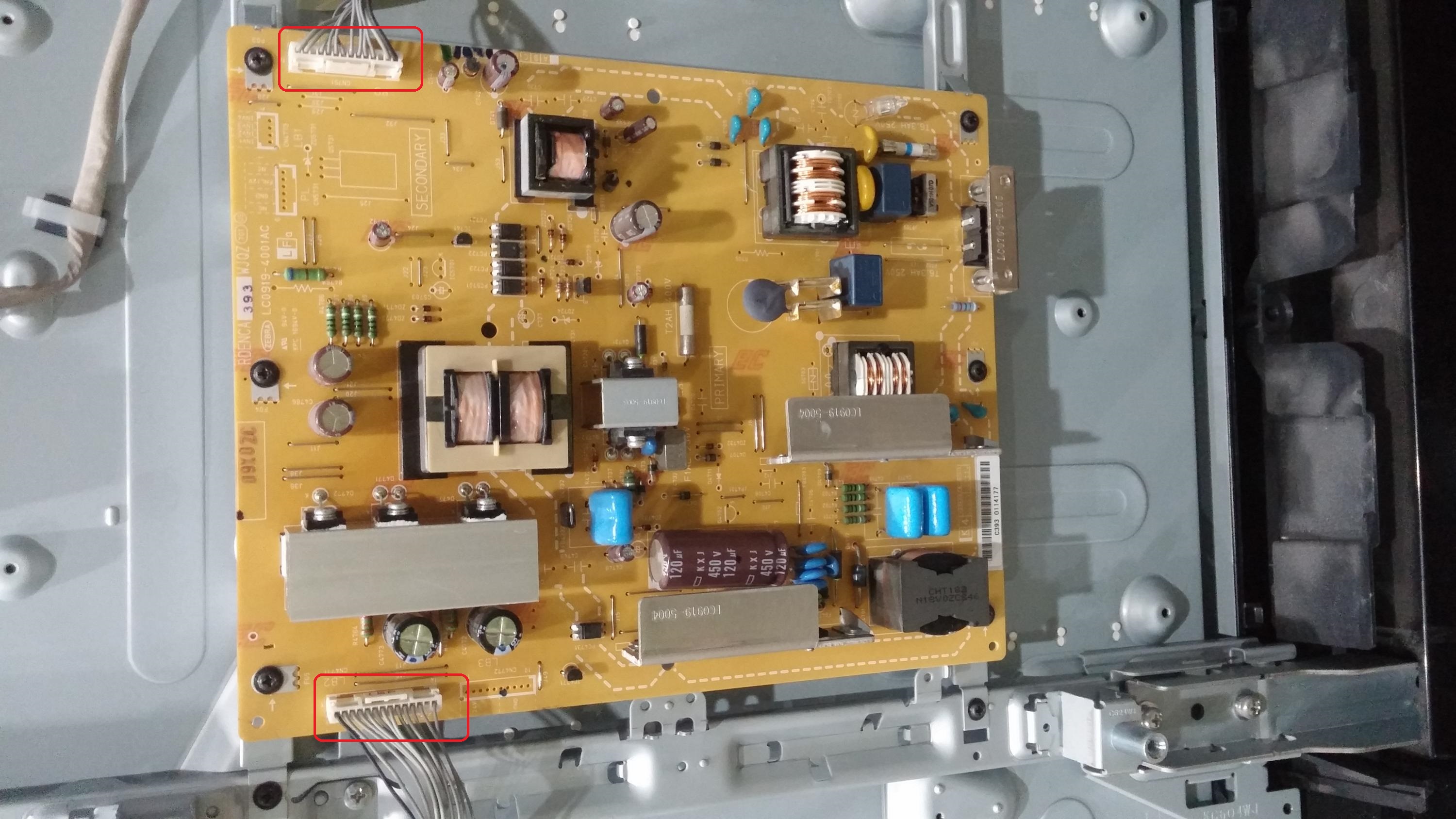

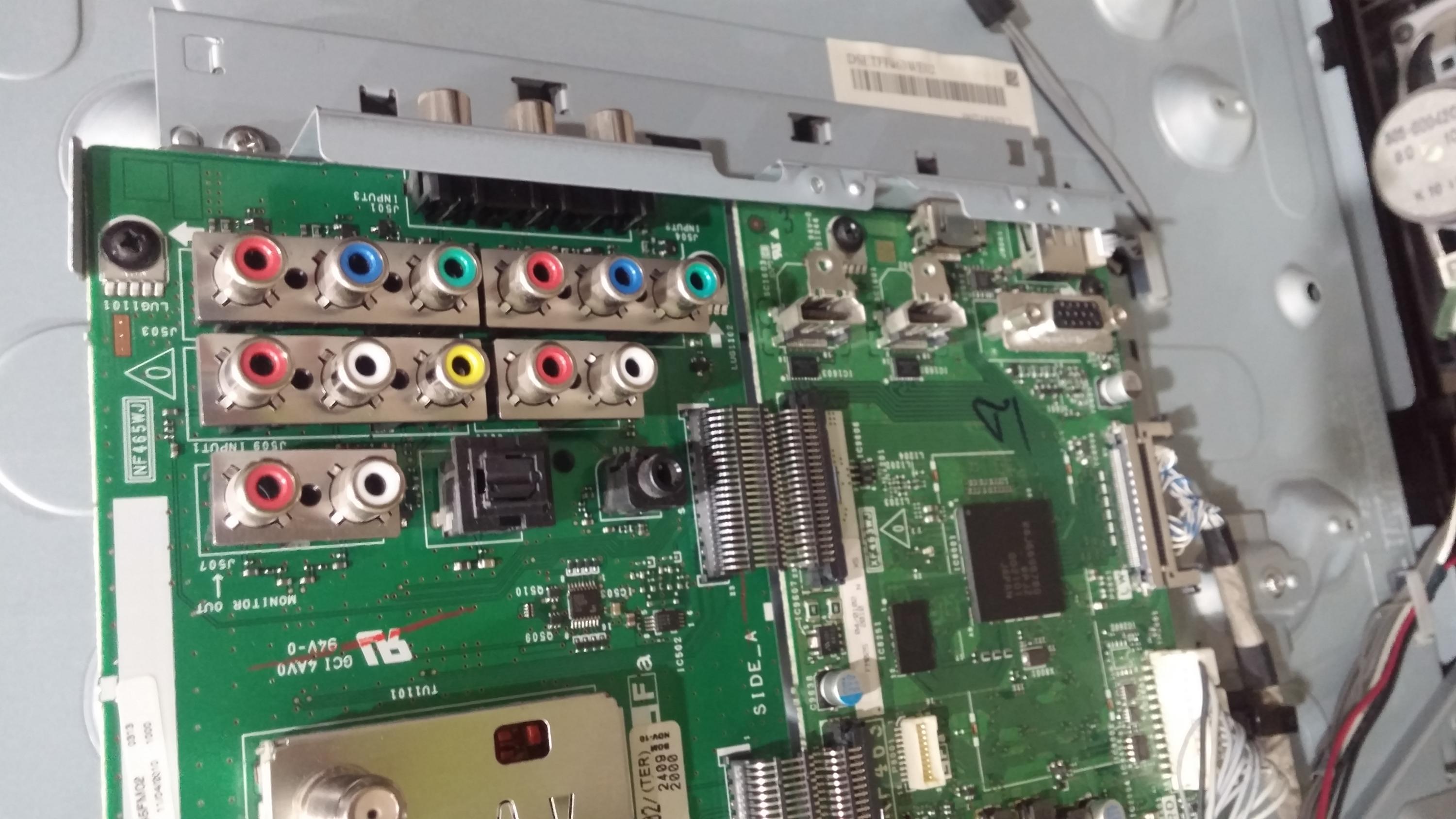

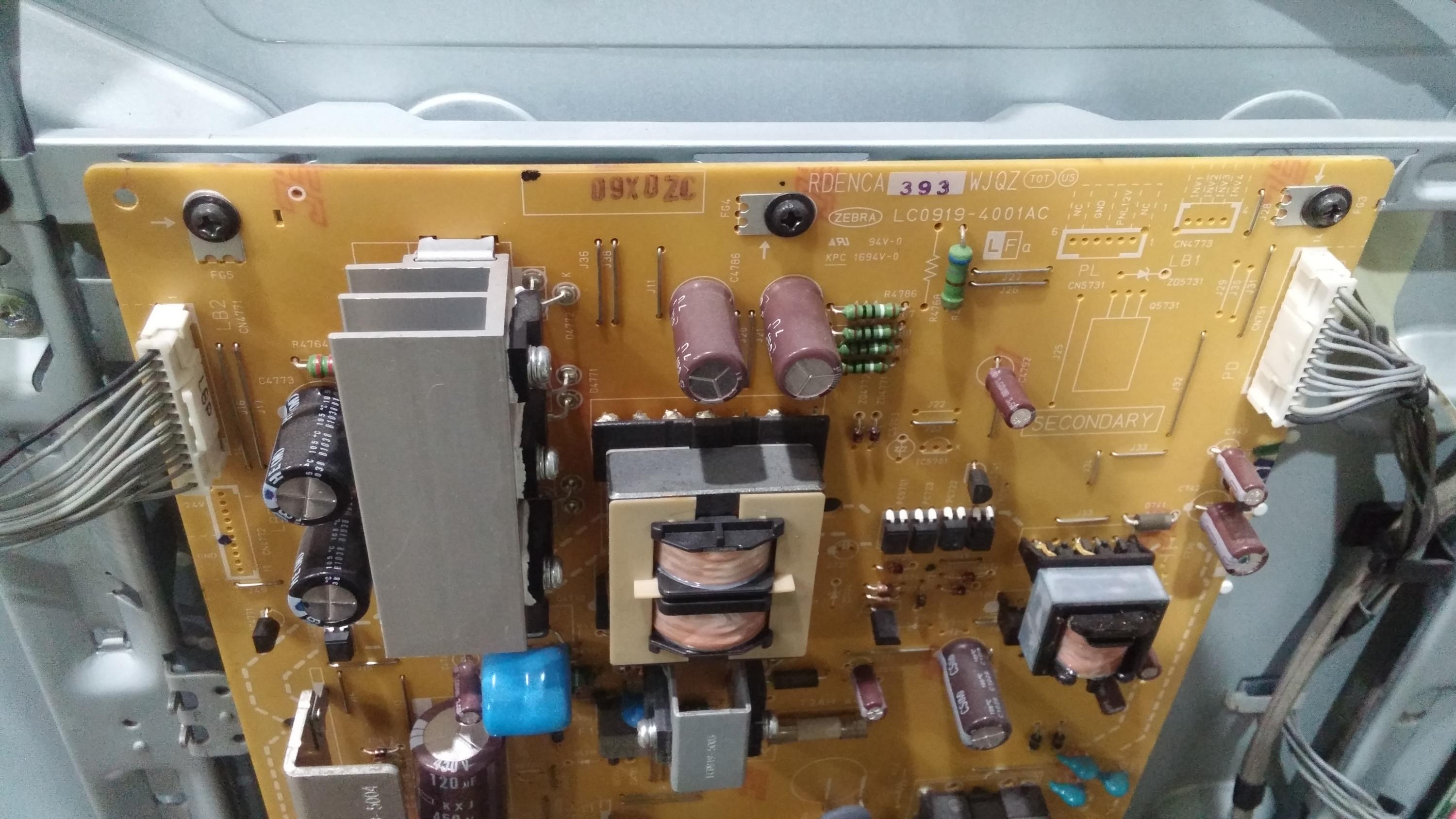

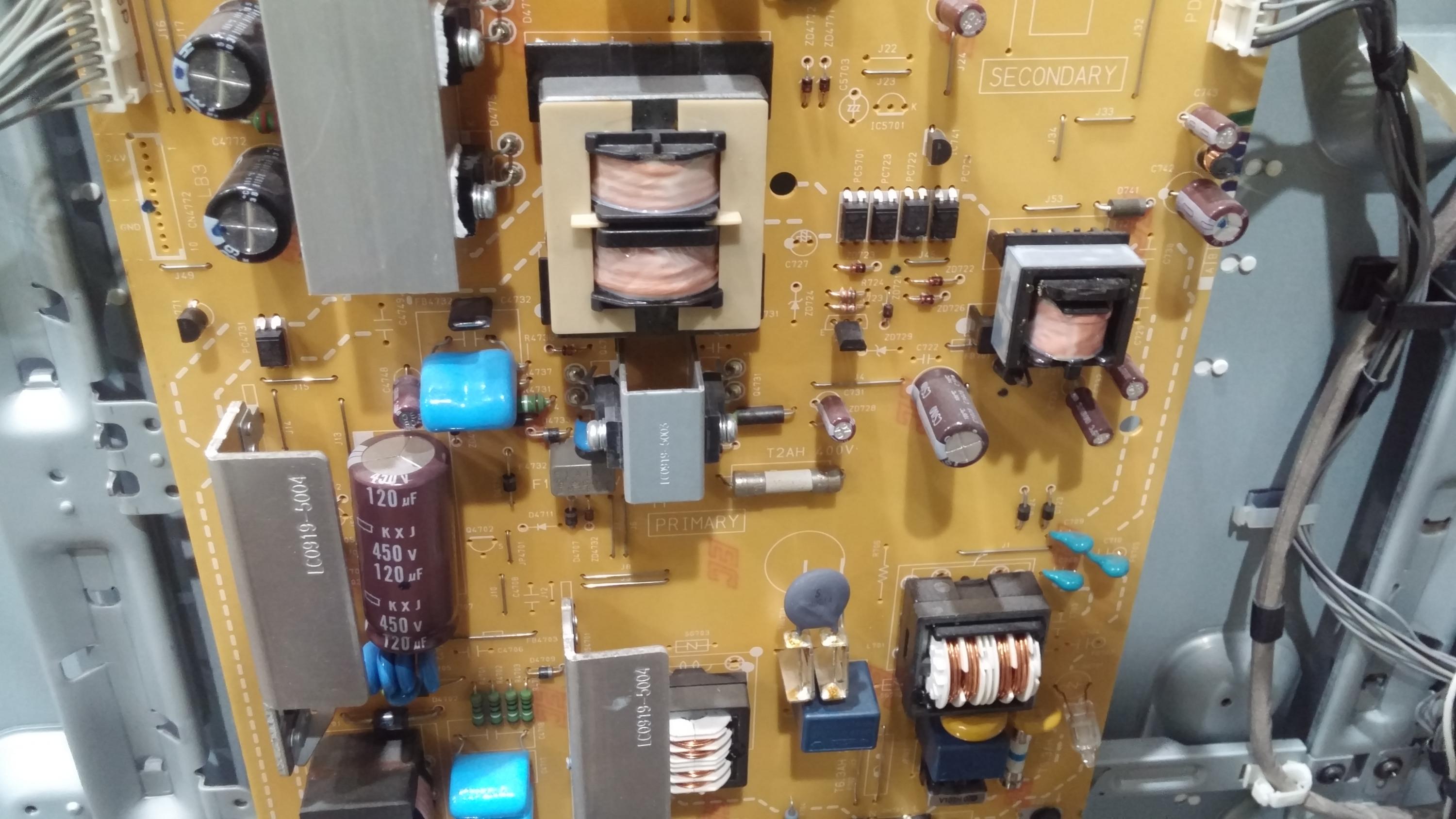

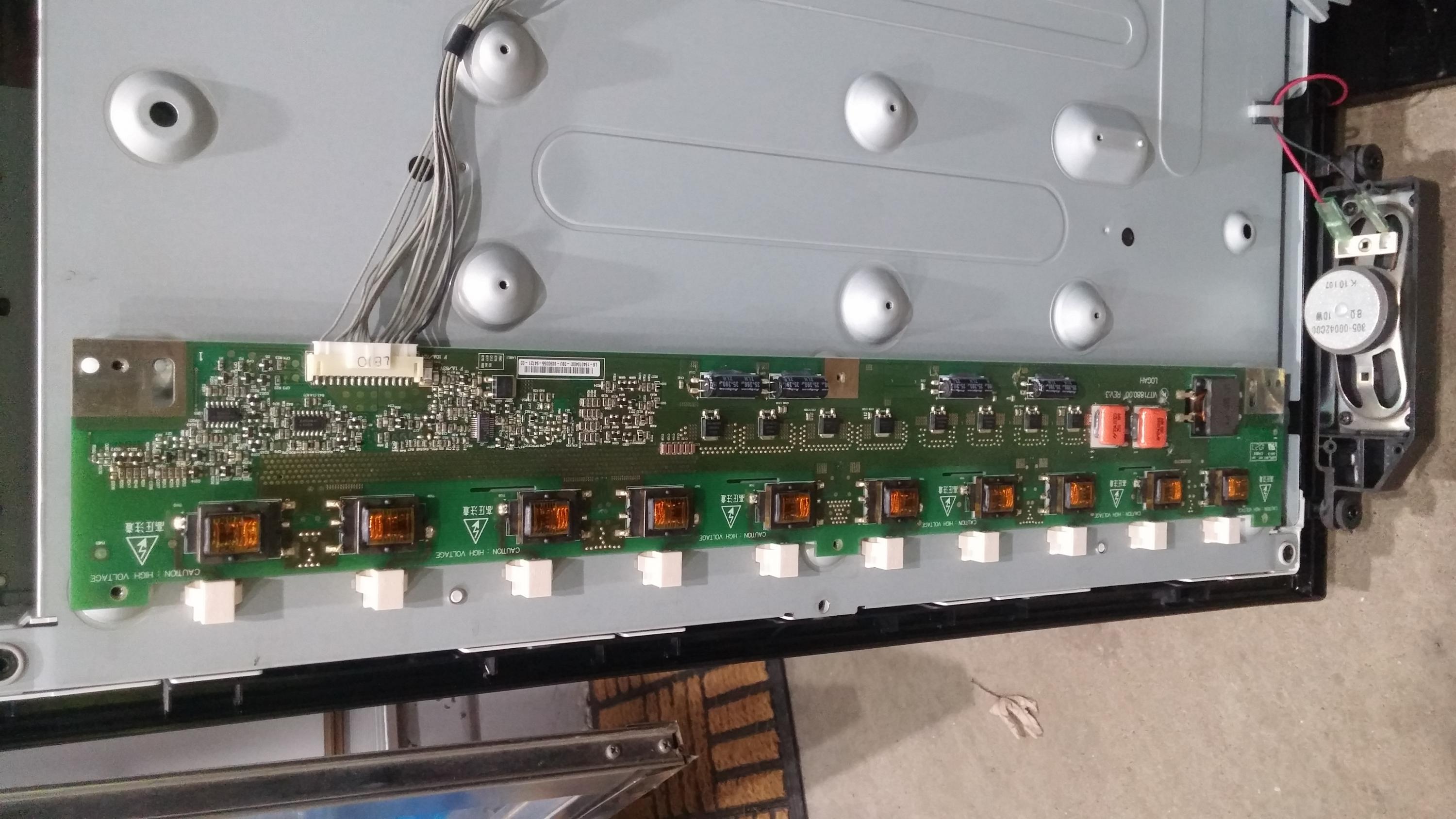

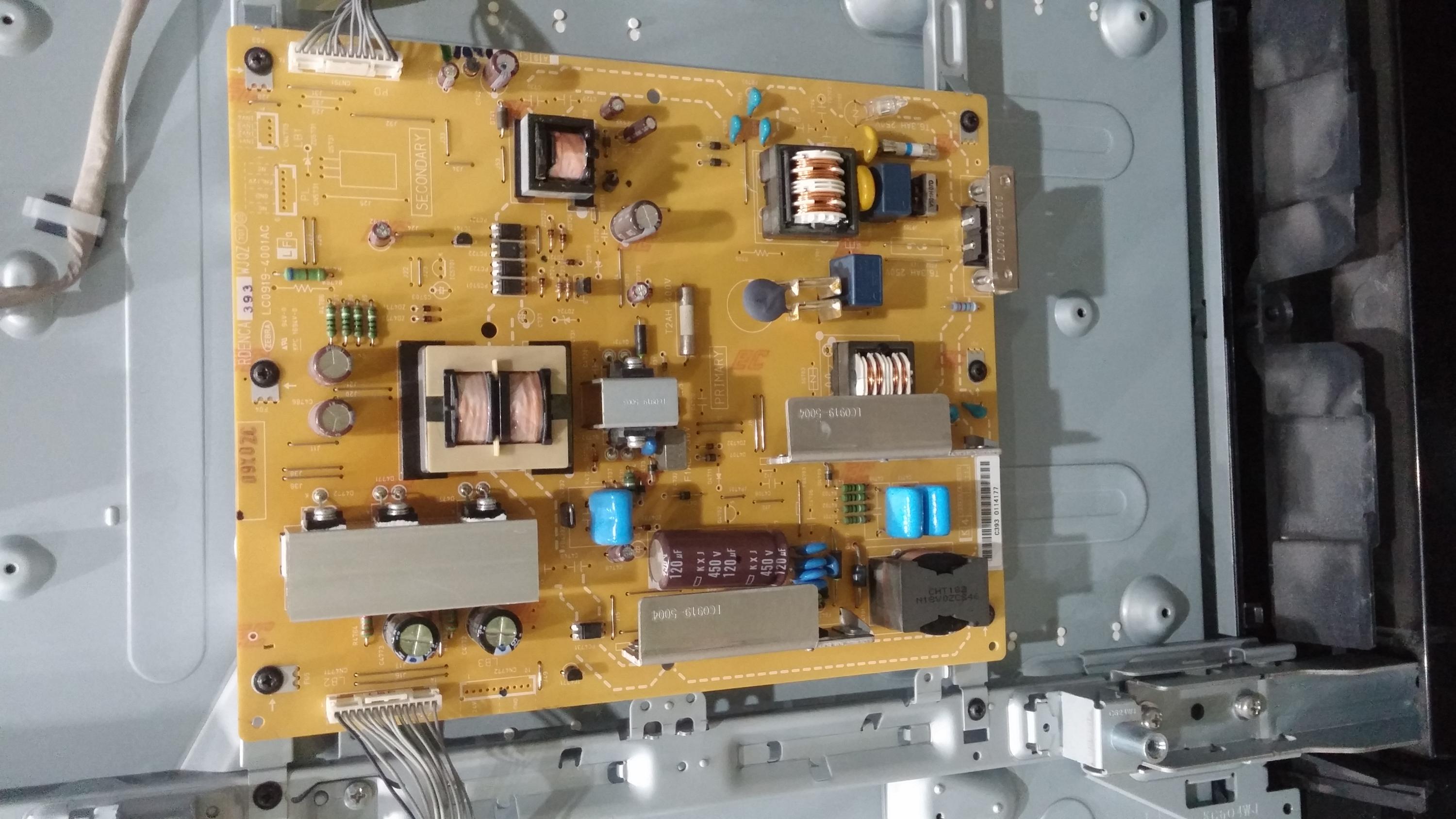

    Adding pictures of the boards on the back of the tv

        start by verifying / recording all the voltages that are printed on the boards (power, tcon, main) usually in and around the connectors. Go from there.
        you can try disconnecting the tcon and see what happens (probably not much). Further there are fuses on most tcons, check them.

                Thank you dick_barton when I was initially doing this TV I wasn't sure how to properly test the voltages but I learned a lot from the last TV I just fixed. Using your photo with the connectors highlighted, the connector at the top reads like this.
                GND-0
                PNL-0
                POW-0
                Bus5v- 5V
                Pson- 3V
                ACDET-0
                INV4-0
                INV3-0
                INV2-0
                INV1-0
                12V-0
                Bottom Connector:
                24V-0
                GND-0
                INV1-0
                INV2-0
                INV3-0
                INV4-0
                I also took the voltage readings of the connector from the power supply to the main board. I got a 0 reading from all pins besides the 4th pin from the left on this connector read 5V. The only other connector that I got any voltage reading on was the connector from the button panel to the main board. There are 4 pins the first pin going from left to right was 0, the next was 3.3V, and the next 2 read 3.2V. I got a 0 reading from all other connectors on the board. Any help from here is greatly appreciated.
                  I'm a little confused here. One connector has 14 positions with only 13 wires connected so doesn't match up with your table above. The second connector at the top of the picture also has 14 position of which 2 are not connected.
                  Connector xxxx (photo post#7 top connector)
                  Pin1
                  Pin2
                  .....etc.
                  Pin12
                  Pin13
                  Pin14
                  Connector yyyy (photo post#7 bottom connector)
                  Pin1
                  Pin2
                  ......etc.
                  Pin 13
                  Pin14
                  • dick_barton
                    • Aug 2015
                    • 6643
                    • Wales
                    CN4771
                    Pin 1,2,3,4,5, [24V]...........0V
                    Pin 6,7,8,9,10, [GND]
                    Pin 11, [INV1]..................0V
                    Pin 12, [INV2]..................0V
                    Pin 13, [INV3]..................0V
                    CN751
                    Pin1,2, [12V]............0V
                    Pin3, [INV1].............0V
                    Pin4, [INV2].............0V
                    Pin5, [INV3].............0V
                    Pin6, [INV4].............0V
                    Pin7, [AC_DET].........0V
                    Pin8, [PS_ON]..........3V
                    Pin9, [BUS5V]..........5V
                    Pin10, [POW]...........0V
                    Pin11, [PNL]............0V
                    Pin12,13,14, [GND]
                    If you disconnect the mainboard and power up the set do the backlights come on.
                      Are the Voltage readings with all the connector in place?
                      "ACDET-0" If that is true reading with all the connectors in place then it is not normal, it should be >2V if I remember it correctly, this will cause the main board not to send out the command signal to turn on the power supply because it thinks the incoming AC to the the TV is not in the operating range. The common cause of the bad AD DET is sue to bad Opto-isolator or the resistors network for the incoming AC sensing circuit.

                        CN4771
                        CN751
                        Pin12,13,14, [GND]
                        Disconnecting the mainboard and powering up does nothing but shut the red blinking LED off. I get nothing else happening from the TV.
