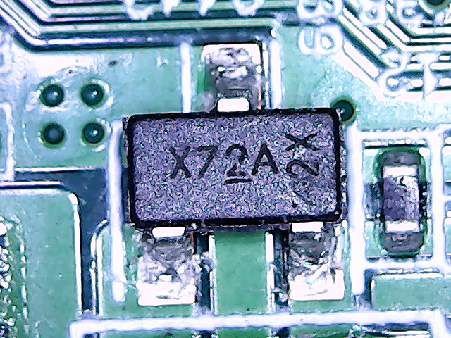

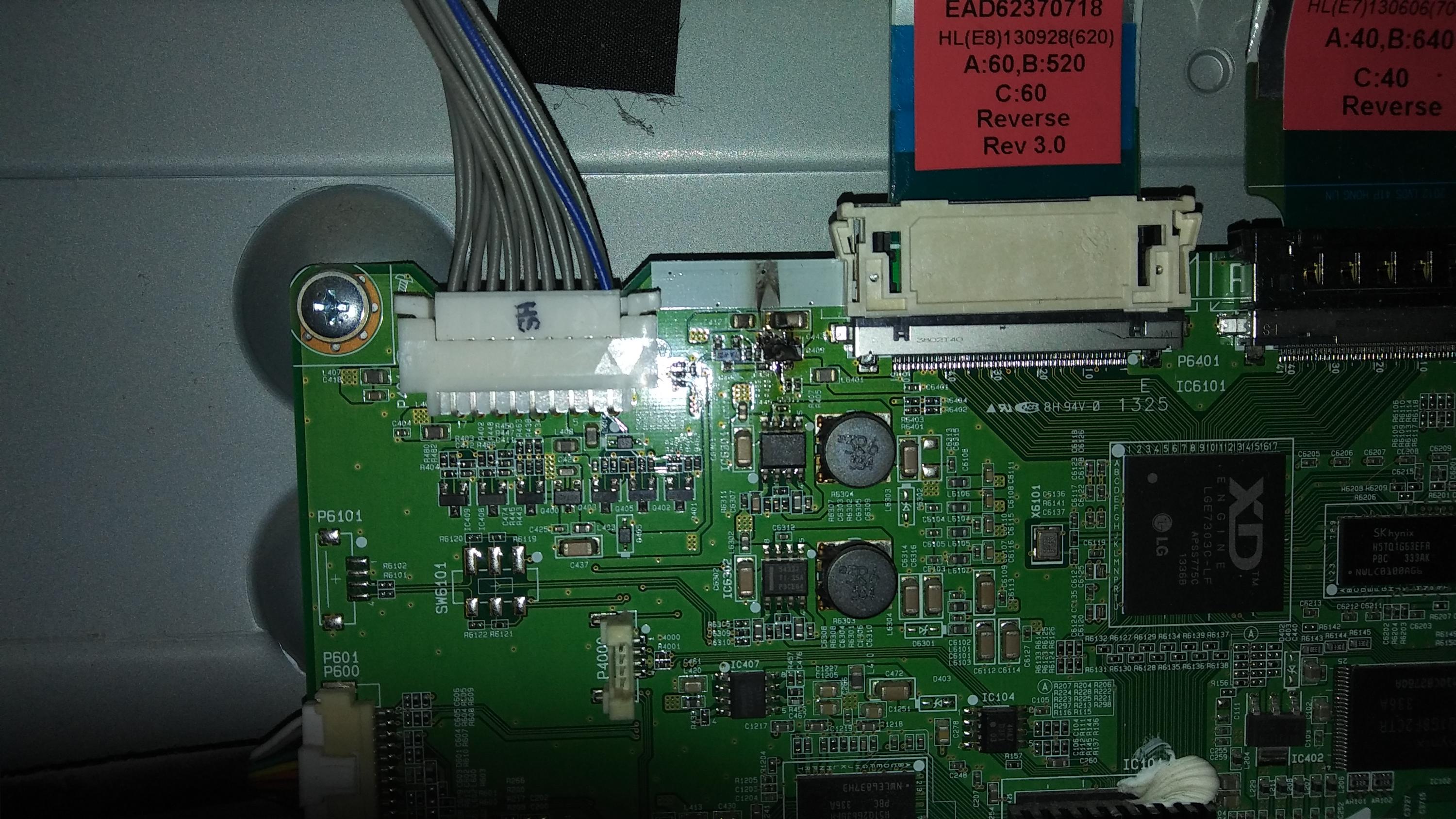

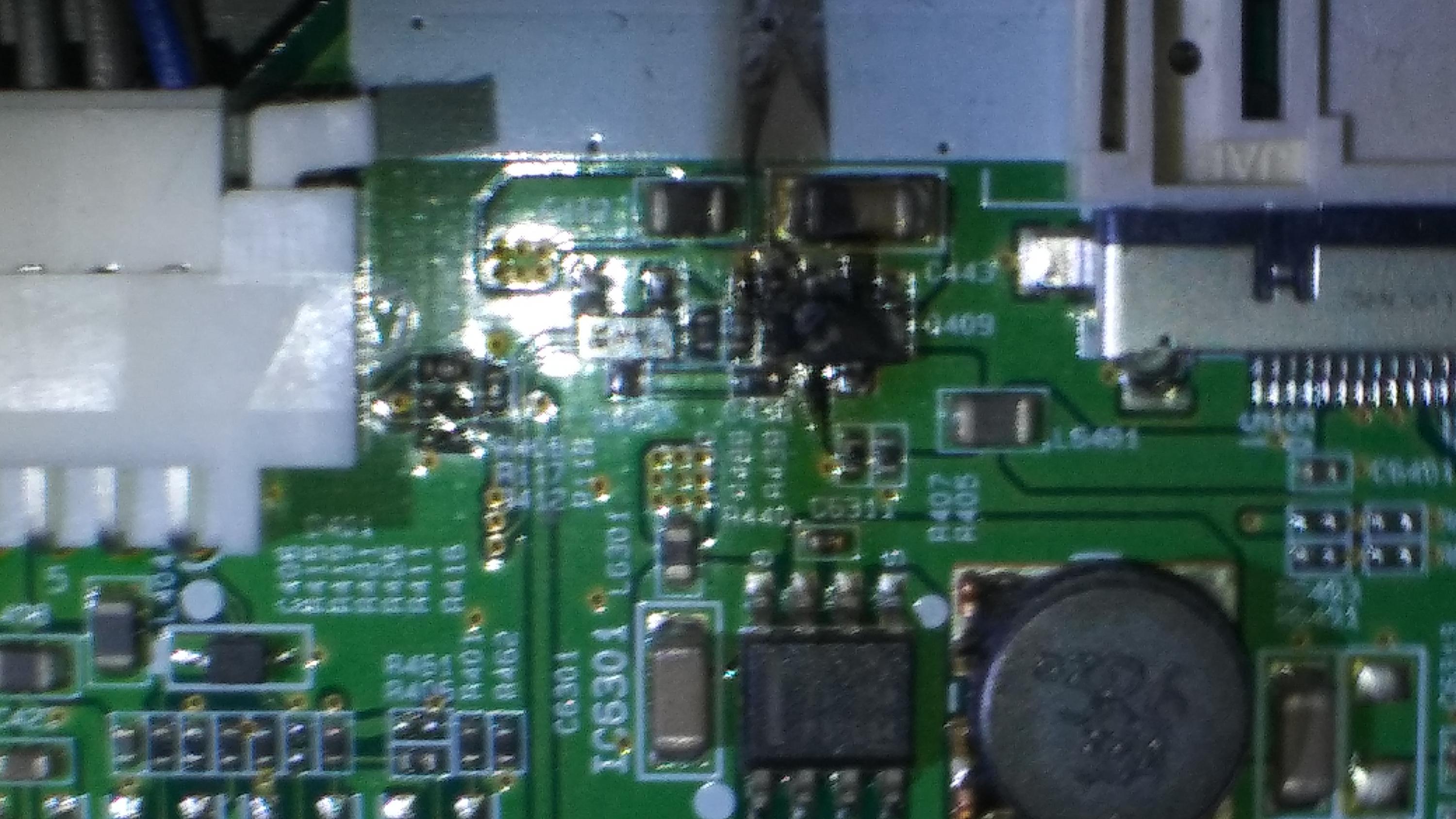

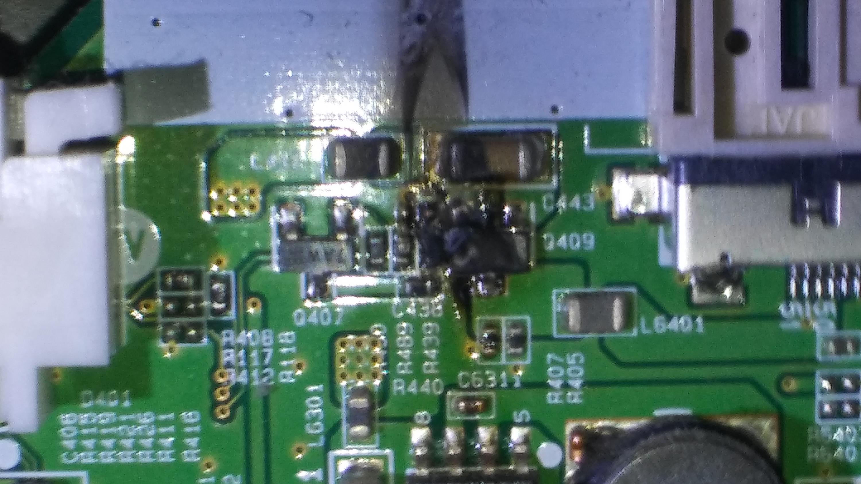

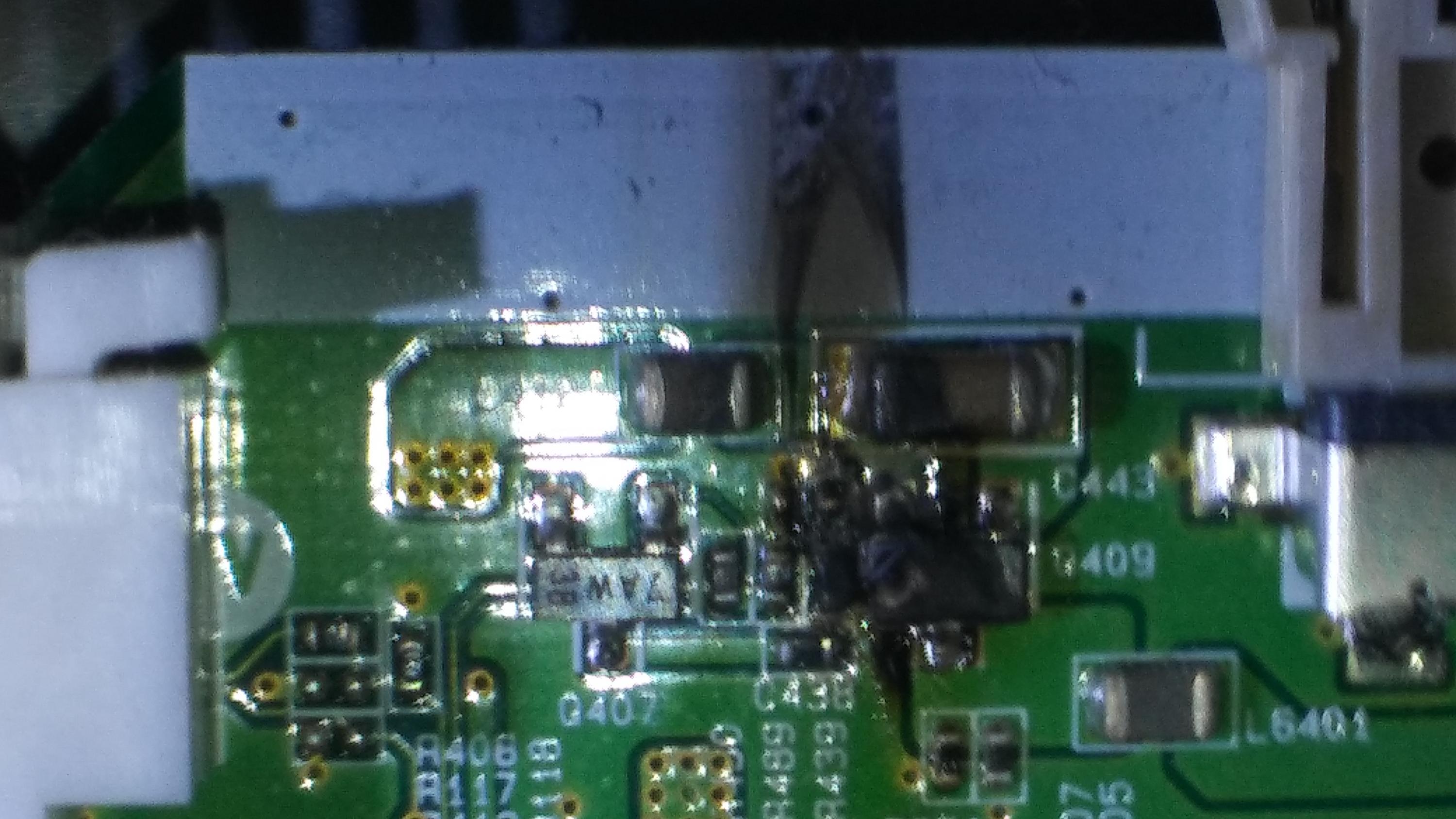

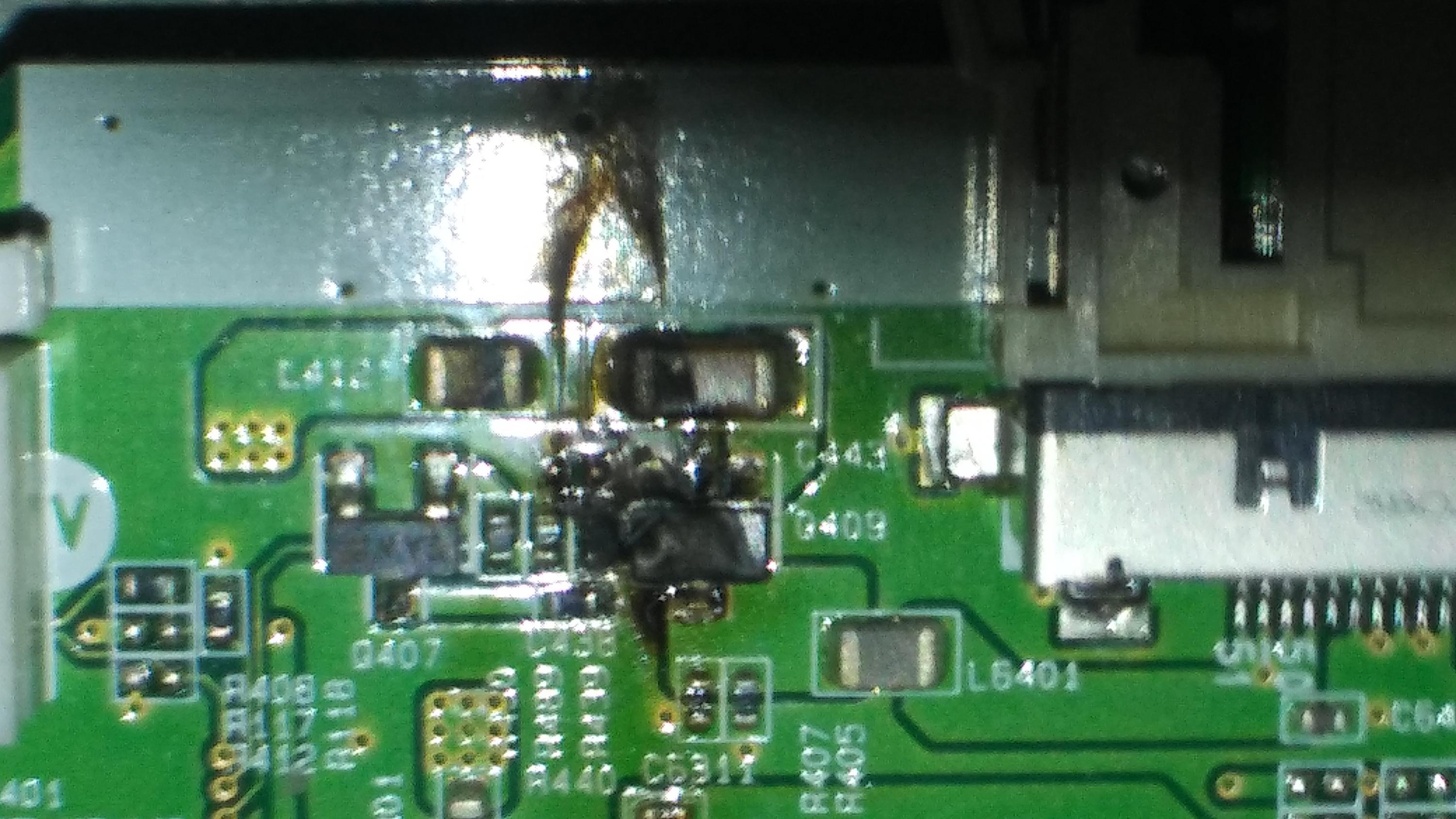

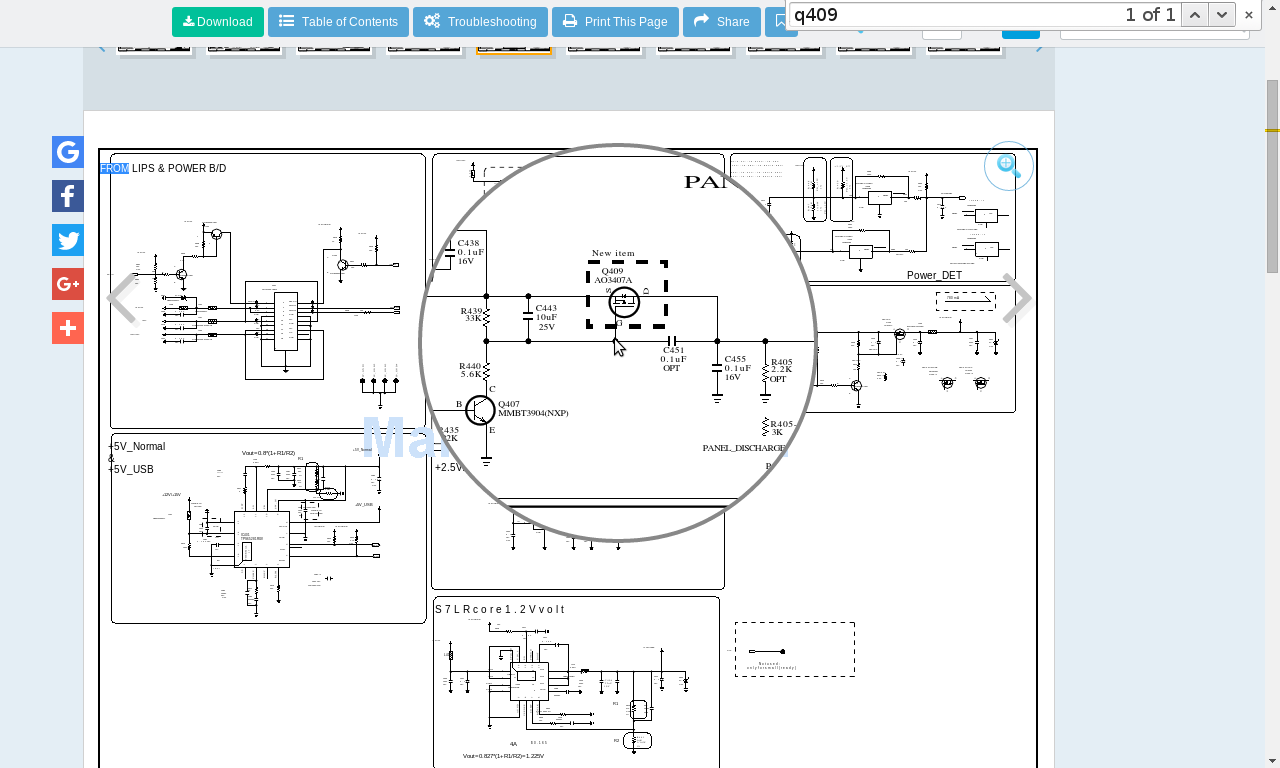

    LG 60LN5400 Q409 burn
    Instead of order the motherboard try to fix myself to save $100...The estimate is at 3.....

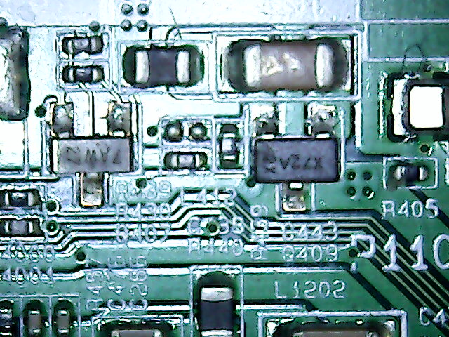

    Re: 60LN5400 Q409 burn

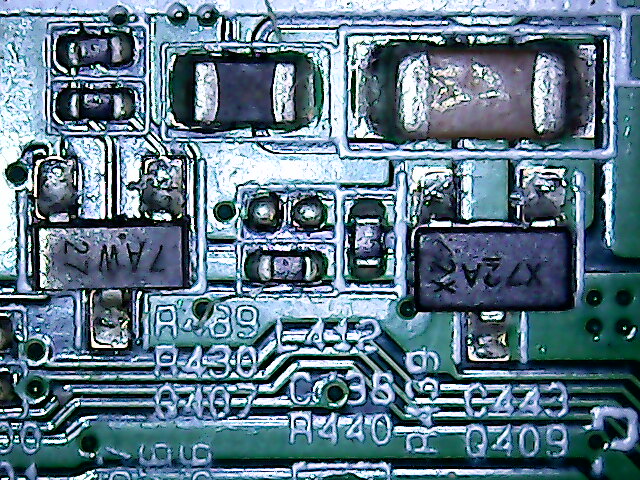

    The SMD Codebook
    http://www.marsport.org.uk/smd/mainframe.htm
    It shows Q409 maybe is this:
    X7 BZX84-C47 Zet C SOT23 0.3W zener 47V±5%
    X7 CMDZ5227B CSC I SOD323 250mW zener 5% 3.6V
    Q407 shows is this MMBR901 SOT23 npn RF MRF901.
    Service manual only found this 55LN5200UB, i cant see its bury....

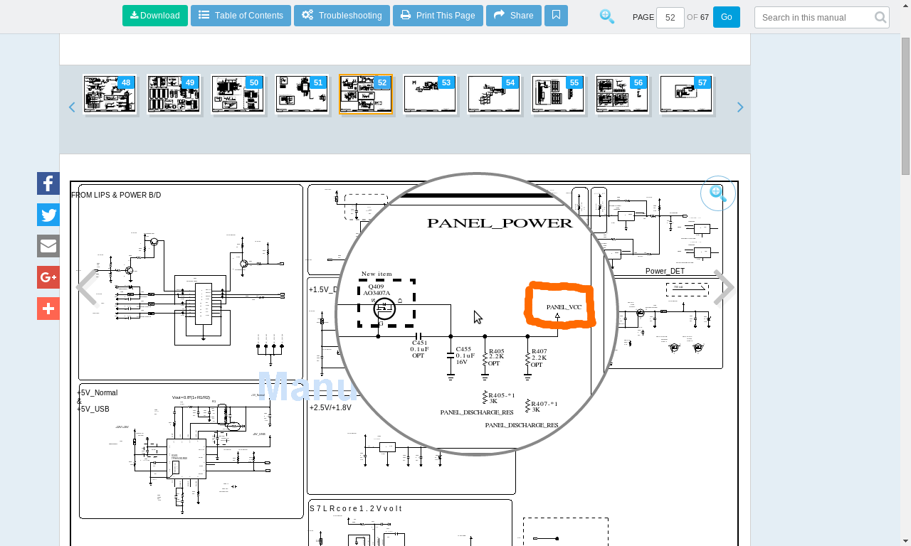

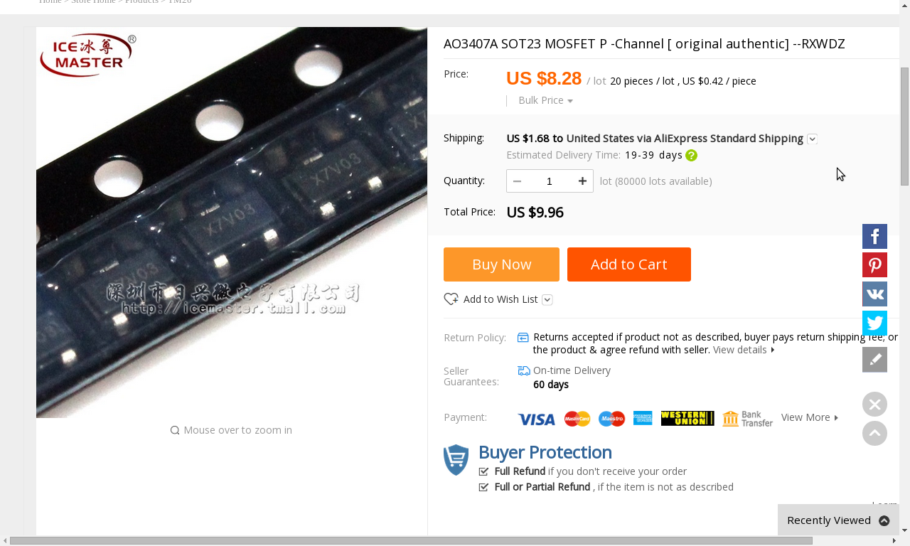

      Service manual I found it! i am so cheap don't want pay nothing...
      http://service.minjja.lt/files/?id=5982
      https://www.manualslib.com/manual/79...e.html?page=52
      Q409 is AO3407A 30V P-Channel MOSFET:...........................
      https://cdn.badcaps-static.com/pdfs/...fa1ec3aa2d.pdf

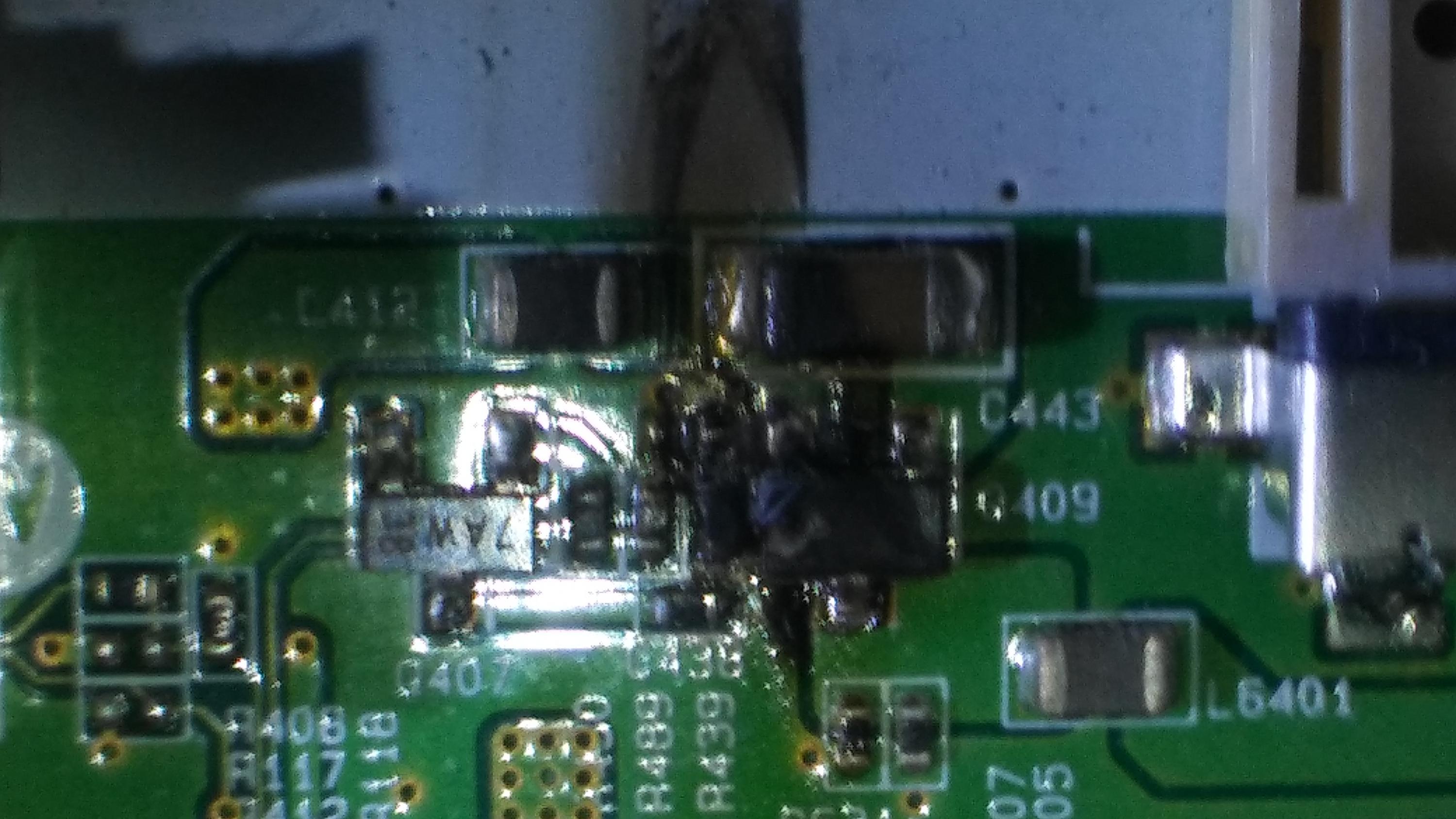

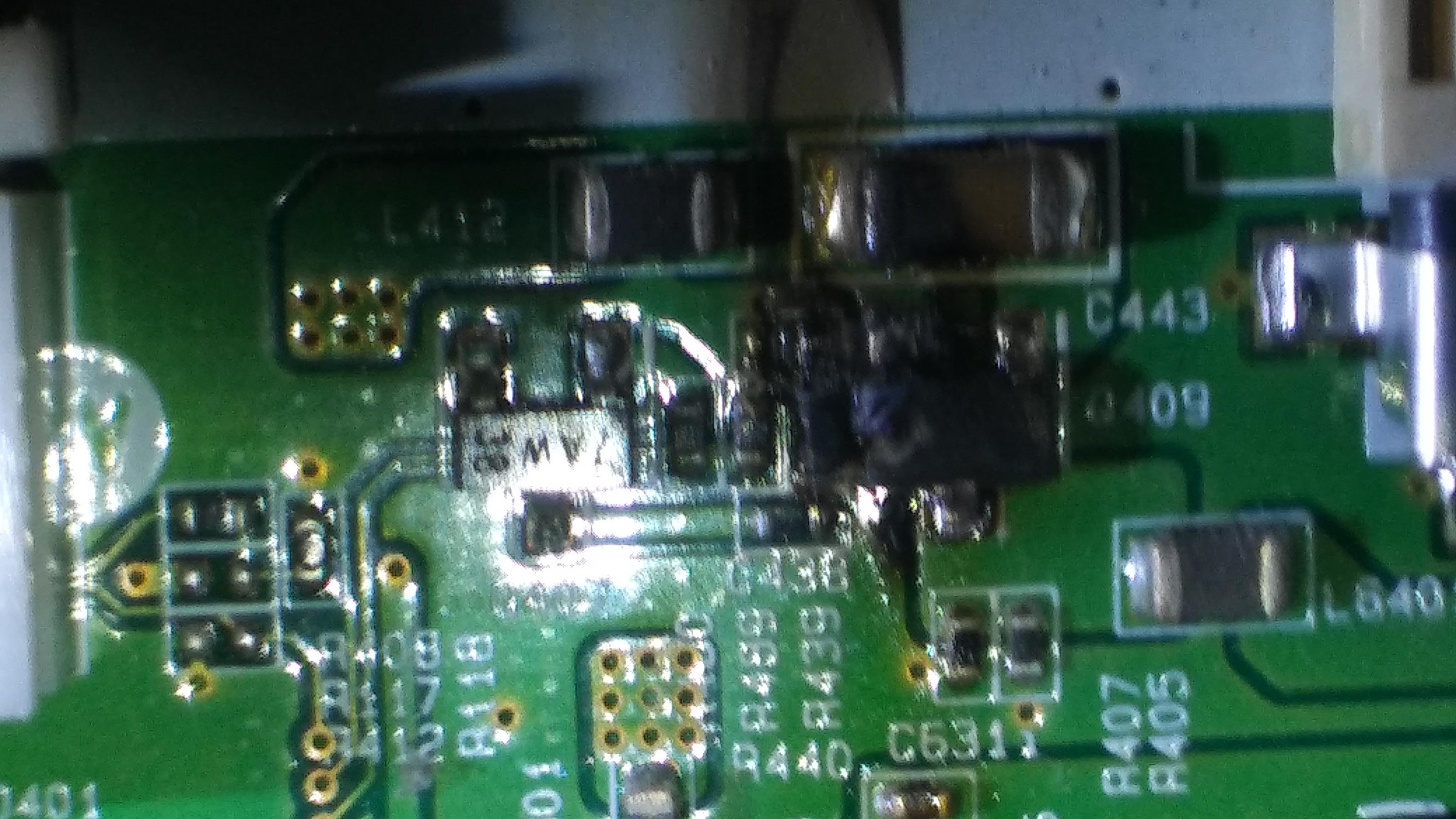

        Bad news, the Q409 is a switch for panel_Vcc, I doubt about TV panel has A short, need to find the pinout, then check the short.
        PS: I checked it has 121 ohm between tv chassis ground to panel_Vcc ( from T-con board), look like has A short to me.
