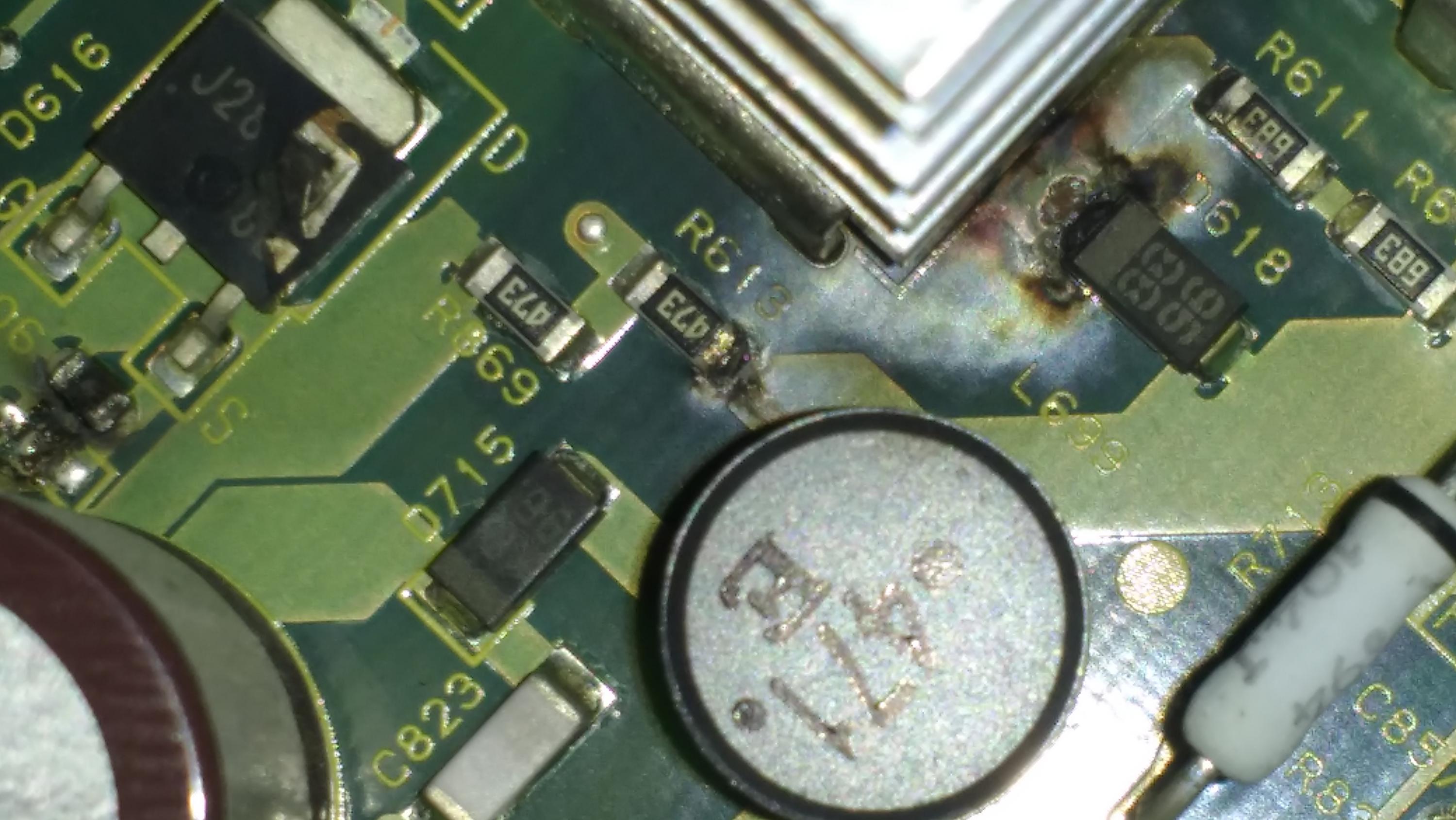

                                #35
                                Re: Panasonic TCP50S1
                                Ok. Thanks for you help.
                                And upon further inspection, I noticed this. I wonder if this happened before or after the jumper incident.

                                  #36
                                  This probably happend both times. You heard a pop which resulted in a 7 blink error. Maybe it took another hit when you used the jumper. With the jumper you tell the tv to turn on without the buffer boards. My guess is that the voltage finished the rest what was already "dead".
                                  Its best to remove the buffer boards completely from the tv and test them as in this video:
                                  https://www.youtube.com/watch?v=51SZsfH60EY
