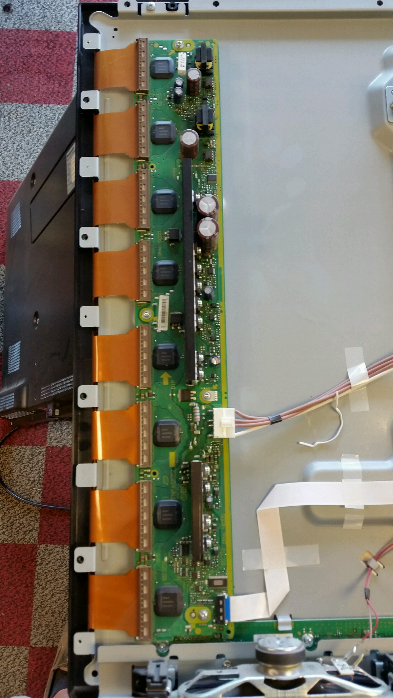

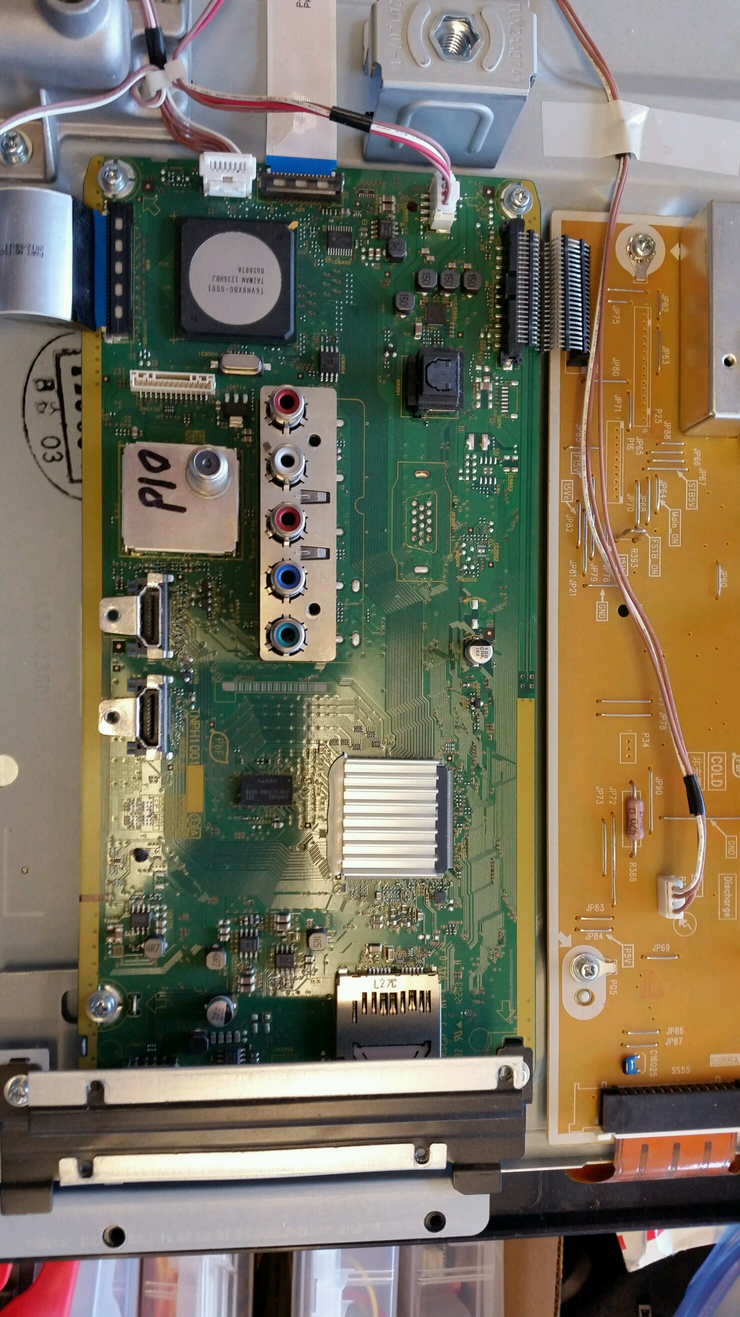

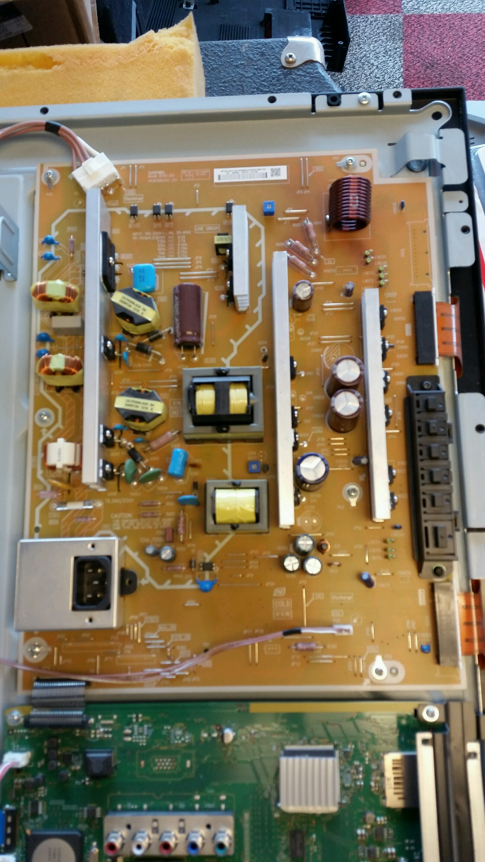

      Re: Panasonic TC-P42X5 , red led solid , no clicks , nothing seems to be working
      photos attached
        Mainboard is bad.
          power supply board? or A Board?
          • tvtimmy
            • Mar 2015
            • 1160
            • usa
            A board.
              Fixed one of them today, common issue on the Psu is 5vstby Ic failing intermittently. However I would say your is a bga solder issue on the GPU (big unheatsunk chip) give it a reflow see if it works.
