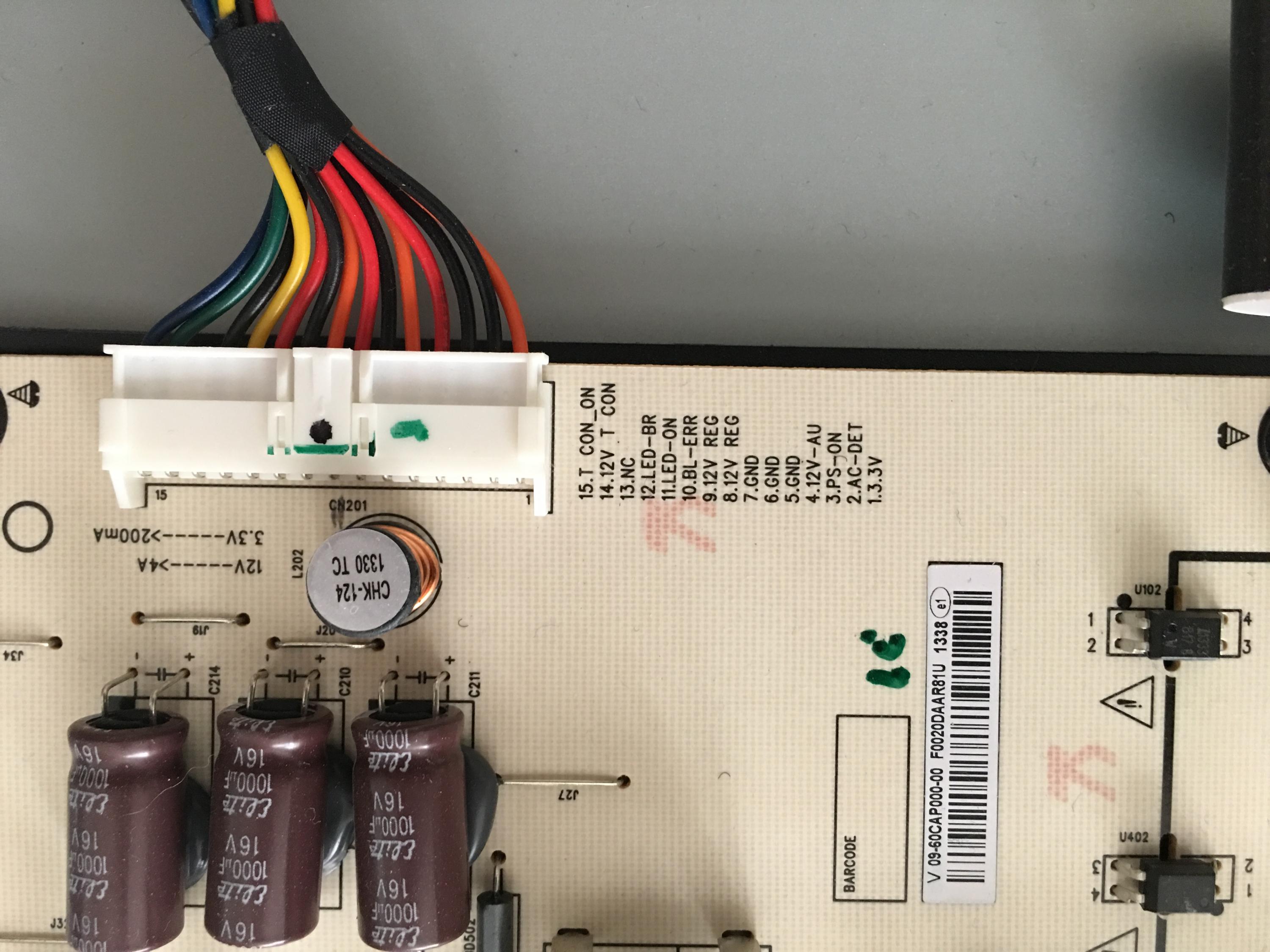

      Re: Vizio e601i-a3e - No Backlight
      Can you post a photo of the connector and legend alongside since pins 1 - 15 don't mean an awful lot without it.

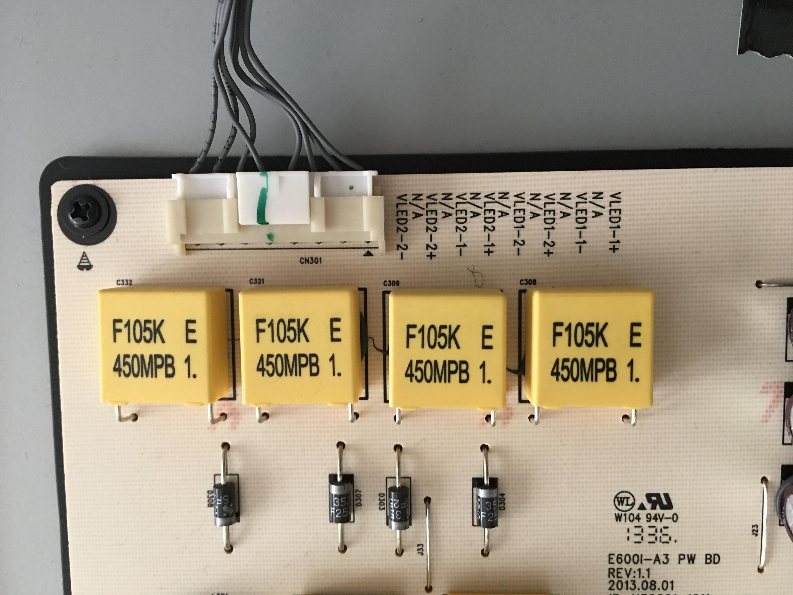

            - Attached LED connector pic
            - Watched video (dont know how I missed that one)
            When I first turn on the tv I get a reading at (VLED1-1+) of 15v - 16v and then it drops to 0 like you said.
            I watched the video and tested the pins like shown
            LED connector, Connected
            all pins = 0.0's
            LED connector, NOT Connected
            all pins = 0.0's
            Is there anything else to try before buying a new power board?

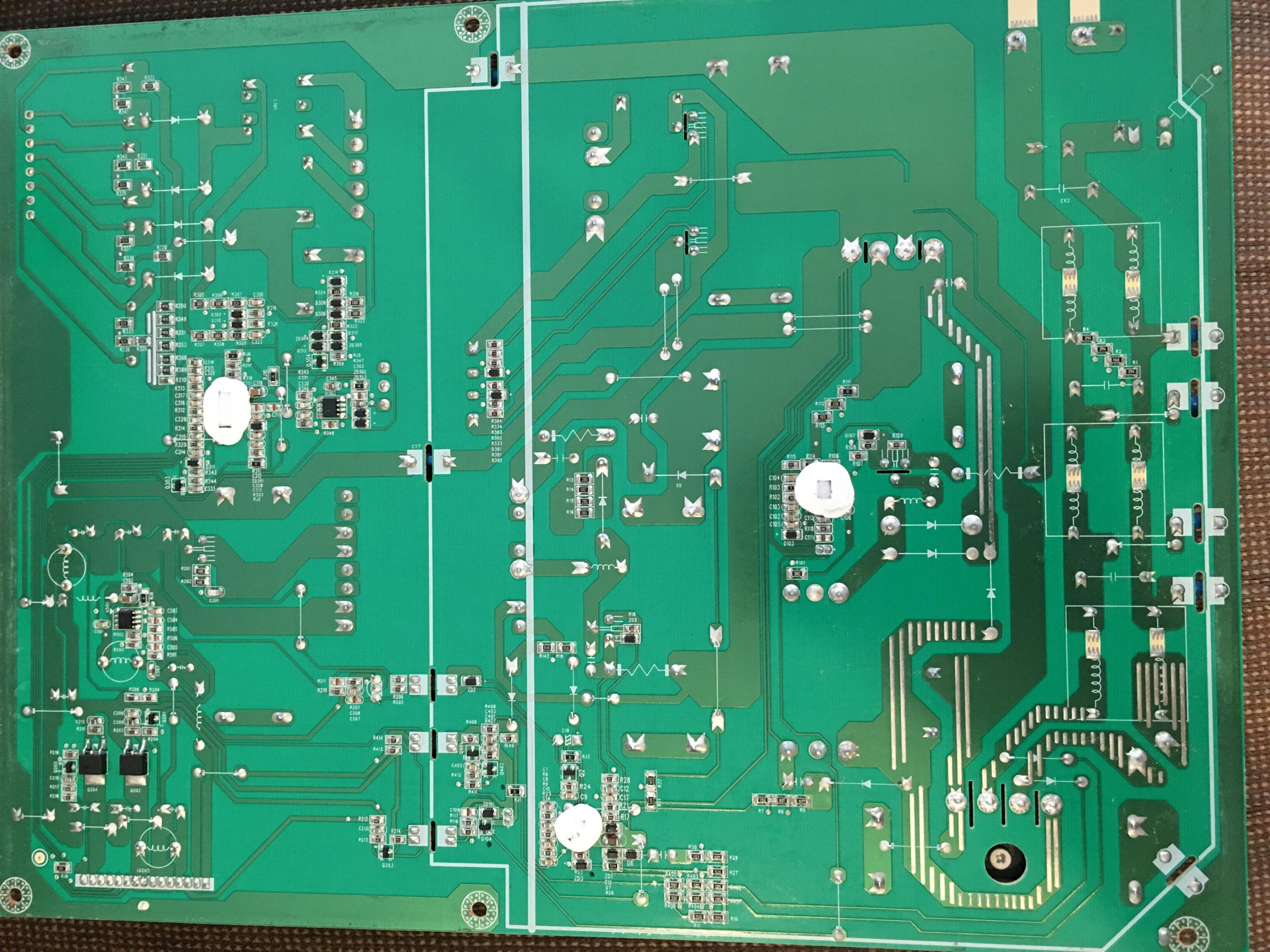

              Post a sharp picture of the underside of your board so that the IC's can be clearly seen. If you add it as an attachment it makes it easier to zoom in.
                  What is written on top of U302?
                  Edit
                  I think the led driver IC of interest may be under the white blob close to U302.

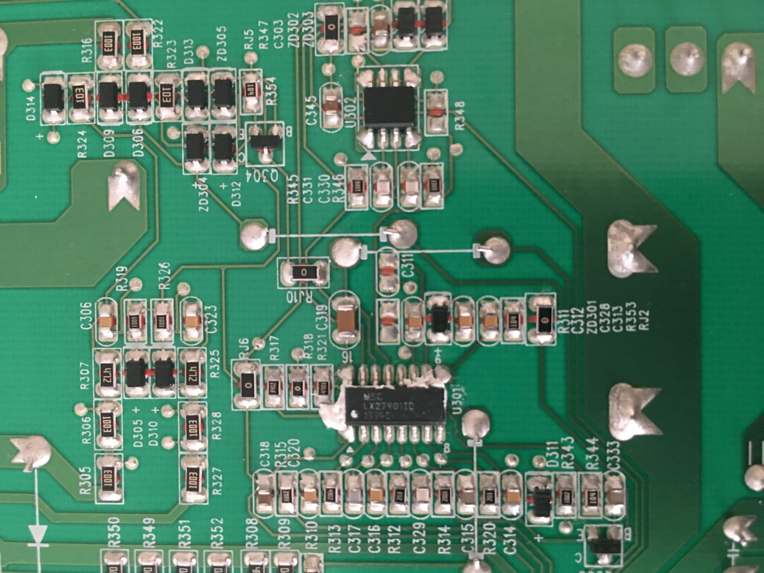

                    picked the white blob off..
                    • dick_barton
                      • Aug 2015
                      • 6643
                      • Wales
                      That is the LED controller chip. Can you carefully measure the DC voltages at the following pins of the LX27901IC
                      Pin 1 = VCC
                      Pin 2 = Enable
                      Pin 7 = Fault
                      Pin 16 = VDD
                      Can you also check D303, D304, D307 & D308 with your meter in diode mode.
                          Unfortunately it's not that unusual that the OP never closed the thread with working / not working / replaced?
                          Post your voltages as per post 6 giving pin number, name and voltage read on pins 1 to 15
                                  Code:
                                  Pin 1.   3.3V     3.3V
                                  Pin 2    AC_Det    3.41V
                                  Pin 3.   PS_ON     3.26V
                                  Pin 4    12V_AU    12.3V
                                  Pin 5.   GND
                                  Pin 6    GND
                                  Pin 7    GND
                                  Pin 8    12V_REG   12.3V
                                  Pin 9    12V_REG   12.3V
                                  Pin 10   BL_ERR    3.28V
                                  Pin 11   Led_On    3.26V
                                  Pin 12   Led_BR    0.49V
                                  Pin 13   NC
                                  Pin 14   12V T_Con   12.32V
                                  Pin 15   T Con_On   3.19V
                                  The voltages appear to be OK. I'm not sure about BL_ERR (3.28V)
                                  Using a bright light can you see an image on the screen. You may have to angle the light and press the menu button on the remote so as to have an image.
                                  I would next check the voltages at the connector shown in post #6. Put you meter on each terminal and chassis then power up and see how high the voltage rises and report. Repeat for each terminal pin.
                                  • kamlesh1011@yahoo.com
                                    • Aug 2020
                                    • 9
                                    • us
                                    Using bright light I can see image. I checked voltage at the connector
                                    vled1+ 8.2
                                    0.02
                                    0.0
                                    9.3
                                    8.3
                                    0.01
                                    0.01
                                    7.6
                                    • dick_barton
                                      • Aug 2015
                                      • 6643
                                      • Wales
                                      Can you check the voltages at LX27901IC as per post #11
                                      And do you have a well focused photo of the power supply board
