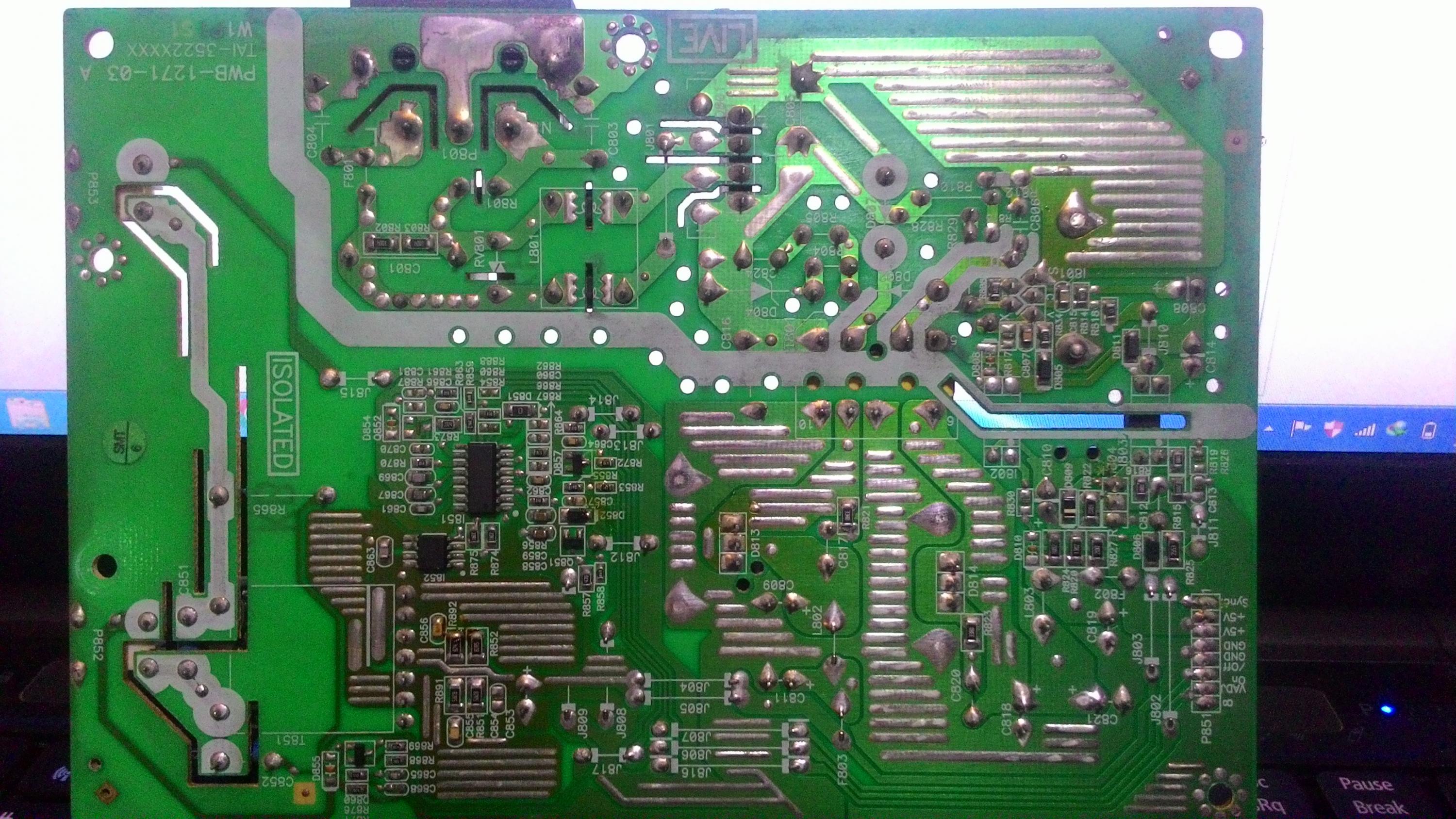

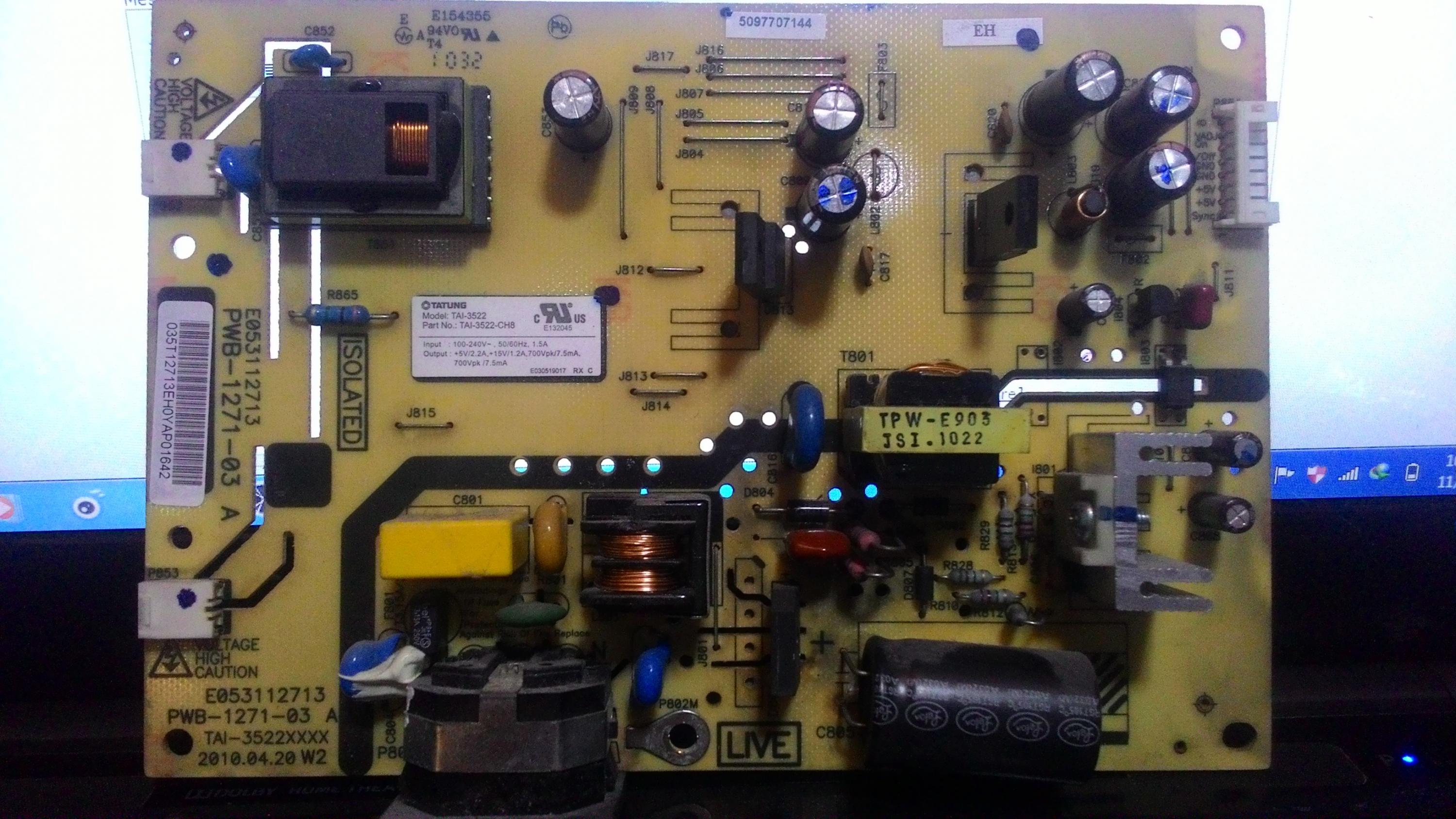

    here the actual image of PSU Model PWB-1271-03 A E053112713
    no caps blowted....
    any advice...

                          now i have clue in psu are. may be on cold area i don't know which part are fault? Help me to find. Thanks

                            R853 does not look right. Is there solder bridging the two ends????
                              thanks for notice the bridging. but i already to clear up. but same auto off 10 mins.
                              did you think the Inverter driver ic? 16 pins 851 ic or 8 pins 852 .
                              or other else on Cold area
                                Re: Viewsonic VA1931W Auto Off after 10 to 15 minute..
                                I would run a soldering iron over as many of the connections as possible. D813 for example looks as though the pins are poking through the solder and poorly attached however it may well be the photo angle, but I would check that.
