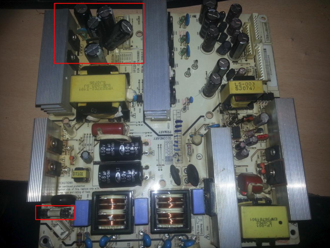

    Hello guys i have here LG 32LB75...
    PSU is YP32DVR ===> P/N: EAY43596801 rev. 1.0

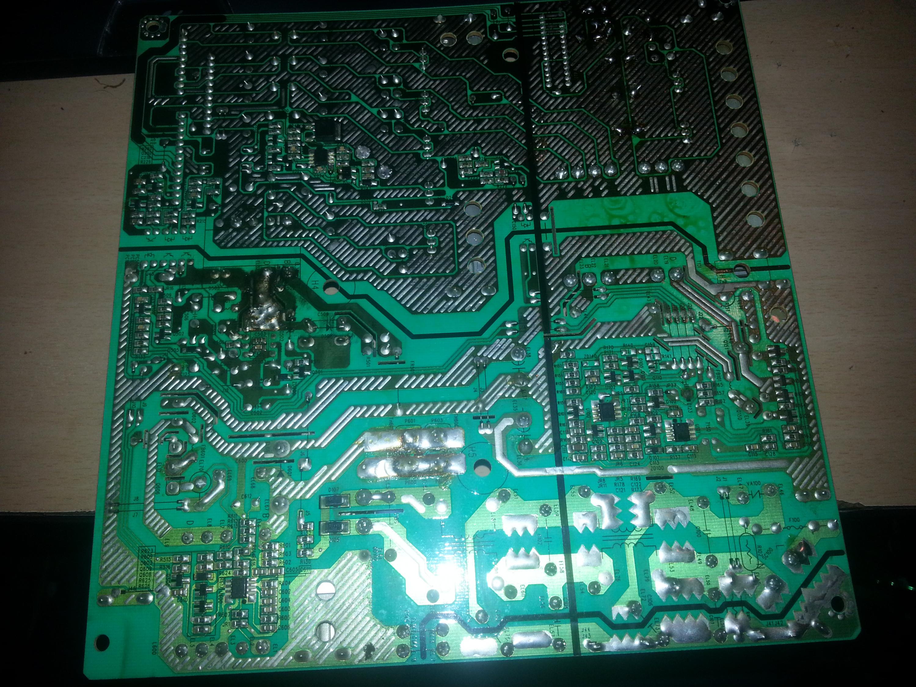

    It has a blown 250v 5a fuse marked in the picture... and previously changed by someone else caps that are again blown also marked in the picture... Update: there are signs of post production soldering on resistors R253 and r254 also located near blown caps.
    I dont have original values of blown caps... and what should i also check before I replace all of this... if it will work at all.

    I changed all the caps and a fuse... Fuse blew up again... Something is shorted... What should i do next?

      Re: LG 32LB75 PSU not working
      Test for short circuits lol mainly devices mounted on a heatsink.
        Newsflash... we have a hole on U101...
        Cant upload picture to site so here it is...
