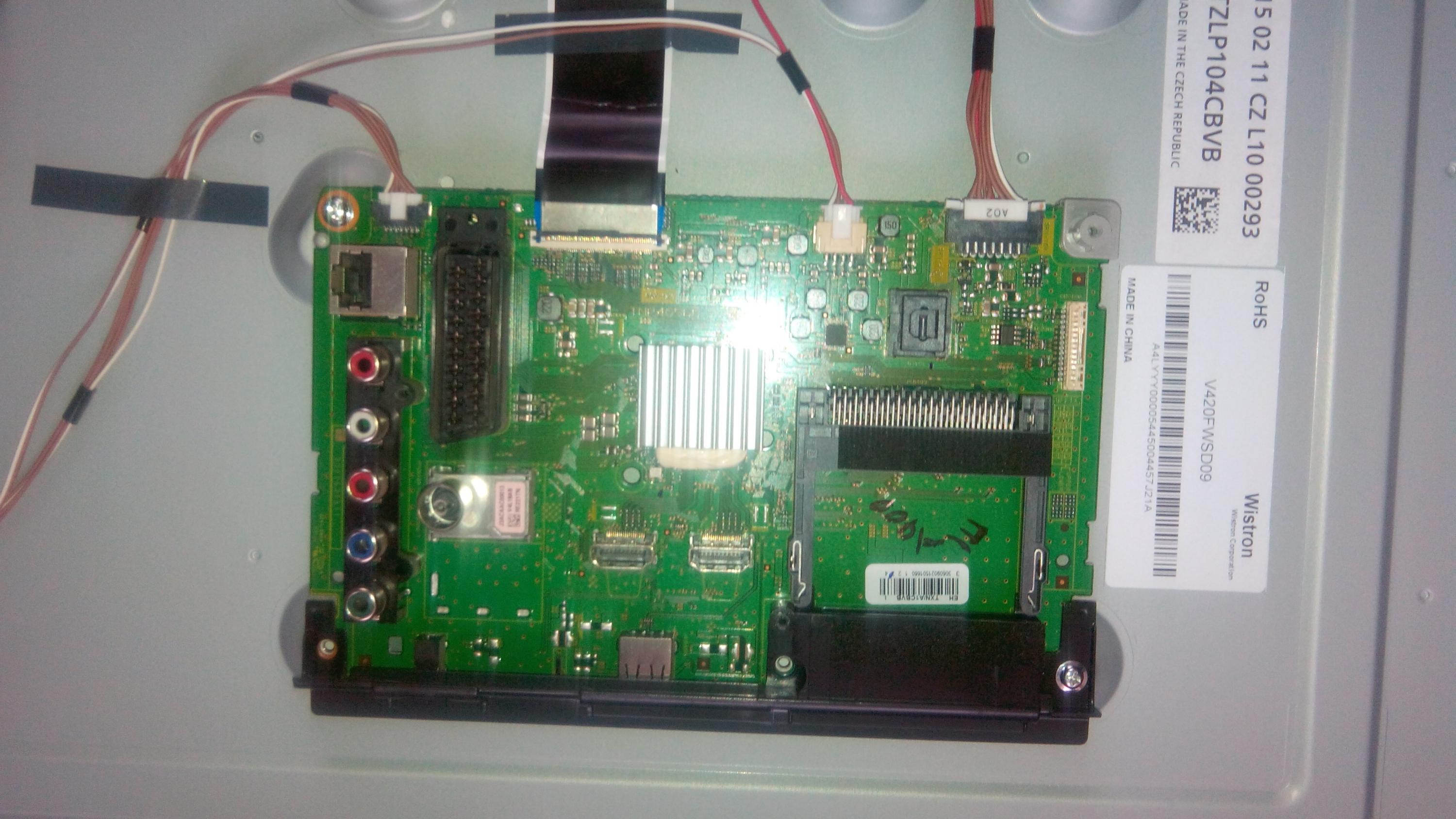

    This Tv is a Panasonic tx42a400. It will not display a picture or sound. The tv powers on but the green power LED quickly turns to a red flashing LED and the tv stays on standby. There are some signs of life on the screen initially soon after powering on. You can clearly see backlight activity , but this soon goes off and then the tv shuts down to standby. I have changed the power board as I thought that this was the cause of the problem. Also used different cables etc. I now suspect the main av board and wanted to know if anyone can suggest some voltage testing to check the av board before I buy a replacement av board.
    Re: Panasonic LCD tv goes into standby and won;t display a picture
    If you could post some photo's of your boards and how they are interconnected would be a good starting point.

              dick barton, I will get some photos on here asap if I can.

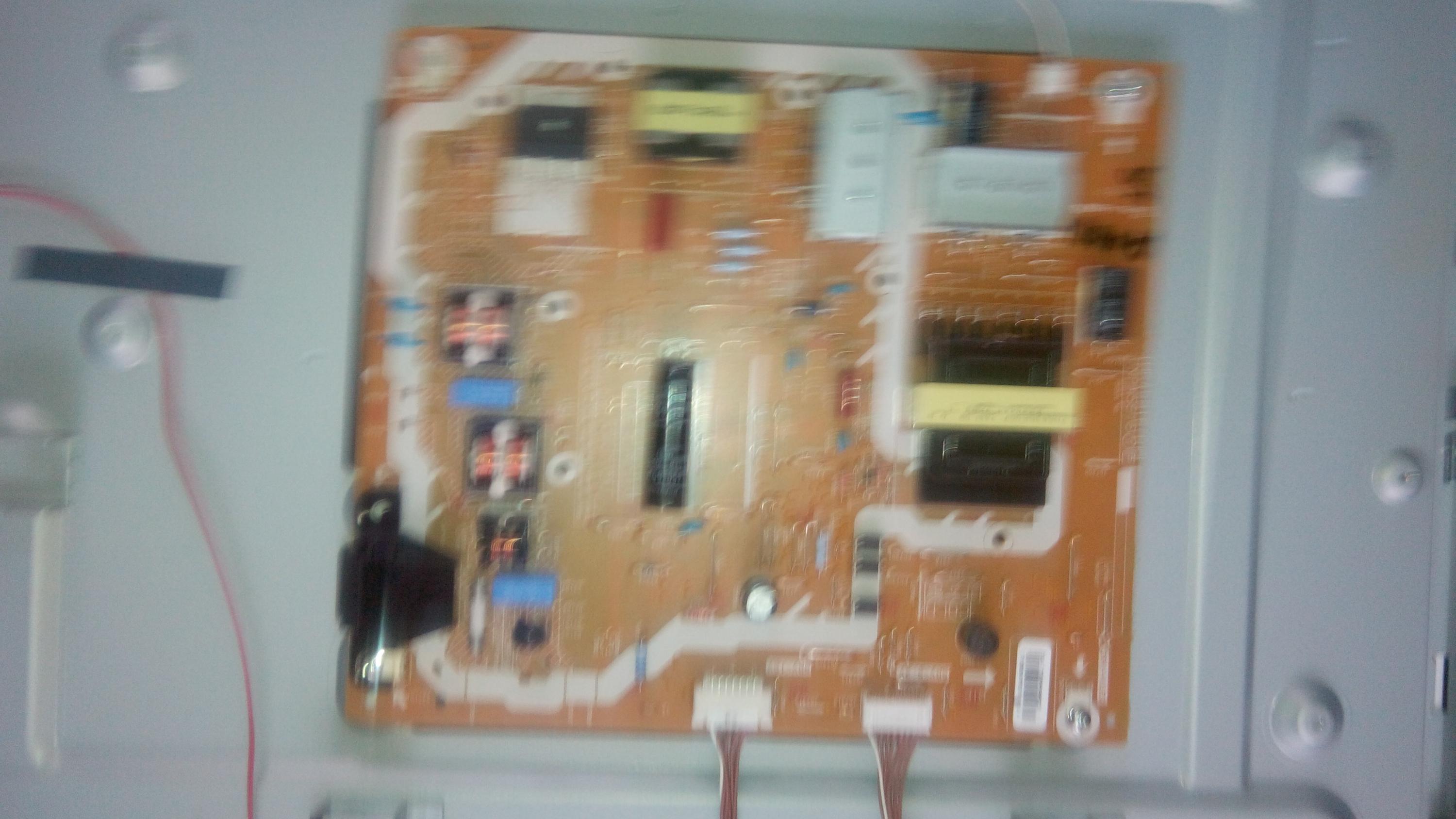

                    What's the part number printed on the power supply. It's too out of focus to see anything clearly.
                      Part number for the psu is TNPA5916

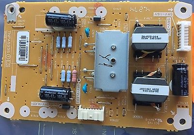

                          Does this set also have a led driver board??
                            Yes, it does have an led driver board. Have tried changing it as I have a spare, but made no difference.
