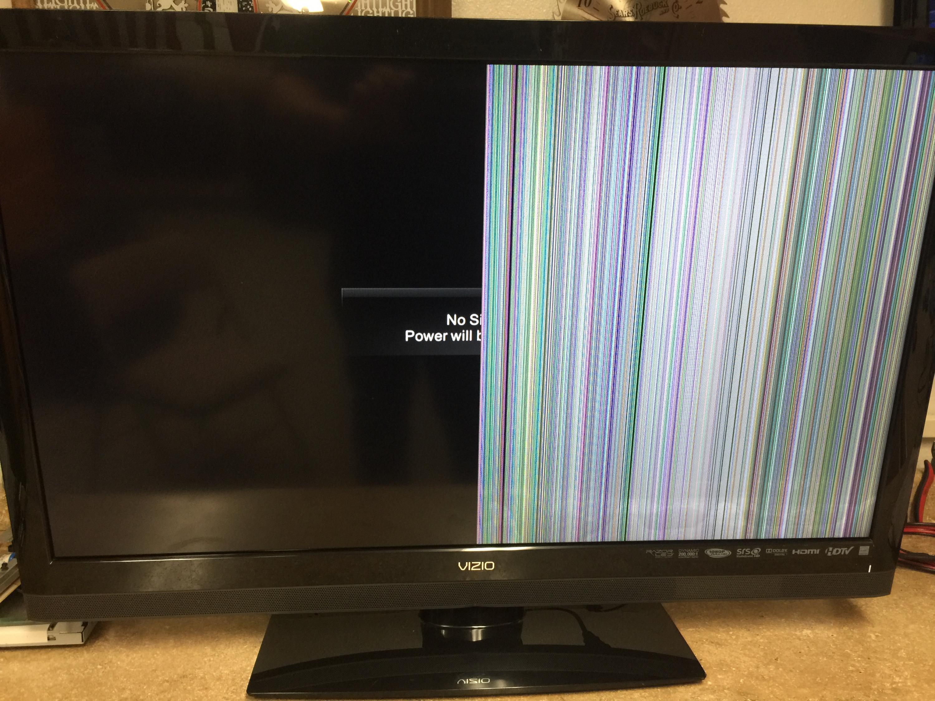

    Second post here, hello everyone. Is this worth the time to troubleshoot and fix? Any pointers as to what is wrong? Visually inspecting the boards looked normal. TIA
    Re: Vizio E370VP
    Looks like half of the screen is bad, I would carefully reseating the cables between the T-CON board and the panel first, you must make sure to put them back in correctly.

      I did disconnect the flat ribbon cable from the side with the lines and the panel was all white. Good/Bad?

        Bad Panel....

          Well that sucks, thank you Budm & Andrew!
