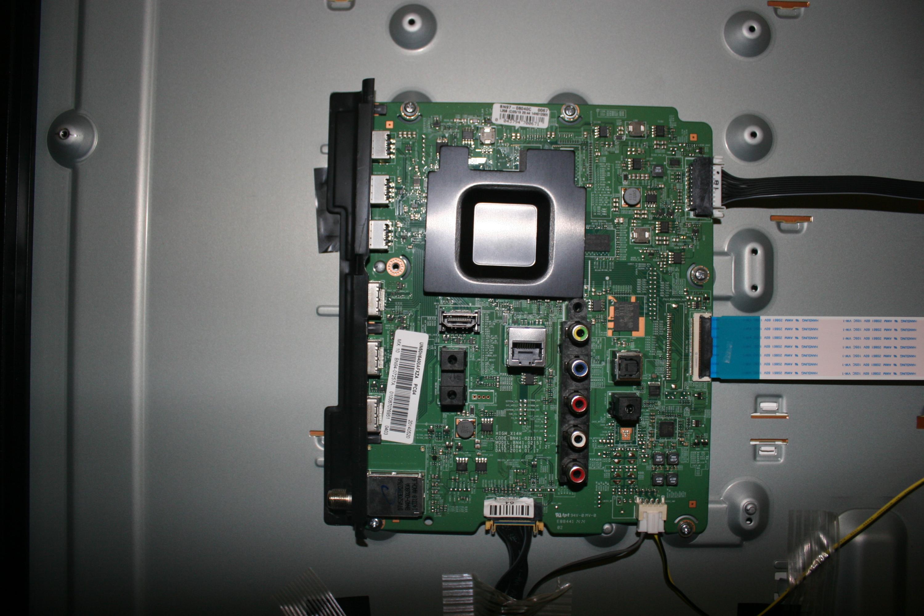

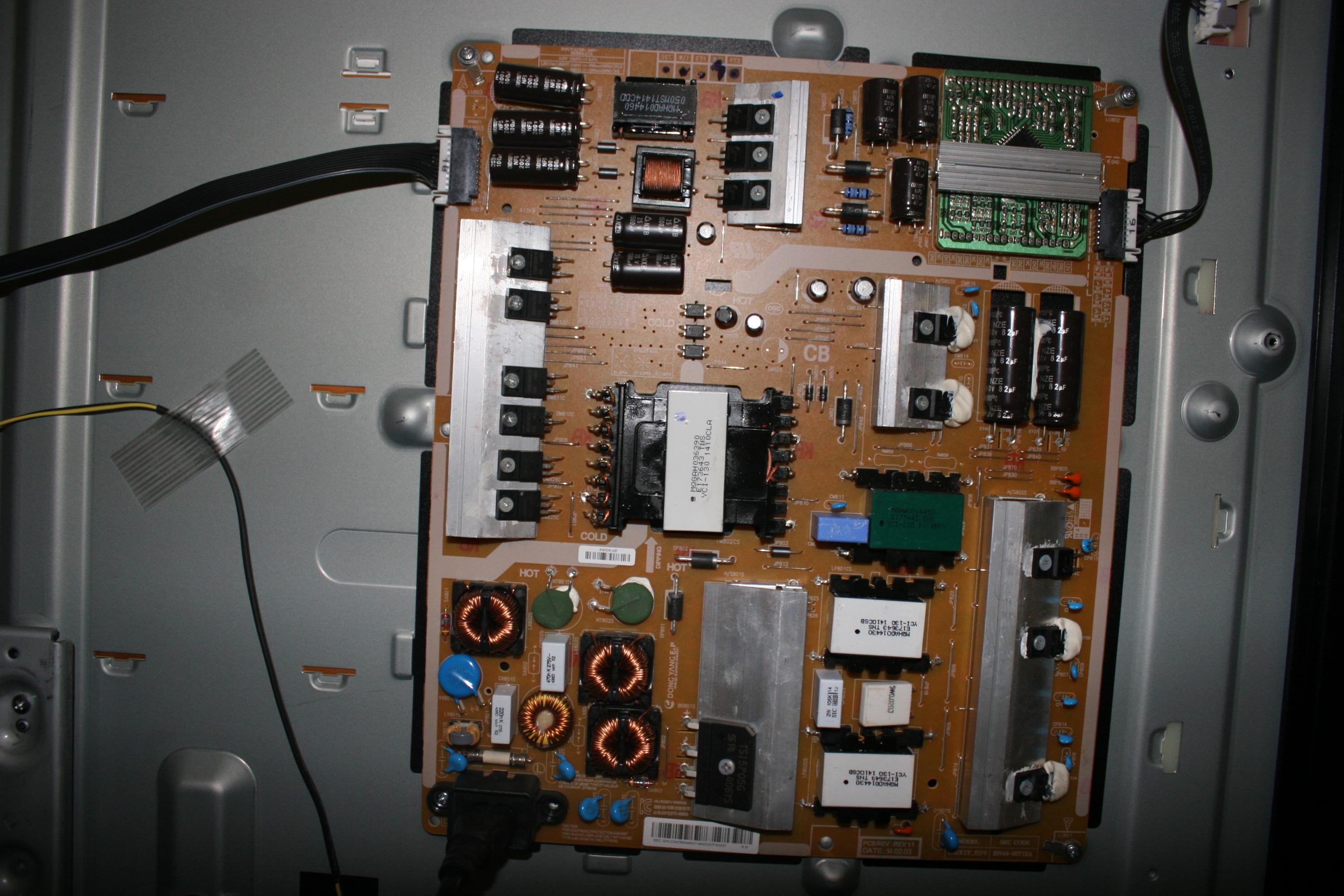

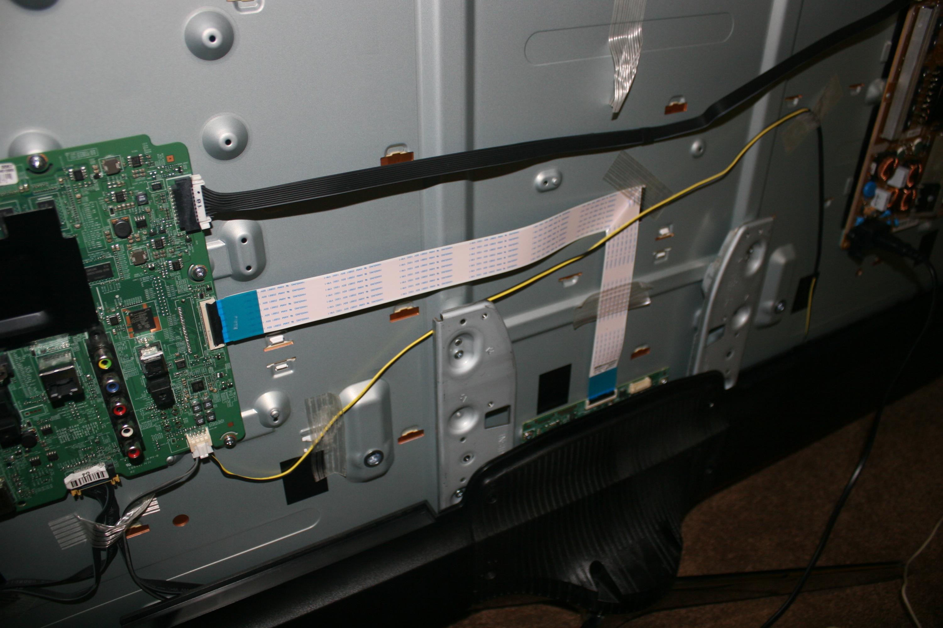

    Re: Samsung UN60H6400AF Stdy Red Standby Light, but will not turn on
    Additional photos of the board.
    Last photo was taken in a dark room with the power board disconnected from the main board. Interestingly, the red area in the middle of the screen was hard to see with the naked eye, but is in fact coming from the TV.
      Unplug one side of the ribbon cables going from the tcon to the panel, check the screen, then do the other side.

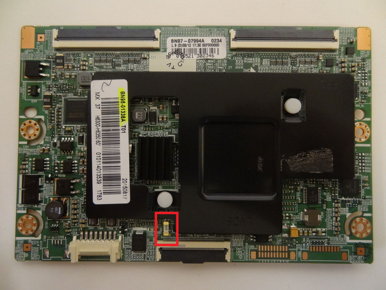

                  I check what I think is the fuse on the tcon board (picture attached), and got no voltage reading from either side.
                  No luck with any audio.
                  The flash I wrote about only happens if I disconnect the t-con board. If the t-con is connected, there is no flash.
                    If you are unable to get a voltage off either side of the fuse on the T-con board, then you may have a bad main board still.
                    However what I would do is remove the T-con board from circuit by removing the LVDS cable aka the ribbon from the main to the T-con and re-measure for 12 volts outgoing voltage from the main board on pin 1 of the ribbon connector CN1401. If you are able to get 12 volts output with the T-con disconnected, then that will show us that the T-con board is indeed faulty.
                    I would also try plugging in a device into the main board such as DVD player in an attempt to get sound out of the speakers. If you can't get sound or 12 volts out of that main board, then I would be looking at replacing that board again.
