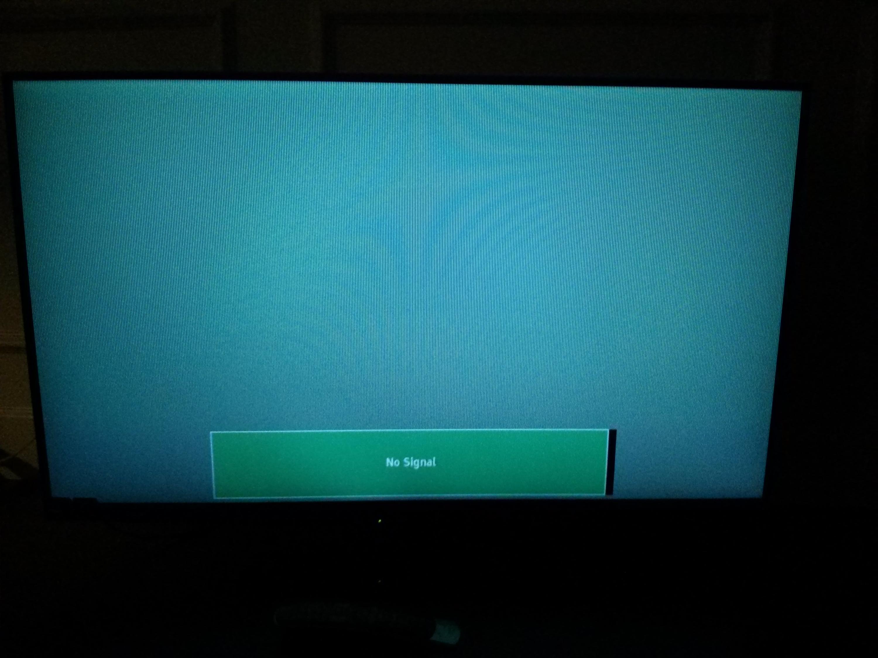

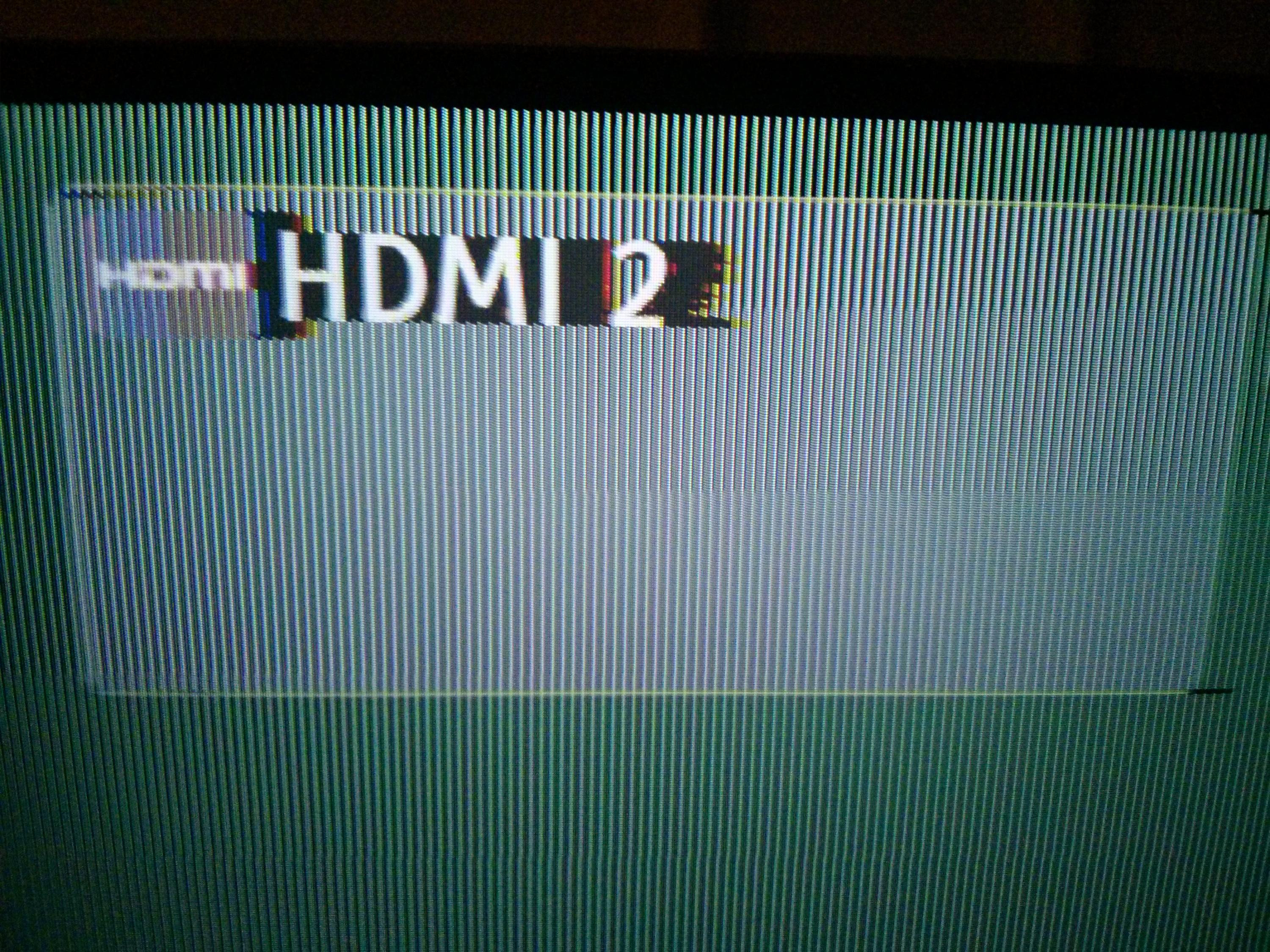

    Friend has a 2012 made Toshiba TV and all of a sudden developed these vertical lines top to bottom, all across. The colour is also off too.
    Here are a couple of pictures.
    I am not a TV guy but have dabble enough with bad caps and he asked me to take a look.
    Is this panel problem? Or main board problem?
    Doesn't sound like power supply problem to me.
    I have not opened it up yet to poke around.
    Thanks for any tips.

    Looks like a main board or T-Con issue. Does this TV have an LG panel or Sharp?

      I agree if an Lg panel it will be the mainboard if its a Sharp panel will be Tcon.

        Thanks for the reply guys.
        Since I have not picked up the set from my friend's place yet. I don't know what panel is inside.
        Maybe I can search for the Special code to enter the service menu and find out what panel is used?
        So panel is panel or T-con board?
        Main board could also mean bad news as not so much Toshiba parts I find.

            And yes, the main boards are very tough to find for this one. My guess is that the TV has an LG panel based on what shopjimmy shows:
            http://www.shopjimmy.com/toshiba-750...r-47l7200u.htm
            That being said, it may be worth waiting to see if one pops up on ebay at a reasonable price. The only thing I see is a traded in service for nearly $200.
            You can also check with pts electronics and see if they offer a repair service for your main board.

              Found youtube video showing 3 different ways to get into Service Menu.
              Unfortunately friend said none of them works.
              I told him the one for LCD should work but he said he tried many times:
              Press MENU on R/C
              Highlight PICTURE icon
              Press 9, 3, 0, 1
              and service menu should appear.
              He also tried the other mentioned methods to no avail.
              Looks like I have to go over his place to take the back off.
              So, if the main board is the issue, is it one of those BGA problem?

                Panel is by LG.
