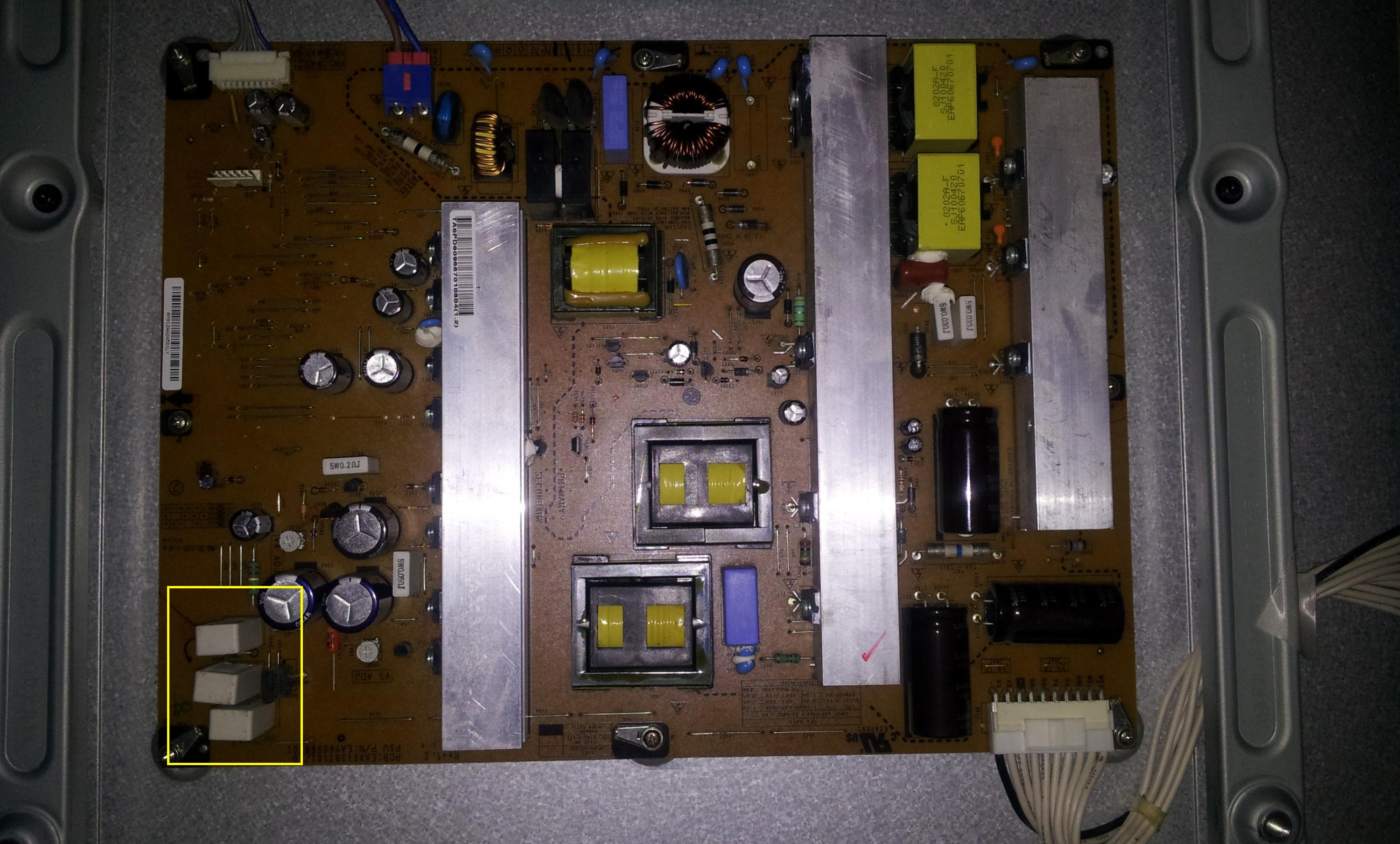

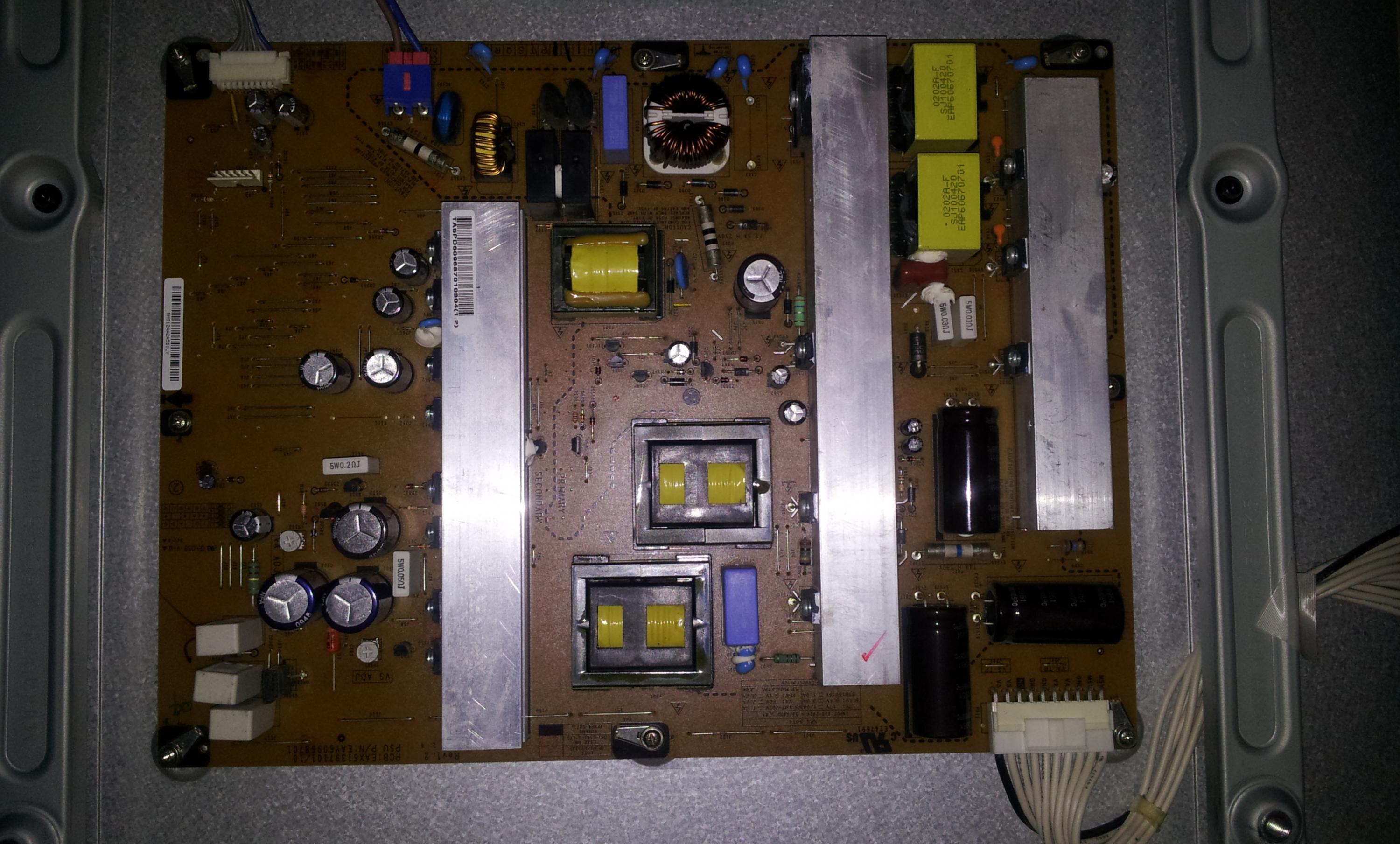

    Hi all. I attach here the picture of the board where the problem seems to come from.
    A wire was not properly connected than I reconnected it and the tv went on showing the
    picture but after that only on and odf. It goes off after 10 secs after
    plugged the power chord.
    I already checked the forum for similar solution but didn't find the right one.
    Anybody can have a look to the picture to see at least if the components
    are ok ?
    Thanks to anybody who will help

    One of the white squares in bottom right will have died.

      I think he might be refering to the 3 ceramic resistors in the lower left, check and see if one or more of them are open, there value should be marked on them

        I've checked the white resistors but none of them are open.

          If The PSU is making 'clicks' then most likely it is working. There is a procedure to self-test the PSU. Your problem is elsewhere. However there are more knowledgeable engineers on the site. I can share the Self-test procedure, if you like.
