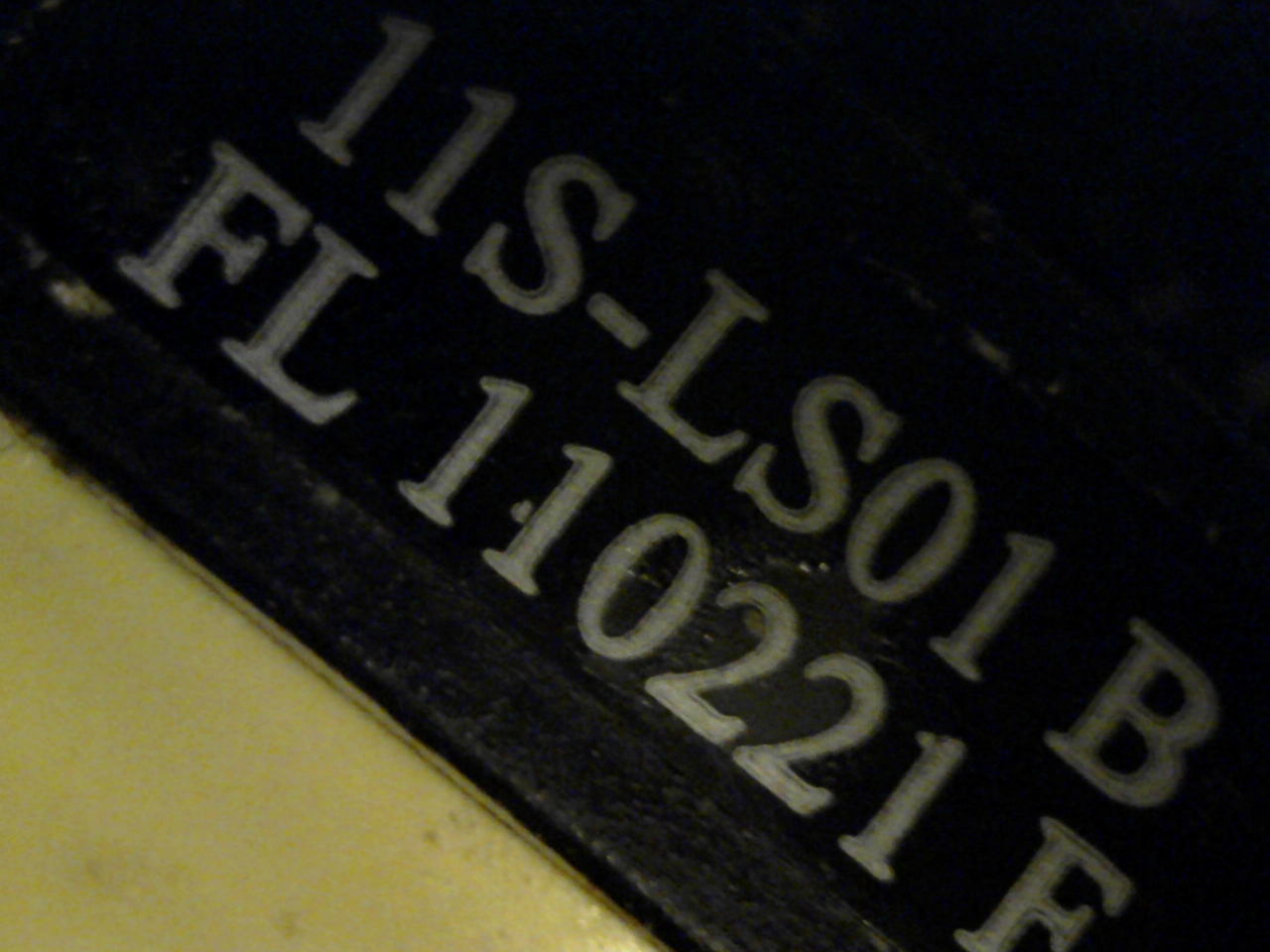

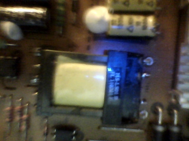

    Well heck! LG says I have to buy a whole power supply, around 140.00
    Come on. They probably buy the part I need from Sanyo. The tv is a LG model # 55LW5300-UC service code 55LW5300-UC AUSYLUR serial # 109RMJF86708
    power supply is TB60A621699010506 1.5
    The number on the part is 11S-LS01 B another number under it FL 110221 F
    My pictures aren't very good. but here they are.
    Taft

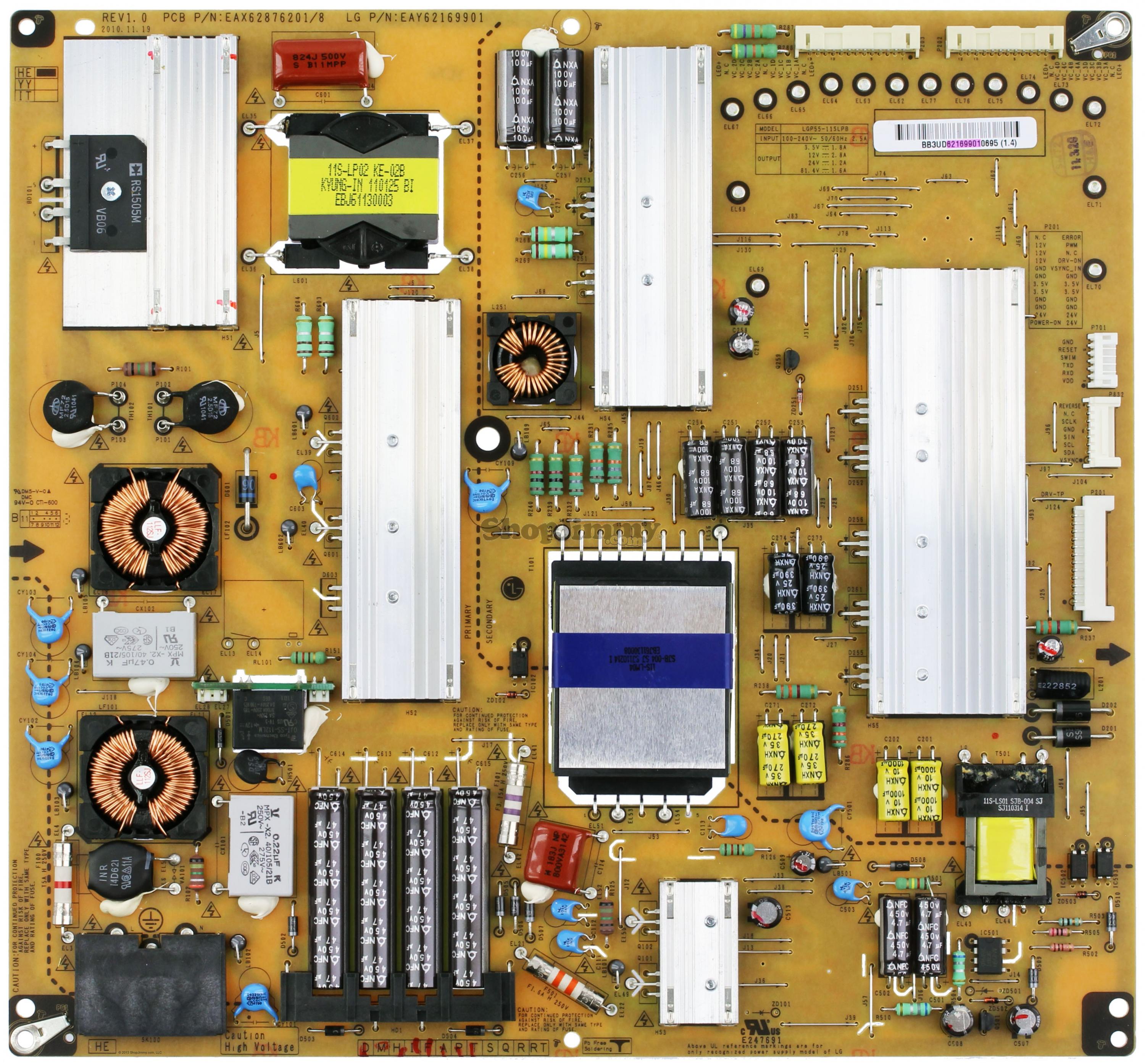

    The part number for the board at least is most likely
    EAY62169901, EAX62876201/8, EAX62876201/9, LGP55-11SPB, CRB31006801
    Not sure how Sanyo fits into this equation but how did you determine the transformer was at fault.

      Don't know how fast or reliable they are but:
      https://www.aliexpress.com/item/POWE...6-593108145bad
      You can also try ebay:
      http://www.ebay.com/itm/LG-55LV5500-...gAAOSwHsRYCXZ2

        Transformer fault's are less likely than other components around them on power supply boards. Inverter transformers for the CCF backlights on the other hand do fail in today's sets.
        As tw2005 has asked I'm interested in how you conclude it's faulty?

          There is input voltage, but no output voltage.

                might have to find used or http://www.ptselectronicsinc.com/eay...-power-supply/

                    The transformer needs to be switched on and off (oscillate) for a voltage to be present on the output windings. If the drive to it is missing (even if the DC voltage is present on the primary) then there will be no output voltage at the secondary.
                    Best to check that the primary and secondary windings have continuity.

                      I looked at the board from aliexpress, and it is they have a fantastic price on it. The part number is the same but it says its is for a 42 inch screen. Mine is a 55 inch screen. Is this the right board, it does look identical.

                          Unfortunately I don't have a schematic either but looking at the board at Shopjimmy I think its connected as follows.
                          The transformer pins have numbers 1 to 10 on the upper side of the pcb.
                          Pins 6 & 7 and Pins 9 & 10 are connected together and you should be able to measure resistance between the pairs.
                          Pin 2 & 8 appear to be not connected.
                          Can you measure the resistances between
                          Pins 1 to 3,4 & 5
                          Pins 3 to 4 & 5
                          Pins 4 & 5
                          That should give an idea of the transformer internal connections.
                            Re: LG part
                            What is the P/N of the SMPS IC501 which drive the primary winding of that transformer?
                            I doubt that the transformer is bad.
                            You need to find out if the IC is getting the VCC to run or not when you find the spec sheet of the IC, there are step in trouble shooting methods that should be followed.

                              pins 1 to 3 i 3.7 ohms
                              pins 4 to 5 is 0.7 ohms
                              pin 3 to 4 doesn't show a connection
                              pin 6 to 7 is 0.2
                              pin 9 to 10 is 0.4
                              • taft1957
                                • Oct 2013
                                • 95
                                Re: LG part
                                I don't know what this means, but on the secondary of that transformer pins 6,7,9,10 all test connected.
