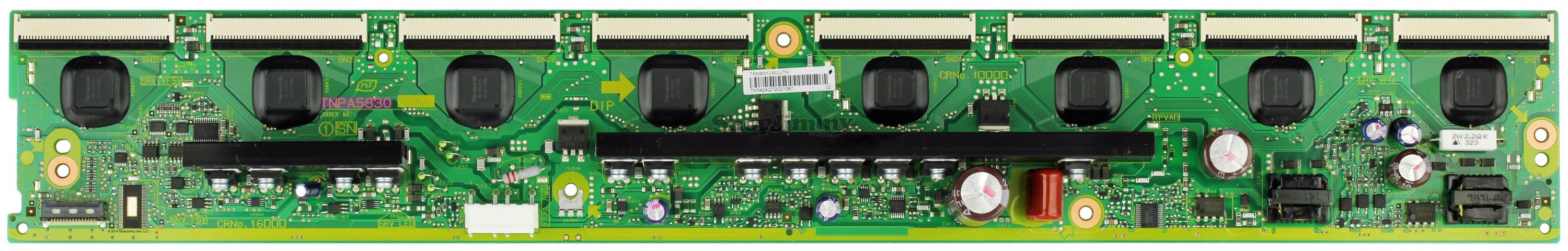

    It's a 2013 HD series TV and from what you're quoting it sounds like your searching 1 blink error codes but there is no such thing as a DG board or STB 5V sense in these. That I feel is going back to 2009 or maybe 2008 models.
    This TV is going to be really basic inside too with 3 main boards to deal with,
    The SN, PSS and A-board

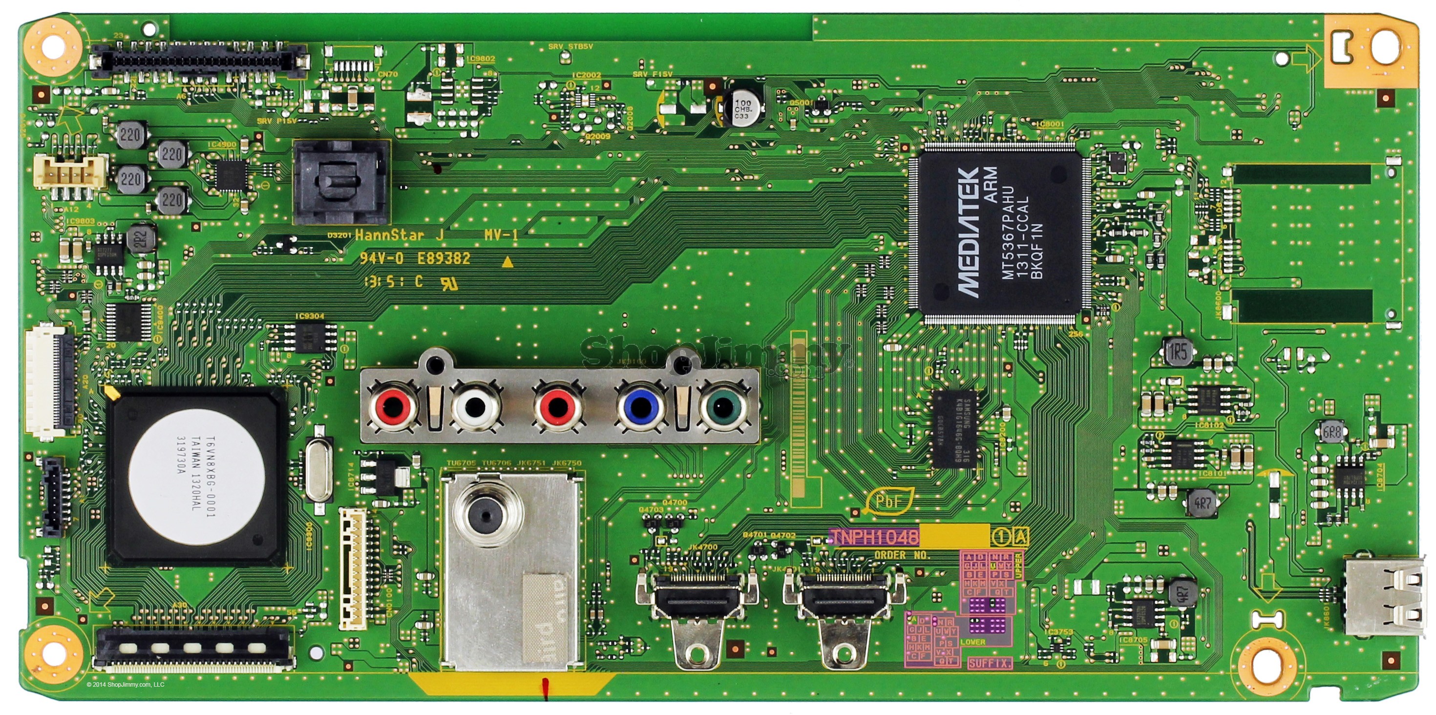

    On a good note, Payless Components has the main A-board for the lowly price of $18 TNPH1048UA

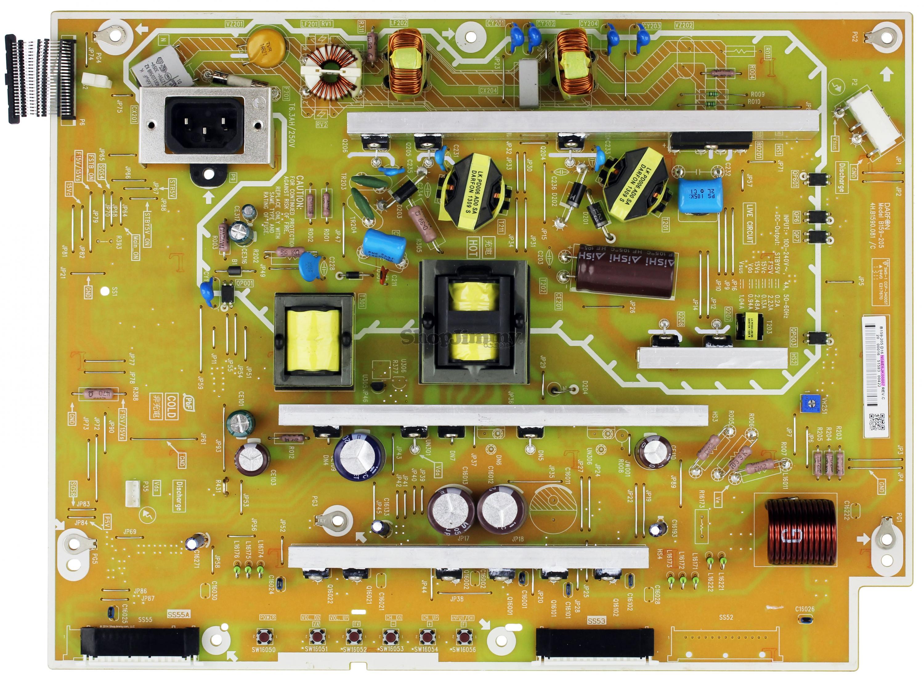

    The PSS for $47 PSS n0ae6jk00007
