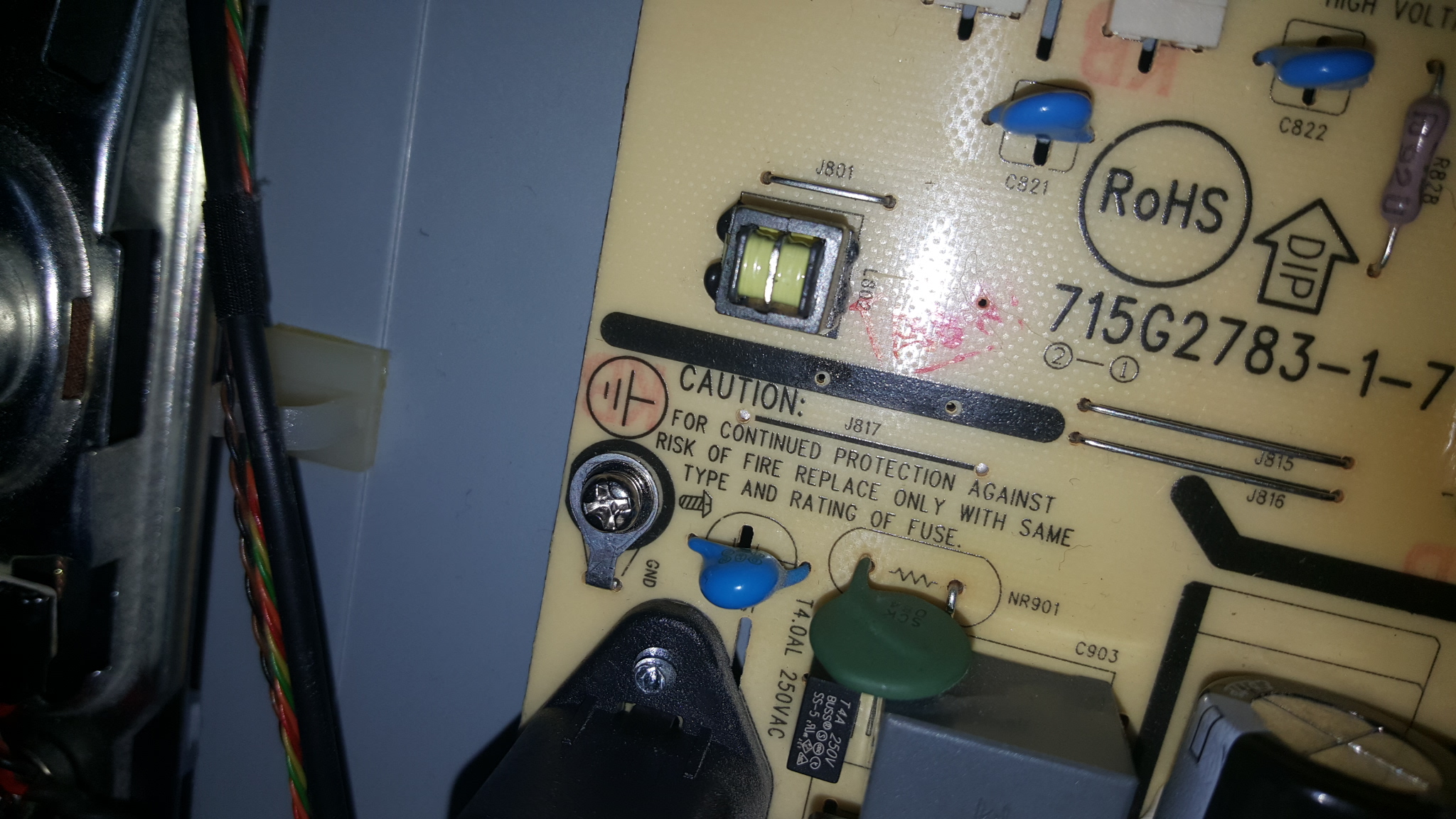

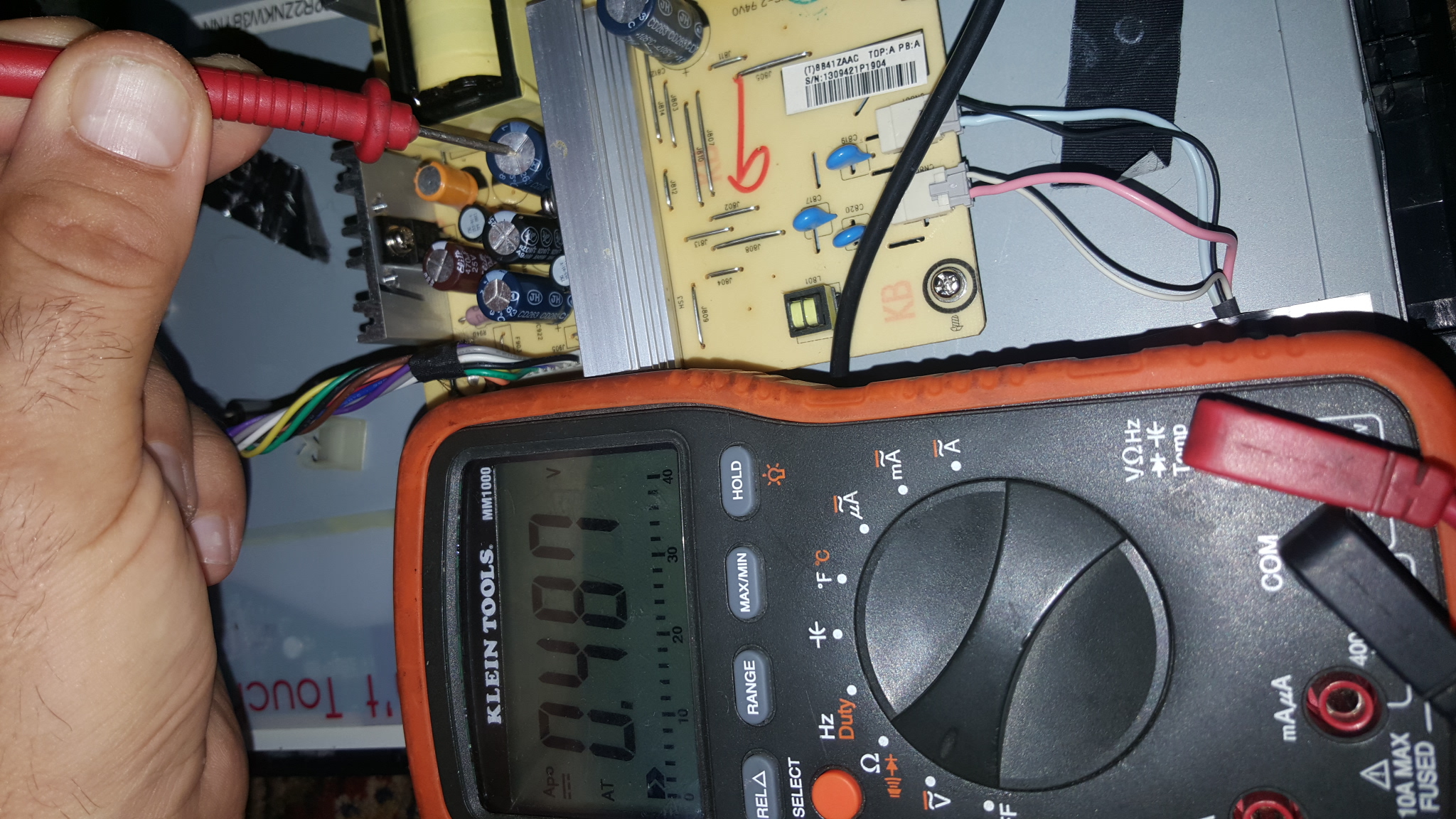

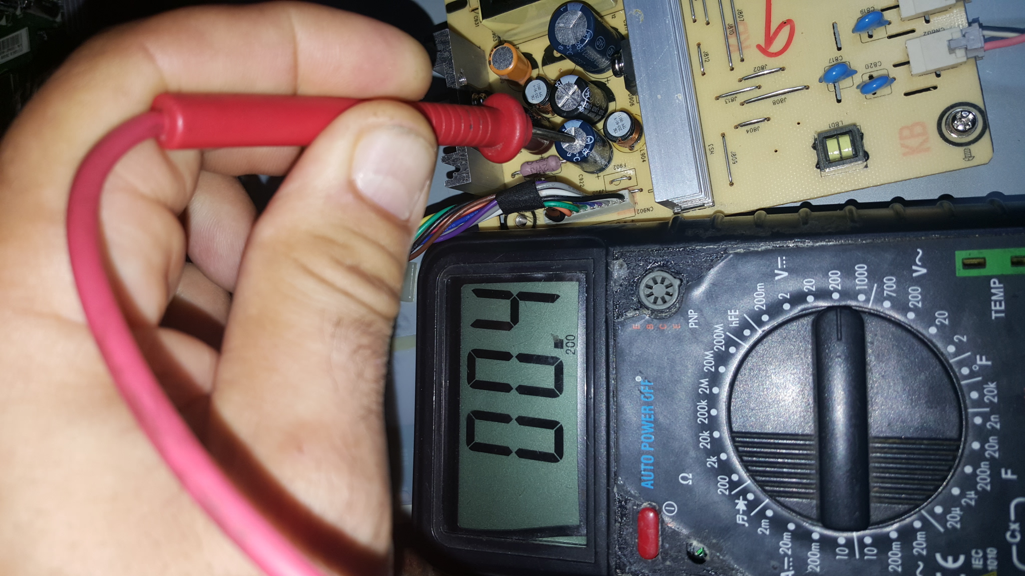

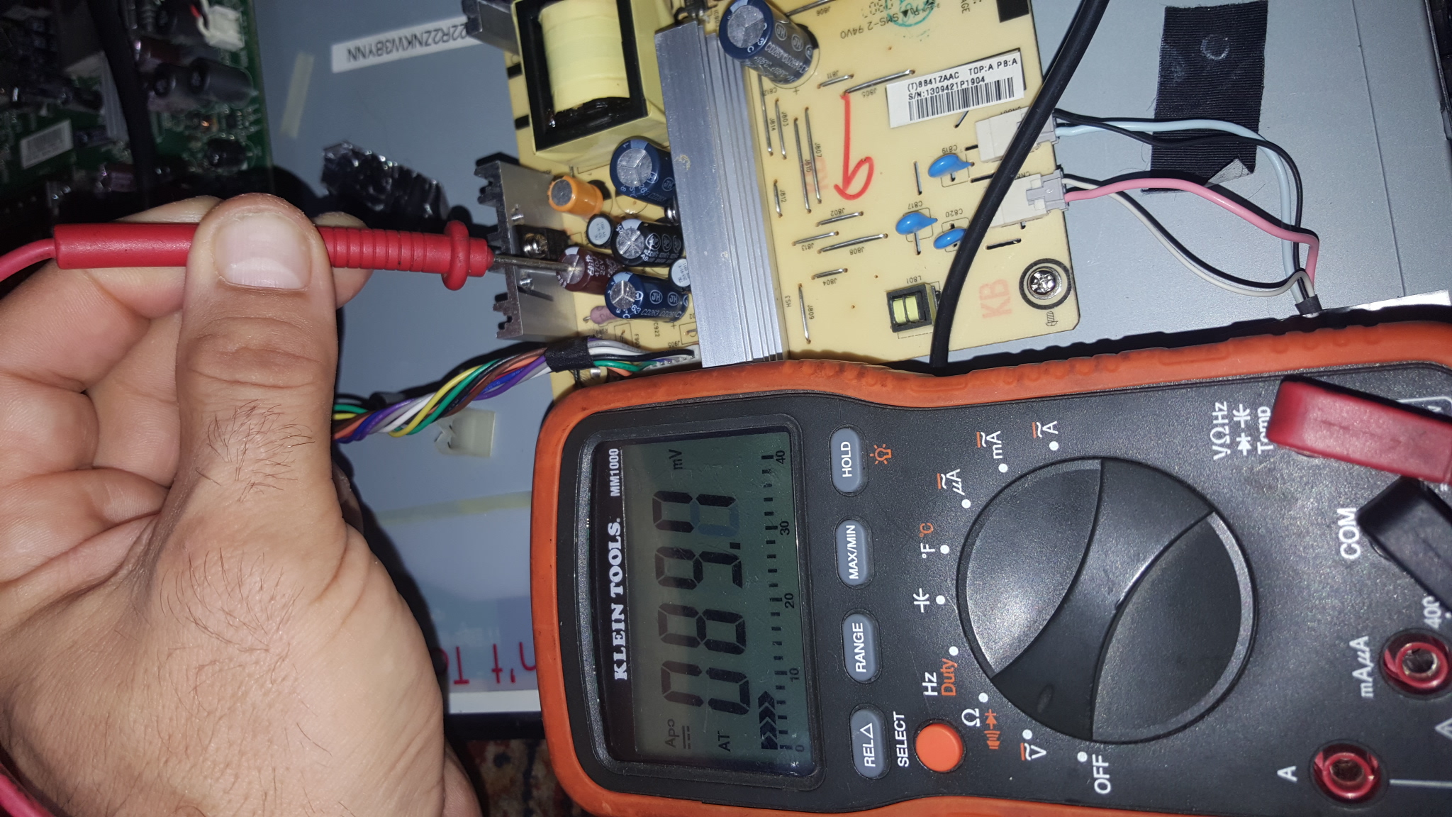

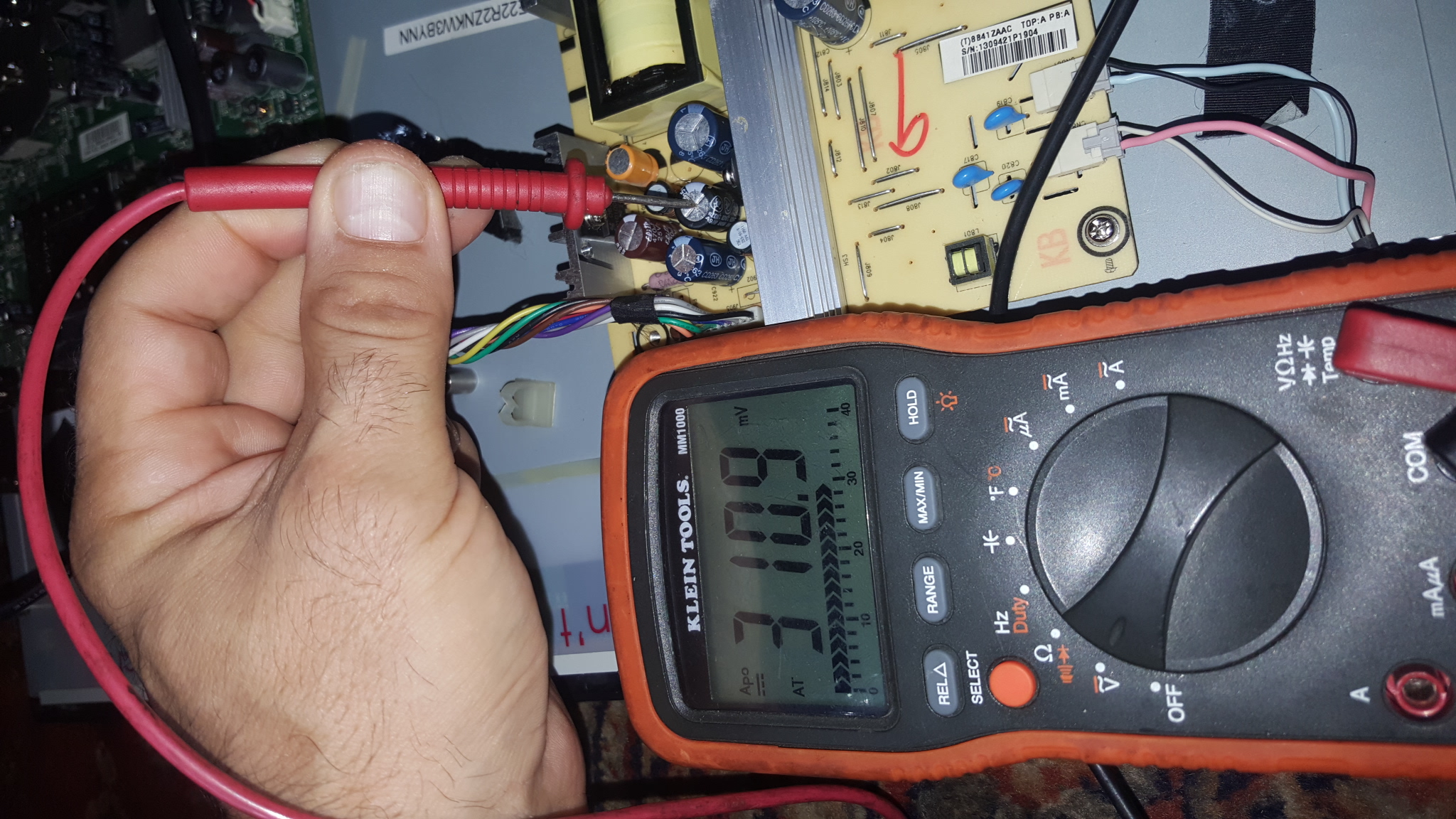

                Can you point out where this filter cap(capacitor?) is located? Also I no longer get the "Please Wait" screen so no lights for 2 seconds. But I get the 12V and 5V again. I get no power to the jumpers toward the 4 CCFL connectors. But I get 13V at the 5 legs of the transformer between them.
                Here's a picture of the ground I use clearly marked as GND

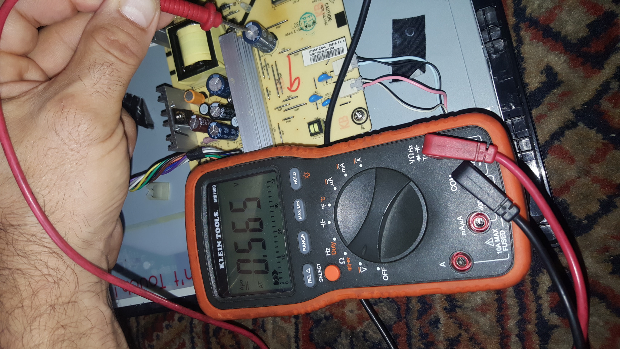

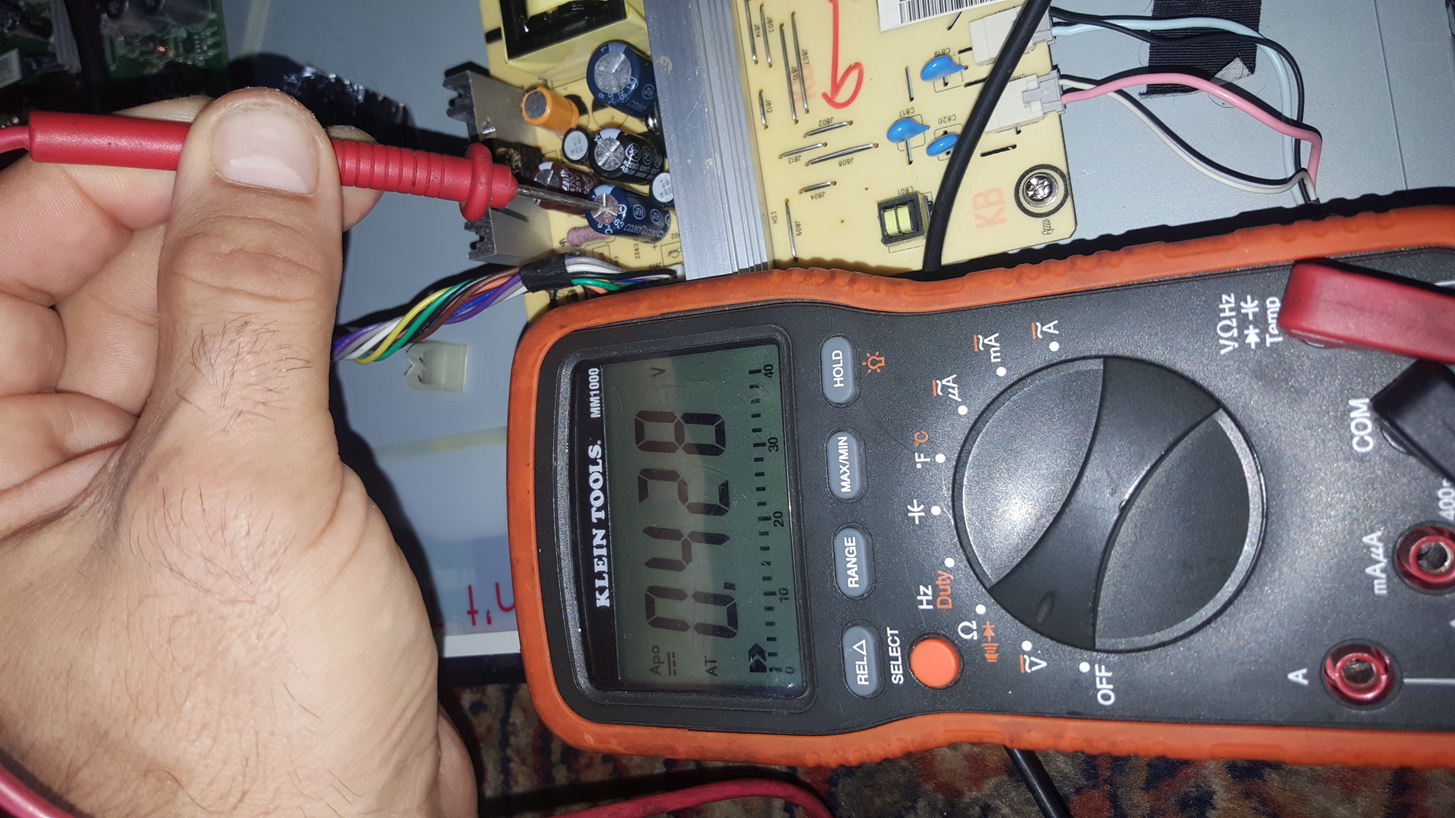

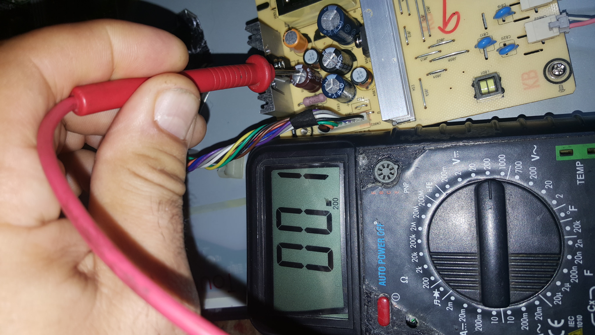

                Also some of the caps measure something on the top there are 2 the measure 0 ore .1V could that mean something?

                  post 3 first picture large filter capacitor is laid on its side too the right of the mains plug socket one side of that capacitor has a negative line/mark so put black probe on the capacitor leg but only use this for measuring the primary side voltages (danger of high voltage so be really carefull) on the secondary side yes use a screw or the metal tv chassis as a ground to test the dc voltages. Have you used your invertor tester to make sure the lamps still light?

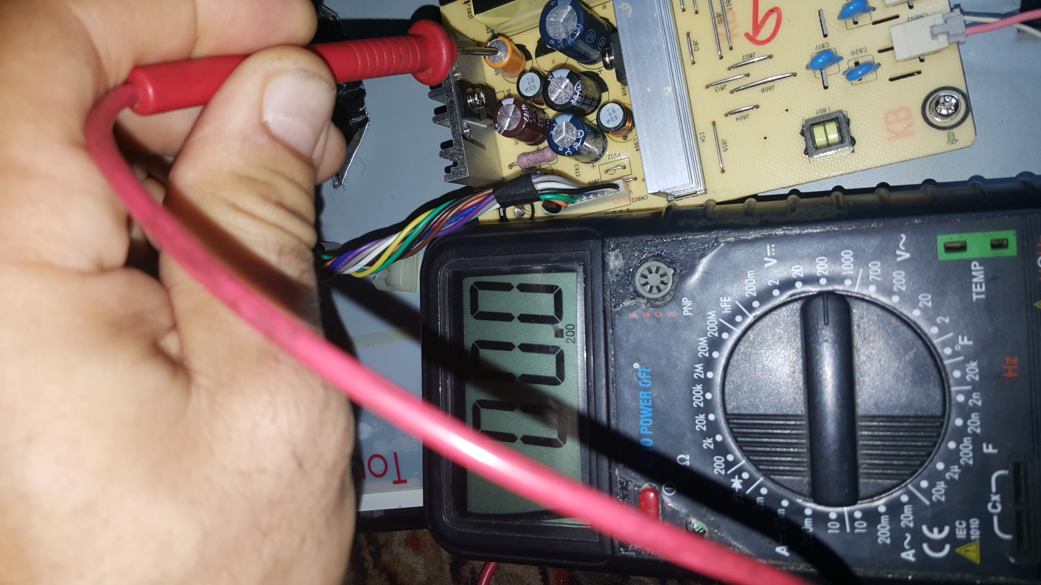

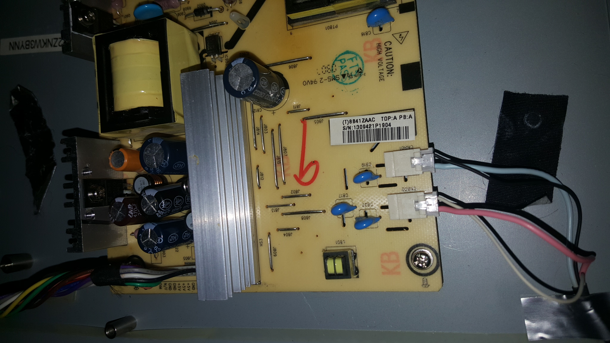

                        Did you see the pictures above with the caps, some getting voltage on top some not? Also all the jumpers around the number 9(red marker) have 0 voltage.

                          so all of 4 of them light up thats good now we need to see why the invertor transformer on your psu is not powering them ive no idea what windings you need to check for shorts/open circuits etc maybe if budm/or more experienced member than me is online later he/they can look at the picture and advise us on which pin combinations to check.

                            Weird how some of the caps have really high voltage on top, in the hundreds and the others are below 1V. Something wrong in the circuit. The 2 seconds of light from before is not there anymore, but the "Please Wait" screen is there just dim.
