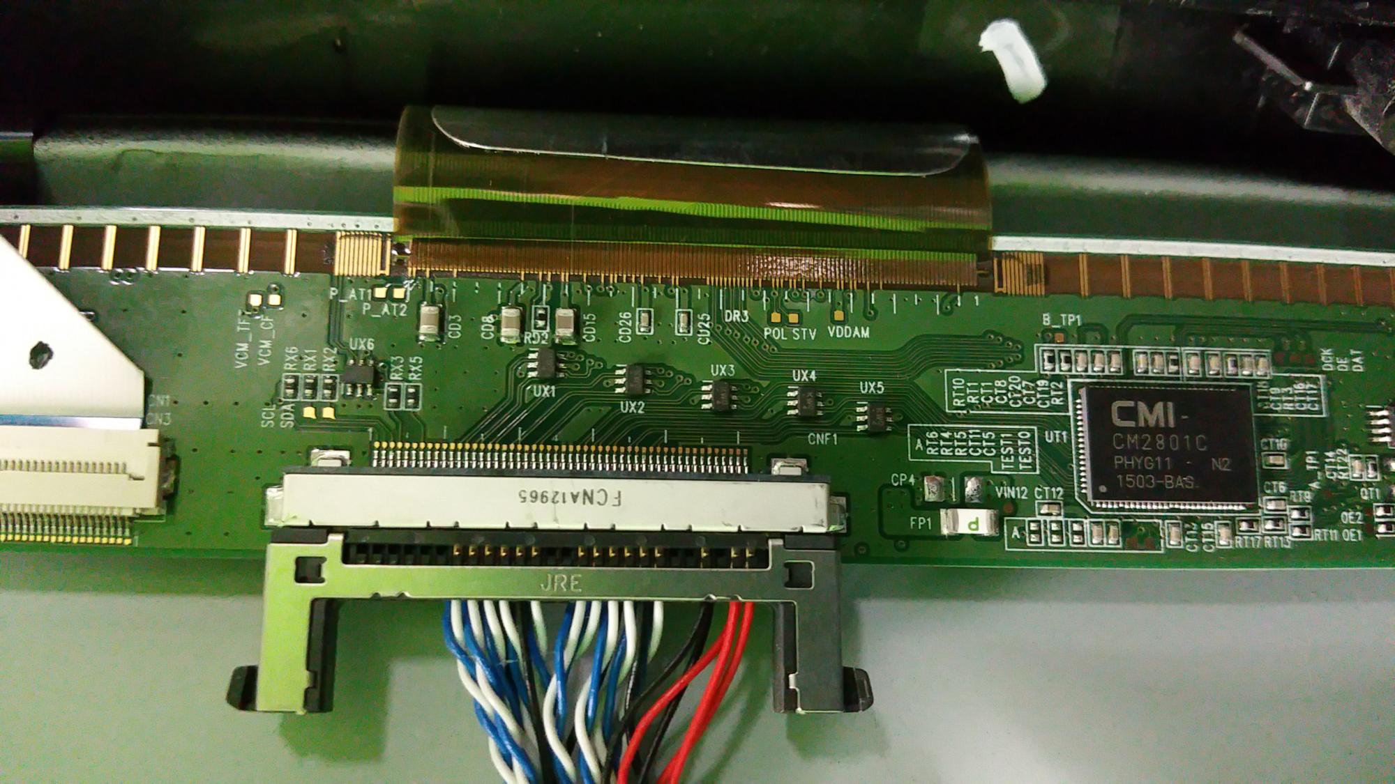

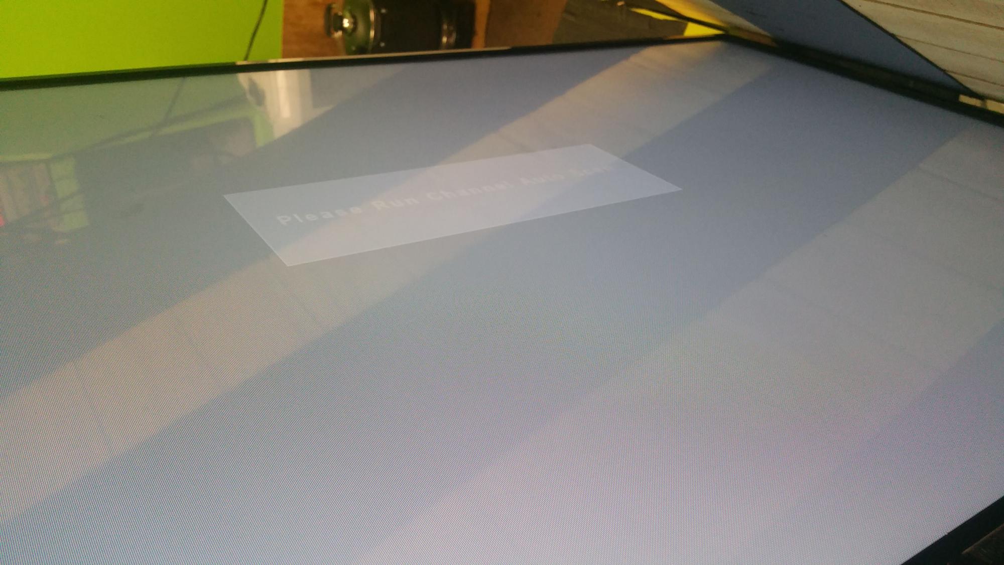

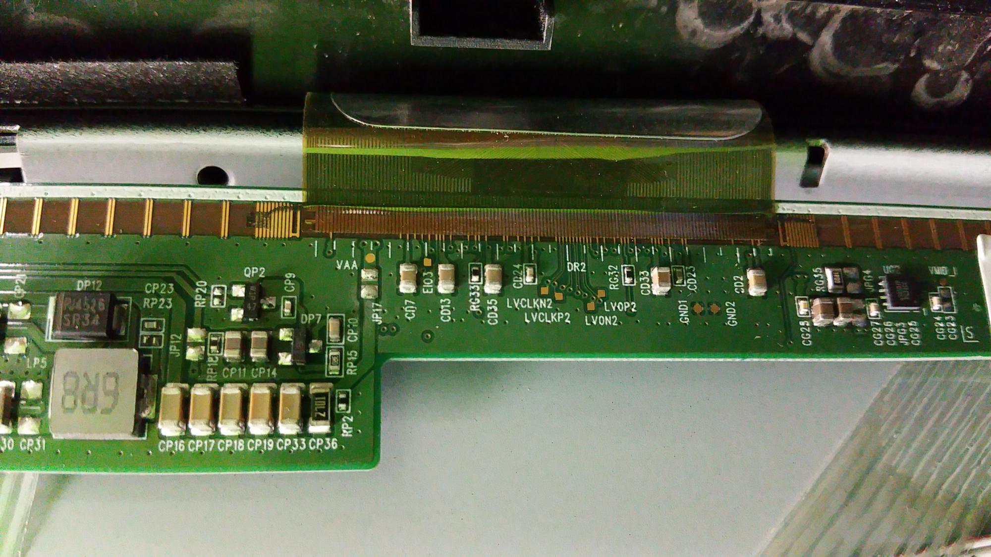

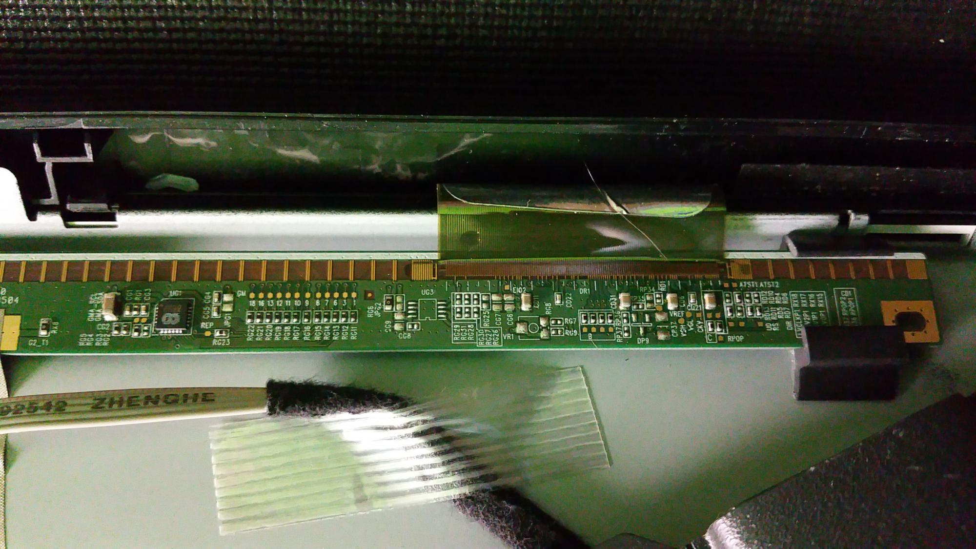

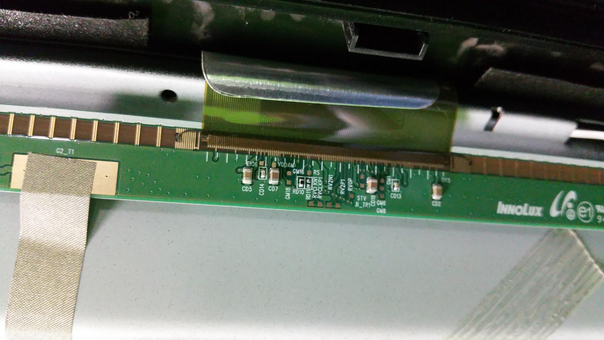

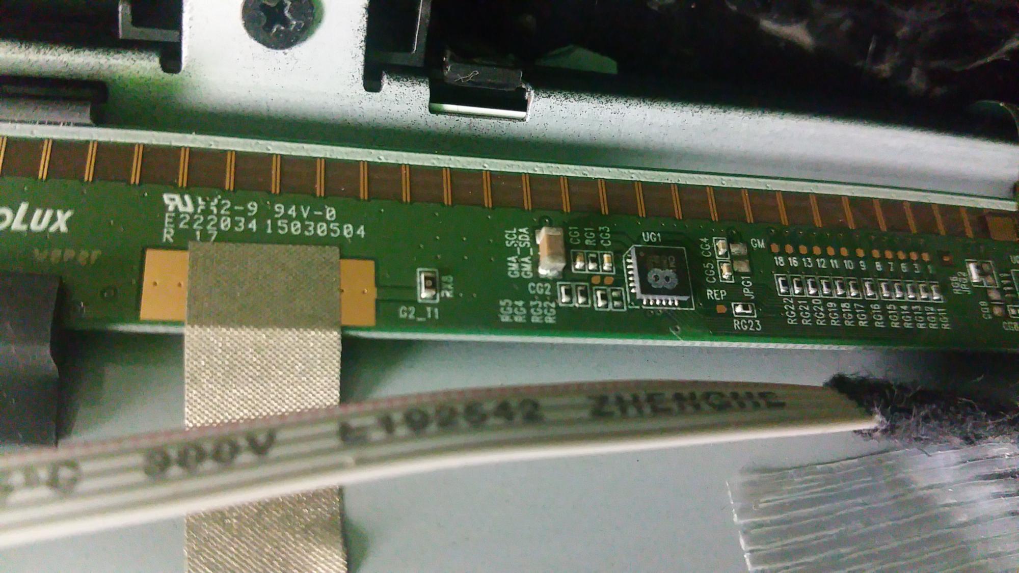

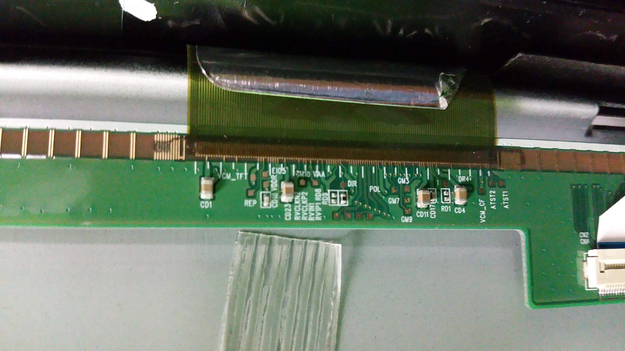

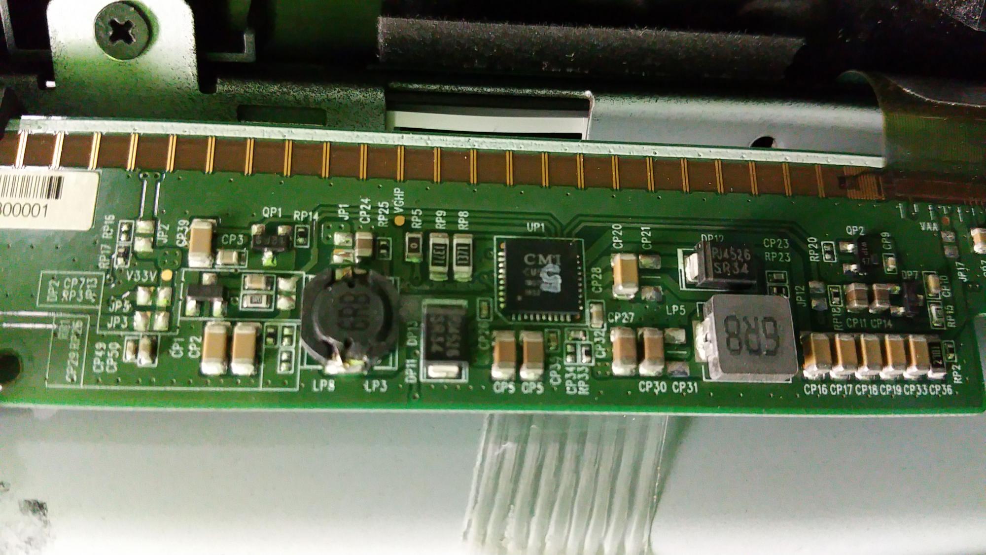

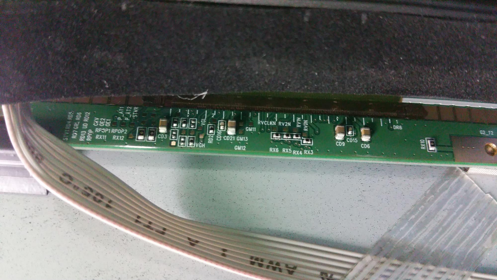

    hI I HAVE A Westinghouse WD50FX1120 WITH WHITE SCREEN I LOOK FOR VCOM ON PANEL AND CANT FIND IT THIS TV HAS BUILD IN T-CON TO PANEL ANY HELP WOULD BE HELP FULL THANKS

    I would start by resoldering them ceramic caps on the tab driver Pcb, some look dry jointed.
