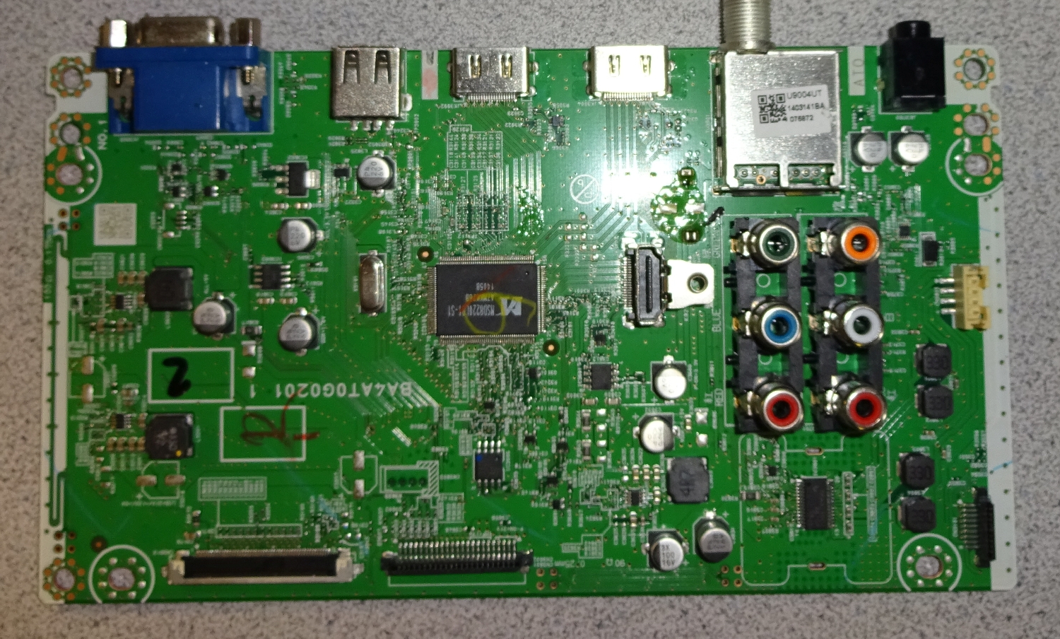

    Emerson chip swap question.
    I have a Emerson LF391EM4A that had a bad main board. I found another main board but it was out of a Magnavox. I installed it and tv works fine now however the splash screen and menu say "Magnavox" also the remote won't work with Emerson code and will With Magnavox. SO is there a chip on the board I can swap over to get back to Emerson??
  • CraigR
    • Dec 2013
    • 973
    Re: Emerson chip swap question.
    Figured it out myself it is chip IC3006 if anybody runs into this again.
