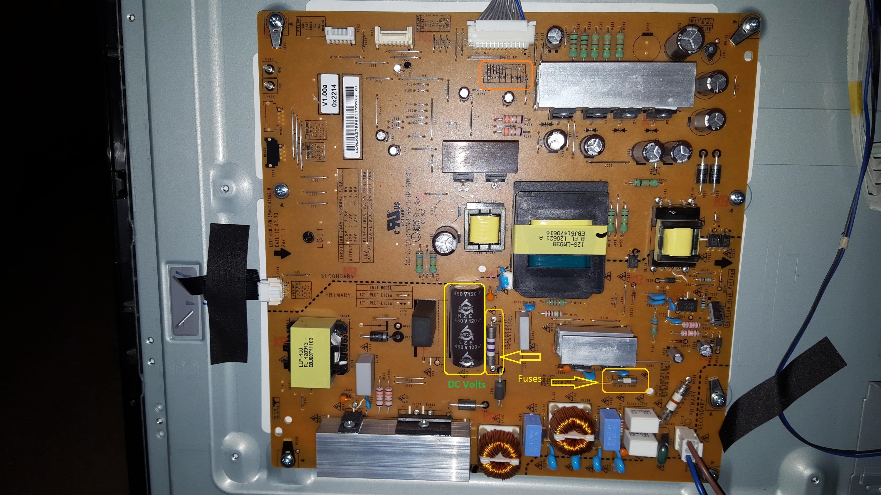

    Hi guys,
    Got the above tv but can't turn it on.
    I have a standby light but when powered on the standby light just flashes twice.

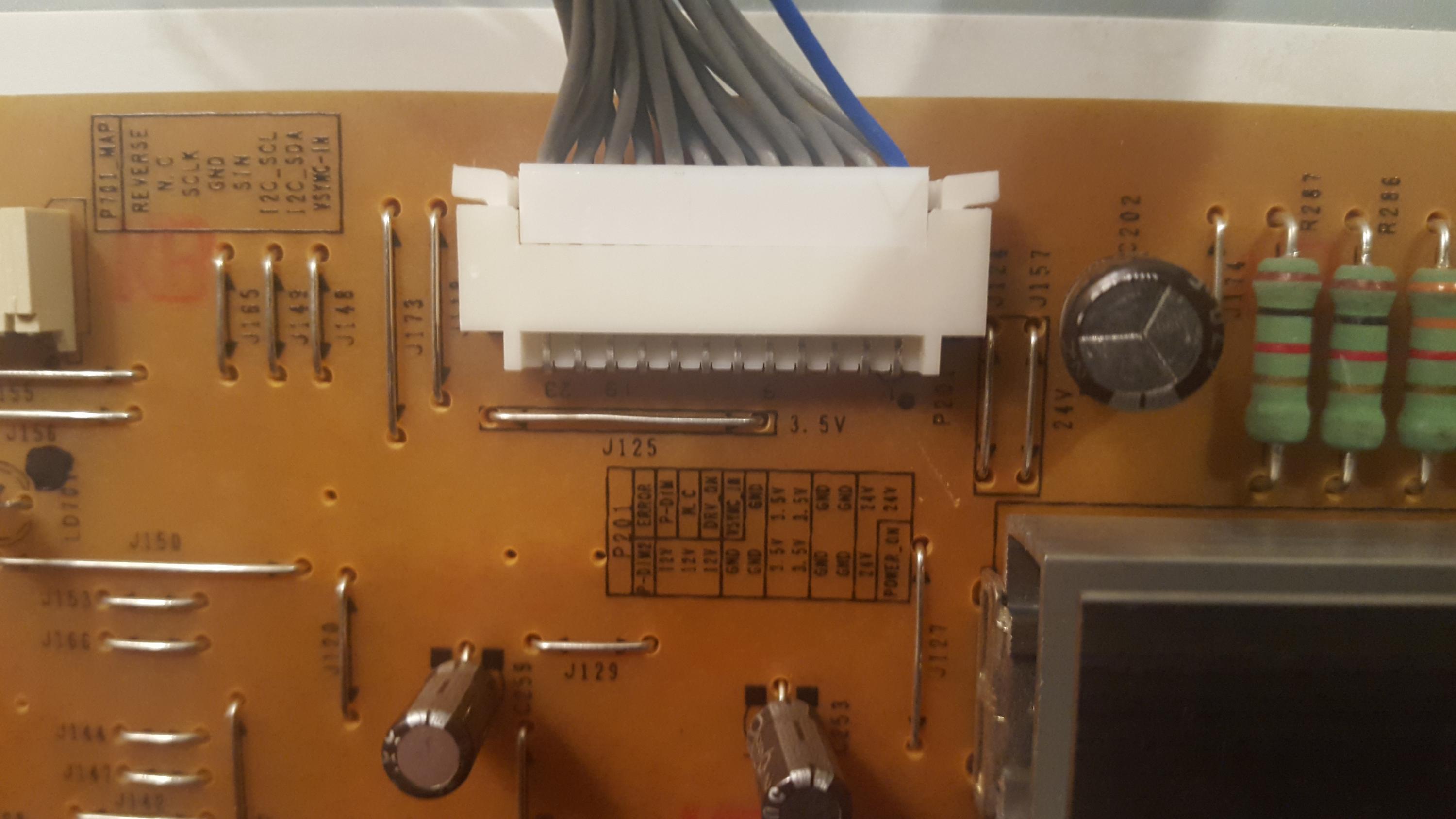

    The primary part of the power board is hot ie powered up with 400v+ and 230v+ but only 3.5v max on the cold side.
    I wanted to check if power on voltage was present, blue wire in picture but it says 24v? I get 3.5 when I power on.
    Should it be 24v as depicted in the legend? And does that hint at a main board fault?

    Ah...Just checked all pins on that plug and I get 3.5v on the power on and no 24v anywhere just 3.5v or less.
    I looked at this little transformer, I have 400v on one side and nothing coming out the other side so could be a suspect? Or is it waiting for a signal to turn on?

      You may have to take the 3.5V and connect to Power_ON using a 1K resistor to check the other voltages. Done with the mainboard disconnected.

        Ok so I connected 3.5v via a 1k resistor to power on, still go no voltages on any pins other than the 3.5v pins checked I had voltage at the power on pin so this was OK.
        I took out the bridge rectifier and tested it and that tests good.
        I noticed I have a slightly unstable voltage of 350-375v on the hot side of the board at various points?

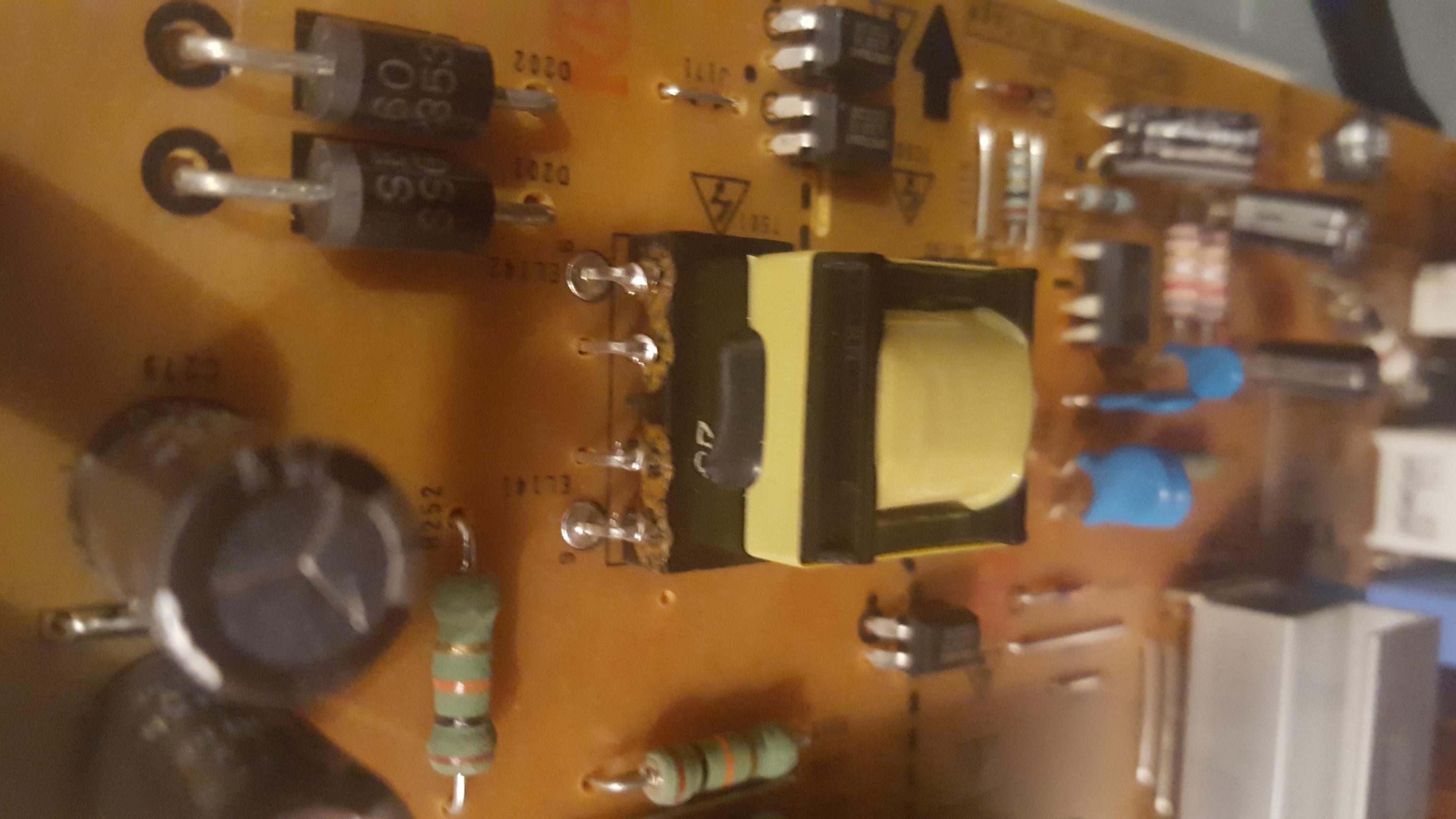

          That little transformer is for the Standby power supply and it is working because you are getting the 3.5VDC.
          BTW, when you were checking the Voltages on the HOT side, what did you use for e GND for the meter, chassis?

            Hi here's the top side photo, I will get the bottom side tomorrow, yeah chassis as ground.

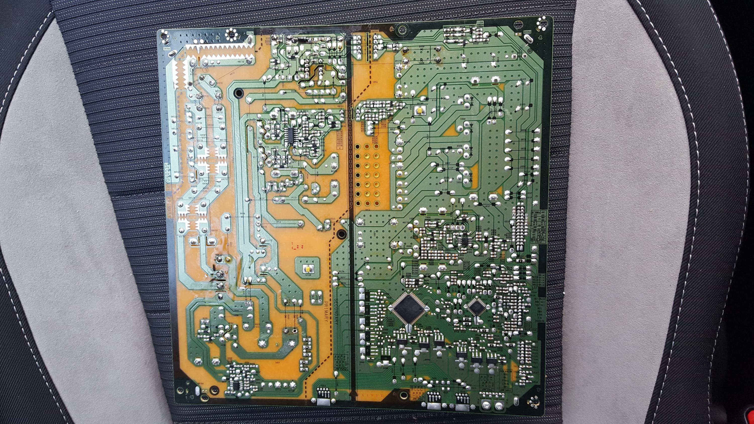

                  Here's the photo of the rear of the board, please excuse the messy soldering in places I intend to tidy up after I've finished and return that diode to the other side 😕

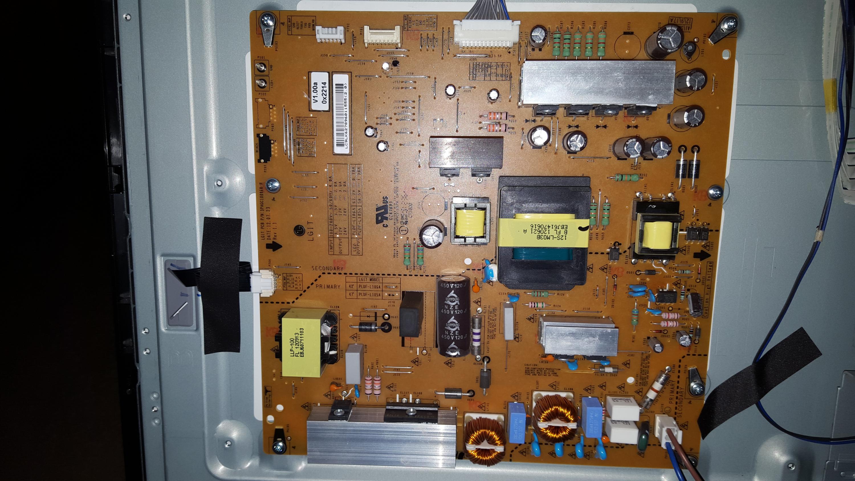

                    Have you checked that both fuses are OK. What is the DC voltage across the two legs of the marked capacitor
                    1) in standby
                    2) when you connect 3.5V to Power On using the 1K resistor

                      Thanks for the info sorry for the late reply been away a lot with work, across the 450v capacitor I'm getting 400v I've checked the fuses for continuity and checked both sides for voltage so these should be ok?

                        What are the voltages corresponding to all the connector pins as shown in the legend highlighted in orange.

                          That's the strange thing, I get 3.5v on the 3.5v pins but nothing on any other and I've just double checked that.

                            So you have 0V on ALL the other pins on that connector and only 3.5V on the pin marked 3.5V. Is that correct? And is this with or without the main board connected to the power supply?

                              The blue wire looks as though it goes to Pin_1 which is Power_On so 3.5V would be coming from the main board to turn on the set. You can check this by switching the set into standby and monitoring the voltage on the blue wire.

                                That's with the main board disconnected but the resistor from 3.5v to power on. The main board when connected does put 3.5v on to Power_ON on the blue wire.
