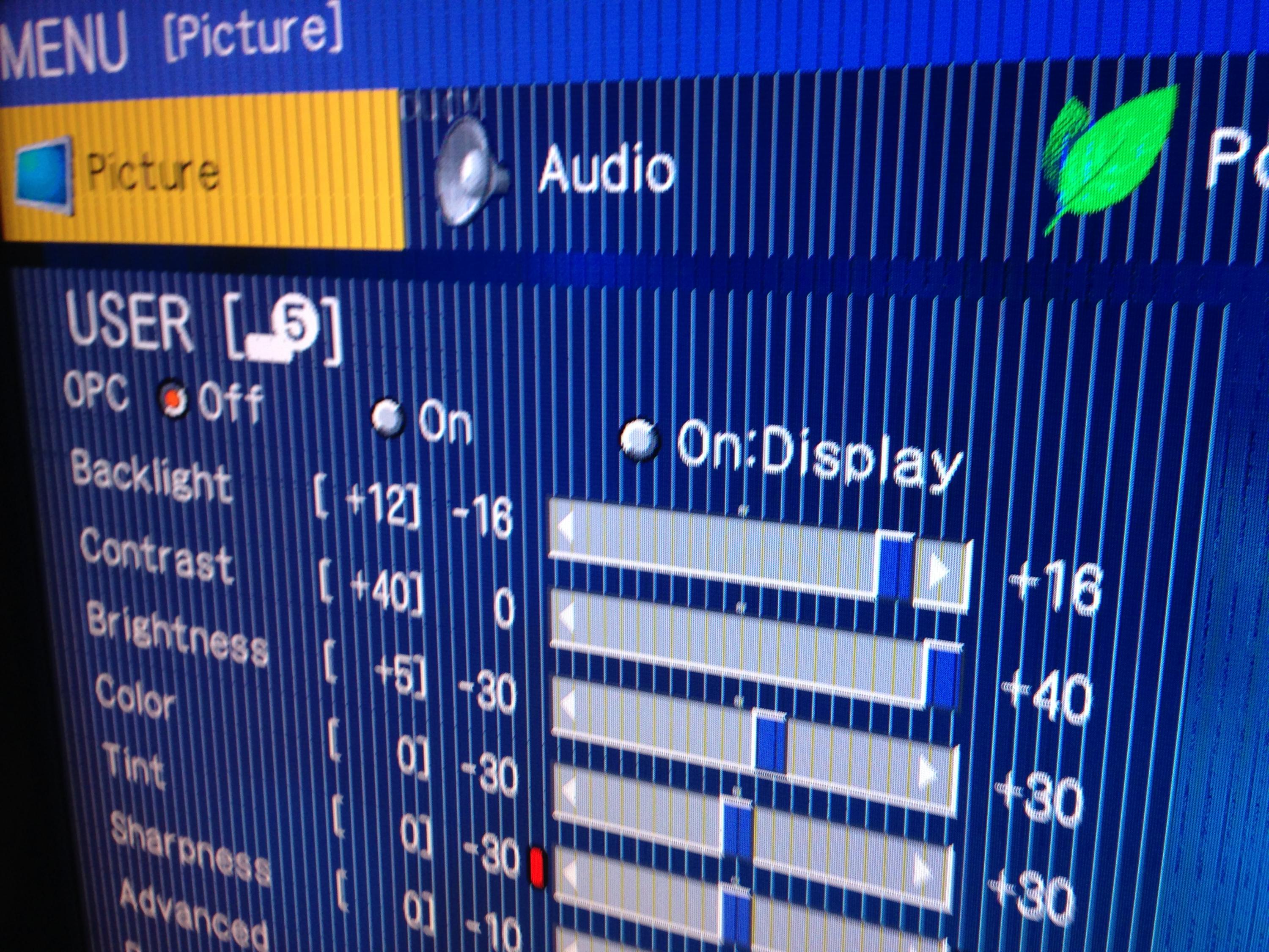

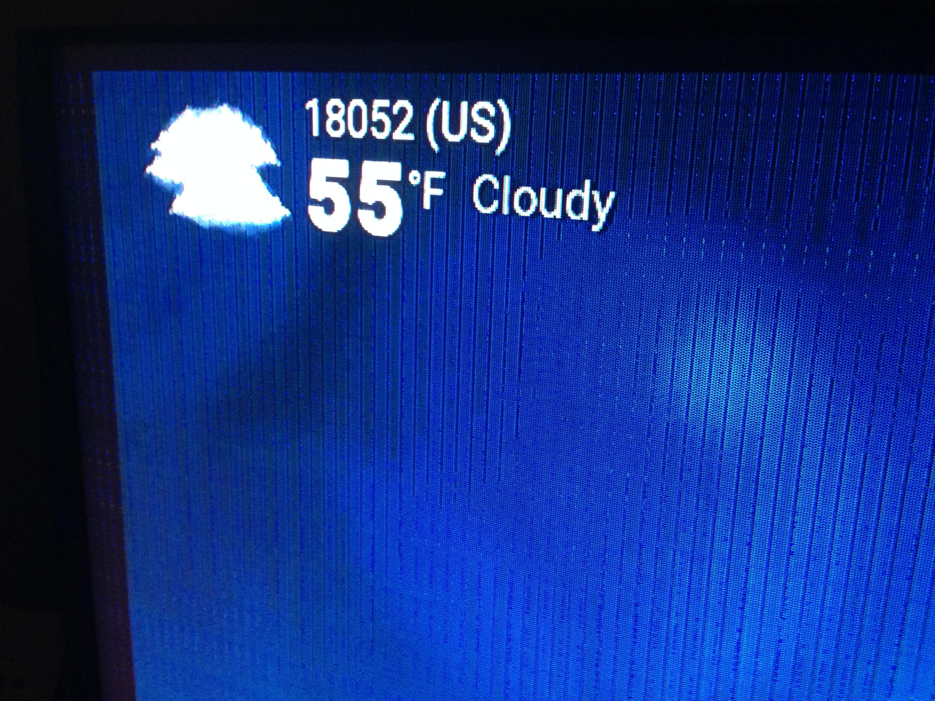

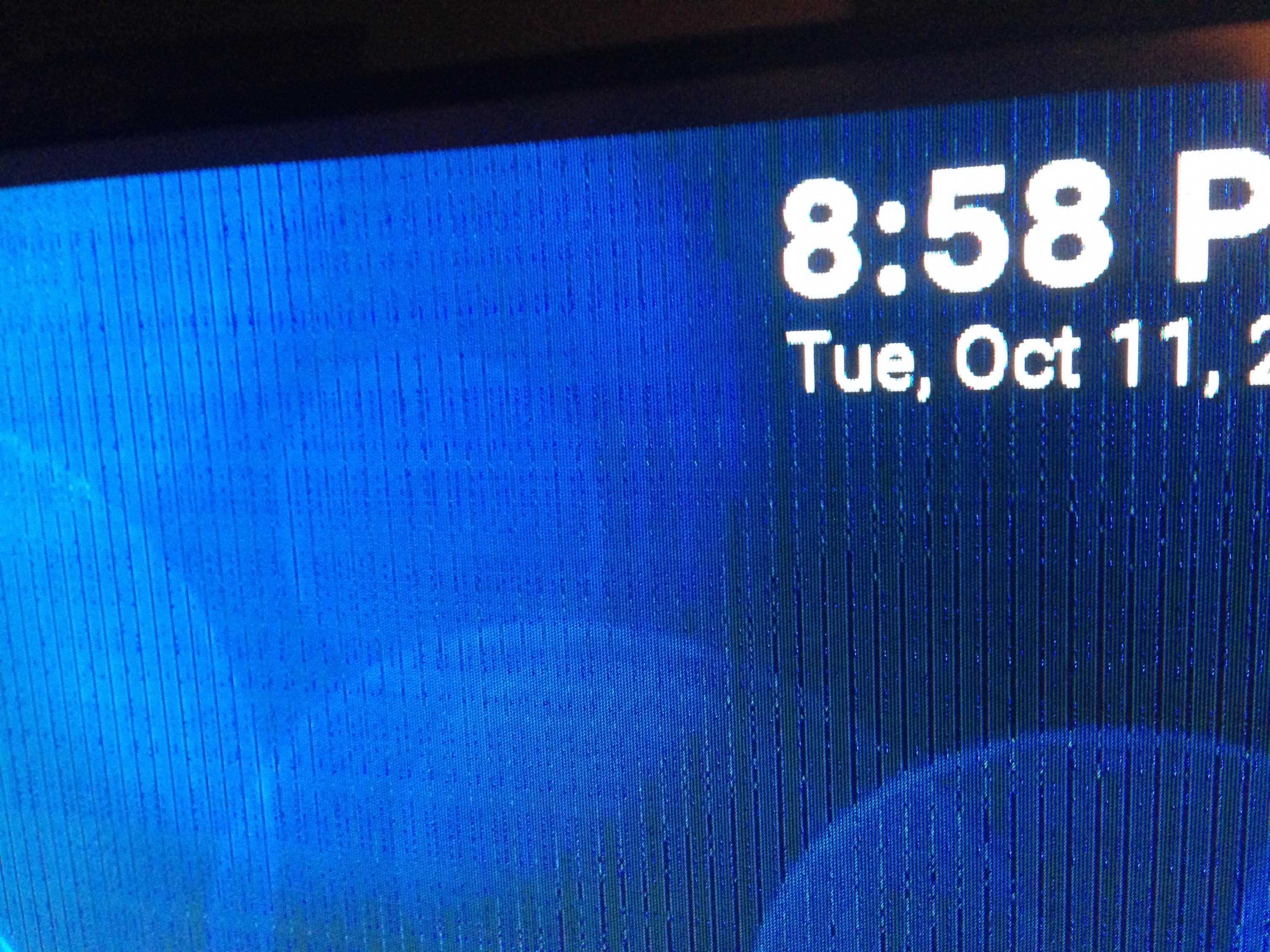

    Hi all. Thanks to the owner/mods for allowing thread creation so quickly on this site. I hope to learn a lot.
    This unit is coming up on 8 years old. The symptoms, seen in the pics, started up a few weeks ago. They appear soon after turning the set on. They occur on any input, HDMI or component. It seemed initially it was only horizontal on the display, but I may not have been looking closely enough. It does not seem to affect anything if I push on the input ports (if that means anything to anyone).
    From what I've read I possibly could get away with just a capacitor swap out or a t-con board. Again, I'm an extreme novice with this stuff and I'm only repeating a bit of what I've read around the 'net.
    Any assistance to set me in the right direction would be highly appreciated. I hope the pics are good enough.

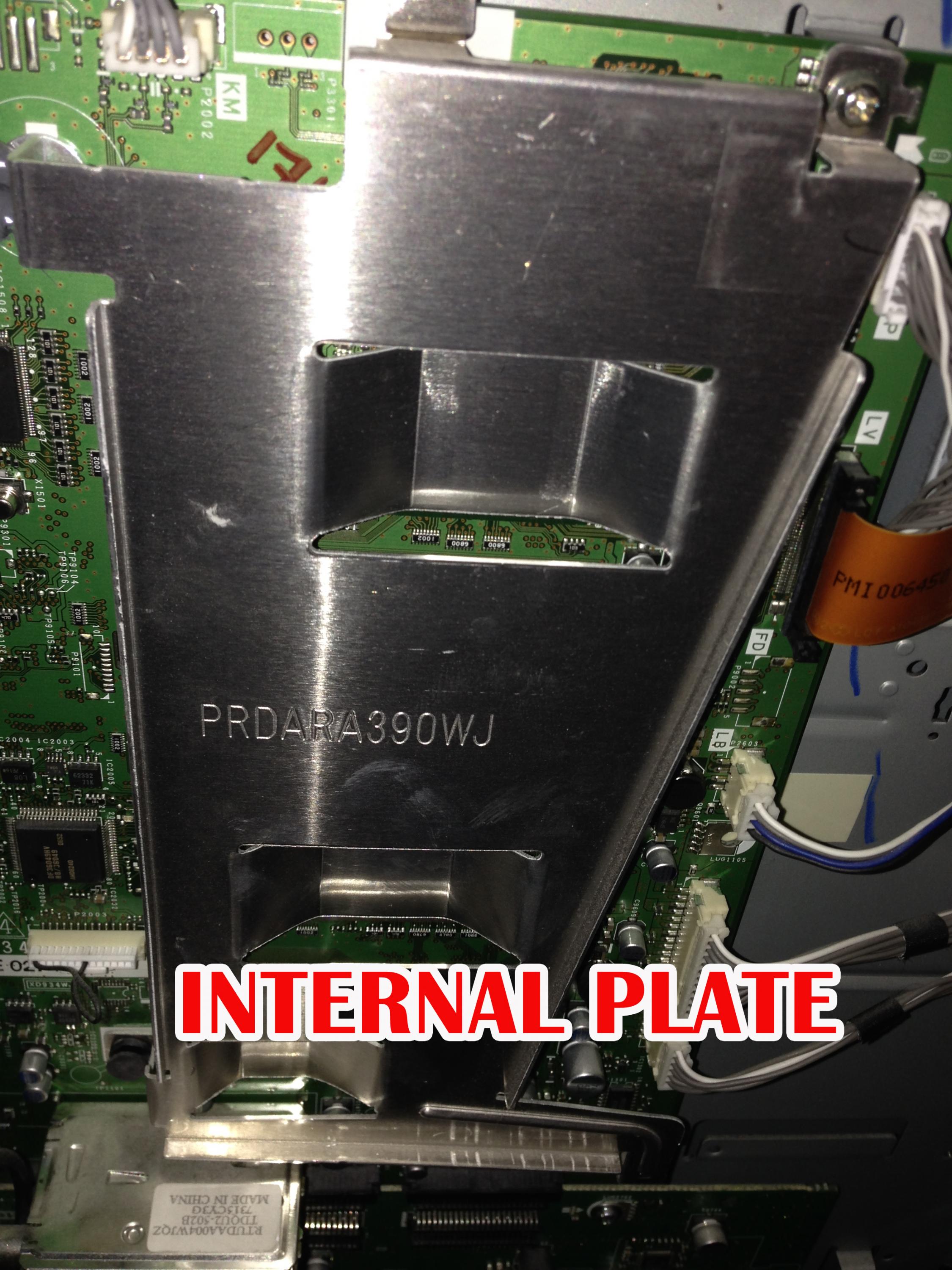

        The main board is the board that takes all the inputs. On that board there is a metal shield underneath that Shield there's a processor near the top of the board and near that processor there's two smaller black squares one above it and one near the right side. The small square above the main processor with the heatsink on it is most likely the problem you could try hitting that one up with a hairdryer in with the TV on and see if it goes away. This board is a real bugger to fix. I have not successfully been able to repair it yet with the ones I worked on

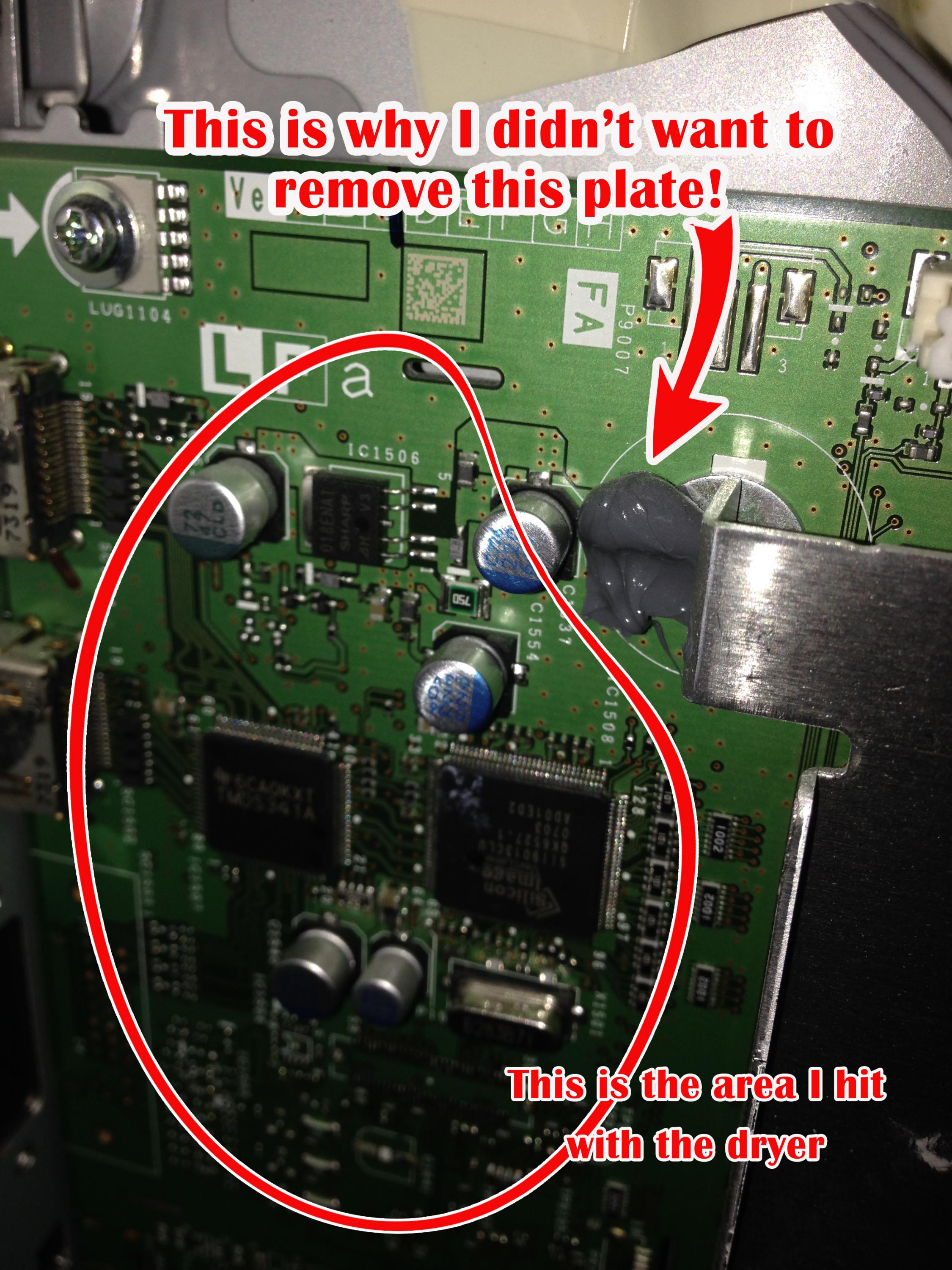

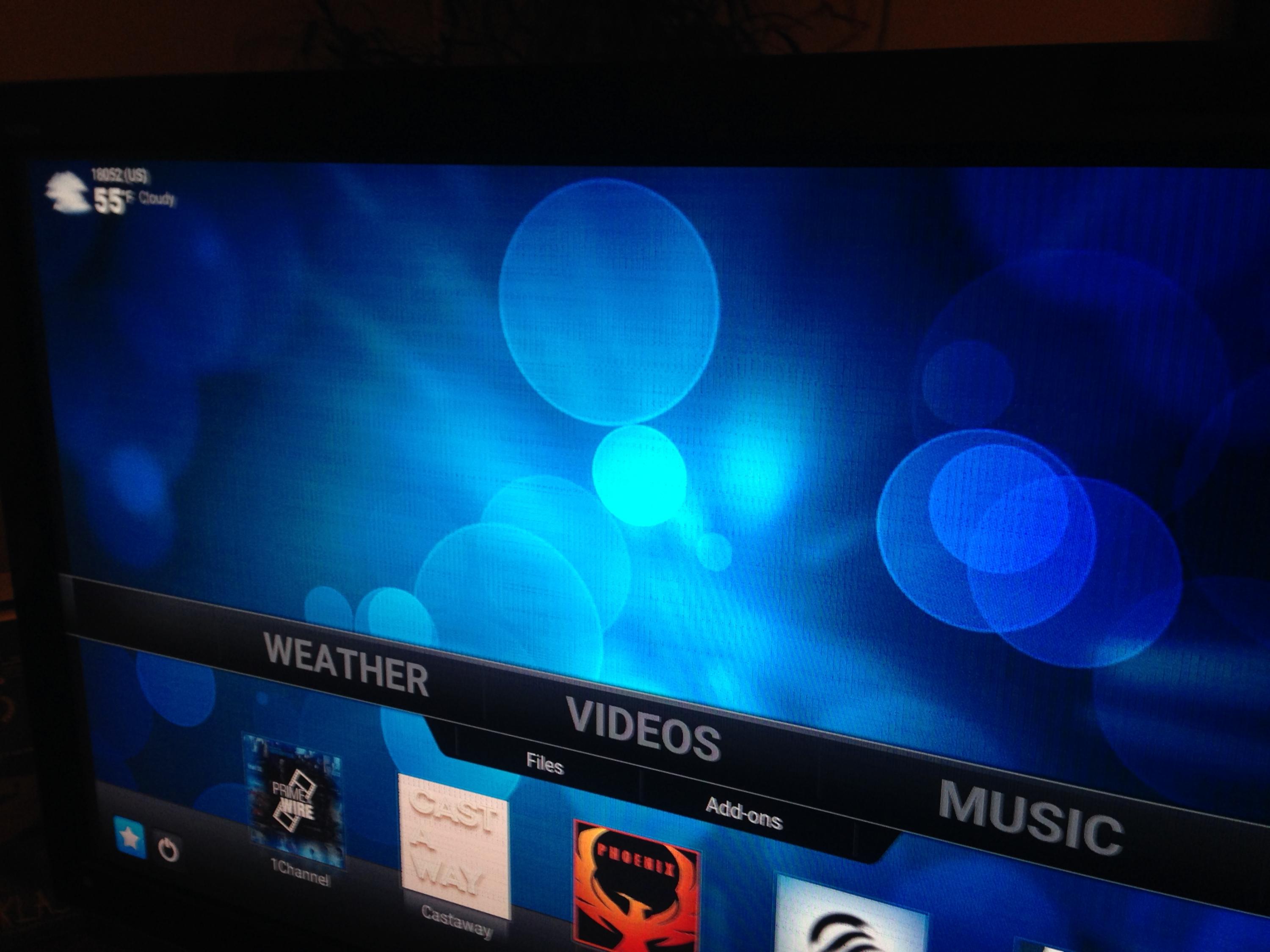

                Hey, just as a follow up, wanted to let you know that the early testing of this has seemed to work so far. It was a real bugger getting that inside shield to come off as the screws were incredibly tight, but managed. There does seem to actually be a secondary shield on that main board. I didn't really see a traditional looking heatsink, unless it's under that second shield (see pic), which doesn't simply have screws to detach it.
                Therefore, I just hit that area with the lower level of heat on a hair dryer. The lines did come back initially, so I continued doing it. It seems to be holding better now. I'll probably apply the heat one more time before closing the unit up.
                Does anyone know why this works? I suppose there is no way to tell how long this is going to last.

                  Hitting it with heat isnt a fix its really to prove what board is at fault so now to need to look for a replacement board look for any stckers etc on the board as you need too match all the numbers up on your replacement.
                  It could be one of the ics at fault or maybe a bad smd capactor can you narrow down the area your heating maybe use a cardboard roll and blow the hot air down that way you can heat a smaller area.

                      I'd start by replacing those caps under that heatsink,bet one has high esr.

                          Those little cans you see in the circle you drew. there's 5 of em,they are prone to "dry out" by the heat under that heatsink.
                          If you have a can of air,the ones you get to blow out your pc,and hold the can upside down you can freeze those caps while the tv is on and see if the symptoms go away.

                            By freezing those caps,they often start working as they should for a bit,giving away that they are defective,hope that makes sense to you.
