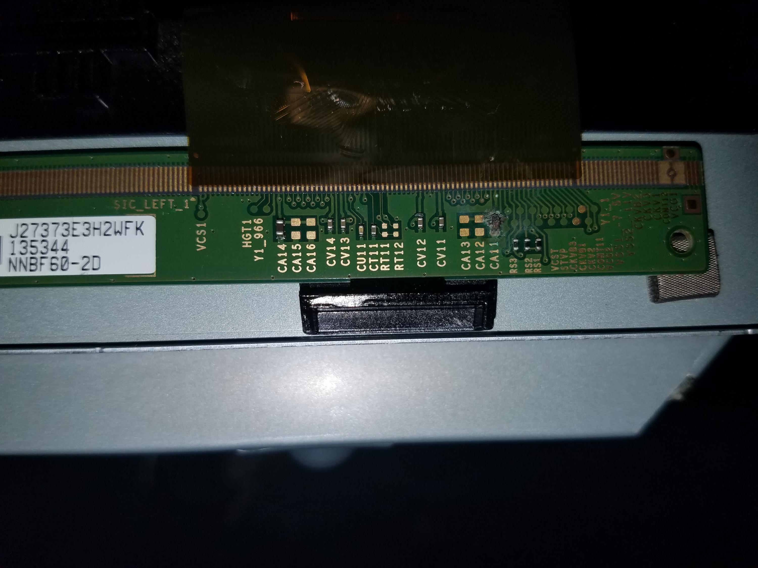

            Here are the pictures with the lights out and with the cable behind from behind the right side disconnected to the panel then with just the cable behind the left side disconnected. The screen appeared to be normal backlights with the lights out before disconnecting anything. When disconnecting the cable behind the left right side showed the screen split in half with vertical lines on the left and a white screen on the right. Once plugged back in and turning on I noticed that the a definate line between the 2 sides so I disconnected it again, cleaned it with alcohol and made sure it was seated perfect and it seem to look like normal backlights at that point but still a separation line and as if there was a vertical 'grain' that I hadn't noticed before. Appearance of the screen with only the cable behind the left side didn't change anything.
              Re: Vizio M3D550SL
              It is one of those LCD panel that has the tab bonding on the bottom edge of the LCD panel which usually get damaged by the cleaning fluid that the customer spray on the screen directly instead of damping the cloth.
              That is what I suspected to what had happened to the screen.

                  You need to remove the LCD metal frame to get to the tab bonding boards and do the visual inspection to see if there is any corrosion damages to the bonding.

                      What happen is that the corrosion will eat away the fine traces, and parts.

                        Well you pinpointed right to the source of fhe problem... there were 3 drivers on each board and the it was only one, the middle one on the right side board. I guess the panel is junk?
                        Thanks for all your help
                        • tjmethod
                          • Jun 2013
                          • 137
                          Re: Vizio M3D550SL
                          Even though I cleaned it thoroughly woth alcohol, that only made it look like it wasn't corroded.
