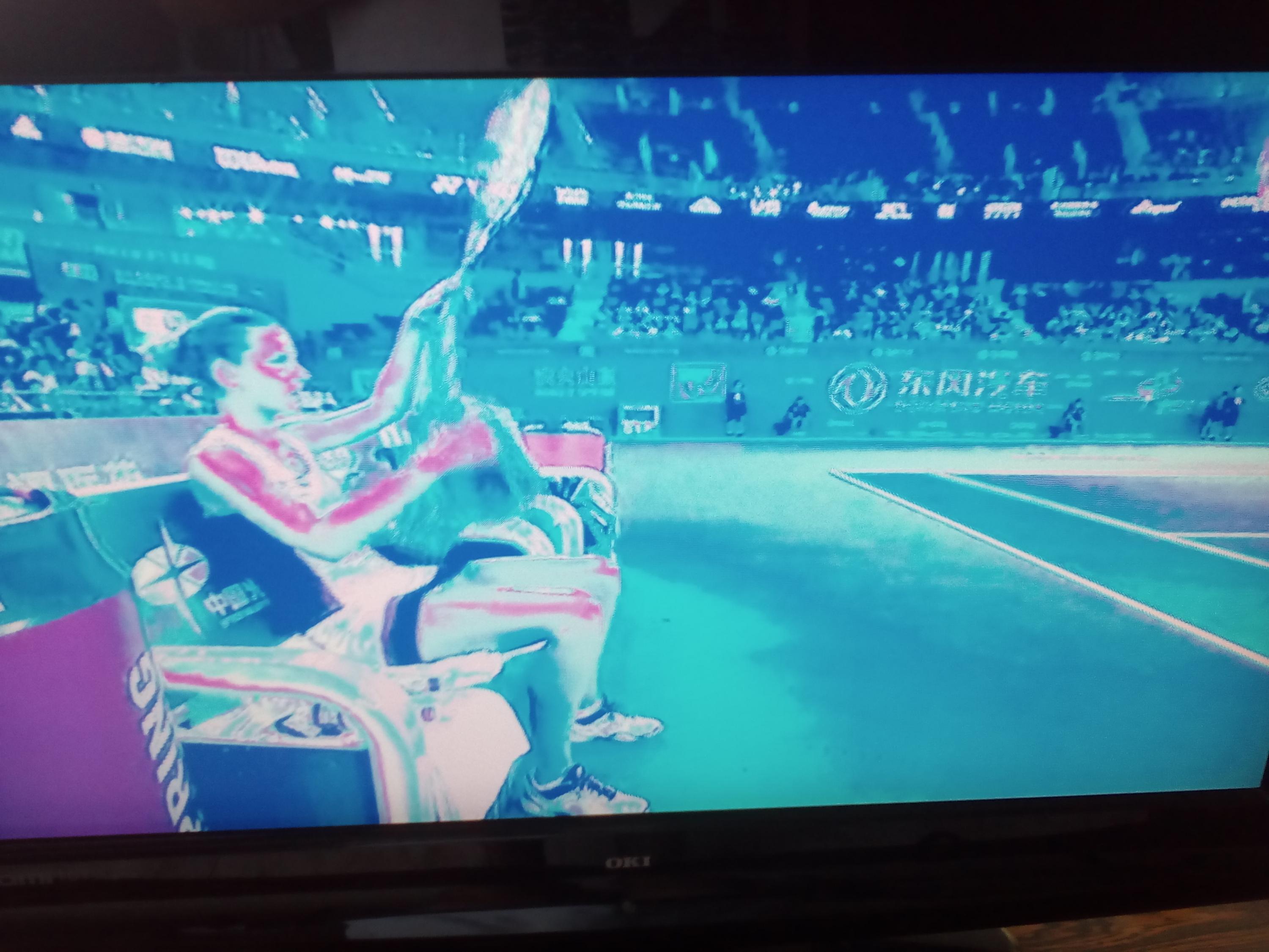

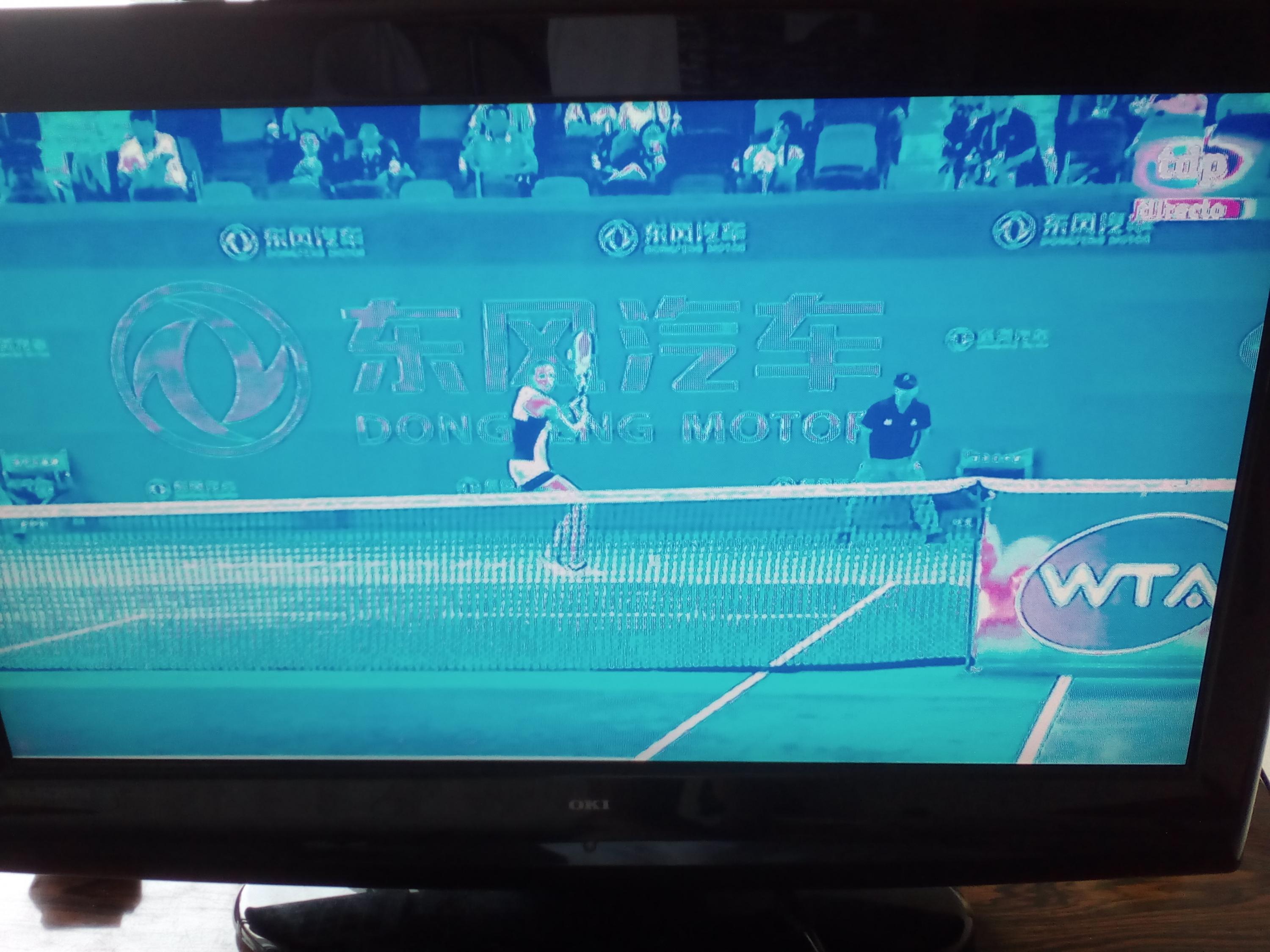

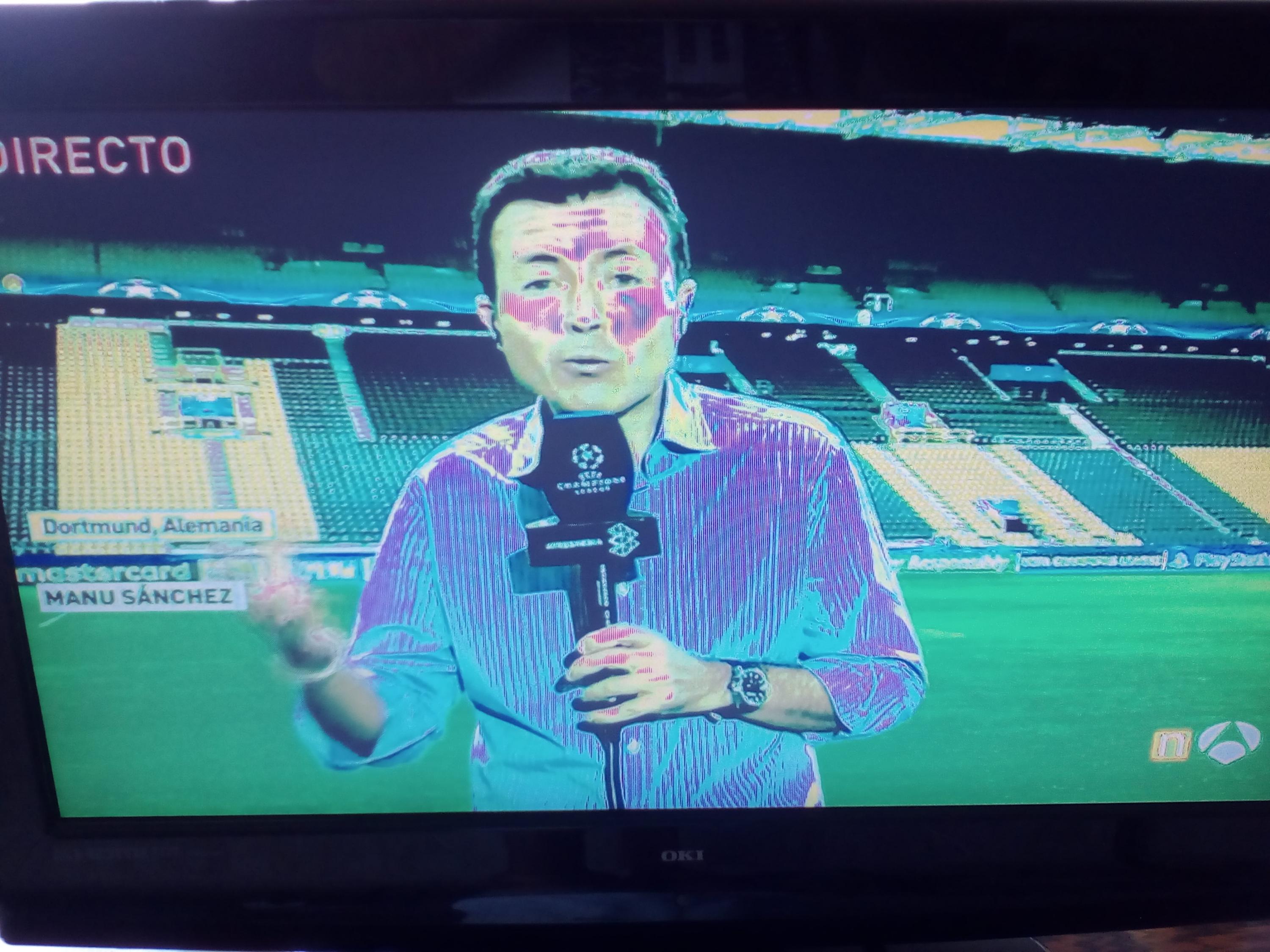

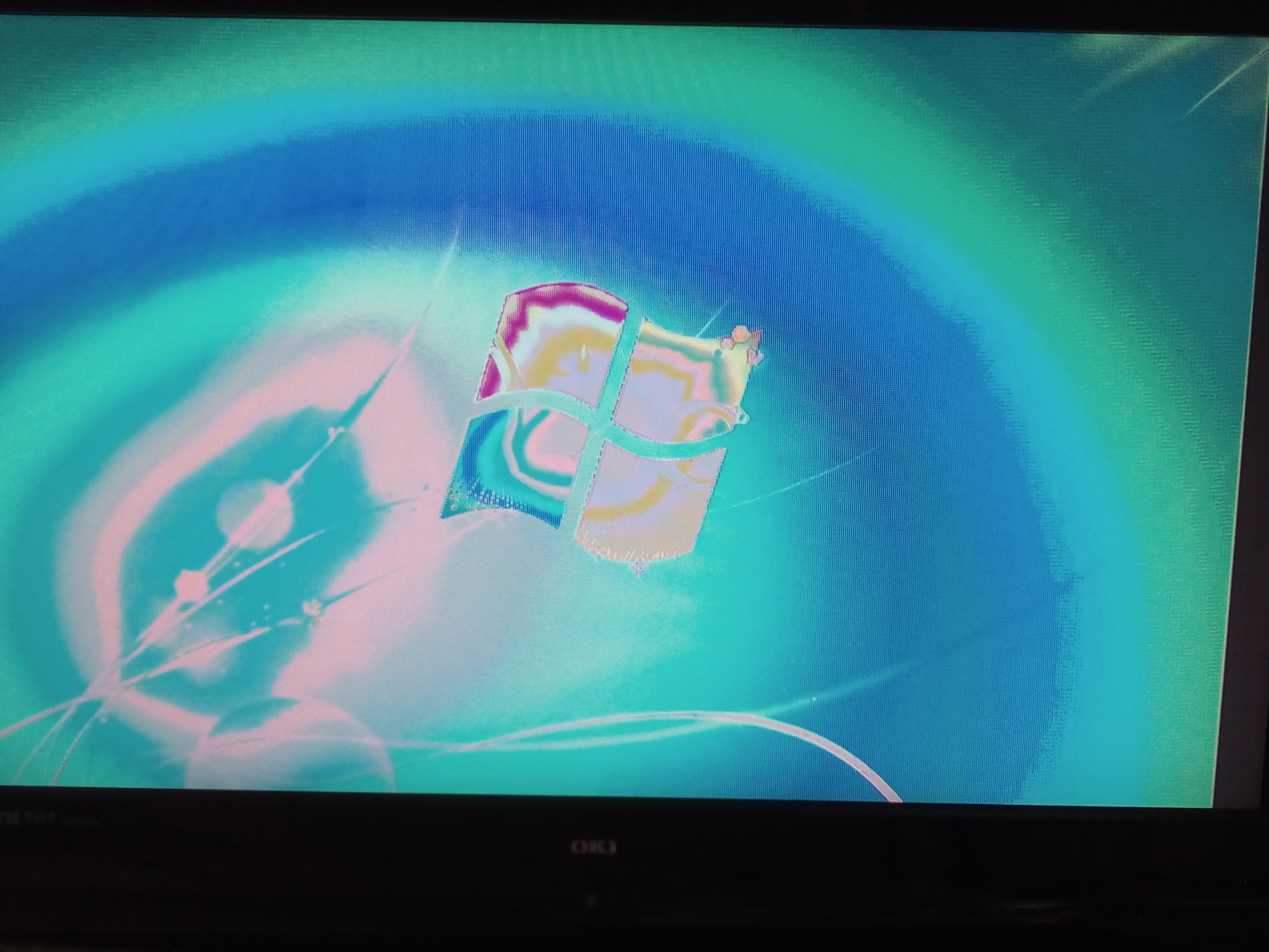

    Bad image, good OSD.
    I change EEPROM 24C32 and problem continues.
    I tried with a external TDT, internal TDT and HDMI.
    I look into service menu and check an error on HD.
    I think that there are some circuit with a short circuit.

    Looks like bad GAMMA Voltages on the T-CON board, it can be due to bad GAMMA Vref IC or wrong panel setting in the service menu.

      Go into SM-4725 then find Lvds mode normally in the picture section and change its value. Problem solved. Also consider checking Tcon voltages could be gamma Ic as bud says.

        I enter in service menu but i cant change lvds mode.
        I think that problem is some lm1117 regulators.

          now, I change LM1117 regulators but problem continues,... I this that there are a short circuit in anywhere
