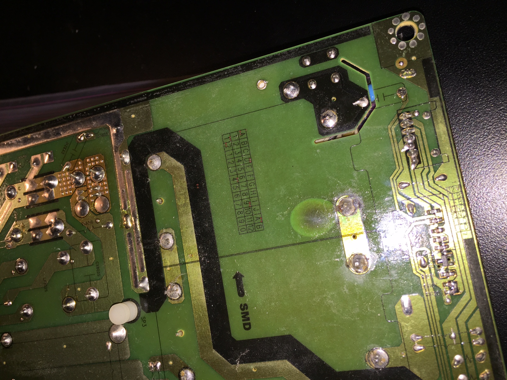

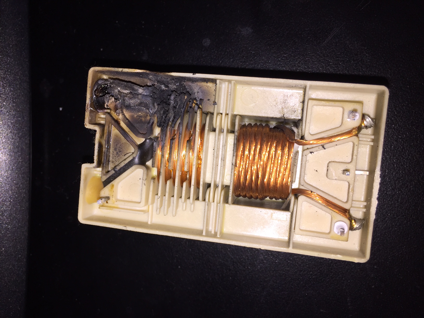

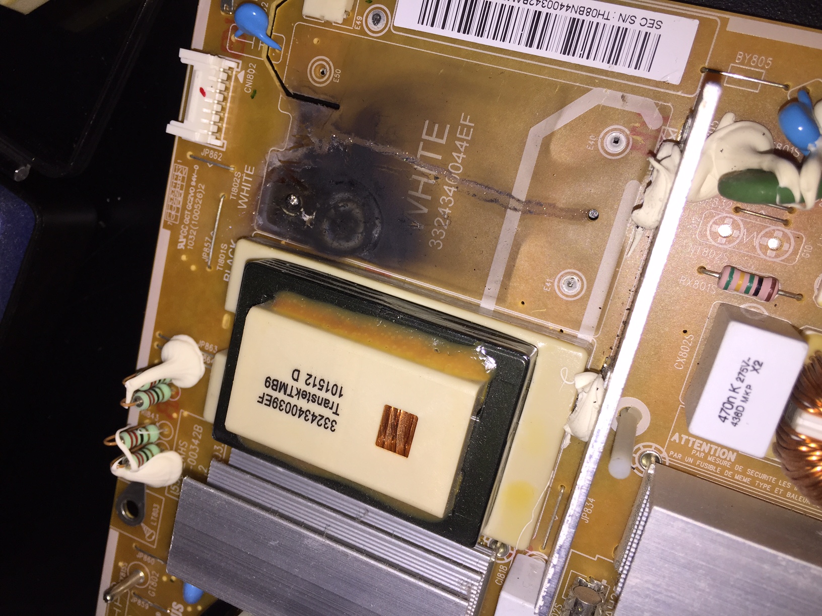

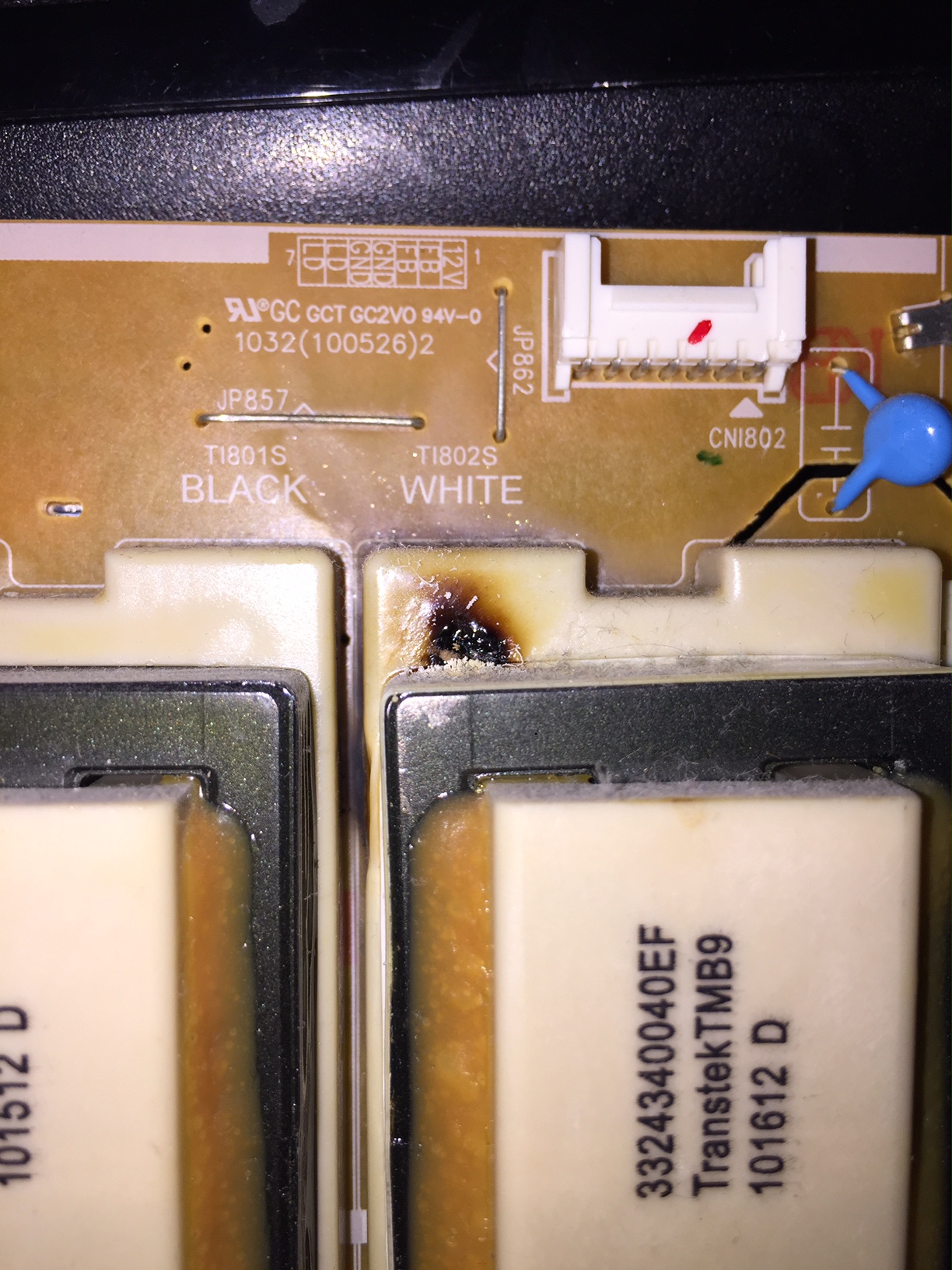

    Hi everyone,
    A friend of mine gave me his TV after it stopped working, he gave up trying to fix it after it caused him so much trouble throughout the years (flickering image, sometimes no backlight, etc.). The latest problem was a weird noise and no power.
    I opened the TV and saw the power supply board with a transformer burnt. Here's the pictures.

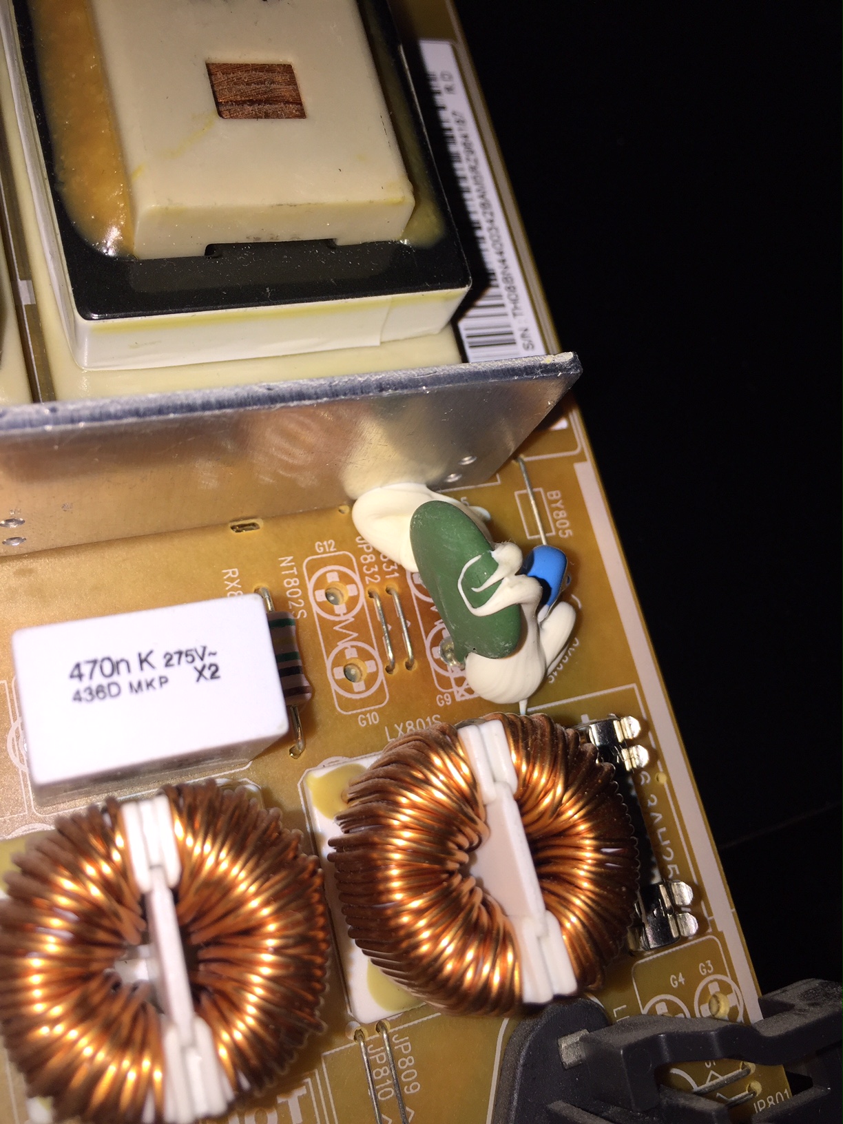

    Notice the green component has slightly darker color on the board, could it be an issue with that also? Would it be safe to replace the transformer? Anything to look for that might have caused this and that should also be replaced?
    Thank you

    Re: Samsung LN55C630K1F power failure (BN44-00342B power board)
    I would replace both of those inverter transformer at the same time, it got hot and discolored the PCB. You also need to check the inverter transformer drive circuit to see if anything else are damaged or not when that transformer failed.
    Cutting the jumper is NOT a fix, all it did is bypassing the PROTECTION circuit. The PFC Boosted Voltage is low that is why the backlights were flashing, if you check the DCV between the two legs of the main filter cap, it will probably show about 360VDC in stead of 380~400VDC.
    Someone should tell that guy on YOUTUBE of what he actually did, bypassing PROTECTION CIRCUIT!
      If you remove the protection circuit for the backlights, I would only recommend that for testing purposes, nothing else. There is a reason for a protection circuit. Disabling it isn't such a bright idea in order to "fix" the TV.

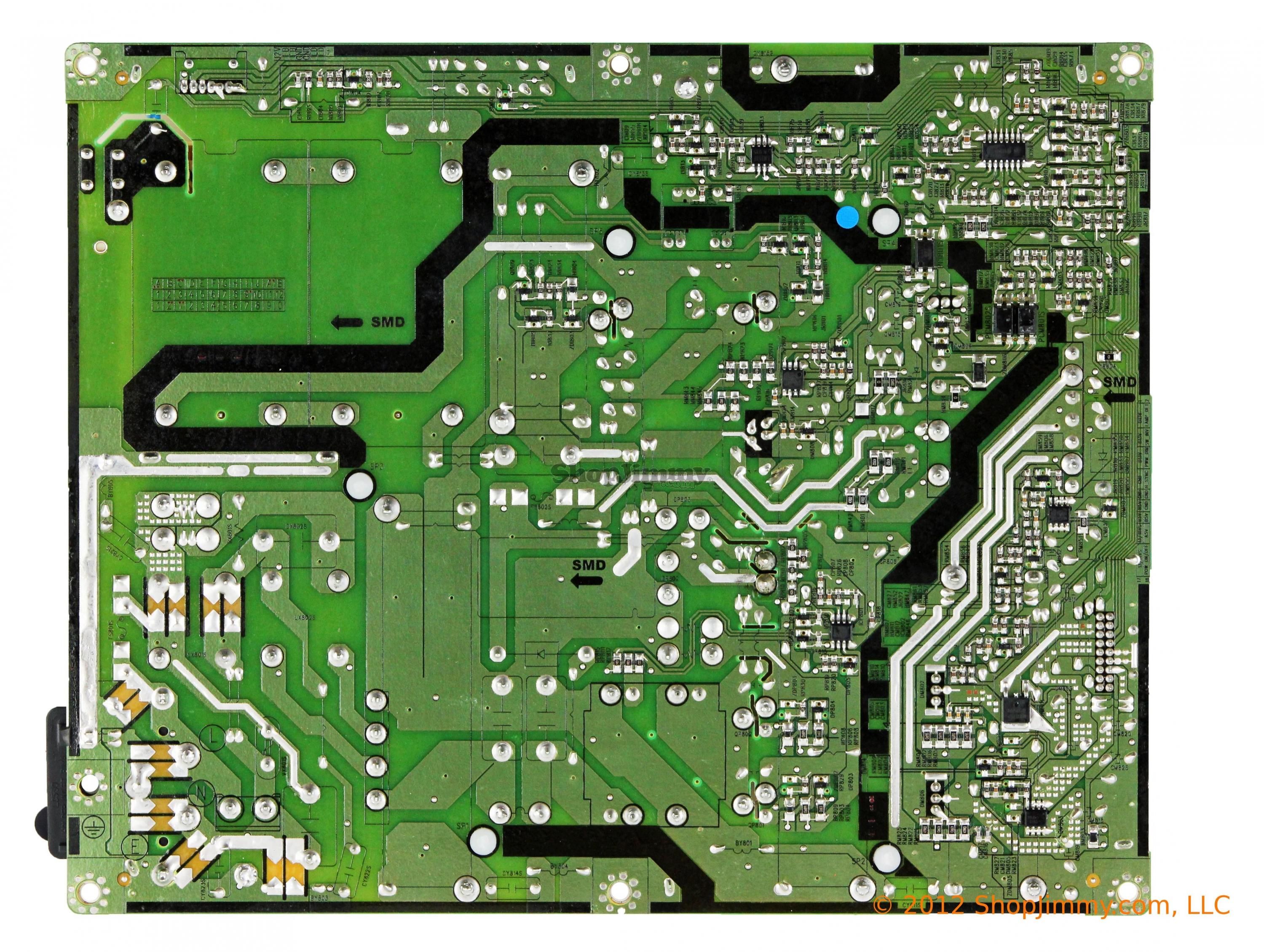

            Take the transformer off the board. Who knows what it is going to look like underneath of it. Also that transformer is obviously toast, so you could find a bad PSU and swap out the transformer, find a replacement transformer online somewhere, or buy a new PSU altogether. Another option is to fix that transformer and take it apart.
            • matomato13
              • Sep 2016
              • 31
              Here's the board and underside of the transfo
              I tried searching for a replacement part but nothing comes up and I have no specifications on what's needed.

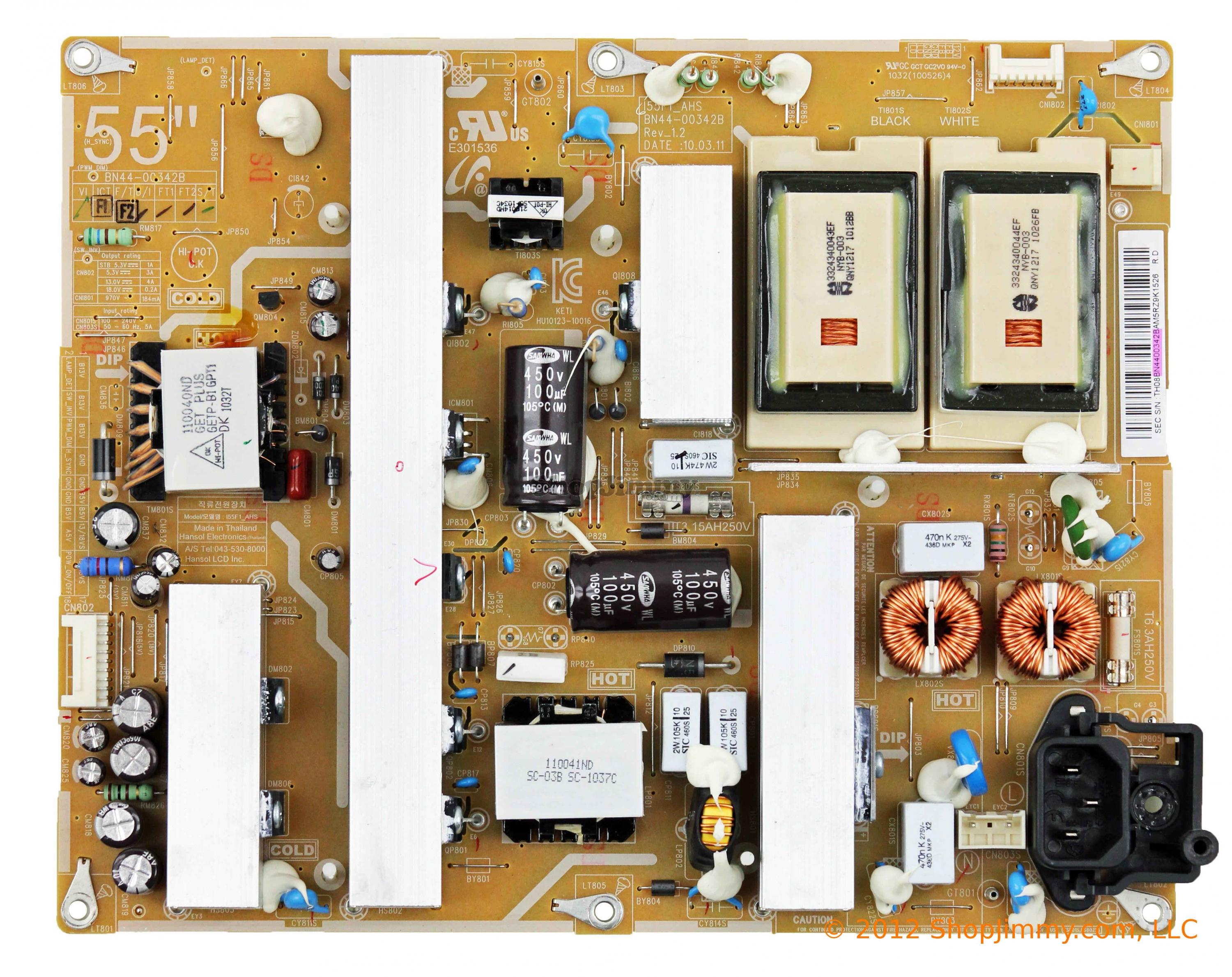

                OK so I replaced the power board completely and now the TV turns on. But there's no backlight.
                Here's the startup:
                1) Red light blinks
                2) Samsung power on music plays
                3) Backlight turns on before picture then turns off
                4) TV is on but no backlight, I can see the image with a flashlight.
                A few years ago I replaced the two backlight inverter boards, I thought it might fix a backlight turning off after watching TV for a few hours problem, but it didn't, so the boards should be fine I think. I just replaced them and I have the exact same behavior, no backlight.
                Where should I look for now?
                After doing a bit of research I've found an old thread where budm you mention something about protection mode because of a lamp problem (https://www.badcaps.net/forum/showthread.php?t=25316) Could this be it and can something be done?

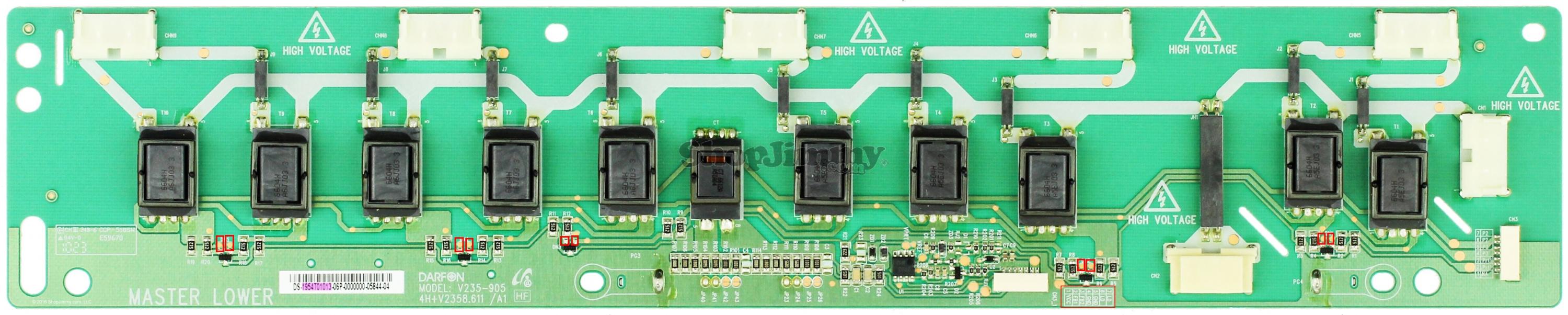

                          I tested the transformers and they are good. I'd like to do a test like this to find out which CCFL (or it's connection) might be causing the issue but I'm not sure which pin I should take the measure on.
                          https://www.youtube.com/watch?v=oE6K4xBVweA
                          Here's the inverter boards I have
                          http://www.shopjimmy.com/auo-19-54t0...t-inverter.htm
