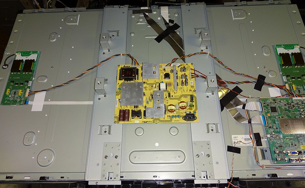

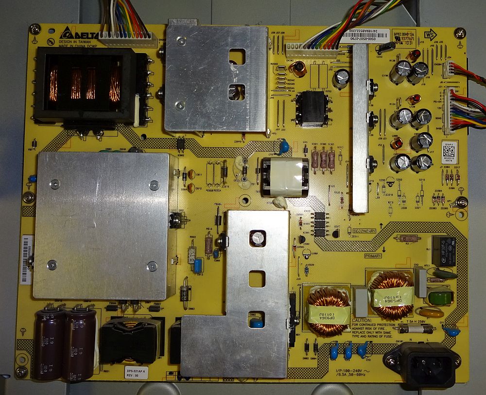

    I have a old Vizio E550VL with no backlight. I do have a picture when I use a light up to the screen. The fuses on the inverter boards are ok and I have 24volts at those fuses when turned on. Not sure on the next step.
    Re: VIZIO E550VL No Backlight
    Next step is to check and find out if you have 24VDC at both ends of the SMD fuse on the inverter boards with ref to the chassis GND or not.
    If you do, the you will need to find out if you have BL-ON signal to the inverter board or not.

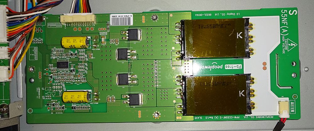

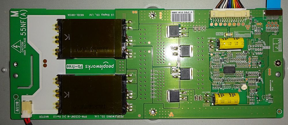

      I do have 24v. However not seeing anyplace marked bl_on or I'm blind. I did see one marked ON/OFF on inverter and that only has .5v
        ON/OFF on the inverter board is the same as BL-ON or INVR-ON.
        IF all you get is 0.50VDC when the TV is turned on then the main board is not sending the ON/OFF (BL-ON) to turn on the Backlights circuit.

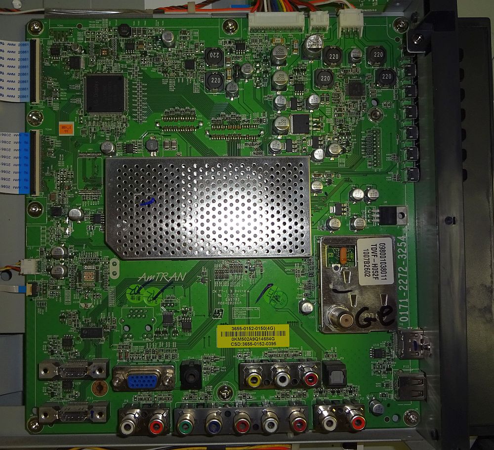

              Still only .5v after chips change.
              • CraigR
                • Dec 2013
                • 973
                Replaced the main board and is working again.
