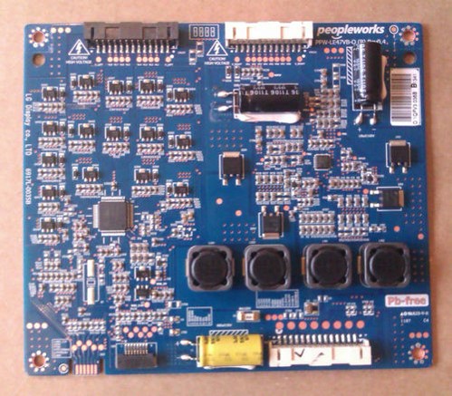

    Re: Black screen and sound on dynamic mode
    If the problem is not occurring when the led brightness is lowered then I would be suspecting an led problem or led driver problem.
    Pictures of your boards always a good starting point.

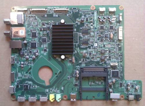

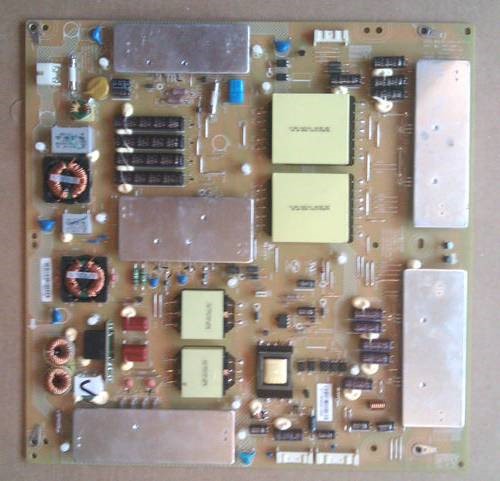

      Attached the various components
