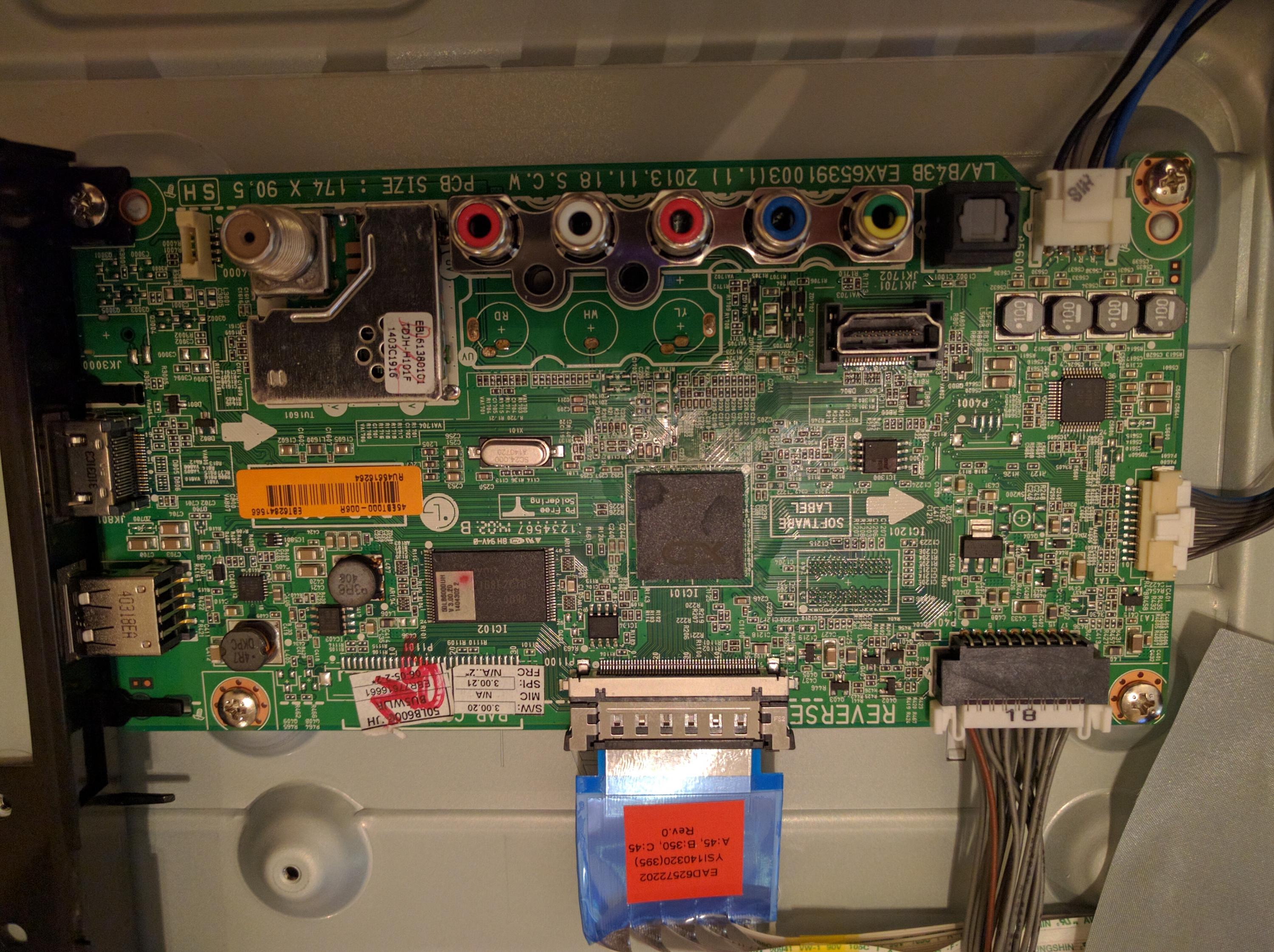

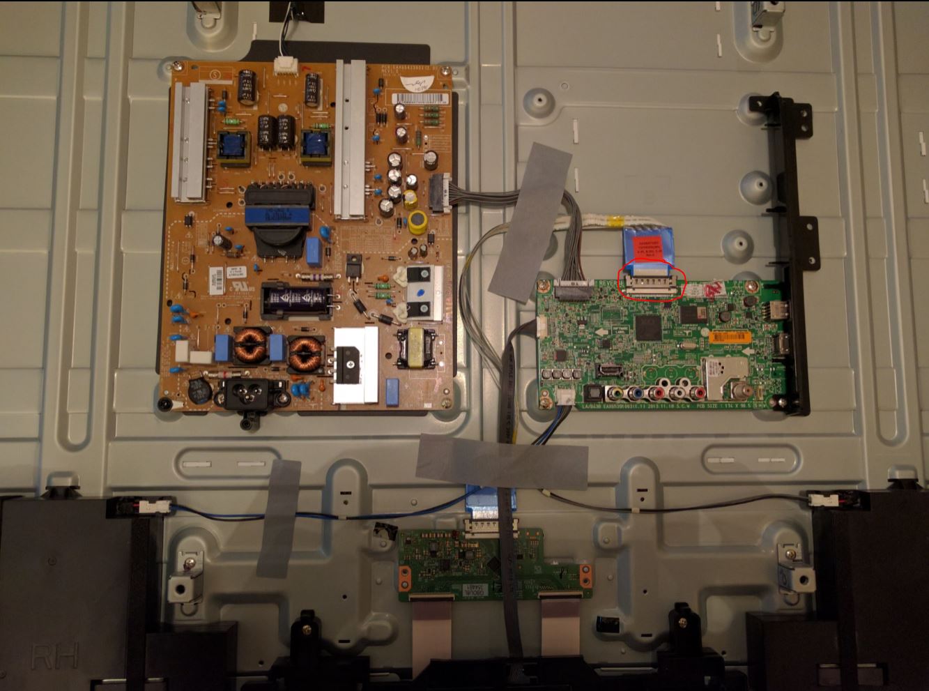

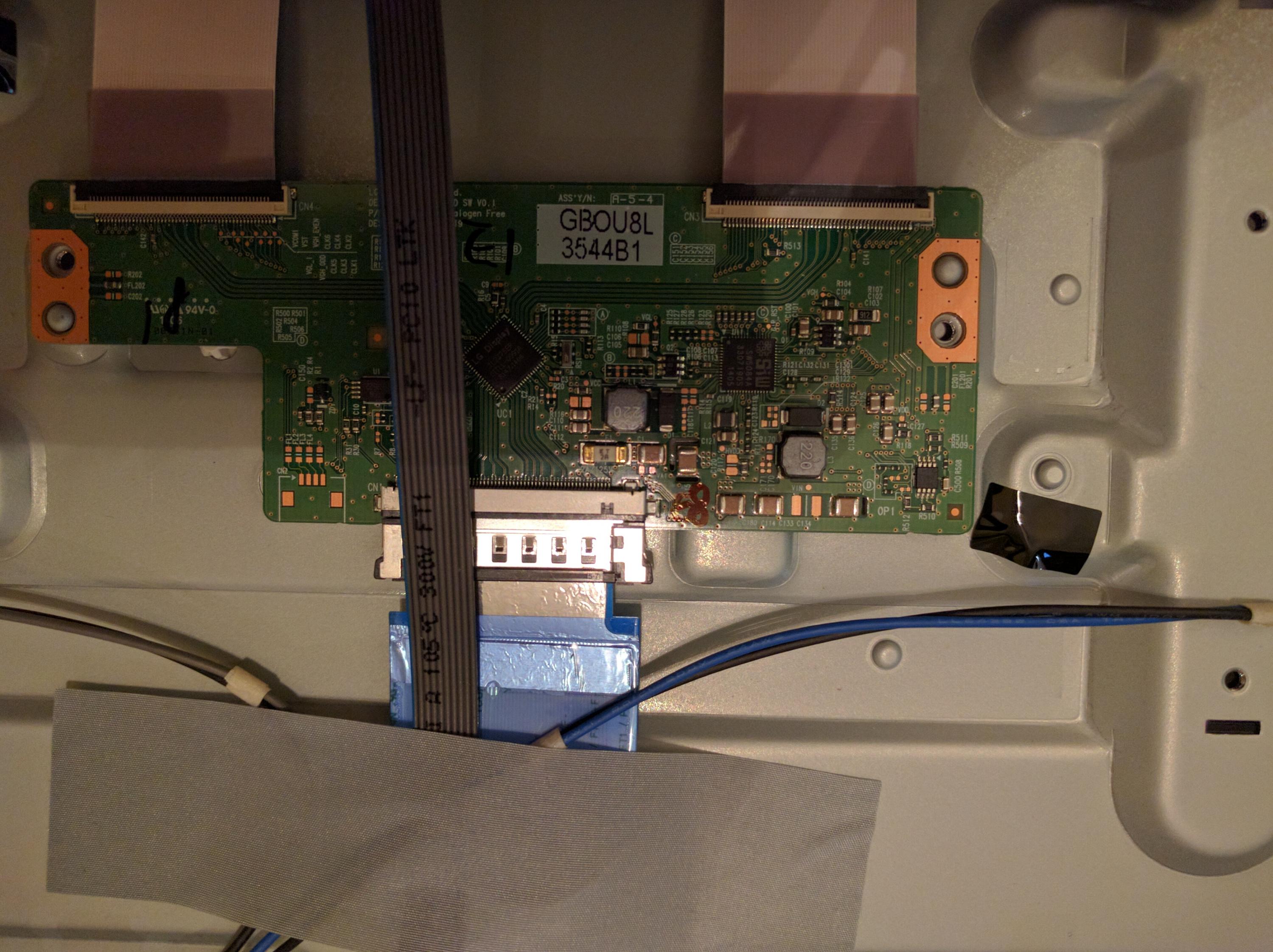

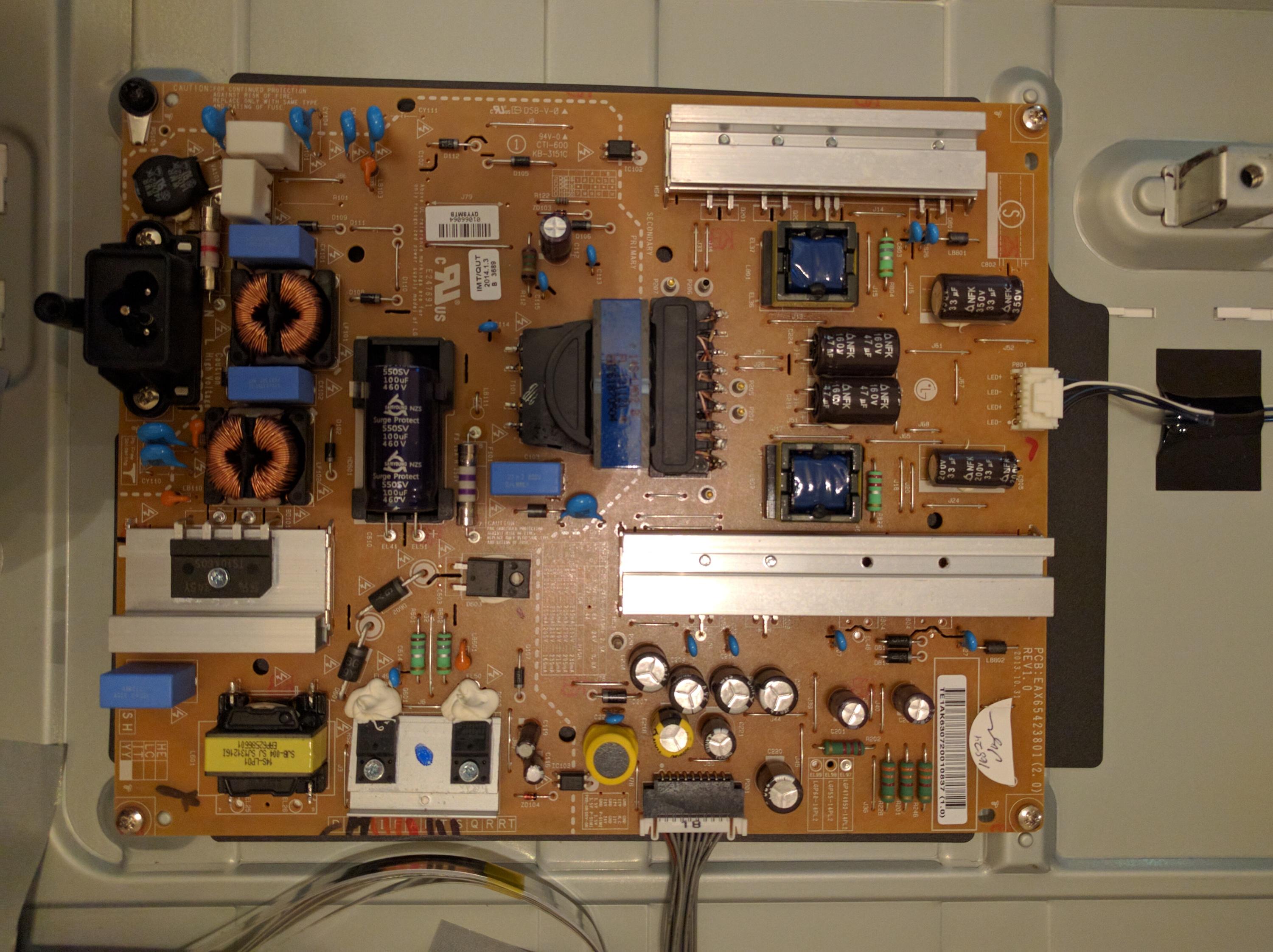

      Can we see high resolution, straight shot pictures of your boards?

        Thanks for your quick responses. I have attached some photos of the boards. I tried disconnecting the ribbon cable from the main board to t-con board, but the TV is still stuck in the same state. I have heard that heating the board up could fix some bad solder joints, but I was a little bit wary about sticking the board in an oven. I figured the plastic connector sockets would melt.

          Re: LG(50LB6000) TV No Picture/Audio, Backlights Lit
          In order for the TV to turn the backlights on without the main board attached, the PSU must have a pull up resistor.
          On the first picture on the bottom there is a plug with wires going to the main board. We want you to measure the DC V of each pin (main board connected of course), and post the results with the corresponding pin out name.
          5V STBY is always on, regardless the state of the TV. That will feed the main CPU and some circuits on the main board. When you turn the TV on, the main board sends a PSon and BLon back to the PSU (all voltage rails should be up and the backlights on).
          In your case the LED is on, but it is not responsive to the remote or the buttons on the TV itself, I'd say your main IC (XD chip) on the main board is bad. It probably got hit by lightning through the HDMI.
            So when the main board is connected to the power supply these are the pinout voltages I read:
            Pin1: GND->GND
            Pin2: 12V->12V
            Pin3: 12V->12V
            Pin4: GND->GND
            Pin5: 24V->24V
            Pin6: GND->GND
            Pin7: 3.5V->3.5V
            Pin8: 3.5V->3.5V
            Pin9: PWR-ON->3.5V
            Pin10: GND->GND
            Pin11: N.C->GND
            Pin12: 12V->12V
            Pin13: GND->GND
            Pin14: 24V->24V
            Pin15: P-DIM2->3.5V
            Pin16: 3.5V->3.5V
            Pin17: P-DIM1->0V
            Pin18: DRV-ON->3.5V
                Good news everyone, replacing the main board fixed the tv and it is back up and running. Would have been nice to figure out what was broken specifically, but $40 saved me some headache lol
                  I think the main IC is bad. The BGA is hard to replace, unless one has proper tools.
                  You could see if you find the data sheet of the ic, or a schematic of the main board and start probing
