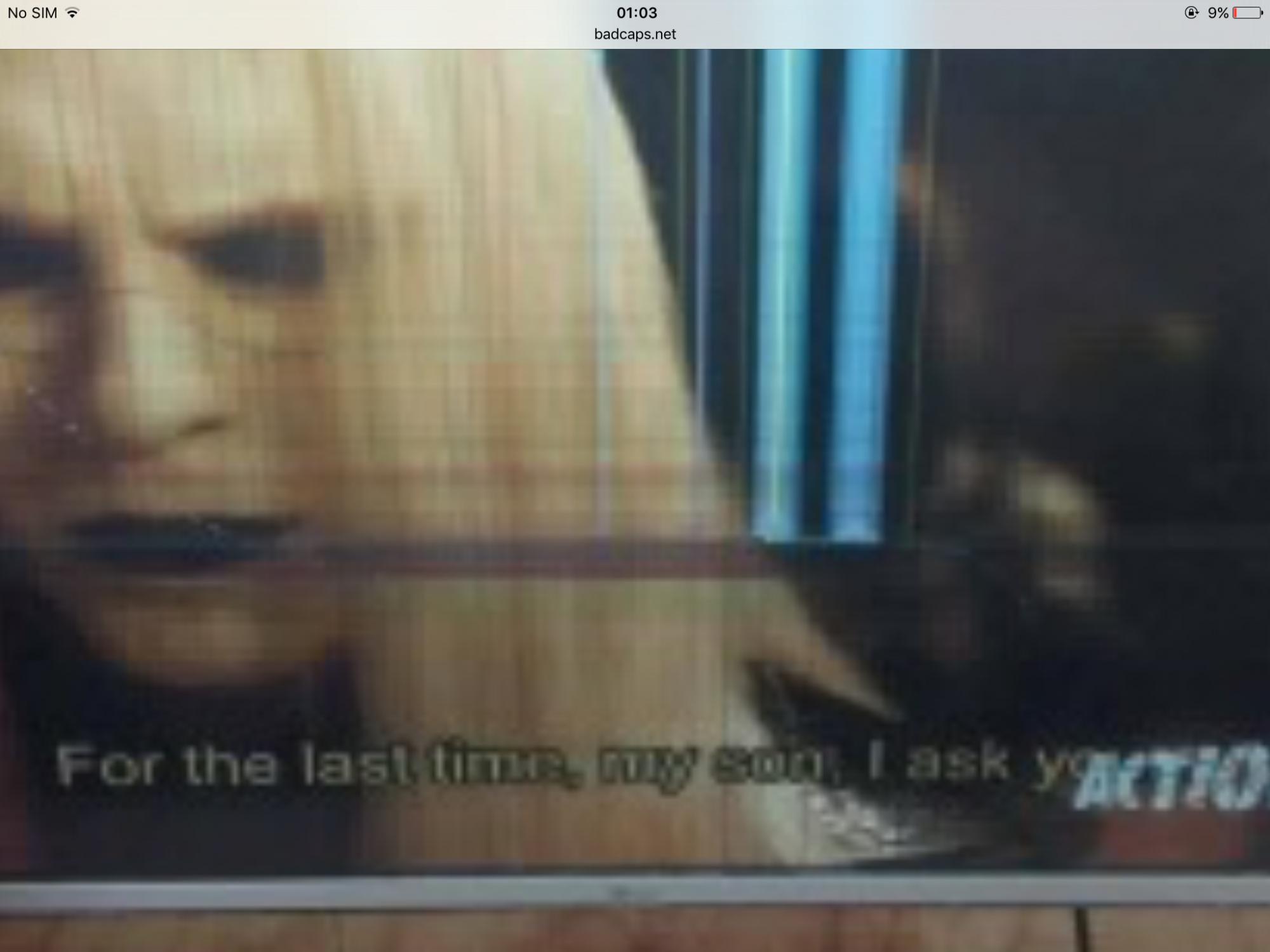

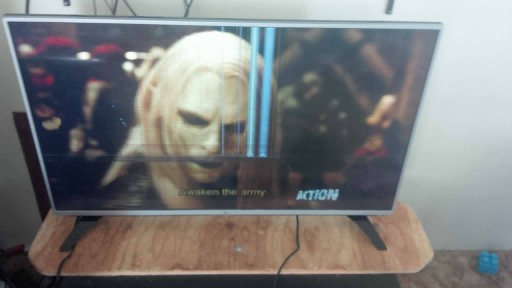

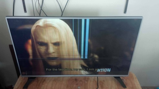

    A potential customer sent me these pics of her tv. is this a T-CON/main board or a tab bonding/panel problem. I know horizontal lines can be a bad panel, but there are vertical ones as well.

    Re: LG 43LF5400 possible panel issue
    Panel failure avoid, looks like its been cracked somewhere to me.
      Thats deffo a crack in that panel under where the blue lines start IMO:
        Thanks Bud, kinda figured that too lol. Im starting classes tomorrow so no sense wasting my time on this shit lol. I have enough on my plate now.
