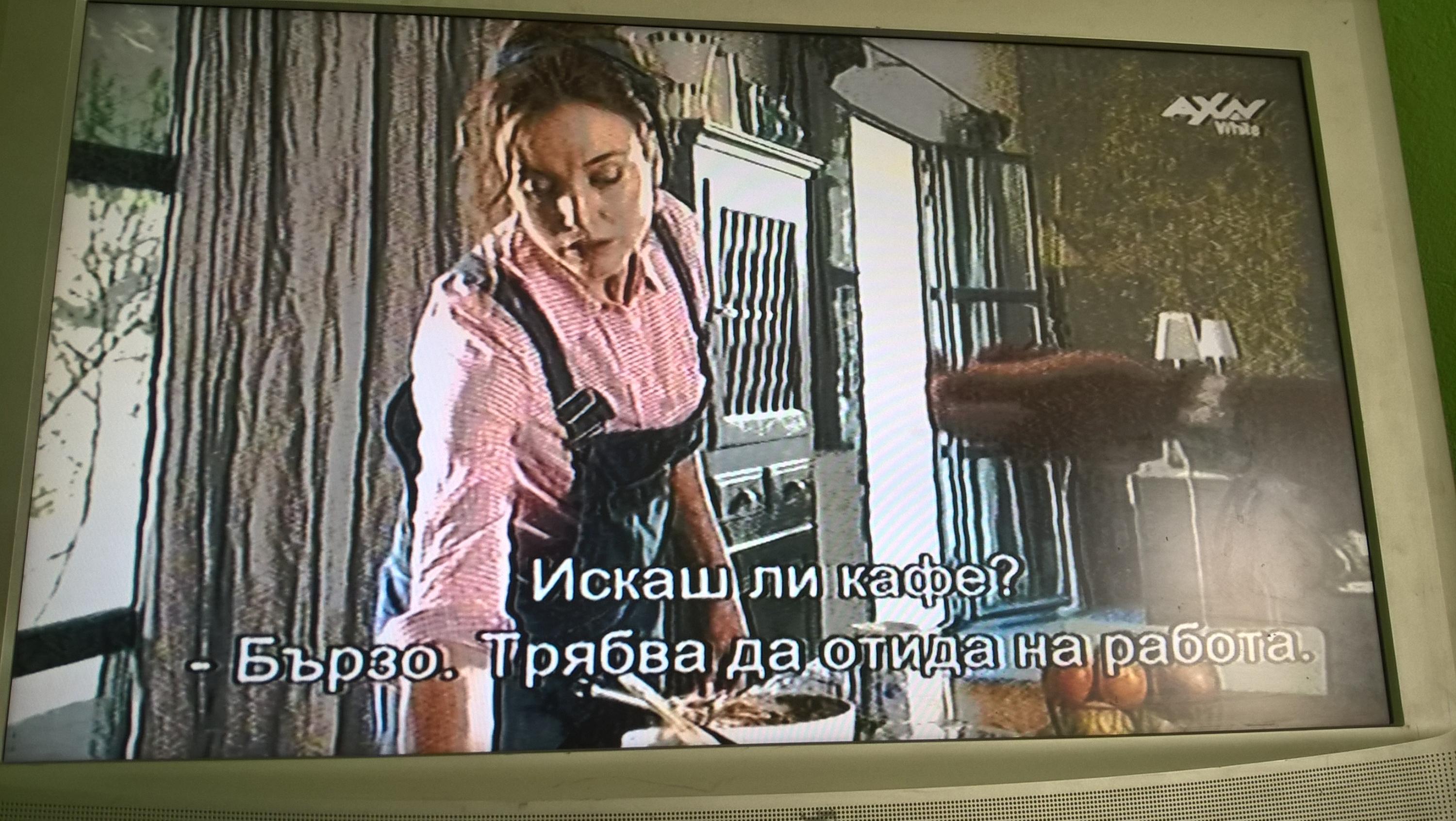

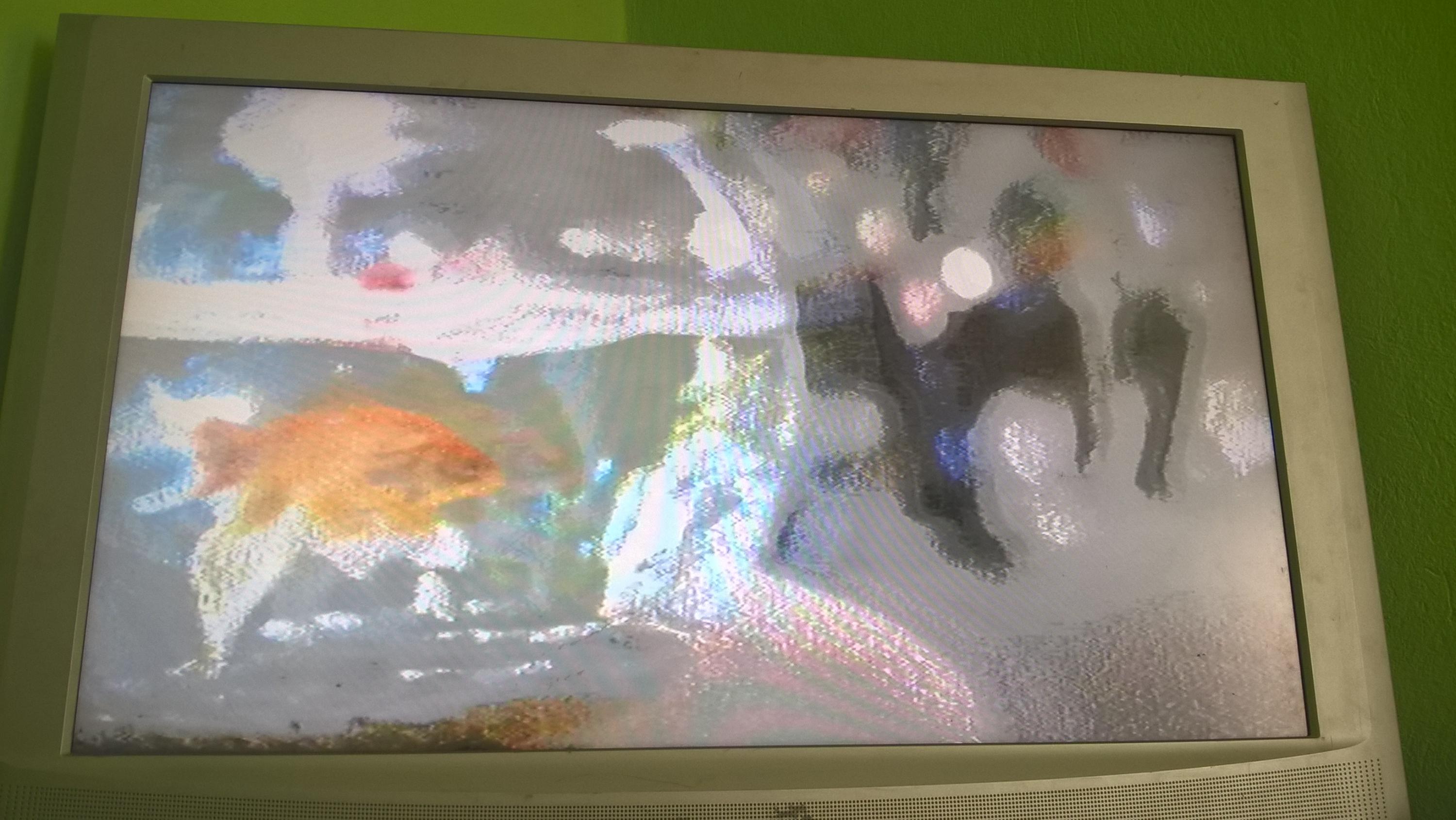

    Hi all.

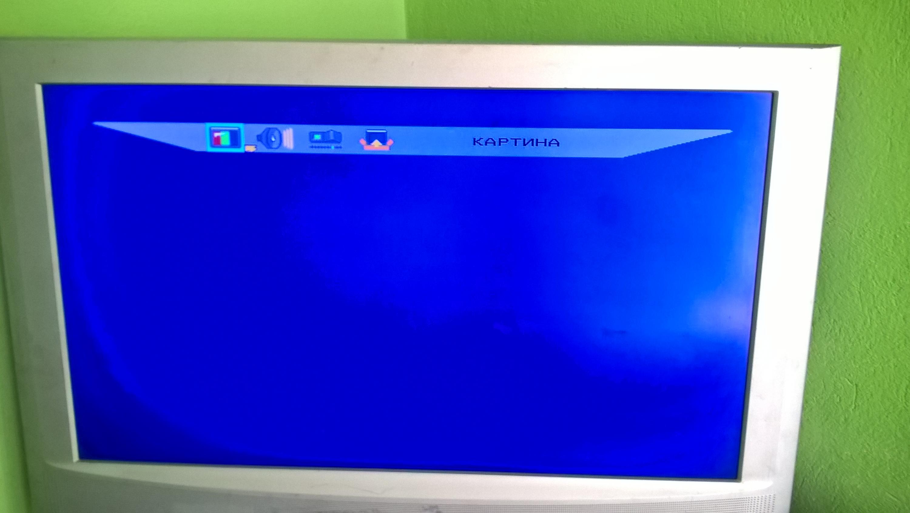

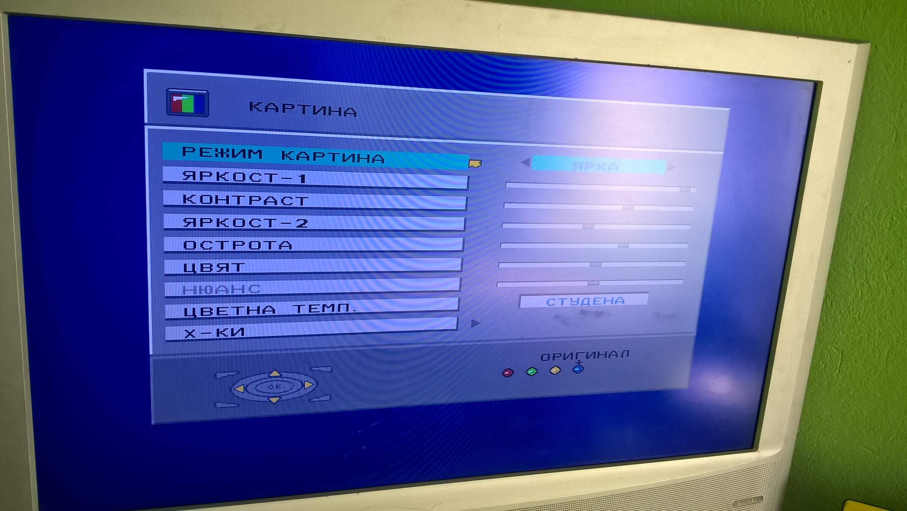

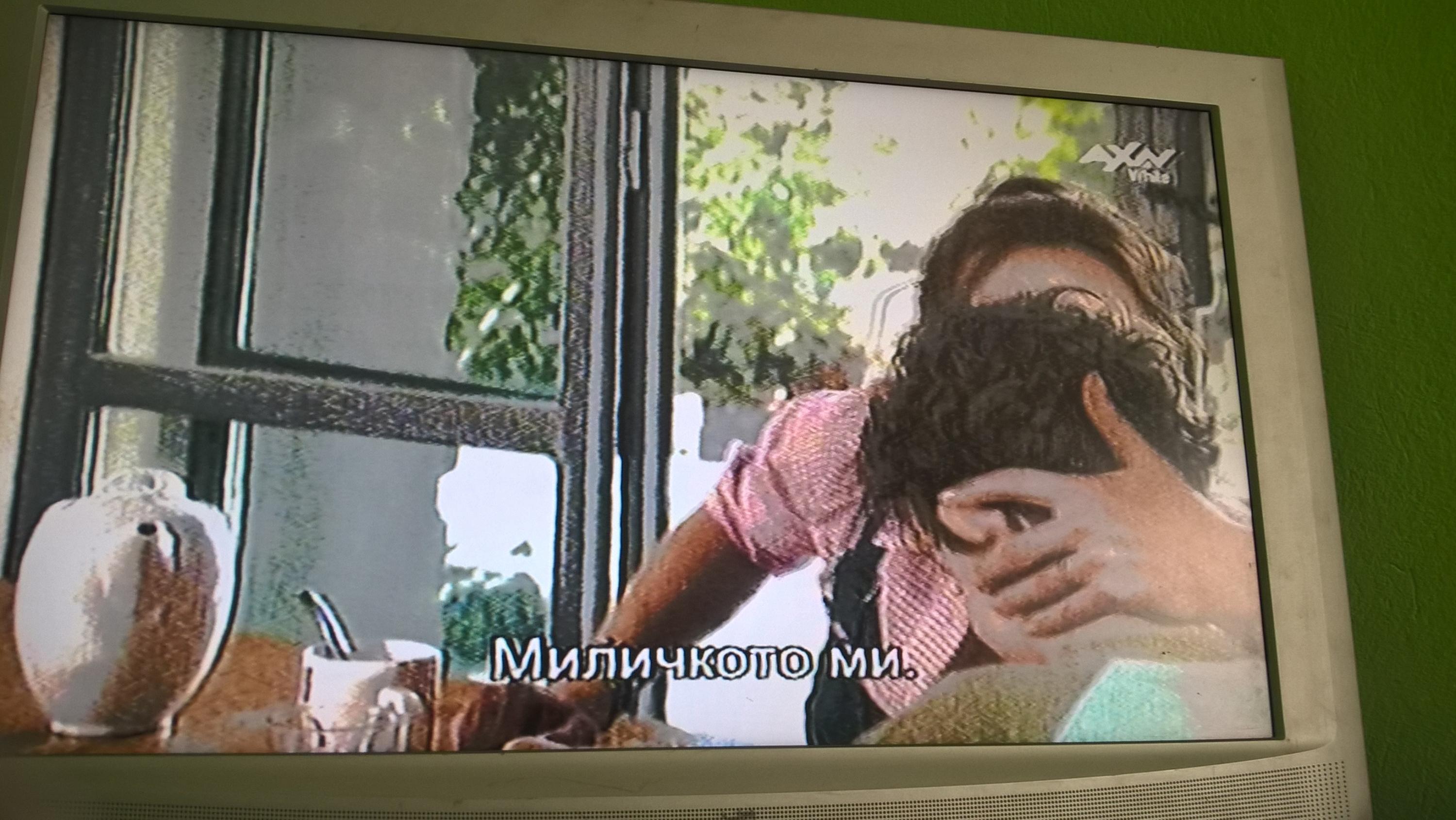

    I have this tv, when i turn on tv without signal, everything is perfect /i have perfect blue screen, perfect ''menu panel''/.

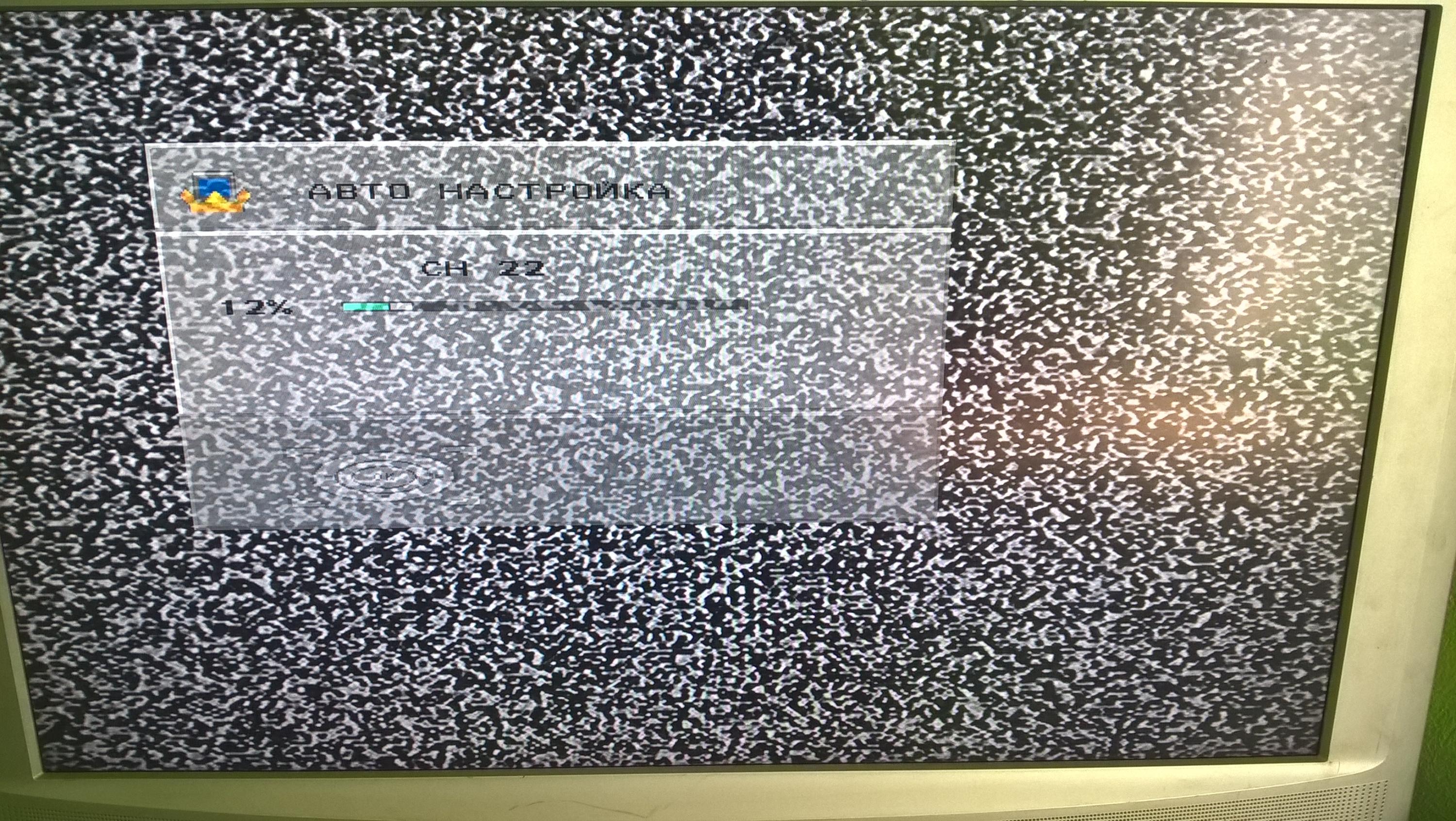

    When i put the cable for tv, or then i connect dvd or blu ray player, the picture is.....some of solarized or ... i don't know...., but the menu panel is still perfect.

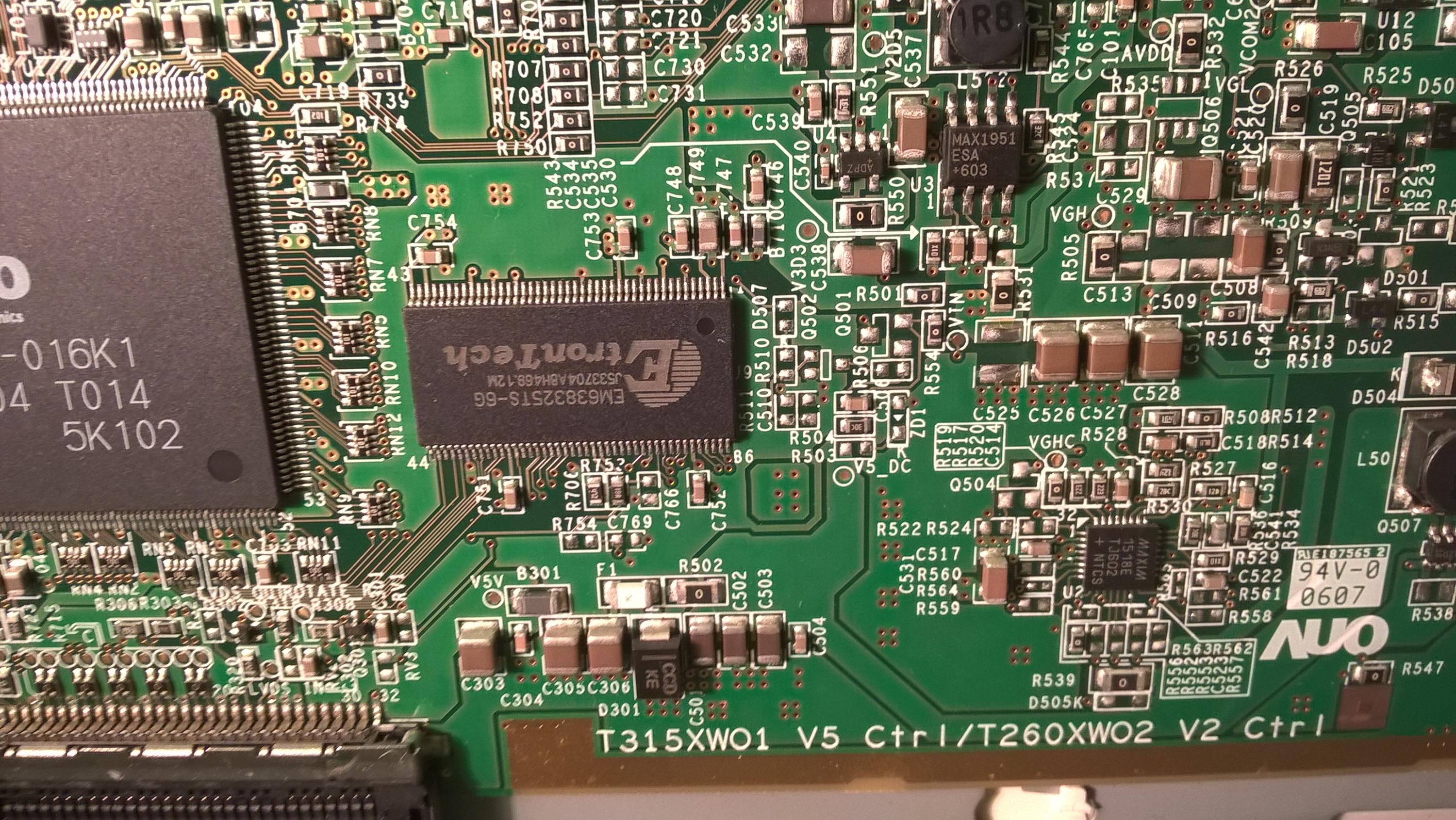

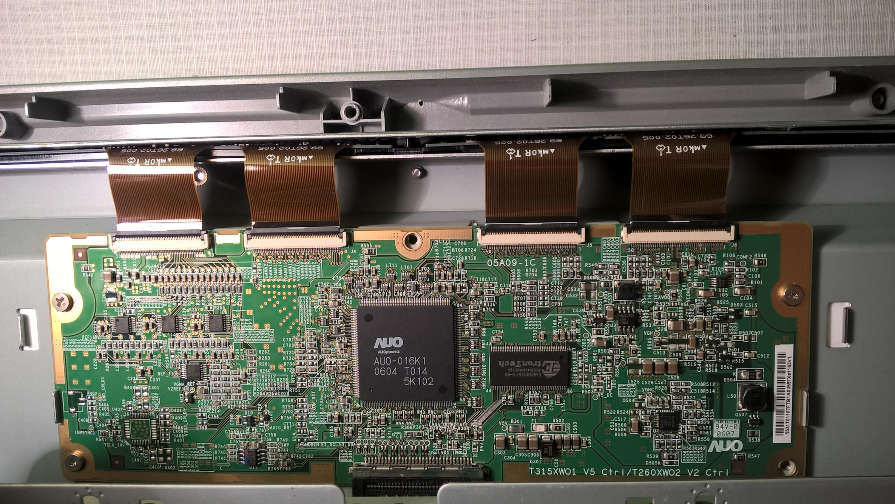

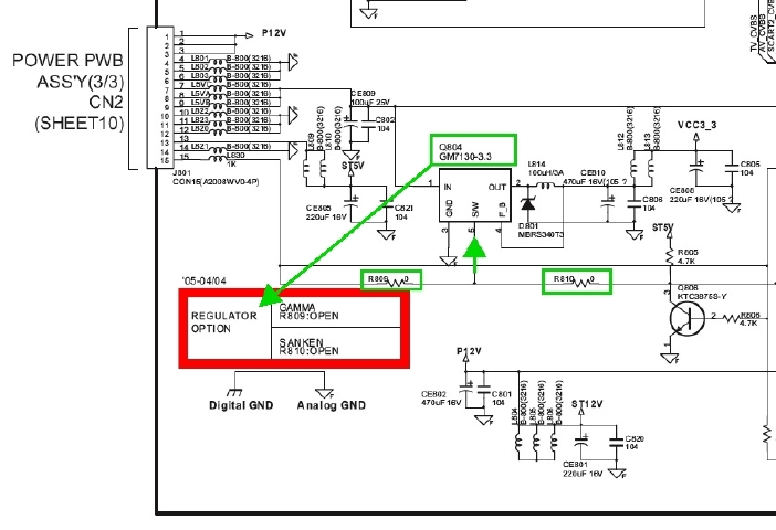

    I thing..., may be chip AS15-F on the t-con, but i don't have this chip on the t-con.
    On the t-con i have 32 pin chip MAXIM1518E.
    Should I check the Tcon or the Mainboard first?

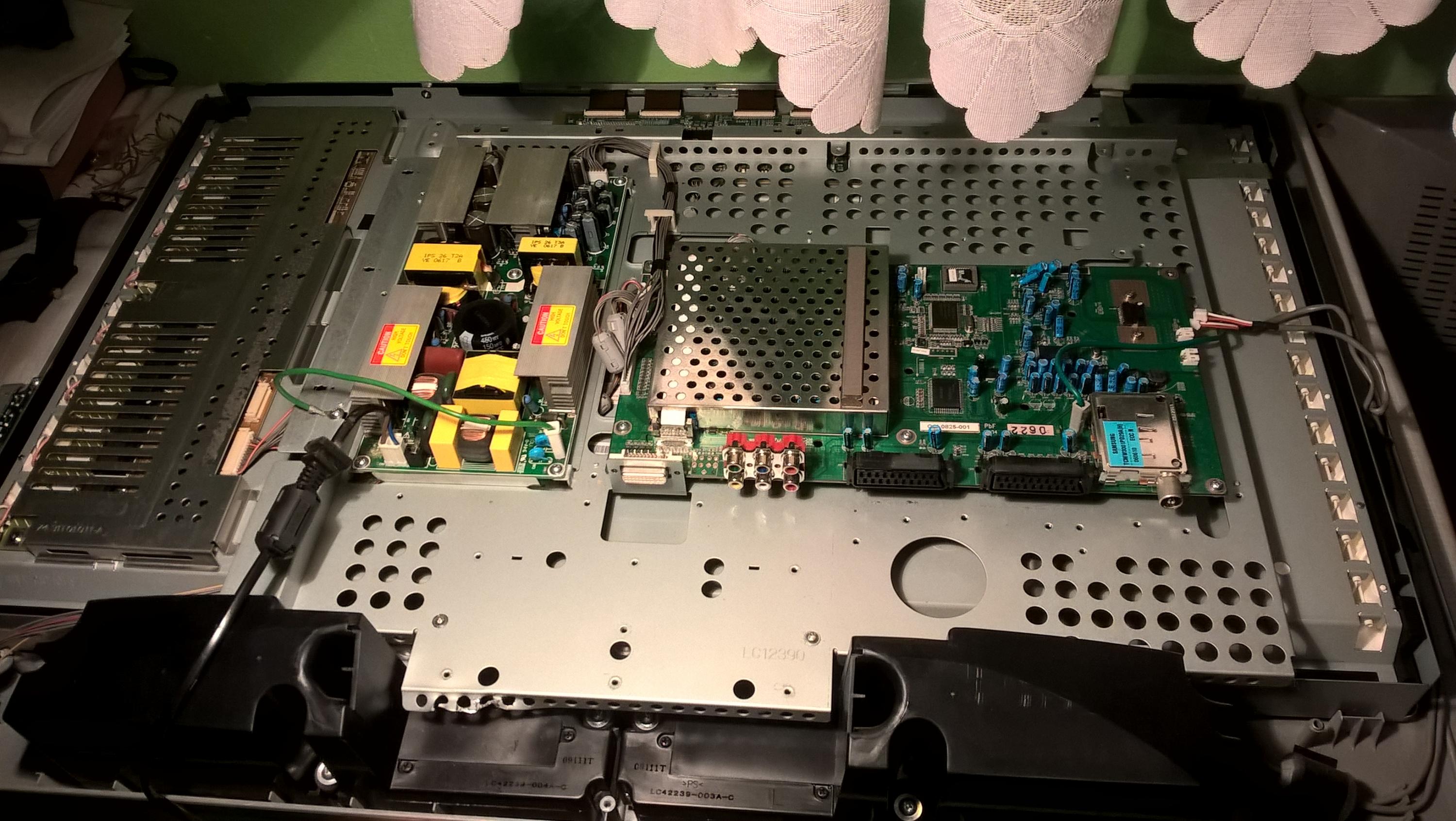

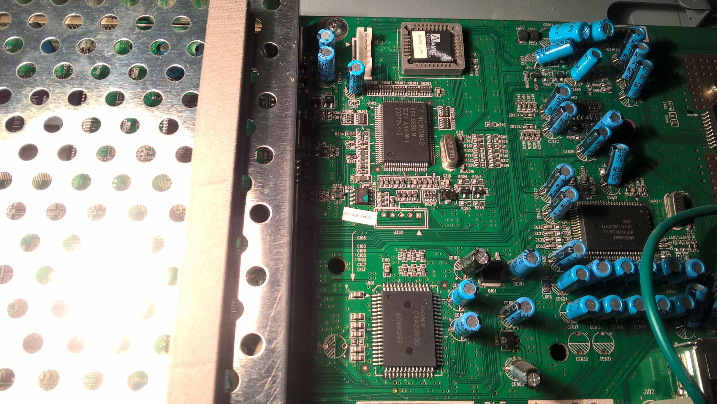

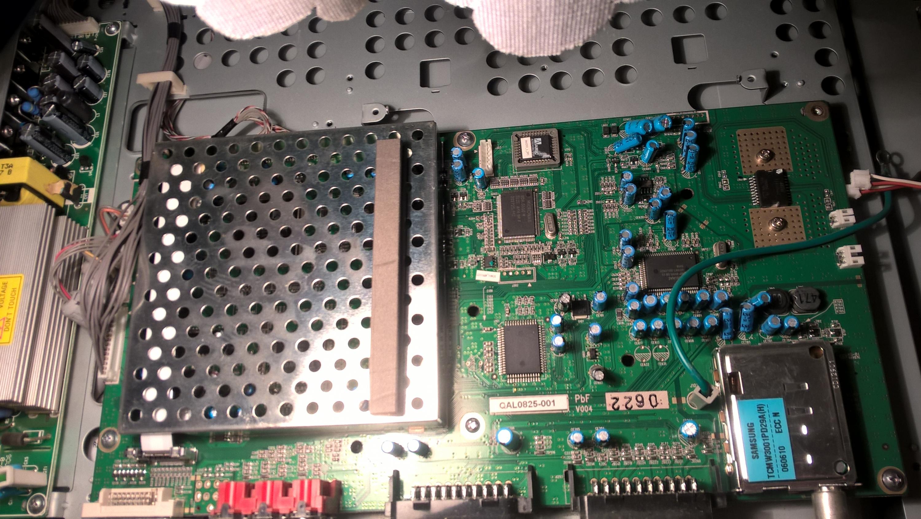

    Post a phoro of your circuit boards.

      Let's see pics of your symptom please.

        Pics 4, 5 and 6 of first post is a pictures with symptoms /bad pictures/.

          it does look like a Tcon fault but better to see what others think. There are various voltage points on the Tcon board which you could measure the volatges at.
          V3D3, V5V, VGHC, VGH, V2D5 etc.

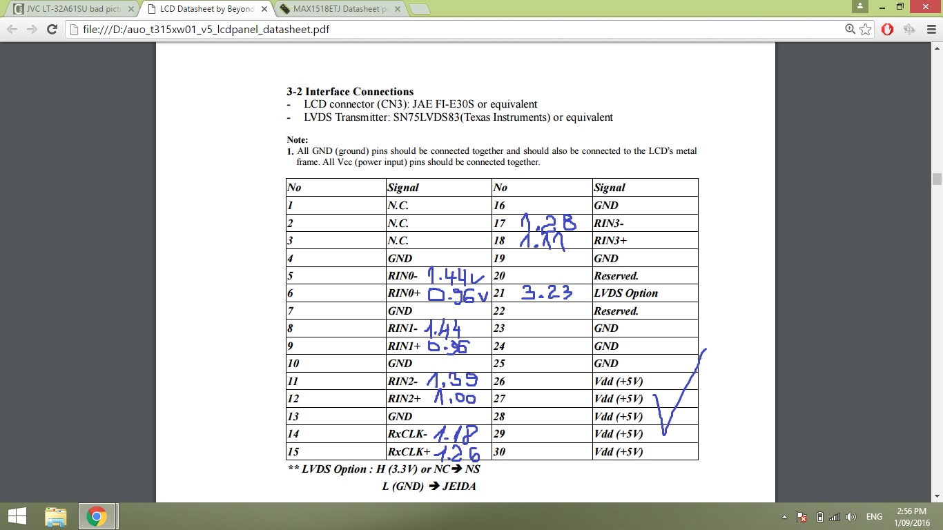

            All GAMMA voltages is no more than 1.30V (0.98, 1.13, 1.26, 0.18 V etc), this is may be bad.
            Here is voltage on my T-con:
            2VS/DC- 4.91V
            VGHC-26.1V
            VGH-26.6
            VGL-6.1V
            VCOM2-6.1V
            COMF2-6.1V
            VIN-3.31V
            V2D5-2.5V
            AVDD-13.6V
            V5V-5.0V
            V3D3-3.3V
            ASYC RST-3.3V
            LVDS- 3.23V
            VGMA- 12.91V
            V2REF1 - 2.5V
            REF/F1-12.86V
            • dick_barton
              • Aug 2015
              • 6643
              • Wales
              Re: JVC LT-32A61SU bad picture
              The supply voltages look reasonable and the reference voltages appear to be there. Looks like you may be right and the gamma chip is faulty.

                  That center area of the chip will be soldered onto the pcb. Do you have the equipment to remove it?

                      The problem is on main board. I find worked t-con, and when i replaced t-con, the problem was the same. Thanks all for help.
                      • kc8adu
                        • Nov 2003
                        • 8832
                        • U.S.A!
                        not sure how mainboard can do that.thats a gamma regulator issue.
                        i suspect your replacement tcon is bad too.
                        • coojoe_213
                          • Nov 2015
                          • 105
                          • bulgaria
                          No, i told you. I find anather one, which work, absolutly same number part, and the problem was same. What you thing about AV Processor on main board?

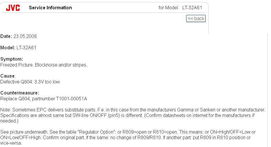

                            Or could it be noise in the picture as the service informations said
                            • coojoe_213
                              • Nov 2015
                              • 105
                              • bulgaria
                              Thanks a lot. Excellent information!!!
