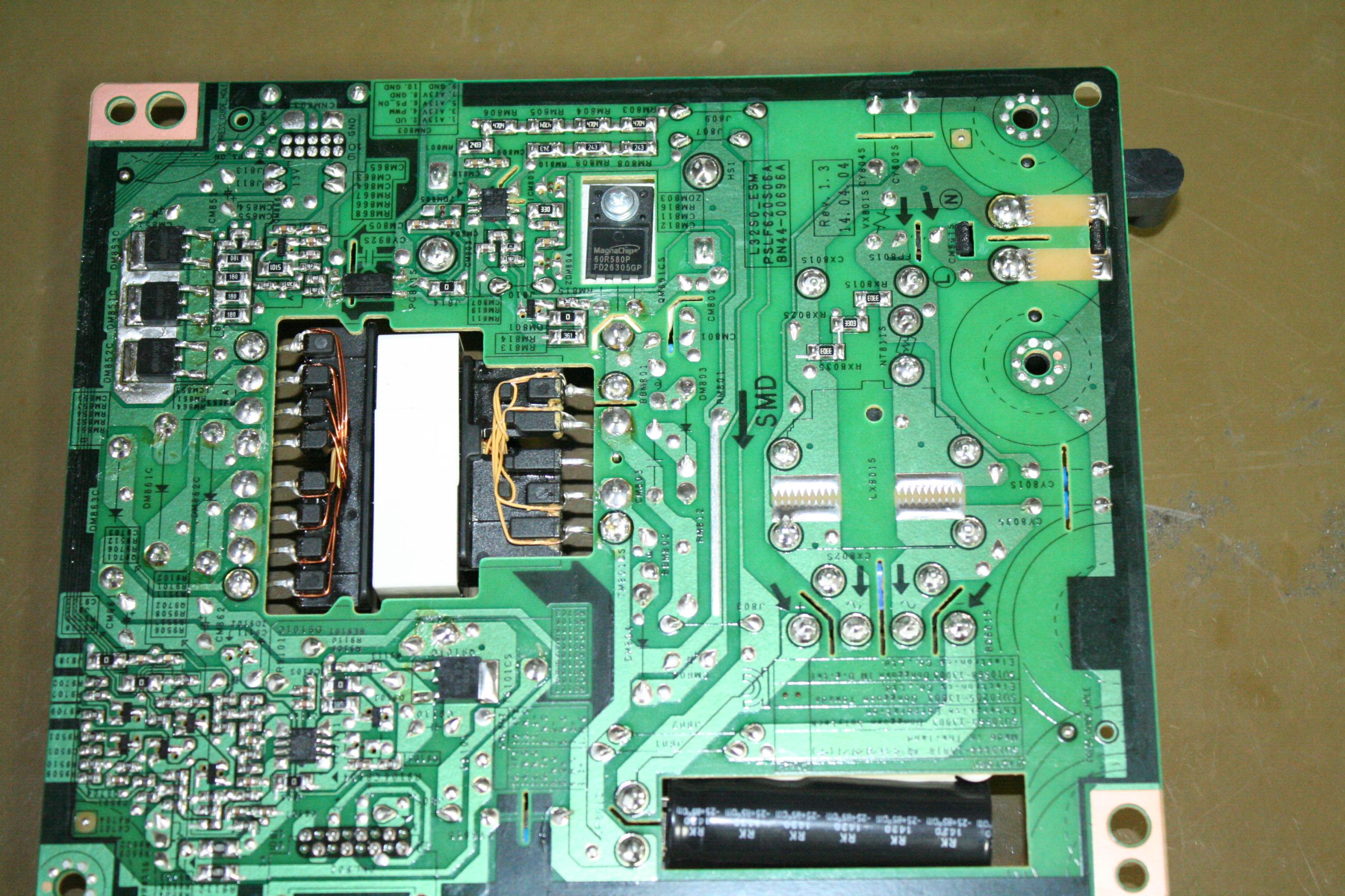

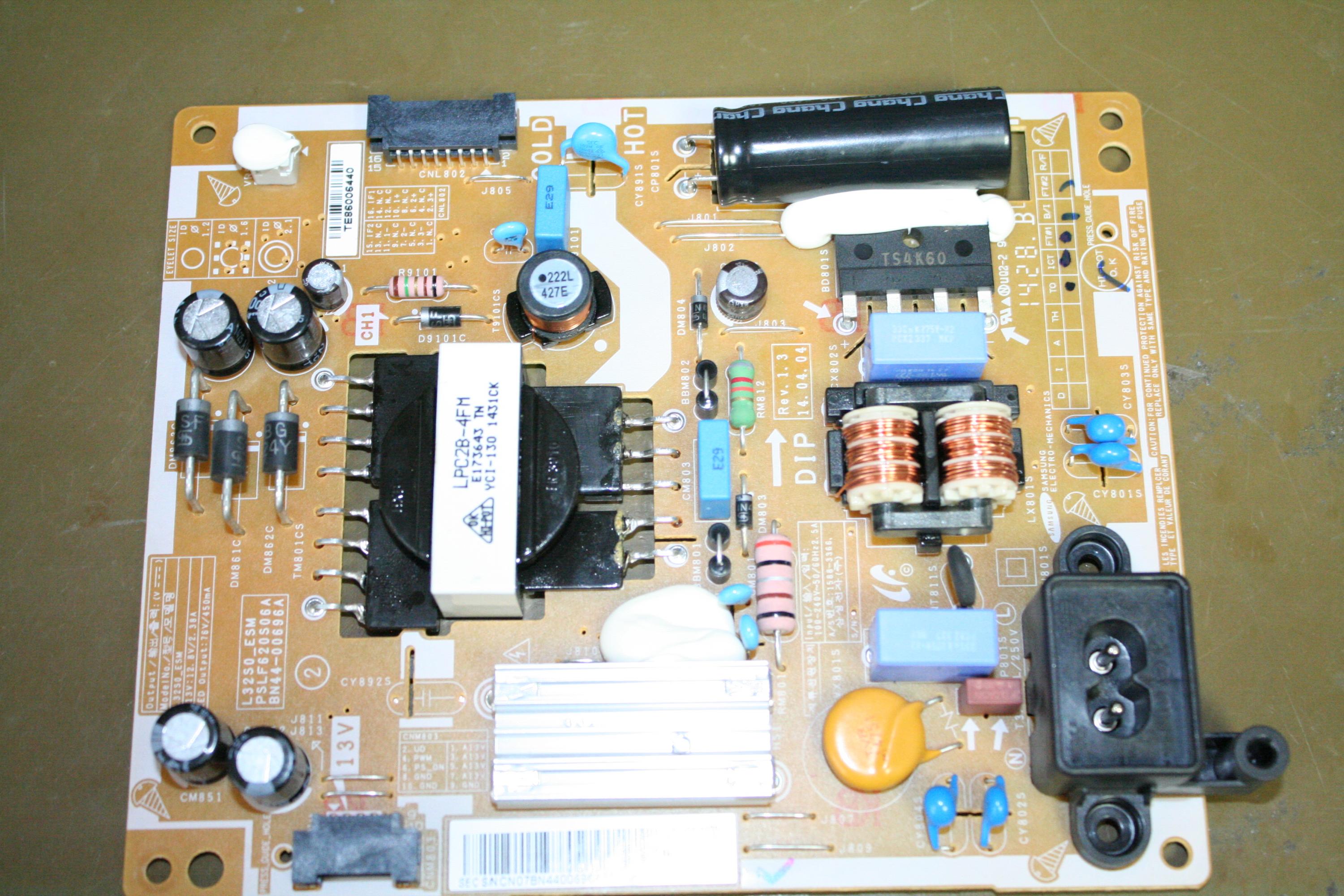

    Greetings fellows, I've searched the forums for this power supply and TV, but I couldn't find anything remotely close, so I'll start my own thread and hopefully we'll be able to fix this TV, as it seems like a real simple thing, but I can't quite pinpoint it.
    The problem: a Samsung ue32h4510 Smart bla bla TV turns on and off at random intervals. Sometimes it stays on for longer, sometimes the "Smart" logo flashes on screen for barely a second and then it goes off before rebooting again.
    What I found so far: I'm most certain it's a power supply issue. The power board is a BN44-00696A (see the pictures, let me know if you want any close-ups of specific parts). I first wanted to make sure it's not the main board to blame, so I unplugged it from the supply and, like with most Samsungs, the LEDs fired up.....for a while at least, as after a few moments, they started flickering and eventually went out (indicating the same intermittent power issue from earlier). I then wanted to make sure it's not a bad LED to blame, so I did the opposite and left just the board with no LEDs. Using my phone's flashlight, I was able to see the logo coming on and then the fuzz you get when there's no antenna plugged it. Once again, it worked like that for a few moments and then rebooted. My first thought was to reflow the connections to the transformer, diodes and switching transistor. I even pulled out the D-PAK diodes on the back of the board and checked them - they all seem fine and there are no other shorts. I tried the TV again and it almost seemed like I fixed the issue: it stayed on for way longer, but then it went off again (after around 10-15 minutes). I then proceeded to swapping out some caps: I started with the 47uF one near the rectifier bridge (towards the middle-right of the board) and then the two 470uF ones in the upper left (which was useless now that I look at it, since those are tied to the backlight portion which seems to work). I tried it again and this time it seemed even worse for some reason, as the backlight flickered a lot and the TV barely came on - it took 2-3 tries to get it to show anything and then it went through its power cycle again. When it does decide to stay on, I get the correct 12v on the 12v rail, so the secondary seems perfectly fine - it's the primary I'm holding as the main culprit. There's also a whistling noise coming from the coil that's part of the LED drive (only when the LEDs are plugged in, of course), but I'm pretty sure that's normal. Here's the weird part: it only seems to turn off when I touch or bump the power board, which is why I still think there's a bad joint somewhere (though I may be far off). Could it be a bad optocoupler or control IC? Again, please don't go too hard on me if this has already been asked somewhere else, but I have searched the forum and couldn't find something related to it. I'm still new around here and may not know how to correctly use the search function LOL. What do you guys think ?
    Wattevah...

      What happens to the pins at CNM803 when the TV friggs up? Do they power down? Try turning the backlights down low as they go and see if your TV stays on longer.
        Re: Samsung ue32h4510 turns on and off randomly (bad power board ?)
        Since this power supply board is and always on power supply, when you run the power supply board by itself without the main board connected, the BACKLIGHTS come on but did not stay on and also so flicker.
        So the DCV on the output side of those 4 rectifier diodes in the cold side are not flickering at all?
        BTW, did you use LOW ESR caps for the replacement? These board with rivets for through hole soldering are know for having bad solder joints, I always resolder them all.
          CNM803 is the LED output - as far as I remember, yes, it too becomes unstable when the supply starts messing up and makes that whizzing sound (which I believe comes from that choke btw - "T9101CS" on the board and "222L" sticker on top). It doesn't start whizzing straight away though: it operates normally and silently for a random period, but then when I poke the board or just on its own, it starts making that whistling sound and the LEDs start flickering shortly after. It doesn't actually shut down entirely - it's like you're connecting a lightbulb to a socket and you're touching the wires together and get that unsteady contact that causes the bulb to flicker. Once it starts messing up, it hardly ever goes back to normal - I have to cycle the power to get it steady again (and sometimes it still doesn't work steadily), so it's like something's heating up and causes the defect :|
            Like I said, I believe I covered most of the solder joints: transformer, transistor(s), choke, diodes (even went down in the primary and reflown the bloody power inlet, hoping it had somehow become loose) - no go.
                CNM803 is not the LED output. Look again. This connector has PSon, BLon etc.
                280V on the main filter capacitor is not the correct voltage. It should be something like 311V at least. 220V x 1.414 = 311.08V
                Put the TV back together and run it with the backlights turned down and see if the TV runs longer.
                    So ALL the dcv outputs of the power supply are jumping up and down then, right?
                      Correct. The secondary falls and rises intermittently (even if very briefly before the normal 12v resumes).
                        If the LED connector is not in place and running the board by itself again, they are still fluctuating?
                        I would inspect the solder joints on the board really well at this point first.
                                Just to confirm: The voltages are jumping up and down, then shuts off? Did you try freezing (can of air upside down) / heating (hair dryer) parts of the PSU yet? See if you can make it run longer, etc.
                                      I would put a oscilloscope on the secondary and make it scan way slow. Then heat and cool specific areas on the PSU and watch the screen.
                                      I have had a problem like this before on a dual voltage PSU for a phone system. It done the exact same thing. The both voltages would go up and down, then it would shut off.
                                      The culprit was an inductor on the secondary. Reflowing with solder didn't help. I had to take it out, clean the holes then resolder the inductor. There was no sign of a bad solder joint. I found it using my hot air soldering station.
