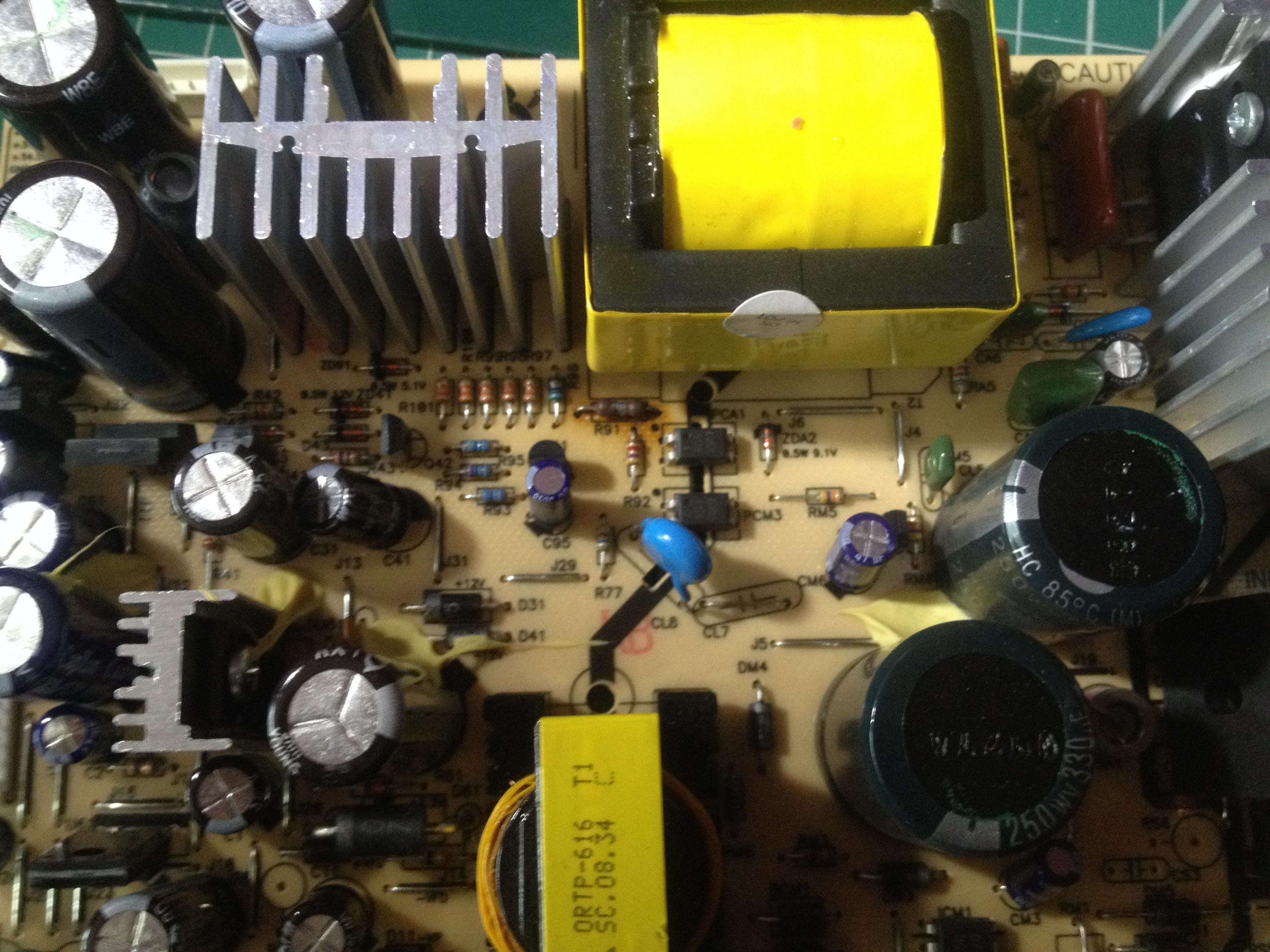

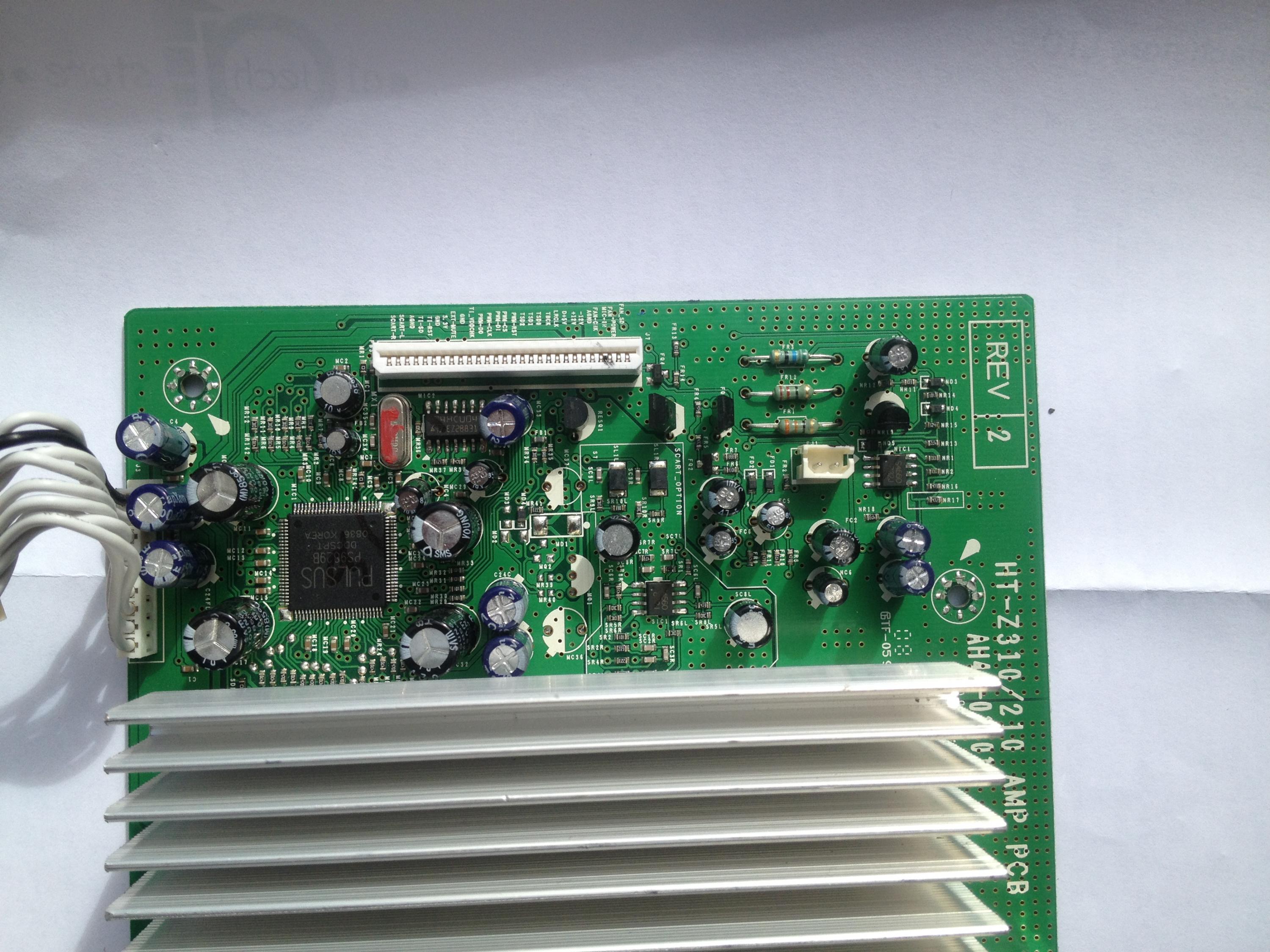

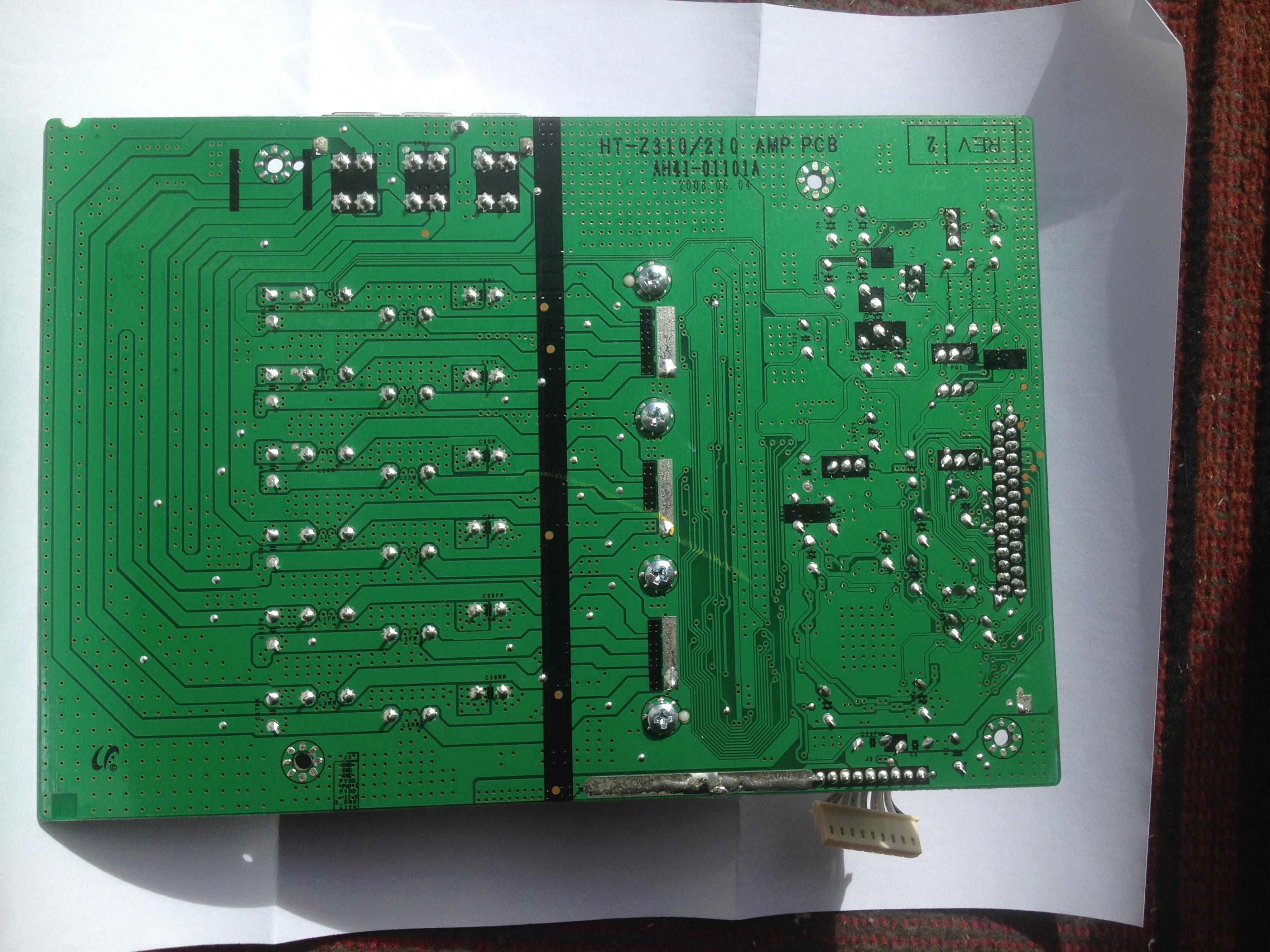

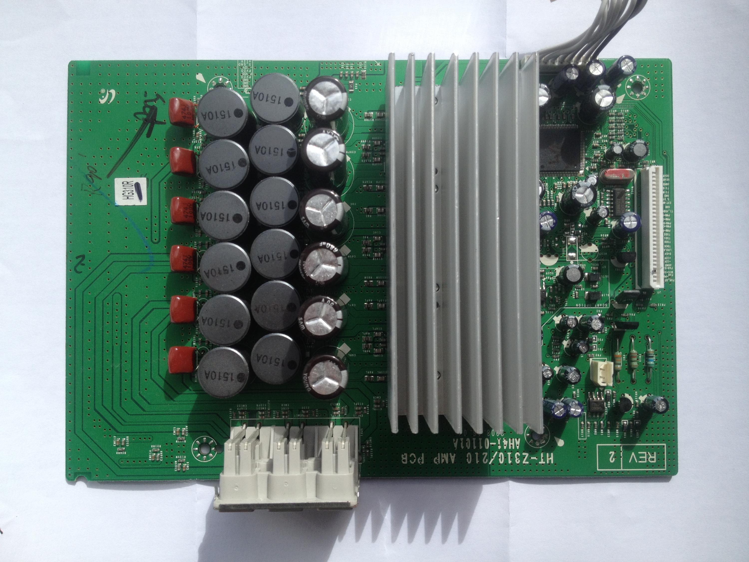

              Re: samsung ht z310 - FAN_CHK error
              First of all, thank you everyone for your help.
              Originally posted by budm
              Pictures of the board and the model number of the fan?
              I have attached some pics. Also, the fan model is Xfan: RDM5015S

                              there's a capacitor FC-2 (47microfarad, 16 V) at the output connector of the fan - it was short-circuited, zero ohm. Replaced, perfect...
                              Worth to check it!
