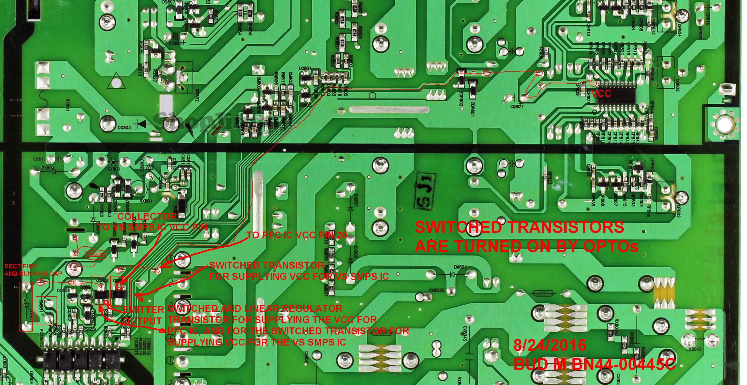

    The voltage is 4.5V on pin 3 of the PFC controller IC. Here are some pics of the PFC circuit.
    That is OK, the trip point is if it is below 1.40V, so next you need the scope to look at the Drive Output pins GD-M 19, GD-S 17.

              My scope is not battery powered so I am SOL. I measured the 3 parts on the heatsink in the PFC circuit, 1 diode and 2 FETs. They all measure ok in circuit. I also measured all the surface mount low ohm resistors and diodes and they all measured good. So only other thing is the PFC IC, unless I missed something?? I watched a video on youtube regarding this p/s. The tech used a 220 ohm resistor from the PS_ON pin to ground. I just used an alligator clip connected to ps_on pin and other end connected to secondary ground. It shouldn't make a difference since the voltage is low enough shorted directly to ground.
                Re: Forcing on Power Supply with PS_ON
                You already know that the PS-ON signal (ACTIVE LOW) is fine otherwise you will not have VCC for the PFC IC, that VCC for PFC is fed through a switched Transitor which is turn on when PS-ON signal is present.
