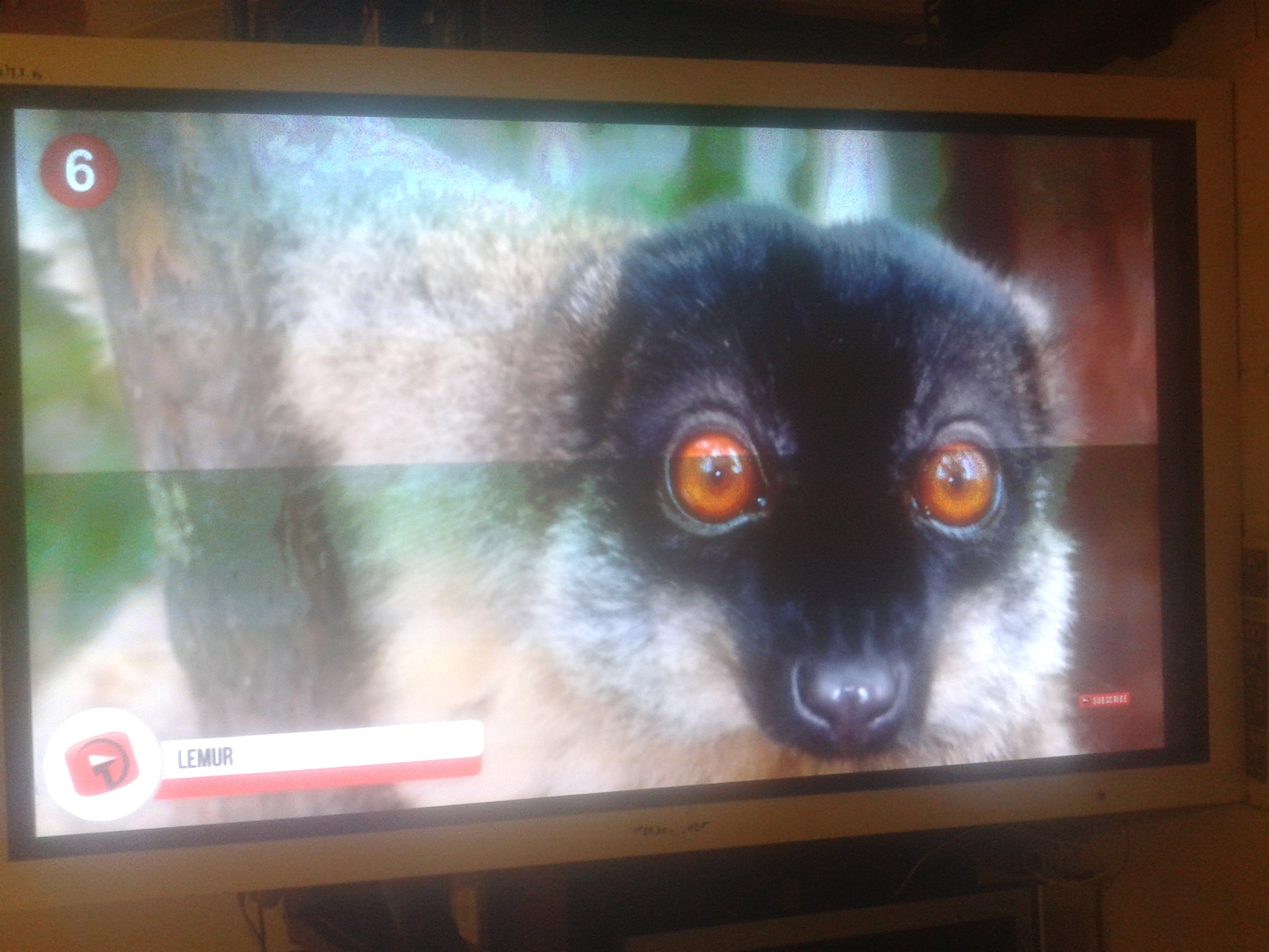

    this unit is having some strange problem :

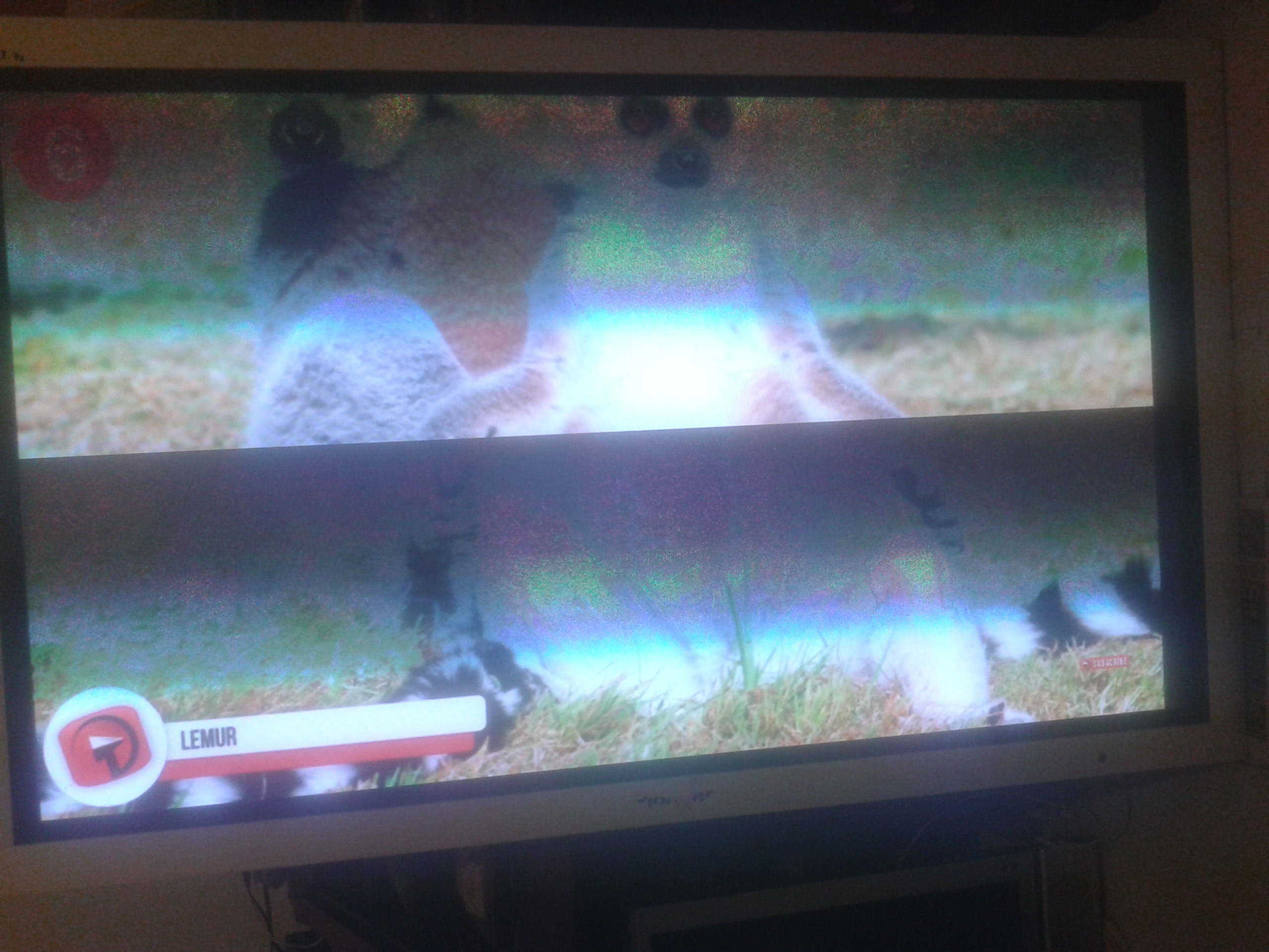

    there is a picture , but when there is a bright picture , the screen is separated into two halves . top and bottom .
    from the top of each half there is noise spreading down the screen.
    when there is a small picture on the screen , it is looking good.
    I tried to calibrate voltages , and could make it better by raising the Vs ( and tweaking other voltages) but it never disappeared totally.
    is this a bad panel ?

    Looks like control board or motherboard to me, ran the test patterns ? Also the panels wont fail in that way at all so rule that out now. Also the image looks very grainy to me from the pictures is it ?
      Re: LG PDP50X2 plasma tv bad picture with full screen. BAD panel ???
      I would go with a Control board issue at first look....However, the test patterns should narrow it down..

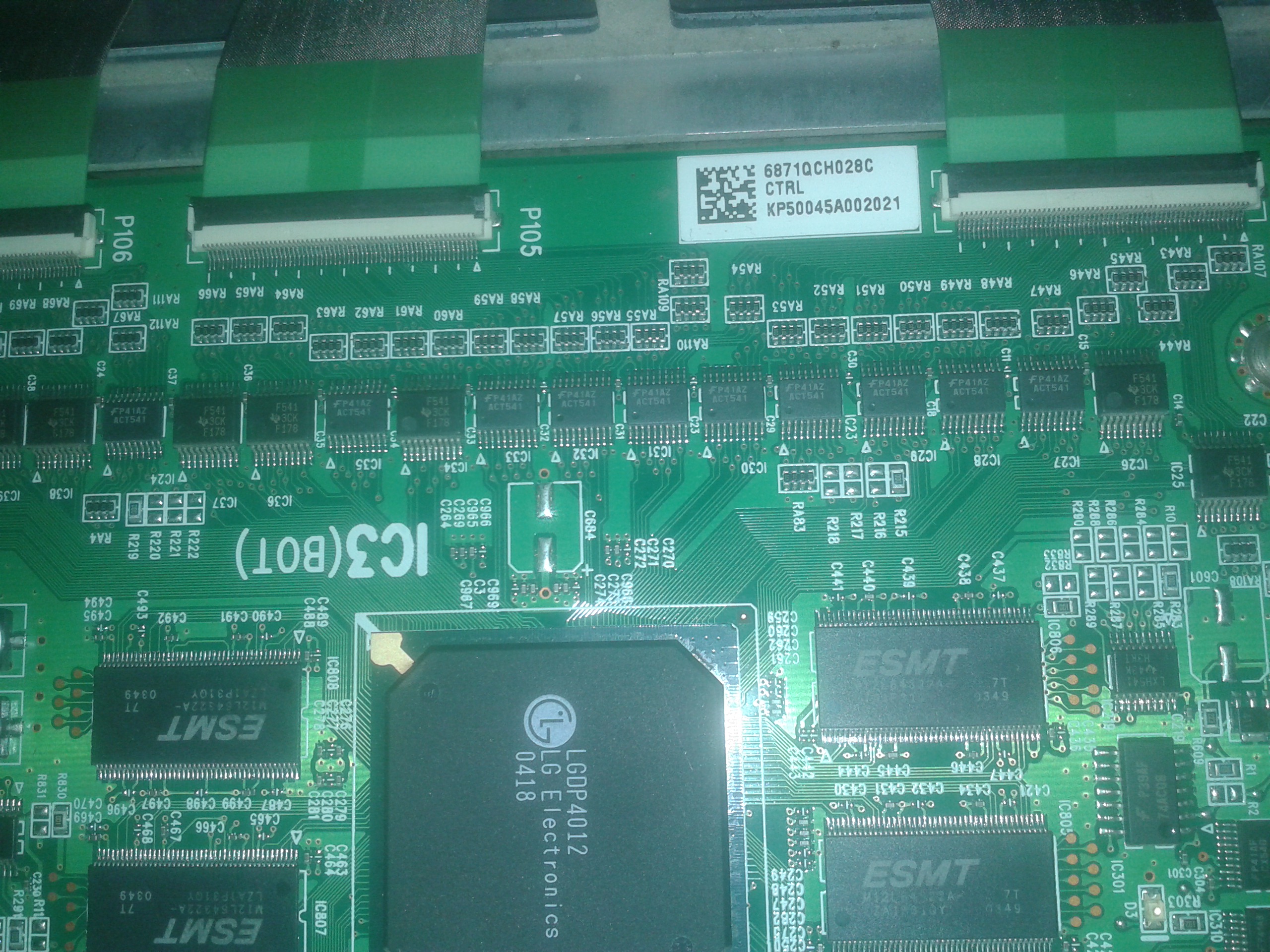

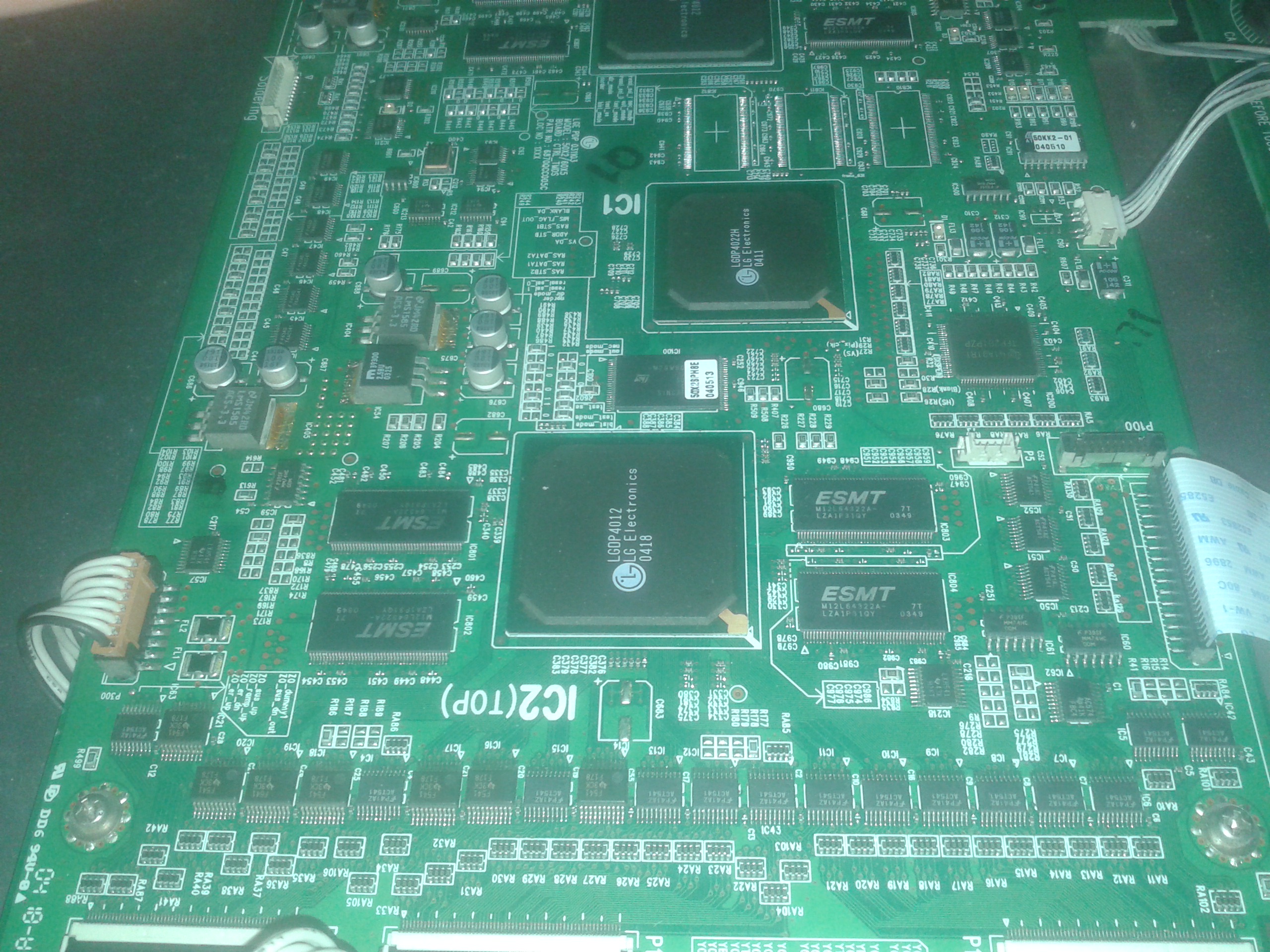

            this is most of the control board .
            the p5 connector is white color , on the right side. (next to p100)

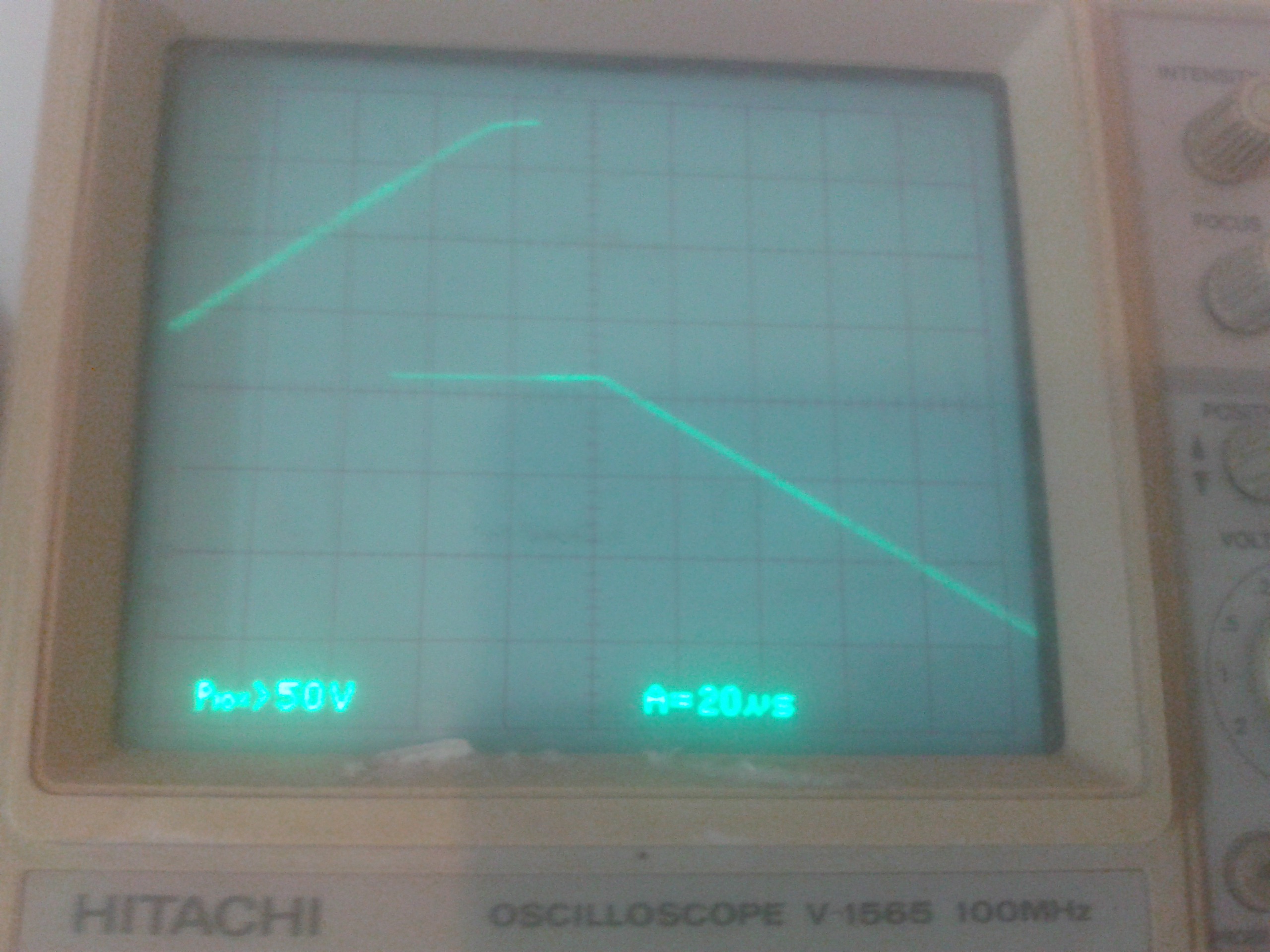

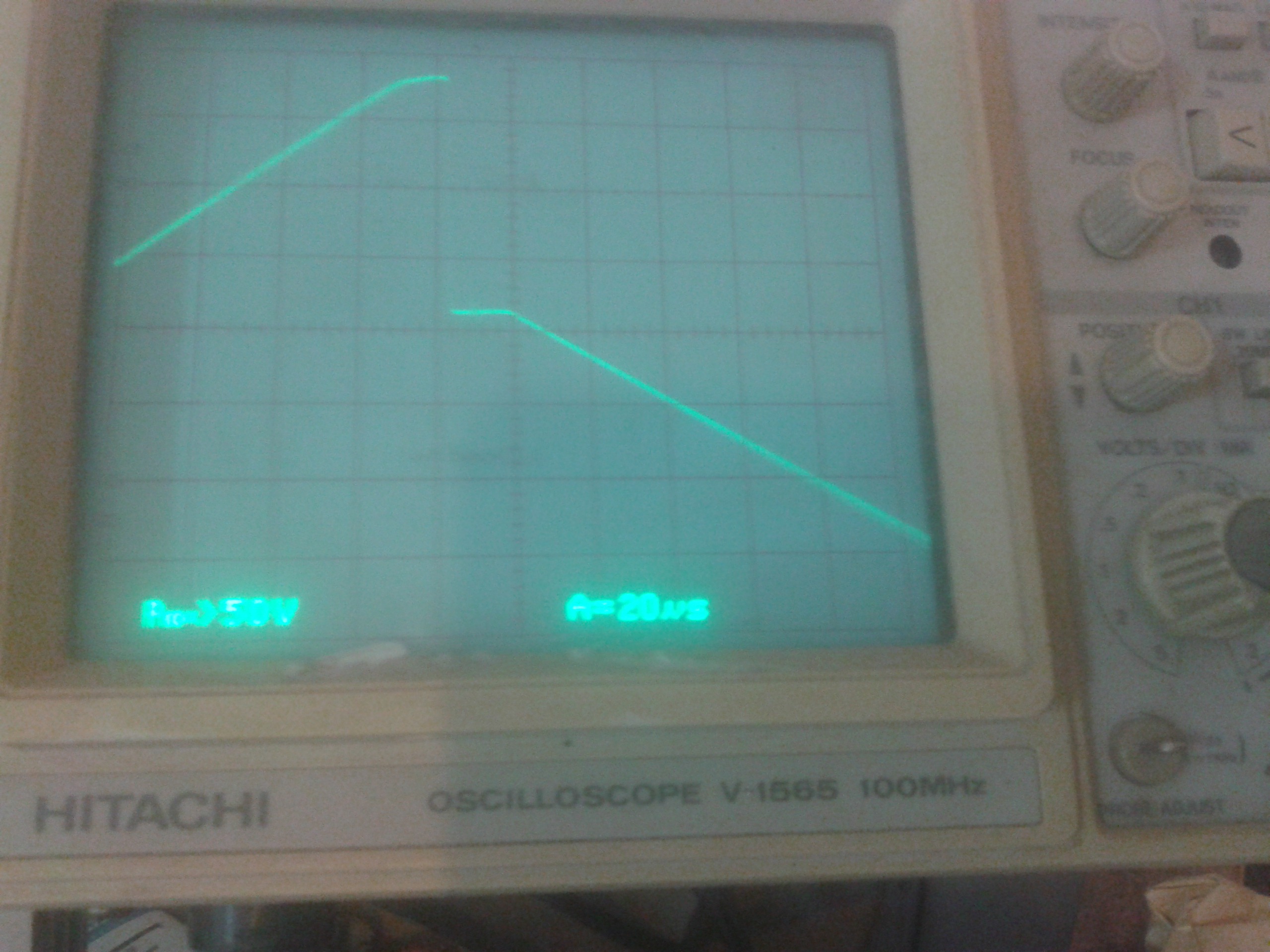

            I have noticed that when the problem occur , there is a different output wave at the Y-SUS output. (it's like when there is a black picture / no input)
